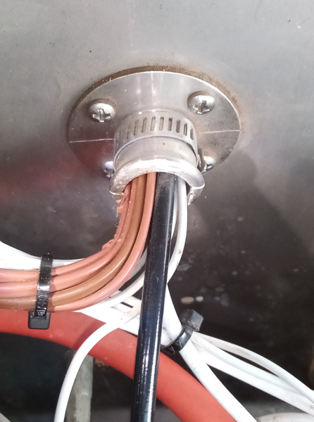

discussion- J230D potential electrical fire - firewall penetration
This from RAAus accident and incident. Perhaps the fix should become a fleet wide thing, a solenoid to isolate the battery, yes please.  Sorry to sound like a broken record but every GA aircraft has to have that.
