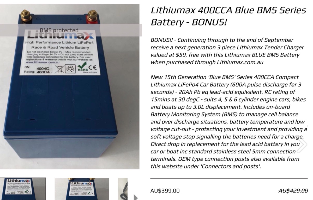

Old Koreelah Posted December 25, 2020 Posted December 25, 2020 1 hour ago, RFguy said: ...Additionally, consider the starter current of 150amps will require a LIFEPO4 battery size of at least 75 AH... Being an electronic simpleton, I’m very interested in this discussion. I hope to learn how to get the best out of my LiFePO4 battery, which is rated at 20AH and has been happily spinning my J2.2 for years, even on cold mornings.
RFguy Posted December 25, 2020 Author Posted December 25, 2020 Now, while we are on the subject of LIFEPO4 and CCA There are many high discharge rate RC helicopter LIFEPO4 (as well as LiPol) packs rated for 30C continuous, 60C boost. There is a 8.4AmpHour 30C pack- so 30x is 240 Amps ... But... I just don't know what quality they are in terms of reliability. That much current density in a small space means the battery will likely get hot in the starting exercise, and I don't like that too much.... maybe use as a starting battery on the ground (and then leave it on the ground) glen.
RFguy Posted December 25, 2020 Author Posted December 25, 2020 Old-K - That Lithumax looks like a good one ! yes on paper is excellent. The only think you DO NOT want in that battery is the on board low voltage cutout- remember- cannot have the jab charging system get disconnected from the battery with everythign else still connected. (over voltage scenario) So, returns back to the issue of current limiting for the flat-battery scenario, the lead acid will probably soak up a charge current greater than the rating of the Jab charging system for the first minute, then back off as the terminal voltage rises of the Lead Acid. Not long enough to overheat the jab charging system. The LIFEPO will just keep on soaking it up for maybe an hour or two ! '

Old Koreelah Posted December 25, 2020 Posted December 25, 2020 27 minutes ago, RFguy said: Old-K - That Lithumax looks like a good one ! yes on paper is excellent. The only think you DO NOT want in that battery is the on board low voltage cutout- remember- cannot have the jab charging system get disconnected from the battery with everythign else still connected. (over voltage scenario)... Thanks for the advice Glen, but most of these explanations assume deep knowledge- which I don’t have. As well as the normal switches, my installation has a Battery negative isolator. I have no idea what this would do to the system. I presume you are saying that if my battery’s internal BMS disconnects it from the aircraft, the Jab charging system will overload, with nowhere to dump the power. If that is the case, I’m open to suggestions about a remedy.
