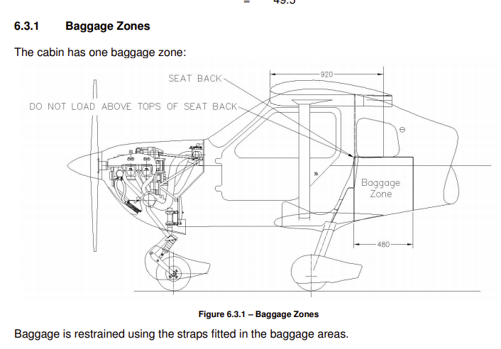

The J230 has a huge baggage area and big wing tanks, but can you use if for long cross country with 2 people?
BEW 370kg
MTOW 600kg
Usable load 230kg
2 Passengers - say 150kg,
Baggage -12 kg This seems light for what you have listed, my lightweight hiking camping gear (tent, 2xsleeping bags, 2xmats) is 7.5kg , without any personal gear, water, tie downs etc
Load capacity left is only 68kg for fuel = 94Lt, equals 3.4hrs with 0.5hrs reserve. at 120knots range of 408nm

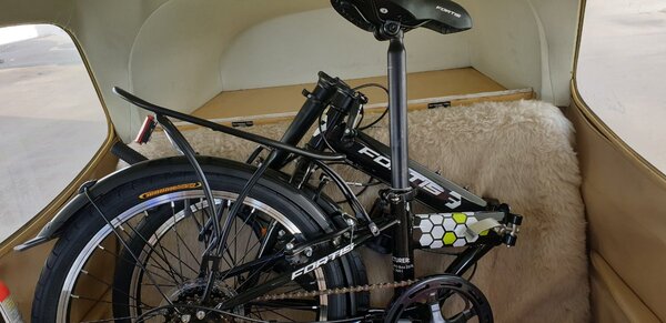

Disclaimer: I have about 90 hours. On the other hand, I have bought my aircraft for touring and exploring the desert so have given it some thought. I think that if you want to see the sights, you are better off with a high-wing aircraft. If you want to avoid misery half the year, avoid something with a bubble canopy. Your aircraft will not be hangered for the 12 months. I was not game to get a composite aircraft because I did not know what the sun would do to it, so I was keen on getting something that was not composite. I suspect that if you are touring, you will want the ability to land on short, rough, soft fields. I have not landed there, but, for example there is a strip to the north of Fraser Island that I would not want to take a plane with small wheels. I needed tricycle undercarriage because I am inexperienced. That left aluminium, high wing aircraft large wheels.
The Foxbat is mostly aluminium, but the control surfaces are fabric and the cowel is fiberglass. That is what I ended up getting. The Zenith is a kit plane. I might have got a Savannah but I did not fit. Even if I did fit, the cabin would have been much smaller than the Foxbat, which is roomy and has excellent visibility. The Brumby did not have enough useful load, and a review in Australian Flying said it lacked rudder authority (!) IIRC, the SuperSTOL, Highlander and Hornet are all tricycle gear, and the Hornet is very slow.
There are lots of Foxbats in Australia, and the support from Foxbat Australia is excellent. They use them on cattle stations a lot. Foxbats cruise at 90 kts. There is the Vixxen which is much faster and is more expensive, but is not approved for use with big tyres like can be used on the Foxbat. IIRC, they are 6 x 6.00. I have been told that if you put big wheels on a Vixxen, it ends up no faster than a Foxbat. There is an older version of the Foxbat with a lower MTOW that is much less expensive and would be okay for flying alone. Eurofoxes are fabric and smaller inside that the Foxbat; they need attention to the rudder when flying but have a very benign stall. There are other planes that are older relatives of the ICP Savannah and look a bit like it.

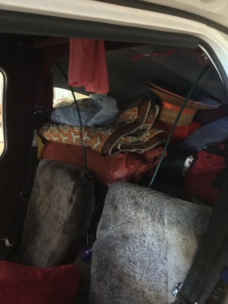

We’ve done a full lap coastal, and a top end half lap. A jab 160 can be packed to the ROOF, has great legs, cumfy. Would do it again in a blink. Have only encountered jabs doing the same epic trips ( RAA ) he jab handles shyte great, handles ruff strips. Downside.......you want to do it again and again. Buried in there is 2x10L fuel,10L water, tent,air beds,bedding,clothes,cooker,food plus plus. ( 631 kg ) and it flew beautifully. ( took a while to get off the ground tho ) Rang a chap to get advice re “that weight” he said “no probs at all”.... so there you go. The specs are grossly under estimated.
Edited by Russ
I have no real experience of flying a Jab, or any other RAAus plane that I would consider suitable. From that low base I would consider the Jab to be well worth considering. It is OK performance wise and also comfort wise. It is high wing and provides reasonable shade for the pilot and crew. Another I would consider would be the Savannah, with similar properties, but slower. A lot of the plastic fantastics don't appeal because they have little shade for the pilot. My choice of high wing is based on years of living in the hotter parts of the country and while I mainly fly low wing, they are not the best for sunny conditions.
Jabiru are tough, I have seen them tyrned over and the nose wheel ripped off and been back flying very quickly.
631kg in a 540kg rated plane is something i would not admit to on a public forum.🤐
Not something I would do either 😬
