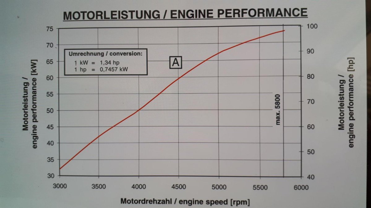

Thruster88 Posted October 15, 2020 Posted October 15, 2020 22 minutes ago, skippydiesel said: This attached article on CS prop use on Foxbat is, in my mind, a very balanced article: https://foxbatpilot.com/tag/constant-speed-propeller/ As per the fox bat article and looking at the 912uls performance curve you will "pick up a bit", maybe 4kw for takeoff and almost nothing for high cruise with a constant speed. If you really need that extra 6 horsepower to operate at a strip it is still going to be marginal.
facthunter Posted October 15, 2020 Posted October 15, 2020 Yes the article is quite reasonable. It concentrates on getting the max horsepower from the engine by the prop making the engines revs available. (like lower gears in a gearbox). One point should be made in all of this is even a CS prop blade is a compromise as it's blades twist cannot suit a wide range of RPMS efficiently, wheras a properly "tailored" fixed pitch for a particular speed. CAN IF this is done for your cruise speed it will out perform any CS at that speed as well as being lighter and cheaper and more reliable.. Nev 1
skippydiesel Posted October 15, 2020 Author Posted October 15, 2020 Thanks Thruster - I have been "operating" from my paddock/strip for about 11 years now. Every TO/Landing is "short field" and just a bit nerve wracking. With full fuel & just me (always), TO role is under 100 m, climb out 1500 ft/min, from a 1100 ft ASL grass strip, with my ground adjustable prop adjusted for what I call advantage TO/Climb (not fully optimised). This is pretty good by most standards but of course my cruise speed 100-110 knots, 5000-5200 rpm 13-14 L/h is compromised. By how much???? Well it has been suggested to me that if I was in a position to optimise my ground adjustable prop for cruise I might be able to achieve a max cruise (5400 rpm) of 125 knots plus, so an economy cruise of 115-120 knots possibly ?????? My existing Fiti prop is no more (accident) so must be replaced. I have a few months to make the decision - Go with the 2 blade Fiti Eco ground adjust, I know so well and have a high regard for OR replace with something else of unknown benefit (CS) that may give a more flexible performance??? Decisions Decisions - all help gratefully received.
