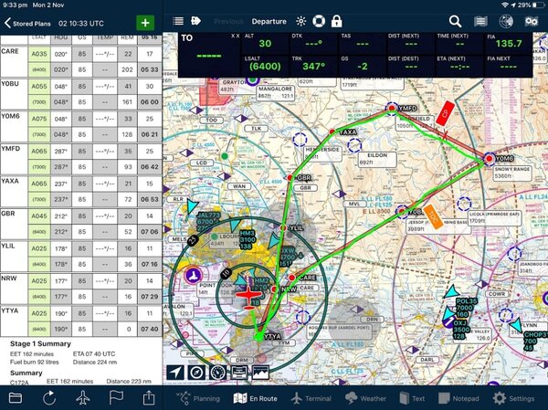

Hi Ferris . Yeah the coast is only a little further. below is the mud map. actually down to Delegate, along the Deddick Valley, then down through Buchan isnt too bad , not so high terrain.. I see there is a Class R around Sale.

Hi Yenn, you'll see I posted what I think is a workable route in this topic. worst case 15nm between possible LZs, mostly 900 to 1500' ASL.
essentially down to Delegate, westish along Deddick Valley to where Barry Way hits civilization (if you can call Seldom Seen civilization) , south past Buchan, Nowa Nowa and after that, plenty of choice.
