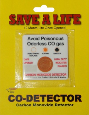

Just having a look at the price of CO detector patches.
Spruce and Specialty have these at about AUD$5.50 each, but you'd have to buy about twenty of them to minimise the postage cost per unit.

Are these not just as good? CO Detector.
Should be less than the total price per unit fom the US (inc. postage).
I will never waste my money on those; bought a few in the last 2 yeras and shared with mates and myself. Also seen others not happy with them as they black out first sniff of CO. Best have been the longlife ones but no longer available at present. Bought a battery one (Aircraft Spruce $99 US) get readings about 10 on startup and some decents and then clears to 0. Cost $150 AUD but reusable and gives info about levels and when clear.
Agree, they are a waste of money!
