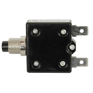

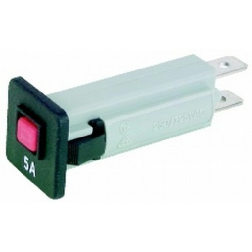

kgwilson Posted April 27, 2020 Posted April 27, 2020 I used panel mount breakers from Jaycar. They are about $10.00 each & come in varying amperages & have a bright red trip button so you can't miss it. 2

danny_galaga Posted April 28, 2020 Author Posted April 28, 2020 I used panel mount breakers from Jaycar. They are about $10.00 each & come in varying amperages & have a bright red trip button so you can't miss it. [ATTACH type=full]52723[/ATTACH] I haven't had a chance to have a good look at these. Do I need to make a square hole for them as implied by the picture?
