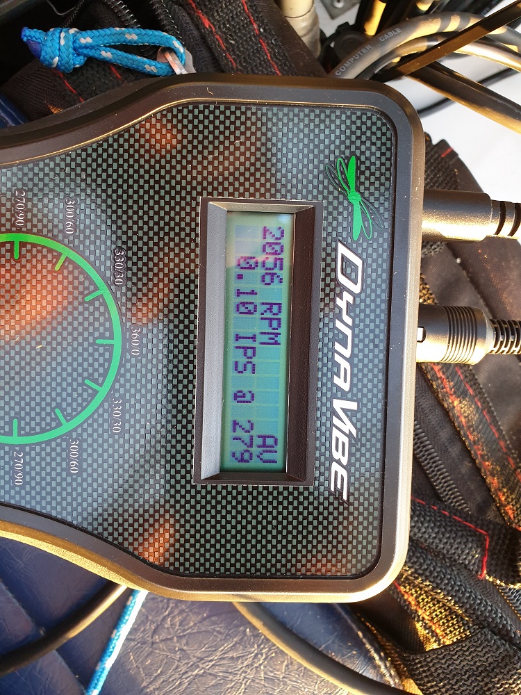

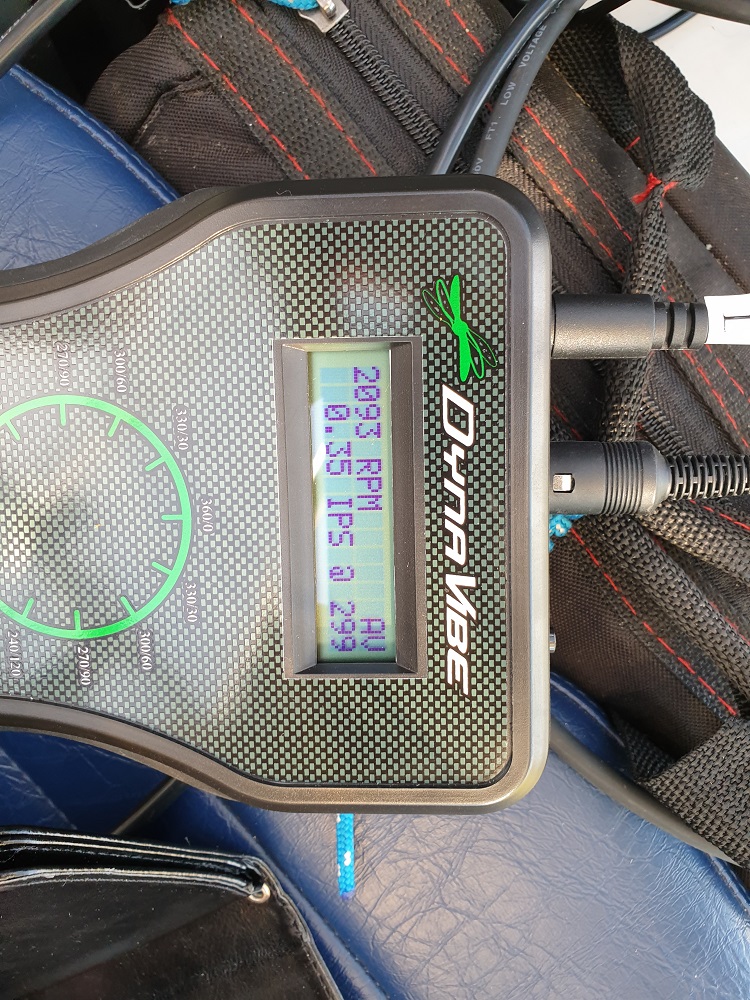

Blueadventures Posted April 18, 2020 Posted April 18, 2020 Hi I'm doing a first dynamic balance of a Rotax 912 ULS2 using a Dynavibe. Would be keen to here from persons who have done the same to their rotax. Just wondering where the weights were fitted. eg under propeller bolt heads or elsewhere. First run showed 0.35 at 299 degrees at my cruise rpm about 5,000 rpm (note the 2058 rpm is after gearbox ratio) I made a timber protector to ascertain where the added weight is required. I marked the side were the 299 degree mark is. Thanks in advance.

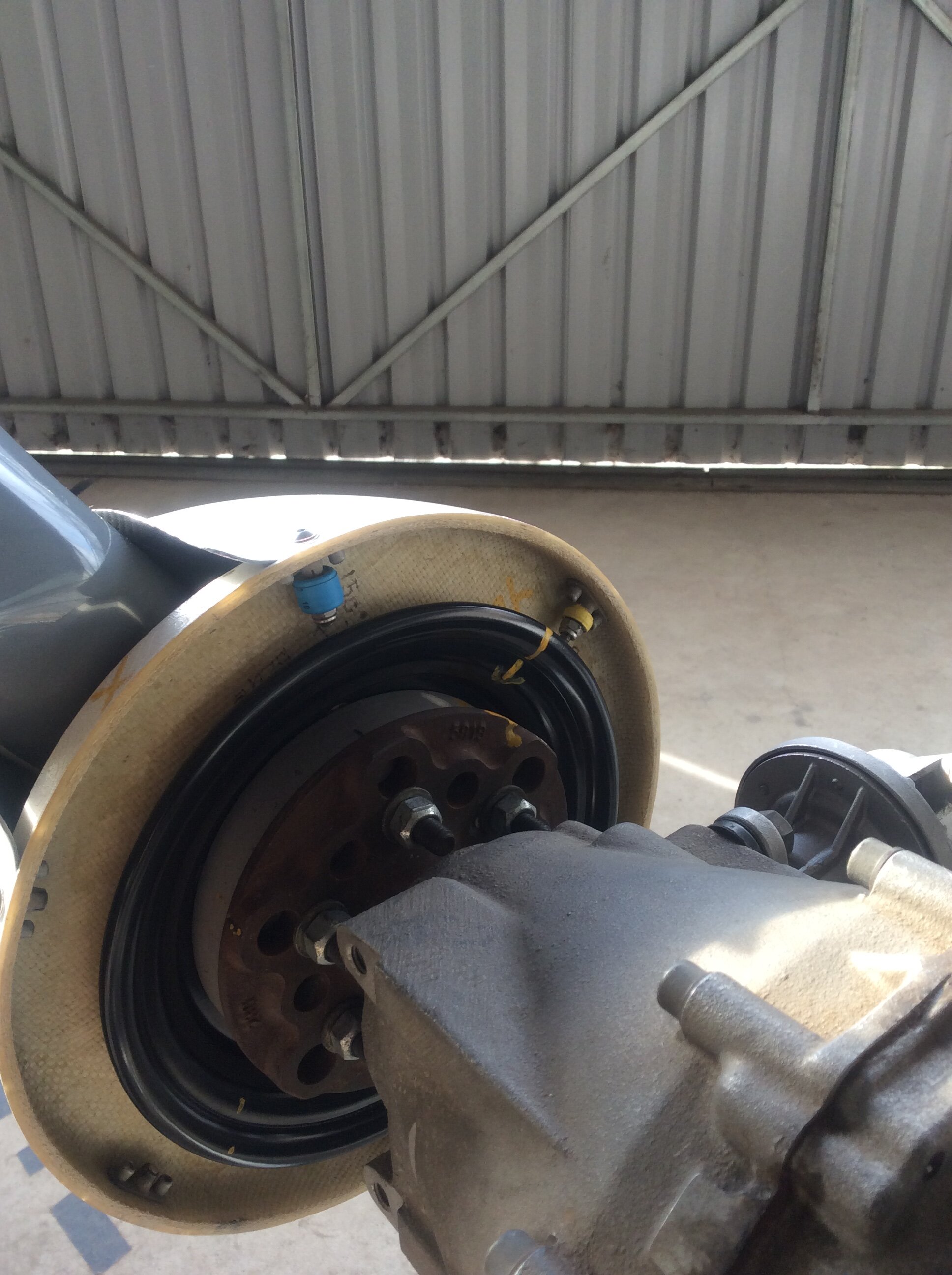

Paul davenport Posted April 18, 2020 Posted April 18, 2020 I have been balancing props for some years now, using an Aces balancer. I use stick on alloy wheel balance weights which are easy to reposition . For the final solution I use one of several methods . I prefer stick on weights which if you use the inside ledge inside the spinner can give you the best results allowing you to access 360 degrees ,allowing for greater accuracy. Small washers can be used under the spinner screw also different length screws allow for some weight, but this method is only really good for small amounts of imbalance. Washers under the prop mounting is only a last resort as it does not give you the fine tune of 360 degrees. Be aware if you balance without the spinner on fitting it will in some instances throw out the balance . Balancing is rewarding when you get it right but can be frustrating. On finishing the balancing job I use a product called Sikaflex as a bonding agent, this stuff sets as rubber and unless you cut it does not let the weight go. Paul 1
Kyle Communications Posted April 18, 2020 Posted April 18, 2020 (edited) I have my own Dynavibe. With the dynavibe came some compass type charts which once you have set the reflective strip it is being the 0 deg position then the clock face is looking at the back of the prop I use the stick on weights the same as Paul on the inside rear lip of the spinner so centrifugal force keeps the weights against the spinner I dont use sikaflex just the stick on weight. But you MUST have the carbs scrupulously balanced before you do the dynamic balance Just noticed where your strip is too..you need to have the transmitter and receiver right behind the prop and I put the reflective strip on the top back side of the spinner base I also made a bent bracket that goes where your TX/RX is but positioned directly in the centre of the engine..I dont think I have any pics but will check Edited April 18, 2020 by Kyle Communications 1

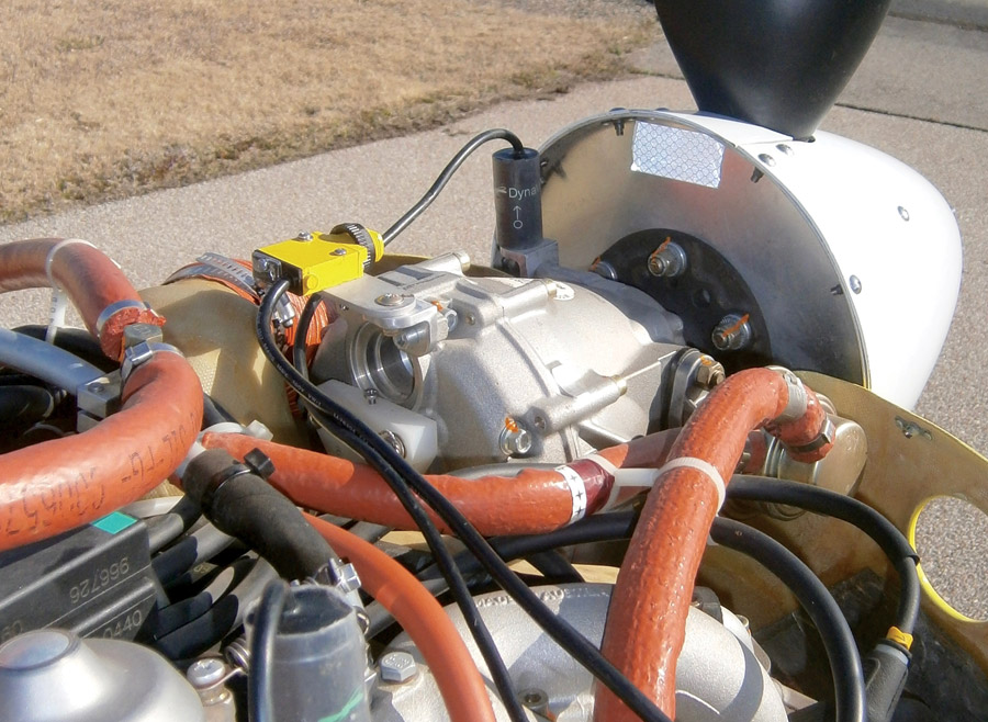

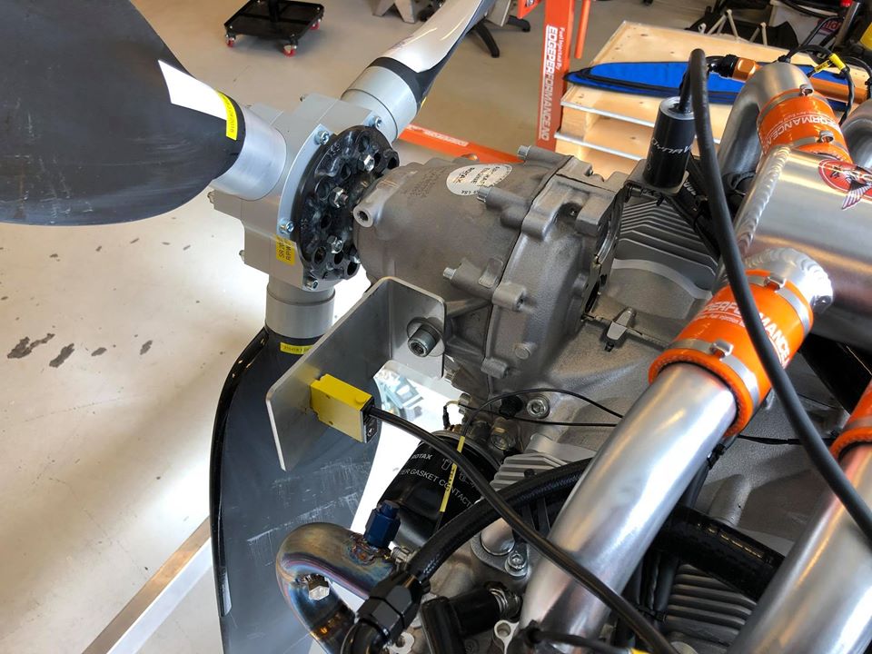

Kyle Communications Posted April 18, 2020 Posted April 18, 2020 Mike You will see it at the start of the video my bracket https://www.youtube.com/watch?v=iZ8GqUNUcbM:1 1

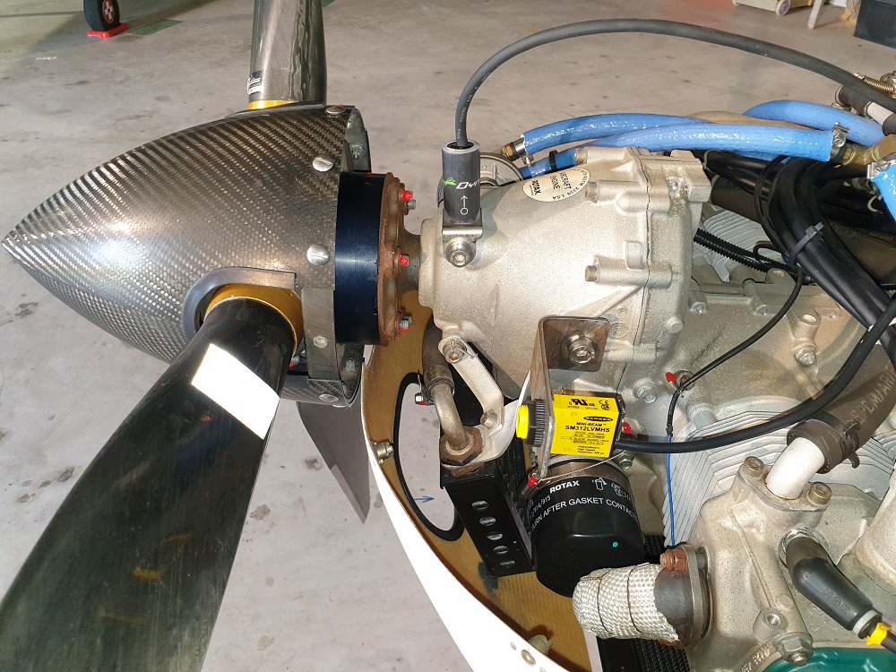

Blueadventures Posted April 18, 2020 Author Posted April 18, 2020 Hi Paul and Mark thanks for tonight's replies. I have redone the optic sensor bracket (at home tonight) to mount behind the accelerator sensor and tape the root of the prop blade. With the set up in my post I have got balance to 0.05 which is getting near very good. Another 915 up here had the weights placed in behind the blade hub and I could not see that. He said I should place weight under the head of the prop bolt that mounts to the gear box flange. I see Edge performance mount the sensors similar to mine. It's ok I believe to mount the optic sensor were I had it (I am mounting on top tomorrow) as you turn the prop until the optic light is on then stop and measure the degrees from the accelerator position as zero (at 12 o'clock in my original setup) I did get mixed up Thursday arvo when I measured the degrees from the optic position. (Was 90 degrees out) Then got it sorted that night. Attached are some images from the net re positioning; the Edge Performance guys should know what they are doing :) Thanks also for the video. I have between 0.10 and 0.05 without the balance master (Happy with this; just need to permanently place the added weight about 6.5g) on so expect the balance master will bring it down even further. The DUC blades are nice kit. Cheers and really appreciate the comments.

Kyle Communications Posted April 18, 2020 Posted April 18, 2020 Dont forget that the rotax engines are NOT balanced either. It will be interesting when we get this new engine of mine running which is fully balanced. We have also come up with a solution to get the engine at least to a better balance by balancing the flywheel only to suit the offset of the cranks in a std rotax. It should also make a big difference as currently you are compensating the engine balance with the prop as well
Kyle Communications Posted April 18, 2020 Posted April 18, 2020 Your reflective strip is pretty wide too on the prop 1

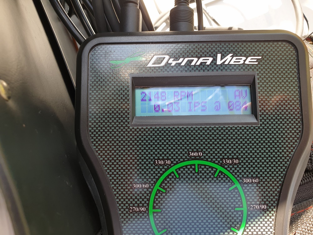

Blueadventures Posted April 19, 2020 Author Posted April 19, 2020 Your reflective strip is pretty wide too on the prop Hi Mark the manual said 1.9 inch wide. At 5,000 got average of 0.03. So happy with that. The new optical position was above the gear housing. I'll make a new mount for 912 so both sensors are over the centre line. The 0.03 reading is without the balance master fitted. The owner of the dyna is happy with my learning and the new brackets and has let me have the unit longer. I'll do some comparisons with the excelerator sensor mounts and positioning, so I can confirm my beliefs about the angle determination method. Cheers

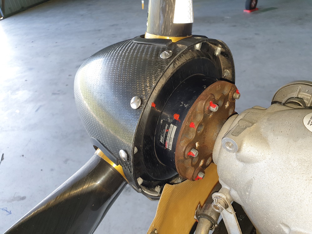

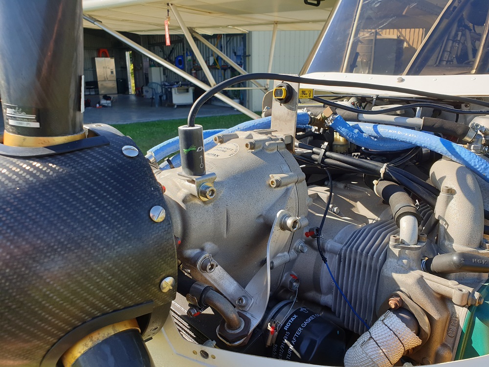

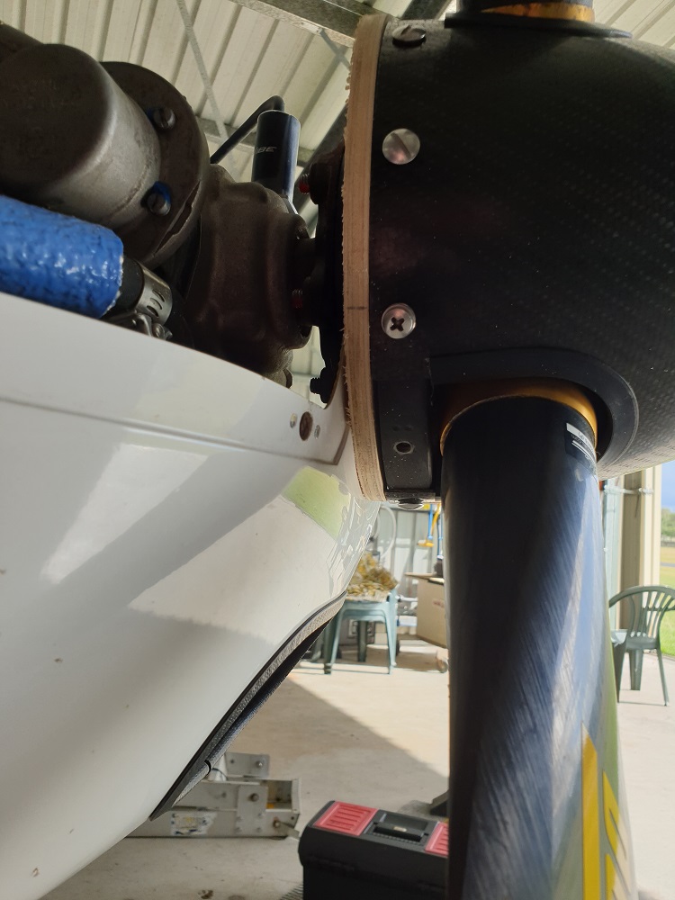

Blueadventures Posted April 19, 2020 Author Posted April 19, 2020 Finished the balance today. Relocated the optic sensor and first run (no weight) was 0.33 so added weights and the finish mass fitted was 9.25g and at 4,900 ish rpm the magnitude was 0.03 so happy with that. Will do a flight this week; some time all things considered. Images show the sensor position today and the average readings at first run (no weight) and the final run with 9.25g fitted. I am making a new sensor bracket and will do a run (in about 10 days time, need a break to do other choirs) with today's setup and then the new setup and compare the angle required etc. I'll fit a narrow reflective strip as well to see if anything changes. I expect not as edge and other use the 1.9" size reflective strip. Cheers

Paul davenport Posted April 20, 2020 Posted April 20, 2020 Point taken skip I did mention static balancing in my previous message but what in effect you are doing when you dynamically balance the prop is fine tuning a lot of other issues . Fitting the weights inside the spinner is far better than drilling holes (as I have seen) and having the risk of crack developing. And if the weight comes off?. That’s why I use sikaflex. I have seen props come back from overhaul balanced by the experts still requiring that fine tune . I suspect that it might be as much engine issues as props, but whose got the money and time to persu that one 1
