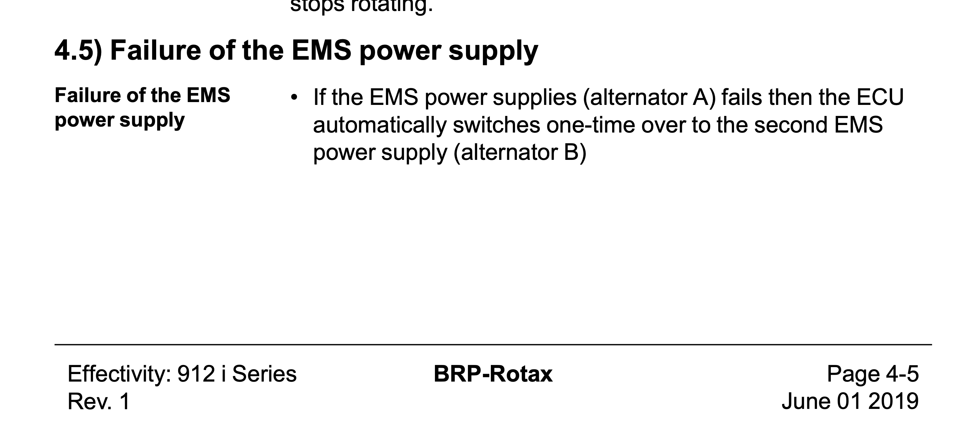

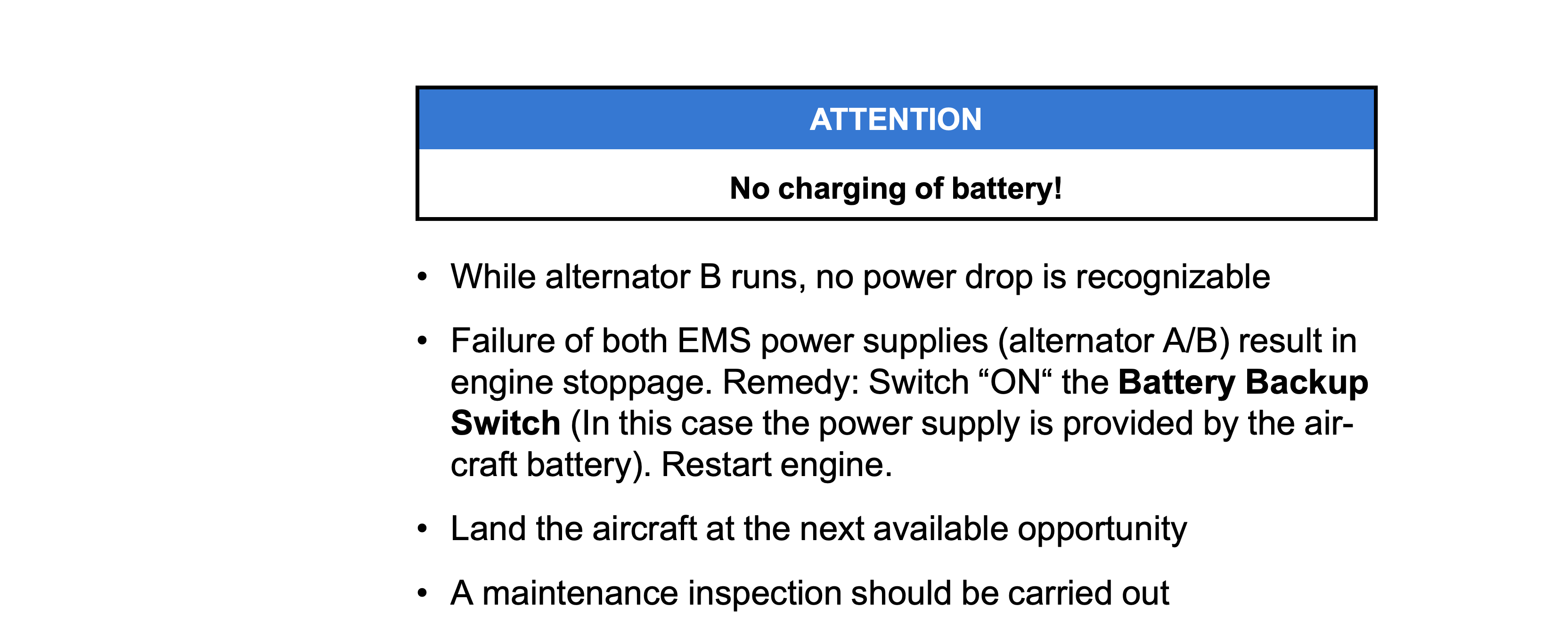

Great video! Well done Kyle! Dunno what happened to the electrical system. If it was an injected engine, The engine shouldn’t have been running on battery at all unless the emergency power switch is selected on - which is also your cue to head home PDQ.The falling battery voltage should also have given the game away. I’d like to know what failed beyond the comment on the video : “alternator and battery”. Reference? Pages 4-5 and 4-6 of engine operators manual.

I would like to know how this failure happened. Have read the POH for the Sling2 with 912is. Alternator failure will show on the lane a or b warning lights and the airplane should be landed asap, then there is the second alternator and then the battery. The odds of all three failing would be many millions to one.
