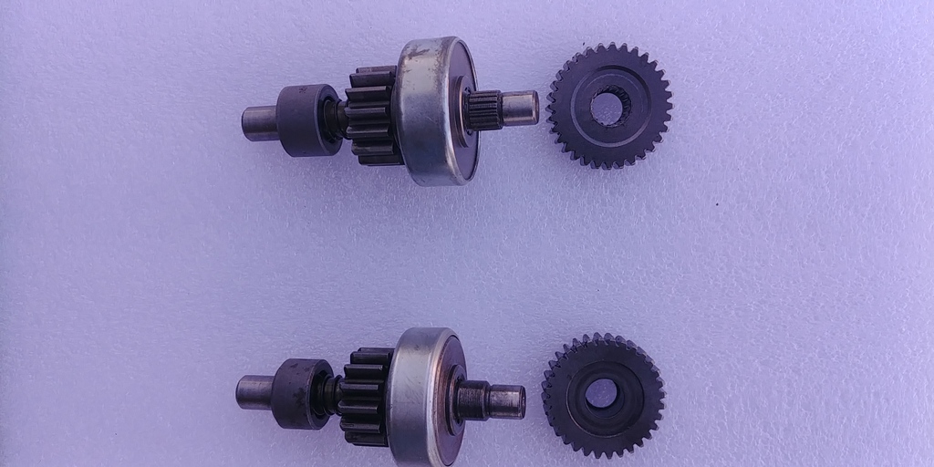

kgwilson Posted May 27, 2020 Posted May 27, 2020 Yes there is a shim washer and a new one comes with the new clutch assembly. I now have 2 clutch assemblies & 2 shim washers & both look to be in perfect condition. The clutch itself looks like an encased bearing & flies out on the shaft when the starter is activated. I imagine there are 2 face plates inside it with a calibrated spring to hold it until a certain amount of torque is applied. 1

kgwilson Posted May 30, 2020 Posted May 30, 2020 I found my old starter bendix/clutch & compared it to the new failed one & that is when I found out what the problem is. The sprag clutches on both are perfect so it isn't that. The main drive cog which is meshed to a pinion on the starter motor rotor is attached to the bendix shaft that has the sprag clutch & throws the pinion on to the ring gear. On the first one I had, it fits on a spline but on the later one it appears to have just been pressed on without any spline. The fit has let go and spins on the shaft. Pretty poor improvement as it lasted about 120 starts. There are slight differences with the size of the sprag clutch and thrust bearing. The first one was replaced when it stopped engaging the ring gear & was just grinding at the edge of the teeth. The length dimensions of both are identical so I have never been able to figure out why the first one stopped meshing with the ring gear. 1 3
facthunter Posted May 30, 2020 Posted May 30, 2020 The press fit is not adequate. Someone's cut corners there. Only the inertia of the starter spinning throws that pinion into mesh and any stickiness in the fast multi start throw in or tight mesh of the gear will make the engagement unreliable. Going through a reduction makes it less likely to work satisfactorily also. Nev

kgwilson Posted June 2, 2020 Posted June 2, 2020 Just so you know, Jabiru are replacing the starter clutch & paying the freight for me to send the failed one back. They confirmed that the supplier of the one with the pressed on gear is different (& I imagine cheaper) from the original with the gear on a spline. There have been a number of the older type that eventually failed like my one did. That is it would not fully engage the ring gear when fired and the pinion just ground at the edge of the ring gear. No real damage was done though. I could not ascertain why it wouldn't as the bendix was fine and movement on the shaft smooth. The thrust bearing though was notchy so this is the only thing I can think of that could cause it not to engage, however by the time the pinion hits the thrust bearing it is in theory already fully meshed with the ring gear. The pressed on gear starter clutch has some subtle differences. The spag clutch is a little narrower and the thrust bearing has a bevelled face at the shaft bush end. This thrust bearing can be moved back against the bendix return spring as well exposing a stop circlip on the shaft. This is apparently the first failure of the pressed on gear they have had. I hope it is the last.

kgwilson Posted June 5, 2020 Posted June 5, 2020 Installed the new clutch & flew yesterday. It is virtually the same as the original with the main drive gear fitted on the shaft via a spline so the press fitted versions were obviously not successful. The only noticeable difference is the main drive gear is slab sided and there is no shim washer between the gear and motor bushing. The original was indeed a Honda confirmed by Jabiru but now are manufactured in China specifically for Jabiru. 1
