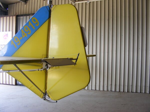

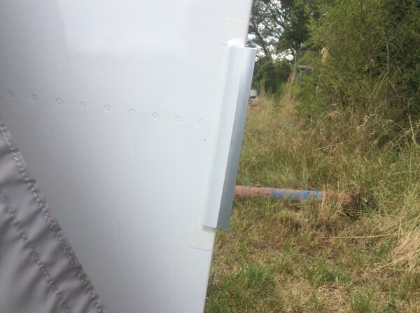

BrendAn Posted January 9 Posted January 9 Old thread but I wanted to bring up the trim subject again. We spoke about it a few weeks back. Seems I am keeping the xair I would like to fix the trim issues. We discussed fixed tabs but I am not keen on them. I can fit a Bungy in the cockpit from the stick to a fixed central point to correct the aileron roll . Trying to figure out what to do with the rudder. Still some sort of bungi system but where to attach it. Or possibly a cable operated rudder trim tab as last resort. Looking for ideas.
skippydiesel Posted January 10 Posted January 10 Hi BrendAn, I am going down a similar track for my Sonex - flies straight & level, hands/feet off, in Cruise with just me aboard. Stick a good sized adult (75kg+) in the right seat and a load of aileron & rudder trim is required. I had a bungee aileron trlm on my Zephyr, didnt need it for the rudder. Very simple/intuitive & light weight. Worked very well. I have acquired a whole role of bungee/shock cord with which to make the trim system. Will need at least two pulleys and one cam cleat per trim (rudder/aileron). I have been checking out variose marine suppliers for the pulleys & cleats - all available. Yet to work out the location of pullies . I rarely have a passenger, so no rush to do the job- get down to it in the cooler months. I may be able to help you with some shock cord. 😈 1
BrendAn Posted January 10 Posted January 10 (edited) i can do a very simple bungie trim off the left stick, i only need slight right pressure to maintain level flight. xair ailerons can't be adjusted independently otherwise i could get what i want with adjustment. that idea might be wrong anyway. still need to figure out something for the rudder. preferably in the cockpit as well. Edited January 10 by BrendAn
robinsm Posted January 10 Posted January 10 had a small fixed trim tab attached to my ruder on my Xair. Once adjusted, flew hands off in a straight line. Simple but effective. 1 1
facthunter Posted January 10 Posted January 10 You only Need Pitch trim unless it has Multiple engines that are off centre. Set it to work in Level cruise with the FIXED tab.. It's NOT a Spitfire.. I've seen a few people get crossed up with rudder and aileron trim. Not good when you do that. Nev 1
BrendAn Posted January 10 Posted January 10 1 hour ago, robinsm said: had a small fixed trim tab attached to my ruder on my Xair. Once adjusted, flew hands off in a straight line. Simple but effective. 1 hour ago, robinsm said: had a small fixed trim tab attached to my ruder on my Xair. Once adjusted, flew hands off in a straight line. Simple but effective. Yes. That's the normal way. Blue a sent a pic of one similar.. my thruster had a fixed tabs in the ailerons . I can do this I just don't like drilling holes through the Dacron. 1
