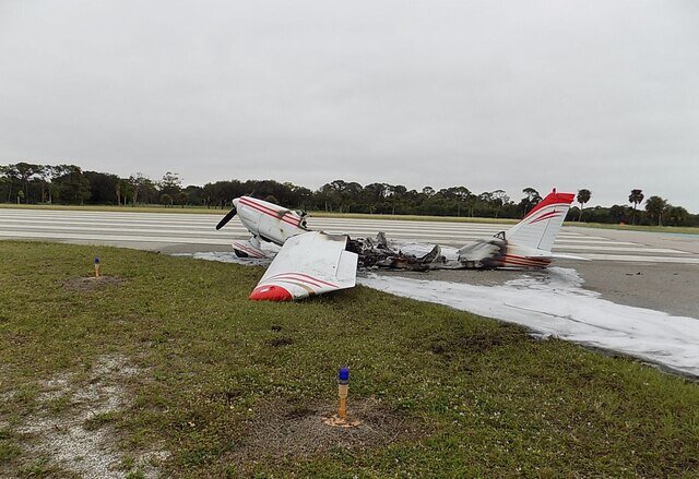

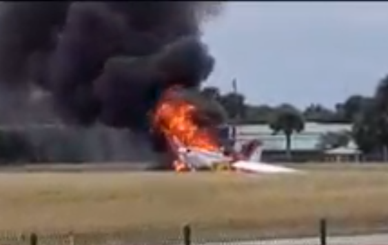

red750 Posted November 18, 2019 Posted November 18, 2019 The pilot of a Piper Cherokee smelled smoke while taxying for take-off at Venice Airport Florida. He and his passenger disembarked to check the source of the smoke, and the plane burst into flames and was destroyed. Both pilot and passenger were uninjured.

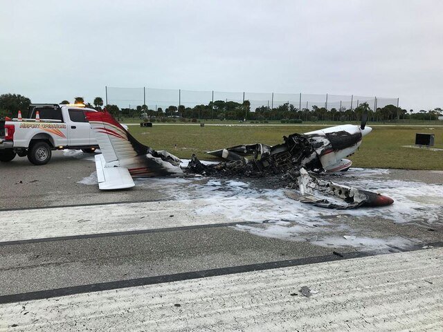

onetrack Posted November 19, 2019 Posted November 19, 2019 According to the passenger, he first sighted smoke from under the starboard wing, near the landing gear. As Facthunter says, there's no damage forward of the firewall, so it wasn't an engine fire. If you look closely, you can see the fire was concentrated in the inner starboard wing area. Interestingly, they were carrying 80 galls of fuel, and the firefighters still managed to recover 30 gallons from the port wing tank/s. https://www.heraldtribune.com/news/20191117/fire-engulfs-plane-at-venice-airport https://www.mysuncoast.com/2019/11/17/small-airplane-catches-fire-while-departing-venice-airport/
facthunter Posted November 19, 2019 Posted November 19, 2019 It's probably a split rubber fuel cell. They don't last forever. Just almost forever. We hope. Don't ignore any petrol smells. Nev 1
