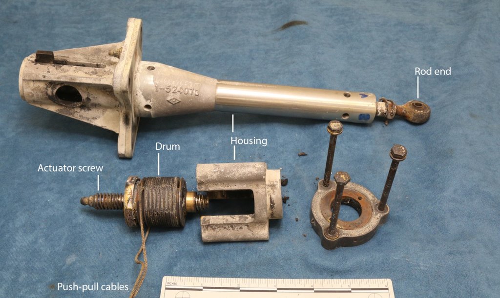

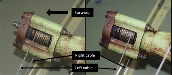

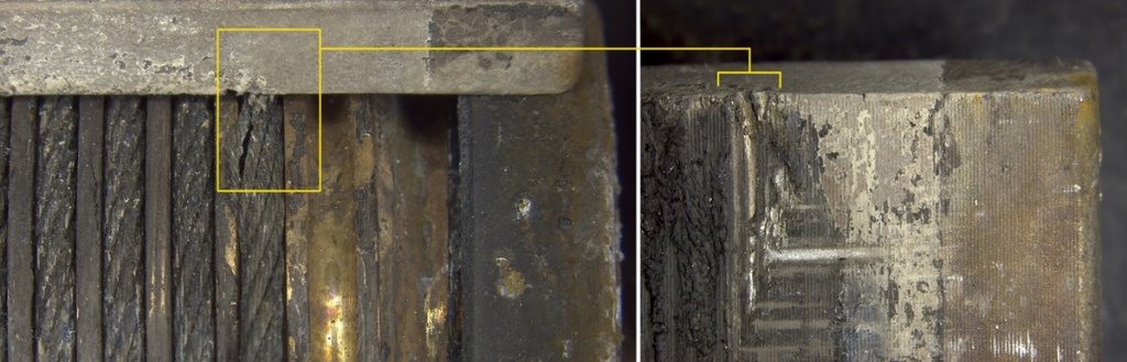

Thruster88 Posted August 20, 2019 Posted August 20, 2019 Looks very similar to Essendon, especially the side yaw. I still believe that at Essendon the rudder trim cable could have been pulled early in the impact sequence, the left cable was found broken so some force was applied. The fin structure still intact at this point guided the cable on and off the drum in the normal way until the structure deformed leaving the witness mark in the actuator at the full left rudder trim position. If the the trim was full left prior to take off how did it get there. Why didn't the pilot adjust the trim if he was standing on the right rudder. So many unanswered questions.

facthunter Posted March 16, 2023 Posted March 16, 2023 The comments section contained little of value, really. With 2 engines running at achievable power the Plane should have been easily able to stay airborne even with the U/C still extended. Trim is often wound through full travel during the first flight of the day but always returned to central unless otherwise specified like for a high powered piston single. tailwheel. I've had a lot of discussion including with pilots who operated out of Essendon at that time. No conclusive cause is established as far as I know. A lot of things don't add up but pilot incapacity of some kind seems a possible cause. (to me).. Nev.
