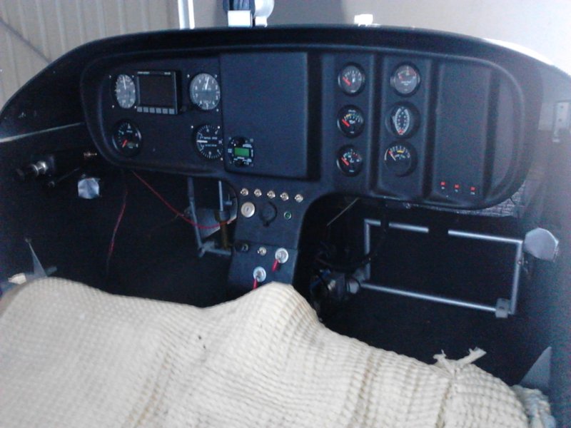

If anyone is interested this is my panel and control layout I designed for myself. The photo was taken during construction so there are no labels etc yet. On the left is the throttle, carb heat & electric flap switch. Left side of the panel is ASI top & tacho below, middle Dynon D6, then ALT top & VSI bottom. Centre bottom left is radio with the rest of the space for the ipadOz runways. Below that the switch cluster, ignition & power outlet for ipad etc & alternator charge light. On the floor mounted centre console is the choke below the ignition, then aux fuel switch with the Left / Right tank selector below. The main centre tank on/off selector is on the right at the top. The left side has the engine instruments angled towards the pilot with circuit breakers & warning label space above. The centre stick is under the blanket with the trim wheel behind.
Fair point Yenn. I have just used a 3d printer to get a conversion from a big instrument to a small one ( without angling) , and you are probably right about not being able to retrofit a crowded panel but you must agree kg's panel looks good. And it is clearly readable from the RH seat.
It does look good and no doubt safer than a non angled panel. It is the rules that are stupid, but if they could all be disregarded, then we would see all sorts of stupid modifications to LSA and the whole purpose of LSA would be usurped.
