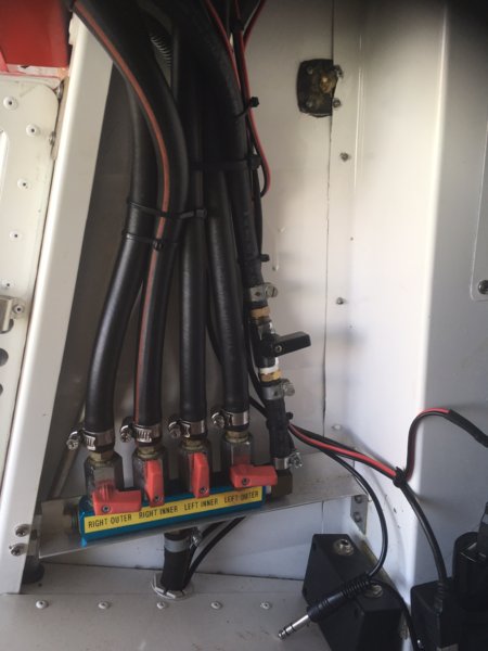

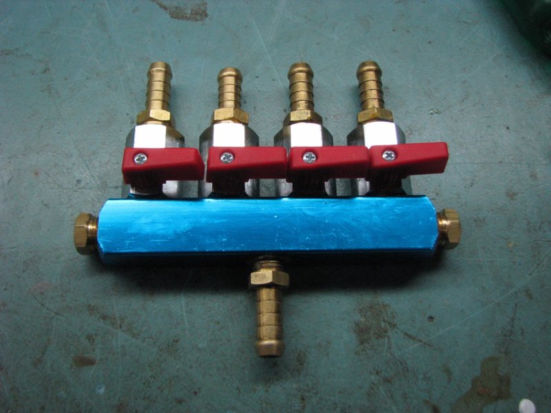

Kyle Communications Posted August 22, 2017 Posted August 22, 2017 Marty Its a controversial subject :) My system has 4 tanks all individual coming to a 4 way manifold with separate switches for each tank. The output for that goes into the top of the collector tank. The other inlet into that collector tank I use as a breather that goes all the way to the top of the pax side inner tank . My overflow from the rotax fuel system goes back to the manifold and enters there but I do have a tap on it so I can tuen it on or off as I want or need to. This way I do not get vapour locks in the collector and I have full control of all fuel in the aircraft at a individual tank level. I have some pics I will find and post them here. I am dying from the man flu at the monent so will get out to the shed soon and get some pics for you. The fuel pipe system in a Sav uses a lot of alu tube connected with lengths of hose..it stops a lot of vibration issues Mark

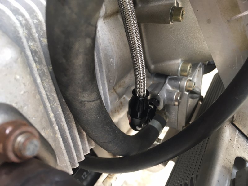

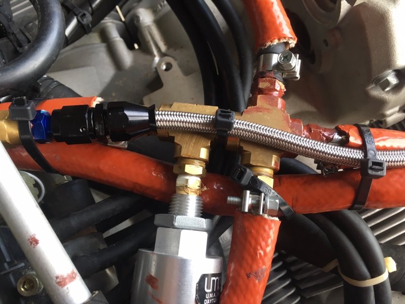

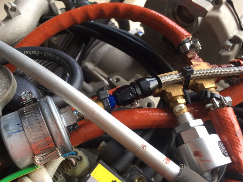

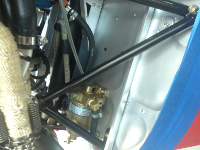

Kyle Communications Posted August 22, 2017 Posted August 22, 2017 The return line from the motor is supposed to go direct to the right inner tank but I changed mine when I made the manifold so that the return goes direct into the side port of the manifold...it will become clearer when I post some pics. The fuel lines from the collector to the engine are made up from alu tube mostly but do have rubber hose in parts so it sort of breaks it up. It comes from under the front floor from the main fuel switch then around the corner at the firewall then in mine it goes to a gasculator/filter then up to the fuel splitter

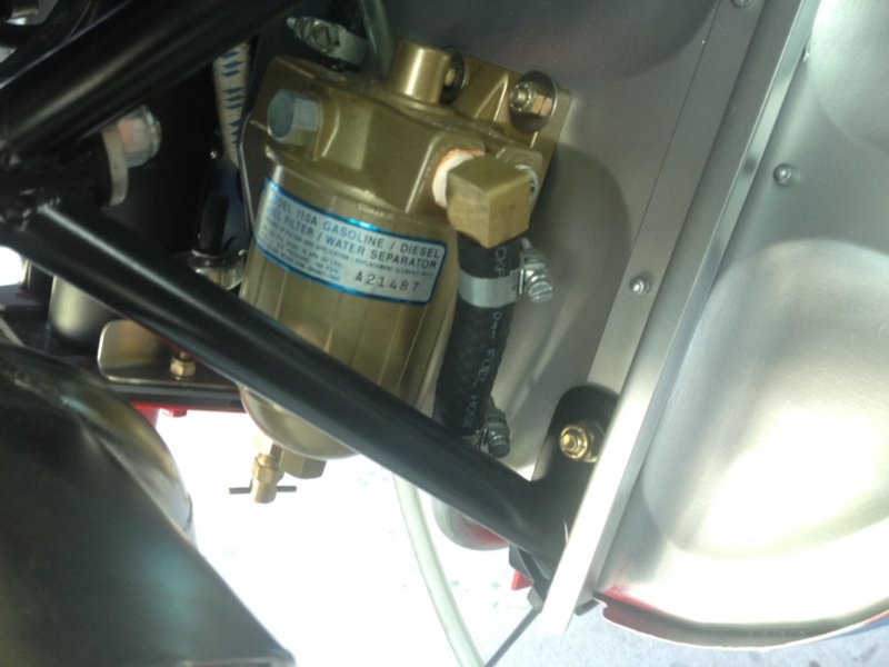

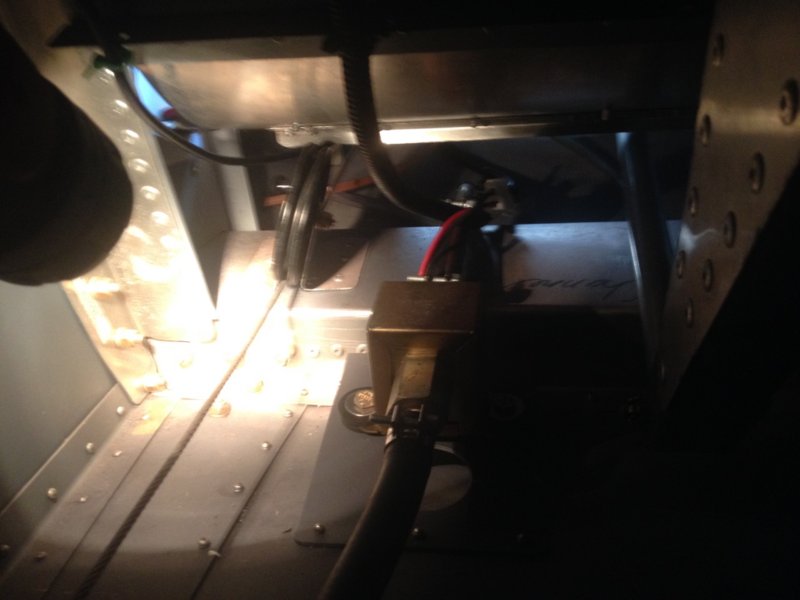

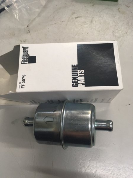

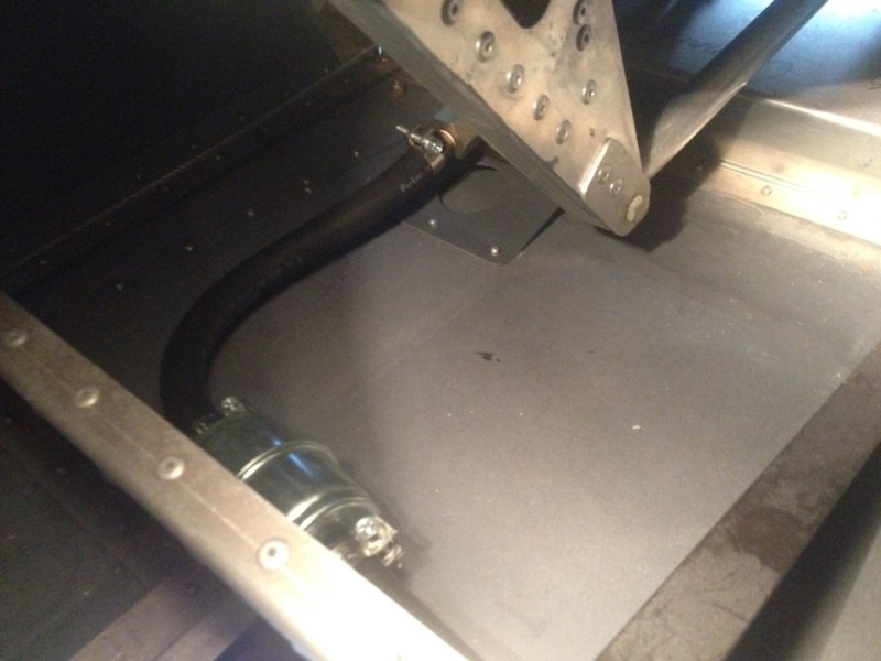

Kyle Communications Posted August 22, 2017 Posted August 22, 2017 I didnt have a gascolator originally I had that stupid motor mower filter they supply so I wanted something better so looked at a few and the one I have I got locally it has a filter inside it but its not too fine. What I did though is I shifted my fuel pump to under the seat to get it away from the firewall and that stupid cover it had and was also a nightmare to get to. Its now easier to get to through the access hole also I have a sealed proper fuel filter at the bottom of the collector now and I change it every 12 months or so. I have a new one here I am about to replace now. The pic showing the girlfriend you can see the system on the pax side of the wall behind the seat so it is easily got to while flying. The one showing the manifold and hoses you can see the right hand end where the fuel return from the engine comes to into the end of the manifold and I have a tap there in that line so I can turn it off. I turn it off to see the actual fuel flow to the engine as my fuel flow sender is on top of the engine at the new fuel spitter I made as the kit one I repaired 3 times from leaking it was crap. I have attached some pics of the one I made. Its a little heavy as its all brass but works a treat and of course gives me the fuel flow sender point. Also I modified my oil pressure sender position. When its mounted on the block they fail due to vibration especially the older type with the resistor. I had the honeywell one electronic type but it failed at 150 hours and they want another 400 bucks for another so I used the older VDO type as they are cheap and just as good but fail because they are attached to the block so I made a flylead up and you can see it now on the top of the motor near my fuel splitter and it works fine. My MGL Xtreme Rdac can take in either type of sender unit 1
Kyle Communications Posted August 22, 2017 Posted August 22, 2017 The gascolator also traps any water that may get through the system and of course has a filter and it was what help me diagnose the issue when Mike was flying and the engine went stupid..coming across Moreton Bay..when he landed to get back on the ground in a hurry is when the noseleg got snapped off and I had to fix her up. I thought it was throttle cables but after I replaced them all and checked everything I could when I started the engine I was doing full power runs when the engine wanted to tear itself out of the mount...this is what he experienced coming across the bay...it ended up being a blockage in the fuel line. A piece of thin plastic from inside the fuel tank..had come off and gone all the way down the system and got trapped at the bend of the alu pipe where it comes under the firewall. This was before I had the sealed filter between the gascolator and the collector. This was causeing the bowls in the engine to empty at full power so the engine was starving as this plastic had turned sideways in the alu pipe. I found it when I turned on the drain tap on the gascolator..fuel was not gushing out it was trickling out so I chased why and that is what caused the whole issue. So having one I think is a good thing for the filtering it does and allows other diagnosing of any issue 1

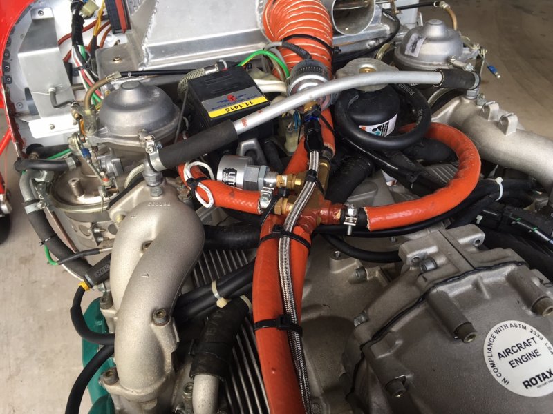

Marty_d Posted August 22, 2017 Author Posted August 22, 2017 The one showing the manifold and hoses you can see the right hand end where the fuel return from the engine comes to into the end of the manifold and I have a tap there in that line so I can turn it off. Yep that's pretty clear Mark, very nice setup. Just a question about the return from the engine though - so I get that it goes back in to the end of the manifold. Have you got a one-way valve or something? Just wondering why the fuel pressure from the tanks wouldn't force fuel backwards through the return line, or is the pressure from the return line more than the gravity flow from tanks?
Marty_d Posted August 22, 2017 Author Posted August 22, 2017 Also - do I have this right - looks like you're not using the 7L header tank that the Savannahs usually have, you're going straight from the manifold down to the bottom filter then along to the pump?
Kyle Communications Posted August 22, 2017 Posted August 22, 2017 The second input to the top of the collector is my breather. You cant see it in the pics but it comes from the collector then goes all the way up the side of the aircraft and connects at the top of the inner right side tank at the pipe I have coming out of the tank for my fuel sight gauge. The total fuel weight overcomes any pressure from the engine return which is about 3 litres per hour which is quite low anyway. We are working on a system to see how much fuel you have left at the moment and it works on that pressure idea. The other end of my manifold has a plug in it. We think a pressure gauge will show how much "weight" you have in fuel. If you only have 1 tap open you will see how much fuel will be in that tank and you could do that with all tanks or one at a time. The pressure required will be small but a gauge that goes from 0 to 2 PSI we think will do the trick and it can be callobrated easily with volume etc and all the fuel being about 500mm head from the gauge it should work so thats another project we are working on
Kyle Communications Posted August 22, 2017 Posted August 22, 2017 That single pipe from the bottom middle of my manifold goes into 1 of the 2 inputs at the top of the sump/collector and the other opening in the top I use for the breather as explained above
Kyle Communications Posted August 22, 2017 Posted August 22, 2017 sump/collector = 7 litre header tank
Kyle Communications Posted August 22, 2017 Posted August 22, 2017 The hole in the original savannah splitter Tee for the fuel bleed back to the tank is 0.3mm this gives about 3 litre per hr...mine is about 0.4mm that I made and I can see this when I turn that tap on and off on the fuel return line. As the system is essentially a closed system that fuel return pressure doesnt really make any difference I think as it all just levels itself out in the long run
