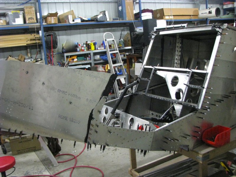

when you have curves always try to use a ratchet strap or straps to help bend...there maybe a lot of tension...like when doing the D section on te wings

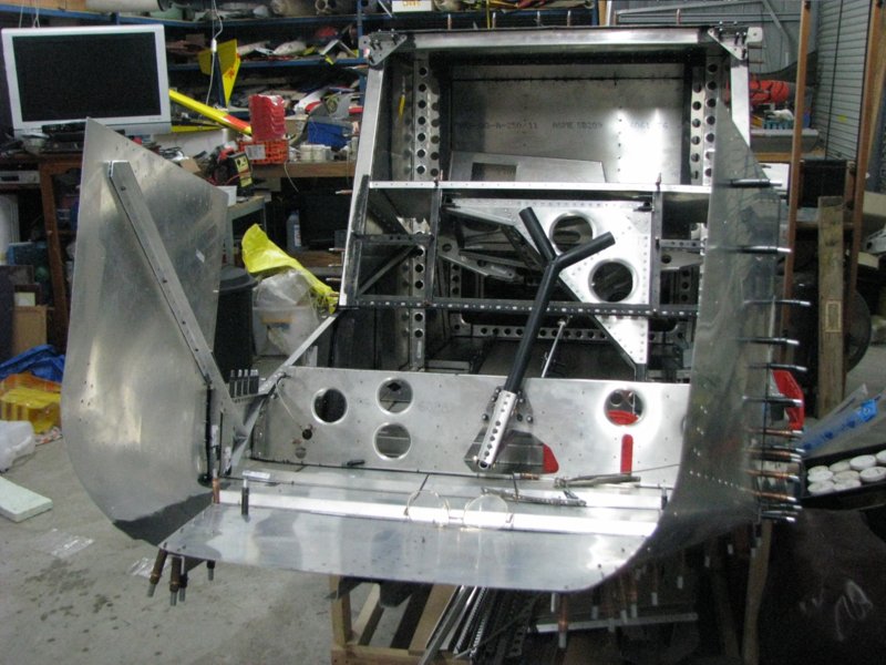

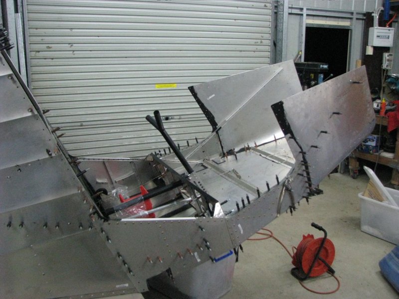

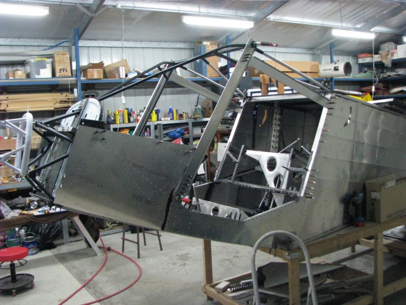

Usually if it doesnt fit reasonably easy you have done something wrong...pics of when I did mine..make sure you have the floor the right way the over and under cross overs etc for the panels

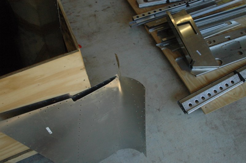

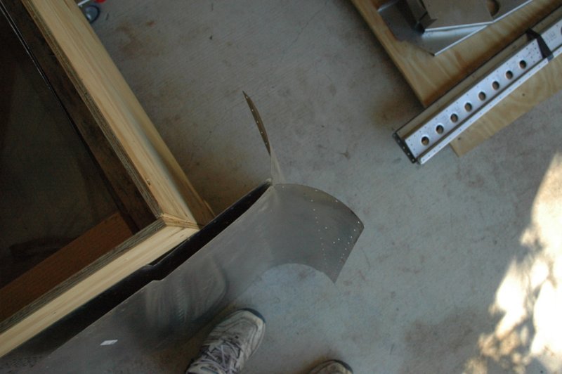

Where you sidewall factory bent also?

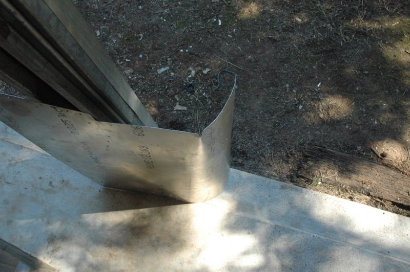

So you have a part that is precurved to a radius, but needs to have that shape tapered like a cone, until it is almost a right angle bend at the rear end.

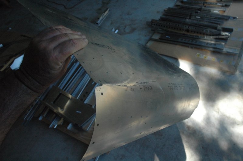

I'm pretty sure I put the part over the edge of the bench, and simply worked it to that shape by hand, literally pressing it with my hand with a series of strokes, gradually working it to a conical shape before fitting it. Maybe 5 minutes to do each side, don't hurry it.
It's easy enough: that is also how I shaped the leading edge of the wingtips.

Mine was a lot squarer in those corners..the factory had done that. I think I manipulated them to make a nicer fit..it was 6 years ago now :)
Mine is perfectly round from side to side
"puh" means releasing compressed air out of your mouth in an act of release or understanding the nessesarity
you cant fit a square peg in a round hole if its not the right size.....the corner of the fuselage is square so you are going to have to reshape it to fit...then it may all fit together

Bob's explanation of how to form this skin is pretty good. In order to get an exact bend point, I measured from the edge of both holes (vertical and bottom) into the middle of the corner, on the factory assembled sides. Then transfer these measurements onto the skin that you need to reshape. Place that mark on the edge of a bench, and bend it by hand around the edge. You may want to shape the corner of your bench to the correct radius. That way, you will avoid bending it too sharply. The sharp part needs to be only where the skin sits into the factory side. From that point going forward, as Bob said, the radius gradually increases. To form the radius going forward, place the skin over something like a metal tube and massage the aluminium by hand. It's easy enough, but still a pity that ICP don't form this part, as it seems they used to looking at Marks photo.

Hi MajorTom. From memory, the construction manual indicates to fit the firewall in two halves, as you are doing it. You may well end up buckling/bending it if you do that. You will find it a lot easier to build up the firewall into one piece, complete with all of the stiffeners/ribs. With it in one piece you may still think that it belongs to a different aircraft, however, it will fit/start to take shape as you cleco it onto the fuselage. I started pinning from the bottom and worked my way up each side evenly. You will see that as each side takes shape, there will be considerable curvature starting to occur fore and aft on the floor panel, including along the right angle stringers that run the length of the cockpit. Rest assured, this is correct. You need to use a tapered mandrel/podger to get the holes to line up around the firewall. One other piece of advice. The firewall is quite rigid once it is riveted, so leave it clecoed (ie: don't rivet) until you fit the upper panel, as you may need to move it slightly in order to pick up the holes in the upper panel.

I thought the same. First thing, ensure you have the tabs around the firewall bent to the correct angle, so that they will sit flat onto the lower (and upper) skins. (Cut a slot in the end on a piece of wood and slide this over each tab in order to bend it) To fit the firewall, pull the top of the sides apart. Initially you will think it won't fit, but once you start installing the cleco's, it will start taking shape. Regarding the stiffeners that you have already riveted, no problem, but you may want to leave perhaps the forward two or three rivets out, to allow you to insert the firewall. Those stiffeners sit on top (inboard) of the firewall tabs, so you need a little bit of flexibility while wriggling it in place. It's a fiddle job, but hang in there.

Just to reiterate, build the firewall structure up. (Or at the very least, cleco it all together) The ribs will keep it flat as you are installing it into the fuselage.
  • Helpful 1
Slide it in from the front, initially tilt the bottom in and then pull the sides apart and then ease the firewall rear wards.
