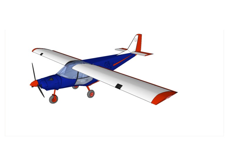

I am looking for ideas for the colour scheme for a Savannah S. I hope to paint the plane myself so it needs to be fairly simple. So far I have come up with the scheme in the attached image. I really like this one too ACCUEIL - GEMILIS-AERO. All ideas welcome

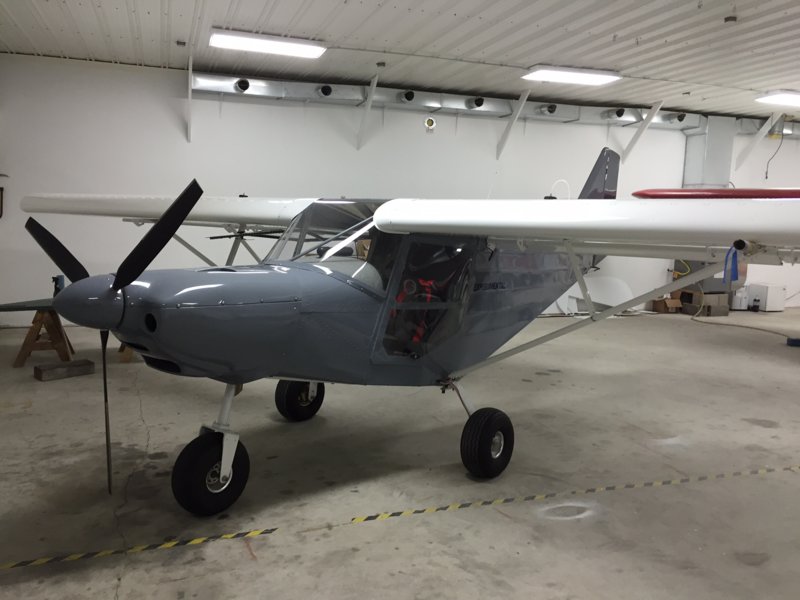

hi , this is my second savannah , it is 646 lbs empty , one way I saved weight on this one is all pieces were epoxy primed before assembly using ppg dp colored primers the I just clear coated the primer on the exterior, simple light weight, I also made fiberglass wingroot fairings and fiberglass windshield retainer, also shortened cowl because of shorter warp drive prop extension
Some other ideas i was playing with
finished Product

I went through the sketches and chose the one you went for! They are really original and make it stand out from the crowd. I still can't decide but I want something simple to do
I dont understand. Which one?
And what is simple? There is so much preparing to do befor the first use of the paintgun. That I guess is hardest. I am absolut beginner in paint. When all is nicly primed, most work is done. At least in my thaughts.... Dont know if this is realistic...
The last picture of the finished plane. for me simple would be each part has a single colour so you have the minimum of masking to do. This is just one idea, but then I am no artist....446989279_savannahcolour.jpg.69895d5fbe543c9c843e0ee919a282ae.jpg
