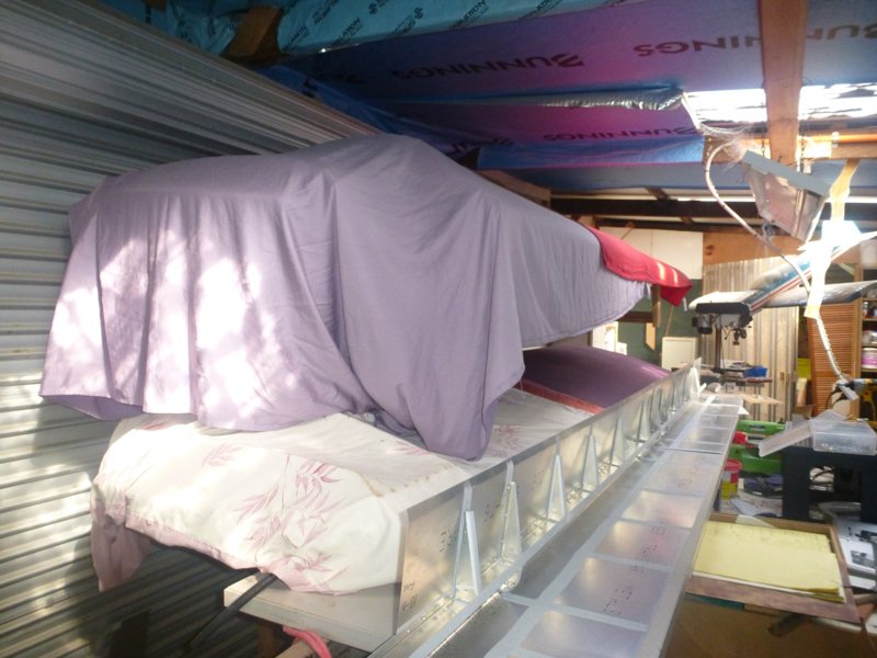

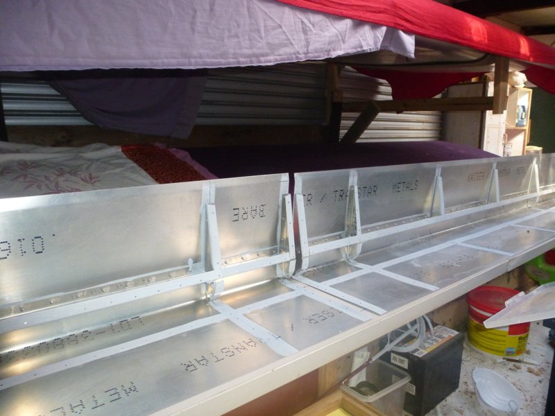

The flaperons are made in two pieces per wing, as the outer one is higher at the TE by about 16mm than the inner, to provide washout. I made both halves for the right wing, and more recently have been working on both halves for the left wing, and they're pretty much ready to rivet.
Last two ready to rivet. In the background are the wings, covered with various old sheets & tablecloths for protection.

Status update 5/11/16
Last two flaperon segments have been riveted, plus the trailing edge solid rivets done on one of them. Drilled and prepped the TE for the other, just have to squeeze those rivets. Only other thing to do is mount and rivet the plastic tip on the outer flaperon segment.
I'll leave the joining plates and root ribs, along with hinge point doubler, until final assembly - really need the fuselage and wings to be together for that bit.
