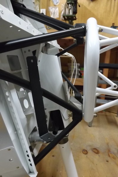

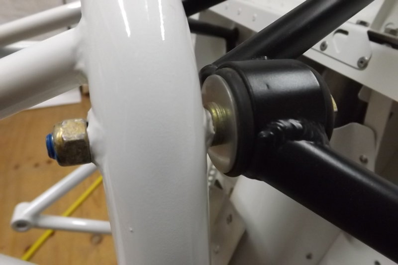

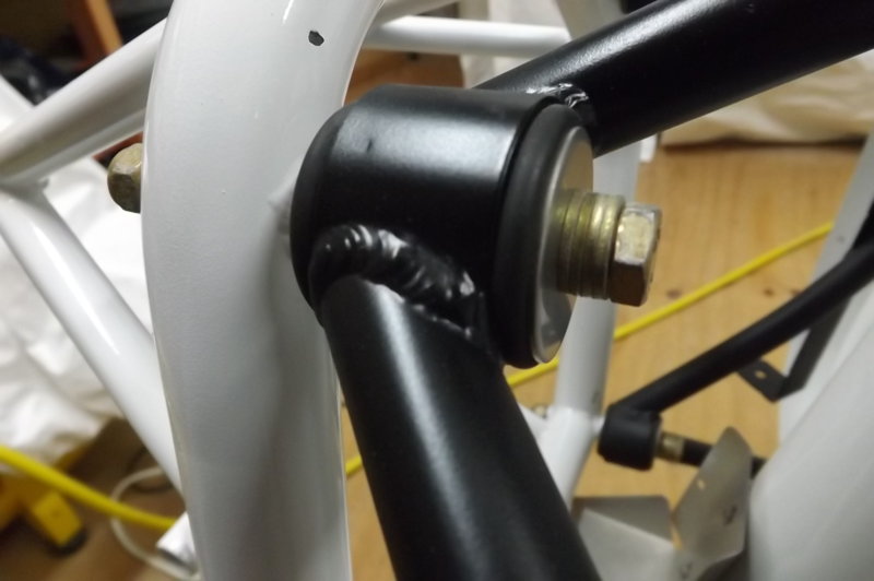

IBob Posted October 22, 2018 Posted October 22, 2018 You're welcome to ask whatever you wish, Marty. I'm not particularly knowledgeable, and in this case I'm just putting together the bits in the box. 1. Yes, those are rubber bushes, with a steel sleeve up the centre. The ring (white) and other bit (black) arrive already assembled, and packed where they are bolted together with washers, to give appropriate alignment: this is done in a jig at the factory, presumably they vary some after welding. There's not much give in those rubbers, so I assume the black frame needs to be strong, and also rigidly mounted to the aircraft. 2. The curved lower member is to allow room on that side for the oil tank, which mounts to the flat plate. Cheers, Bob 1
Marty_d Posted October 22, 2018 Author Posted October 22, 2018 Thanks Bob... this stuff is gold. It's great to see how that bit is constructed. So where the rubber mounts go through, that would be a segment of tube welded in. Just had a look at Aircraft Spruce and there's a variety of rubber mounts around. I'm going to have to research this a bit more for sizes etc.
IBob Posted October 22, 2018 Posted October 22, 2018 You're welcome. 1. Where the bolt goes through the ring mount (white) there's a small diameter tube welded through the ring mount, so that tightening the bolt does not distort the ring mount tubing. 2. Where the bolt goes through the black frame, yes, there's a segment of bigger welded tube, which takes the rubber shock mount. The shock mount itself look very much to me like what you get in car auto suspension on the end of the shocks. And they're a tight fit in there: having counted the washers etc, I disassembled the white from the black for painting and had to mask round the rubbers as I was unable to withdraw them with moderate force. The segment of black tube is 38mm OD and 25mm long, with a wall thickness of approx. 2mm (I cannot get at that to measure it). The bolts are AN5. 3. The bolts attaching the black frame to the fuselage are AN4 at top and bottom, and AN5 at the sides. 4. The manual says the packing washers between black and white frame are adjusted to give 0 to 2deg downwards with reference to the rear upper fuselage, and 2deg to the right plus/minus 1 deg. My setup has 2off AN5 washers in each of the LH mounts, and none in the RH mounts.

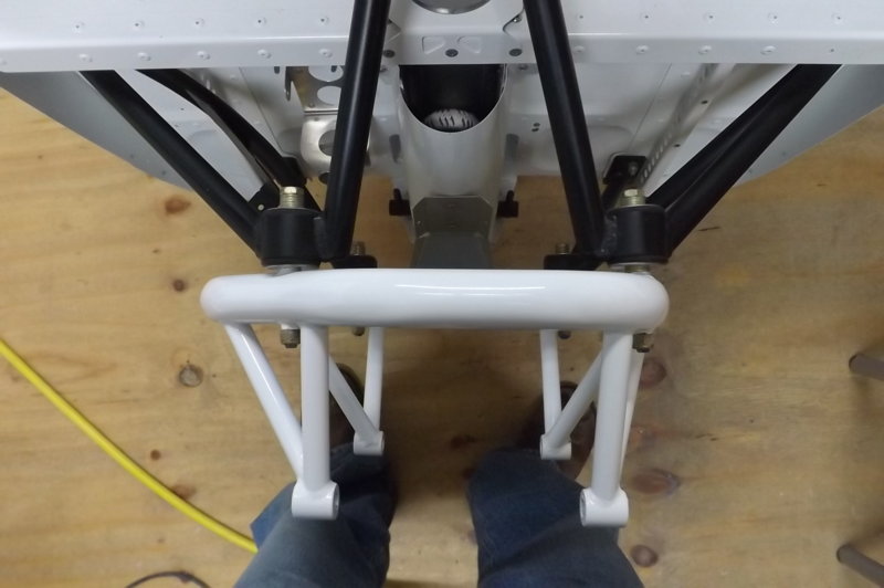

Marty_d Posted October 24, 2018 Author Posted October 24, 2018 Got the noseleg on today. (For tailwheel pilots - that's the bit that holds the full-size third wheel....) 3 1

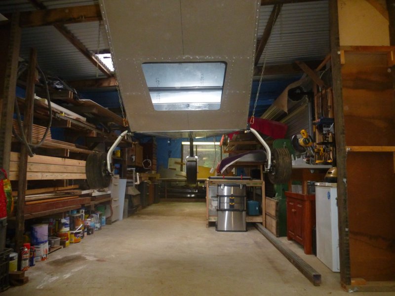

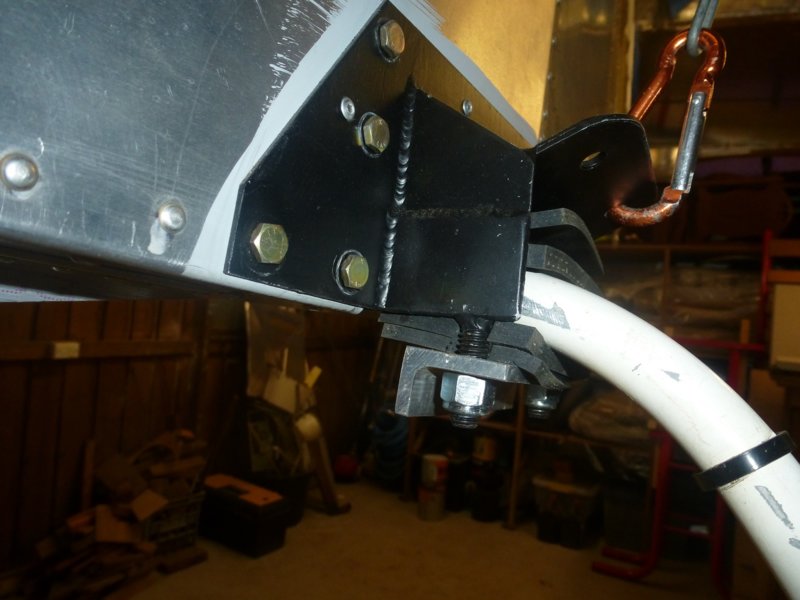

Marty_d Posted November 3, 2018 Author Posted November 3, 2018 Wheels on!! After a marathon shed-cleaning exercise (5 days worth, it hasn't been cleaned out properly for 10 years...) I hoisted the plane from the roof beams and this morning got the gear mounted. Is there a specified celebration for when a plane gets its undercarriage on for the first time? Scantily clad maidens dancing around waving rosemary or something? Credit must be given to my son Harry (8) who came down to the shed before he'd even had breakfast, held one side of the main gear up, and put on the nuts and got them started. 4 1
IBob Posted November 3, 2018 Posted November 3, 2018 Magic moment! And congratulations. I think, once the maidens have departed, you're supposed to put the seats in and sit there, flexing your imagination??? This is a little way off for me yet: when it comes to spray-guns, I need all the help I can get, so I've left the U/C off so that I can rotisserie the fuselage. But. I saw nifty timelapse Sav build the other day...in Iceland, i think...and to put the main U/C on they turned the fuse over and sat it on the cockpit steelwork. Which was definitely different...) 1

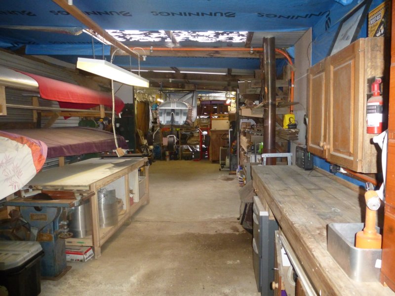

nomadpete Posted November 4, 2018 Posted November 4, 2018 I don't believe it. That can't really be your shed. You must have Photoshopped it. 1 1
Marty_d Posted November 5, 2018 Author Posted November 5, 2018 I don't believe it. That can't really be your shed. You must have Photoshopped it. I know, it's hard to believe. Drop in next time you're going past Peter - see for yourself! Picked up my rivets from the post office today - courtesy of Aircraft Spruce. So this evening was spent happily riveting most of the front end, it's gone from looking like an echidna, to an echidna with a crew cut. Now that all the underneath rivets are pulled, I decided to lower her down from her eyrie and she's sitting on her wheels. Judicial placement of an almost-full 10L tin of ceiling white is providing enough weight in the front end to keep the rear end off the floor. She looks pretty level, not sure at this stage whether to leave those tyres on or get larger ones - having read some of the horror stories when it comes to Savannah wheels I'm not real keen to muck around with them!
