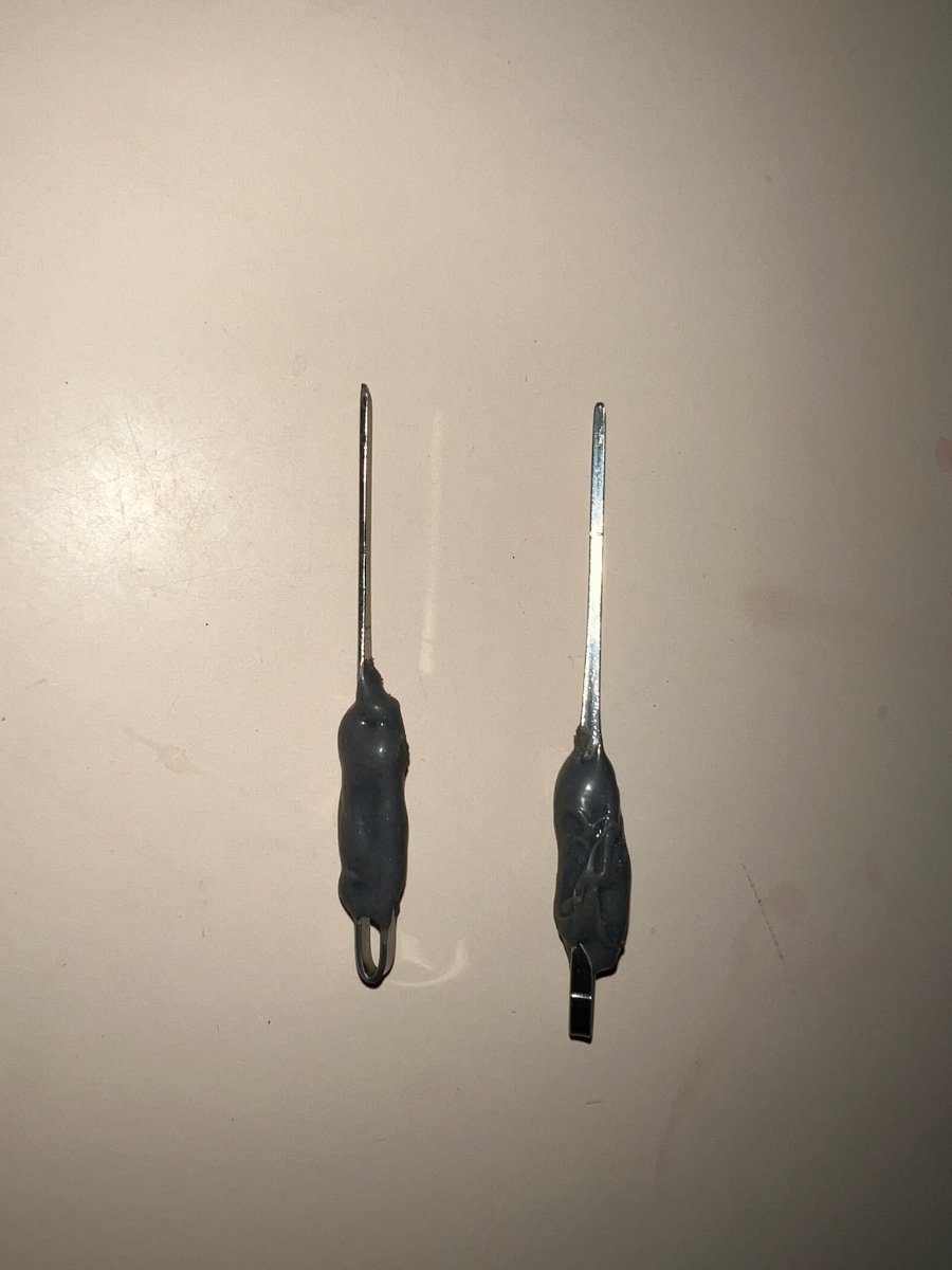

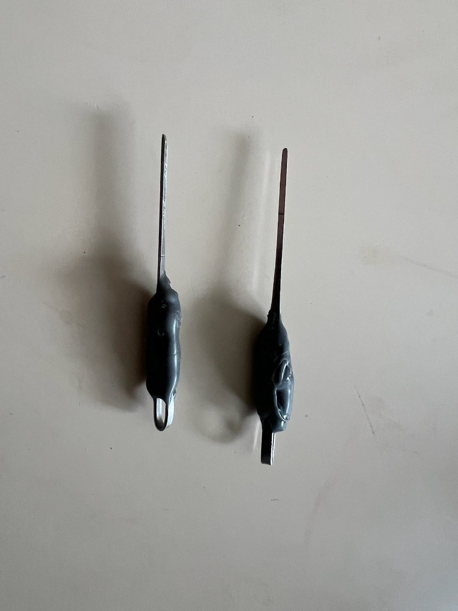

Blueadventures Posted February 21, 2025 Author Posted February 21, 2025 (edited) I made up two pin removal tools for the Rotax 912 ignition module connectors. I had used round pins and small Jewlery flat blade screw drivers in the past but after doing a 912 install this week I used a ford type removal tool for removing the old engines soft start and mag pins, very easy with the chisel shaped end to the flat tool. Being a rain again day, over the rain and heaps more on its way this week, I made two tools using the left over off cut of the s/s from car windshield wiper blades as very strong and flied the sides down to the 1.4mm width as in Mnewbery's attachment (thanks for the info was very helpful) above and placed some epoxy metal to form a handle. Edited February 21, 2025 by Blueadventures 1 2

Blueadventures Posted February 22, 2025 Author Posted February 22, 2025 10 hours ago, onetrack said: eBay Aviation Supplies is your friend for this kind of stuff! 😄 https://www.ebay.com.au/sch/i.html?_nkw=electrical+pin+tools Agree, bought a similar set a few days ago; just made the two so I have one in my electrical repair tools kit and one in my small spares kit on board. Easy enough to make up and the shape works a treat. 1 1

Blueadventures Posted February 25, 2025 Author Posted February 25, 2025 38 minutes ago, Moneybox said: Some automotive windscreen wiper inserts have a small SS strip inserted into either side of the rubber. It's a very thin rigid metal strip about 3x1mm I think without going out and looking for one. Very handy for this sort of job. Yep, exactly what I used, filed width down to 1.4mm. as above one in my electrical connector crimp box and one in tools etc on board. I carry two pins and gromets (no weight to them) as have assisted with mags not stopping Rotax's due to broken or poor crimp in the connect tor that allows for an open circuit. Just handy. 1
