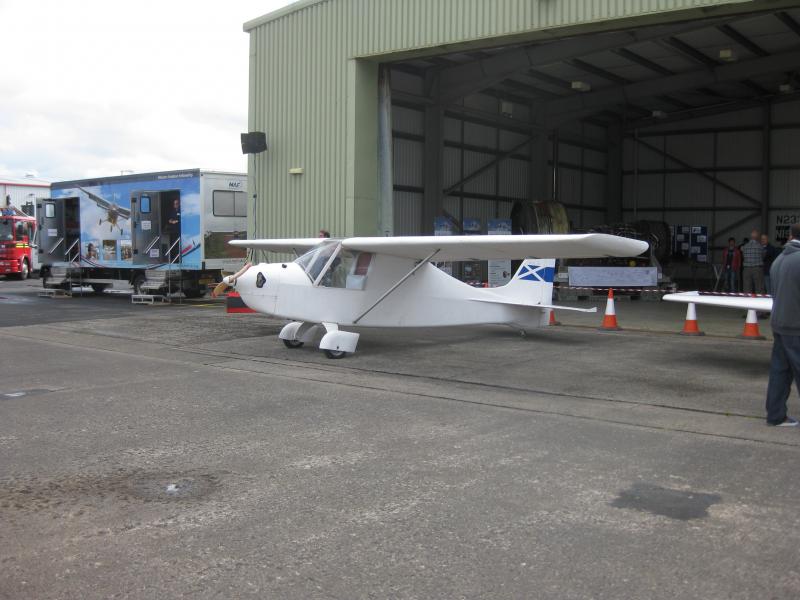

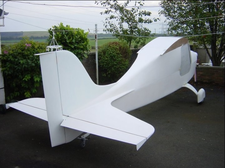

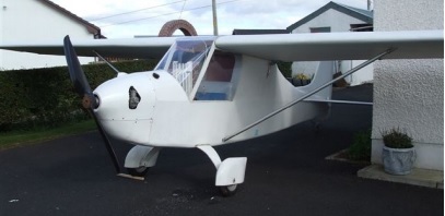

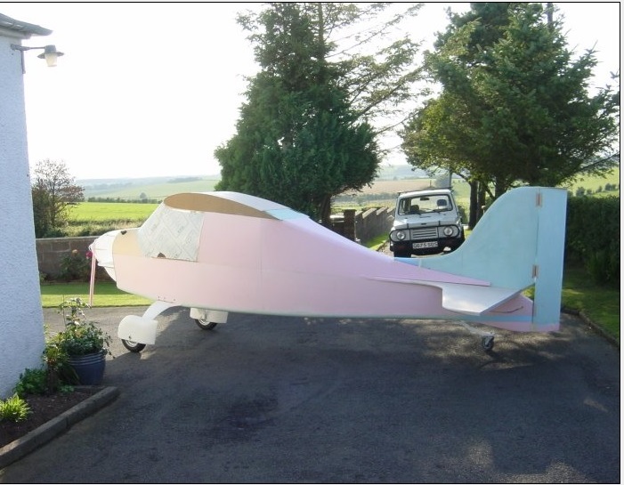

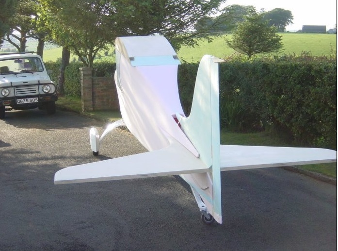

SGIAN DUBH Posted June 7, 2016 Posted June 7, 2016 Just getting ready to commence the Quaich Flight Testing ( Collection of the Microlight is imminent, once our Trailer is emptied of the Building Supplies for the Holiday Home projects ). The Quaich has a Rotax 447 engine & has an empty weight of 184.2kg & will be cleared to 300kg under the UK SSDR acceptance. We are limiting the Pilot weight to 86kg to allow for 30litres of fuel to be carried ( the tank will be replaced by a 40ltr Tank as calcs will allow 40ltrs with a 86kg Pilot ) 3

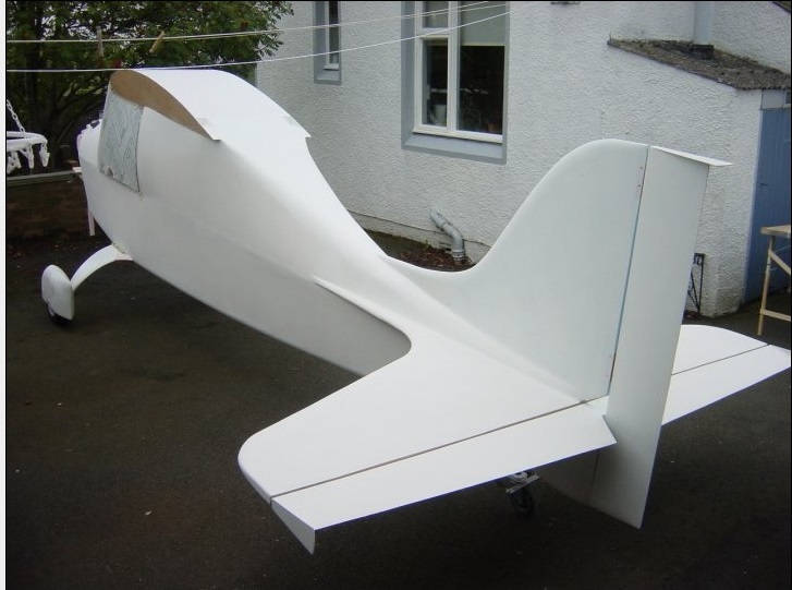

Head in the clouds Posted June 7, 2016 Posted June 7, 2016 A couple of observations that you might want to consider during your testing - 1. If it was mine the elevator and rudder would have much more area. The area they have at the moment is more typical of an aircraft with a stall speed in the vicinity of 60kt than the 35-40kt I imagine this will have. Consequently it's very likely that the elevator will run out of authority a fair while before it could bring the mainplane to the critical angle and stall it, so you may find your landings will be a good bit faster than anticipated, or is desirable. Similarly the elevator may not have sufficient authority to lift the tail during the take-off roll. If the aircraft has flaps and you use them on take-off then they would move the centre of pressure of the mainplane aft and that would help with the situation very considerably. If you don't have flaps, or don't use them for take-off, and if the engine has sufficient power to overcome the drag and reach take-off speed in the three-point attitude (with a 447 it should have) then you would be likely to become airborne in the almost-stalled attitude. Once the wheels are off then you'd want to lower the nose and build speed rather promptly or risk a wing-drop (lowering the nose would happen 'automatically' if you maintain stick forward as it lifts off, of course, though that's not entirely intuitive) ... this situation of perhaps not being able to lift the tail prior to take-off is made worse by the position of the mainwheels which appears to be a little forward of the leading edge (in level flight attitude) - right below the leading edge is more 'usual'. The condition would be improved by ensuring a CG toward the forward end of the range but that could be a bad trade-off in terms of increasing the landing speed even further because of running out of 'up' elevator authority even earlier. 2. It has a tall rudder, and some of its area below the HS, which is very good, but I'd venture to say that you might find it has rather limited capability in cross-winds. The large amount of fuselage side-area behind the CG, the forward landing gear position and the smallish (narrow chord/high aspect ratio which stalls at a lower Reynolds number than a lower aspect ratio would) rudder all combine to limit the aircraft's cross-wind ability, so I'd be leading up to cross-wind landings gradually. 1
SGIAN DUBH Posted June 7, 2016 Author Posted June 7, 2016 A couple of observations that you might want to consider during your testing -1. If it was mine the elevator and rudder would have much more area. The area they have at the moment is more typical of an aircraft with a stall speed in the vicinity of 60kt than the 35-40kt I imagine this will have. Consequently it's very likely that the elevator will run out of authority a fair while before it could bring the mainplane to the critical angle and stall it, so you may find your landings will be a good bit faster than anticipated, or is desirable. H.I.T.C, Do you have credentials that back up your opinions or are they just ' well-meaning ' findings? I only ask because I seem to be getting different opinions from here to there ;-) Until it gets test-flown ( in the air ) it will be an unknown stall speed though I am almost certain it will be in the 30kt area ( I certainly hope so because it needs to be to comply with SSDR ) I am assured the Elevator has more than enough authority to ensure a controlled landing. Similarly the elevator may not have sufficient authority to lift the tail during the take-off roll. If the aircraft has flaps and you use them on take-off then they would move the centre of pressure of the mainplane aft and that would help with the situation very considerably. If you don't have flaps, or don't use them for take-off, and if the engine has sufficient power to overcome the drag and reach take-off speed in the three-point attitude (with a 447 it should have) then you would be likely to become airborne in the almost-stalled attitude. Once the wheels are off then you'd want to lower the nose and build speed rather promptly or risk a wing-drop (lowering the nose would happen 'automatically' if you maintain stick forward as it lifts off, of course, though that's not entirely intuitive) ... this situation of perhaps not being able to lift the tail prior to take-off is made worse by the position of the mainwheels which appears to be a little forward of the leading edge (in level flight attitude) - right below the leading edge is more 'usual'. The condition would be improved by ensuring a CG toward the forward end of the range but that could be a bad trade-off in terms of increasing the landing speed even further because of running out of 'up' elevator authority even earlier. I am assured the Elevator has more than enough authority to ensure a controlled tail lift in the take off run. I have very little confidence in 2 strokes but as a 447 /503 is the only realistic option for this aircraft I am stuck with that as a powerplant....... I have ample hours on Taildraggers so I don't envisage that I will have any problem getting the tail up ( I doubt my Test Pilot will have any problems either ). I am intrigued by the mainwheels reference.... I have flown many Tailwaggers with mainwheels ahead of the Leading Edge & they are more tricky but not dangerously tricky. I will be looking closely at the CofG & if it can be moved toward the front of the range it will be adjusted. 2. It has a tall rudder, and some of its area below the HS, which is very good, but I'd venture to say that you might find it has rather limited capability in cross-winds. The large amount of fuselage side-area behind the CG, the forward landing gear position and the smallish (narrow chord/high aspect ratio which stalls at a lower Reynolds number than a lower aspect ratio would) rudder all combine to limit the aircraft's cross-wind ability, so I'd be leading up to cross-wind landings gradually. Again the Crosswind capability will be explored closely before we set a figure that we are happy with..... One of the beauties of our UK SSDR Category is that " it is a licence to explore the parameters of your aircraft " The UK CAA have even said " SSDR allows Aerobatics if your Design is capable of withstanding the G forces associated with Aeros " I won't personally do Aeros in any SSDR that I currently operate, might be tempted in a Phantom Ultralight if we manage to acquire one ;-) Currently having a bit of grief getting a Kolb Twinstar through SSDR because it is ex LAA/PFA & it looks like the LAA are reluctant now to have too many LAA aircraft moving onto the SSDR category.
Head in the clouds Posted June 7, 2016 Posted June 7, 2016 H.I.T.C, Do you have credentials that back up your opinions or are they just ' well-meaning ' findings? I only ask because I seem to be getting different opinions from here to there ;-) Until it gets test-flown ( in the air ) it will be an unknown stall speed though I am almost certain it will be in the 30kt area ( I certainly hope so because it needs to be to comply with SSDR ) I am assured the Elevator has more than enough authority to ensure a controlled landing. It depends what you call credentials, I don't have formal aeronautical engineering qualifications however I have been studying the subject since 1976 during which time I have completed fifteen aircraft, not completed two others and am nearing the completion of the current one (DooMaw, my avatar). The completed ones were all successful and fly well, the varying experiences I had with 'tuning' some of the earlier ones, and abandoning two of them are all testament to the learning curve. All are/were of my own design. Experience of that kind, and over four decades, does provide valuable real-world experience that some might say amount to a little more than 'well meaning findings', but by all means take my observations as you see fit and do with them as you will ... :-) I didn't say the Quaich's stall speed would be much above the 30-40kt region, I said the tail control surfaces looked like you might have a minimum controllable speed well above the stall speed. I said the elevator wasn't likely to have enough authority to bring the mainplane to the stall. That results in the minimum controllable speed being well above the stall speed because when you reach full rear stick travel the lift and moment provided by the elevator isn't sufficient to overcome the moments provided by the CG being ahead of the Centre of Pressure (CP), the pitching moment of the airfoil and any additional pitching moment provided by extending flaps. It all adds up to a plane that won't fly as slow as it could, if you could bring it to the stall. It's a much misunderstood thing, people bring the stick back to the stop, the plane gets slower until eventually it reaches a minimum flying speed and 'mushes'. How often have you heard people say their plane is very kindly in the stall, it just mushes? Fact is, it hasn't reached the stall at all. Now, that doesn't mean the assurance you were given that "the Elevator has more than enough authority to ensure a controlled landing" is wrong, it means that the landing will need to be much faster than you expect, because if my assessment of the elevator's size is correct, then you'll run out of elevator authority way above the stall speed. And - earlier, in the Sgian Dubh thread, you said you had an aerodynamicist who was "the most respected aircraft engineer in UK" or words very close to that, involved in this program. Above you said "Until it gets test-flown ( in the air ) it will be an unknown stall speed". That is a mystery ... how can you have such a highly revered person on the team and he doesn't seem to know how to do the most basic of aeronautical calcs i.e. the stall speed prediction. Presumably you know the airfoil section, the wing area and the weight of the aircraft? That, and a set of polars for the section (available on many sites online) are all you need to predict the stall speed with great accuracy. Determination of similar for the HS, factored by the tail moment, would tell you for certain whether the elevator will have the authority to fully stall the mainplane or not ... it's basic stuff. I am assured the Elevator has more than enough authority to ensure a controlled tail lift in the take off run. I have very little confidence in 2 strokes but as a 447 /503 is the only realistic option for this aircraft I am stuck with that as a powerplant....... I have ample hours on Taildraggers so I don't envisage that I will have any problem getting the tail up ( I doubt my Test Pilot will have any problems either ). I am intrigued by the mainwheels reference.... I have flown many Tailwaggers with mainwheels ahead of the Leading Edge & they are more tricky but not dangerously tricky. I will be looking closely at the CofG & if it can be moved toward the front of the range it will be adjusted. Assurances are good - but the proof will be in the pudding, as they say, and the actual fact will be very easy to find out as soon as you start taxi tests, so the tail-lift thing is a non-issue - you'll know the answer before you ever need to get airborne. If the one providing the assurances has conducted a lift coefficient and moment calc for the HS and VS then it would be useful to attach it here, if you like. Second opinions would likely be forthcoming and where controllability and test-flying is concerned it doesn't hurt to have a few of them. Just my opinion again - but a well maintained 2T with a knowledgeable operator can be very reliable. In my experiences the key issues are - maintain full throttle in the climb, a lot of folks like to 'back off a little' and that leans the mixture considerably which makes it run a lot hotter and risks nipping up. Make sure you don't have air leaks in the induction, either at the rubber mounts after the carbies or direct to the crankcase (via the fuel-pump pulse line is a classic), they both lean the mixture with disastrous results. Avoid low idle speeds on the ground, the 'rattle' breaks the crankshafts. Avoid long low throttle descents, it shock-cools them and that can crack things, or they can oil up the plugs and stop, or oil-injected ones can run with insufficient oil in the mix. Use 2T oil for air-cooled 2T engines, not for water-cooled engines like outboard engines, the oil is designed to burn at different temperatures i.e. air-cooled engines run hotter so oil for water-cooled engines burns too soon if used in air-cooled engines. HIH. I didn't say the forward position of the mainwheels was 'dangerously tricky', and neither did I mean that it need be any kind of problem. What I was on about was that it would have two effects - first it would make the weight on the tailwheel greater than if those wheels were further aft, consequently the 'down' elevator has more work to do to lift the tail in the take-off run, and secondly the further the wheels are ahead of the CG, the more work the rudder has to do in a crosswind. In both cases the forward wheels position does a dis-service to the already very marginal tail flying surfaces' effectiveness. 1
SGIAN DUBH Posted June 7, 2016 Author Posted June 7, 2016 It depends what you call credentials, I don't have formal aeronautical engineering qualifications however I have been studying the subject since 1976 during which time I have completed fifteen aircraft, not completed two others and am nearing the completion of the current one (DooMaw, my avatar). The completed ones were all successful and fly well, the varying experiences I had with 'tuning' some of the earlier ones, and abandoning two of them are all testament to the learning curve. All are/were of my own design. Experience of that kind, and over four decades, does provide valuable real-world experience that some might say amount to a little more than 'well meaning findings', but by all means take my observations as you see fit and do with them as you will ... :-) . I always take what others say or suggest as Good Sound Advice offered with the best intentions, the problem in the UK is " Everyone is an Aircraft Engineer until the engine starts " Thus why I look further afield for advice and analyse whether the person is a Waffler or an informed font of knowledge, I am sure you are the latter " I didn't say the Quaich's stall speed would be much above the 30-40kt region, I said the tail control surfaces looked like you might have a minimum controllable speed well above the stall speed. I said the elevator wasn't likely to have enough authority to bring the mainplane to the stall. That results in the minimum controllable speed being well above the stall speed because when you reach full rear stick travel the lift and moment provided by the elevator isn't sufficient to overcome the moments provided by the CG being ahead of the Centre of Pressure (CP), the pitching moment of the airfoil and any additional pitching moment provided by extending flaps. It all adds up to a plane that won't fly as slow as it could, if you could bring it to the stall.. I take your points & will bank them for future recall during testing......you may well be right in what you foresee, I hope you are wrong but you are certainly putting reasoned doubt into my mind. It's a much misunderstood thing, people bring the stick back to the stop, the plane gets slower until eventually it reaches a minimum flying speed and 'mushes'. How often have you heard people say their plane is very kindly in the stall, it just mushes? Fact is, it hasn't reached the stall at all. Now, that doesn't mean the assurance you were given that "the Elevator has more than enough authority to ensure a controlled landing" is wrong, it means that the landing will need to be much faster than you expect, because if my assessment of the elevator's size is correct, then you'll run out of elevator authority way above the stall speed.. The Stall will be fully explored, I won't be settling for Mushing... I want to see a FULL STALL ( It will be done at Altitude for safety ) And - earlier, in the Sgian Dubh thread, you said you had an aerodynamicist who was "the most respected aircraft engineer in UK" or words very close to that, involved in this program. Above you said "Until it gets test-flown ( in the air ) it will be an unknown stall speed". That is a mystery ... how can you have such a highly revered person on the team and he doesn't seem to know how to do the most basic of aeronautical calcs i.e. the stall speed prediction. Presumably you know the airfoil section, the wing area and the weight of the aircraft? That, and a set of polars for the section (available on many sites online) are all you need to predict the stall speed with great accuracy. Determination of similar for the HS, factored by the tail moment, would tell you for certain whether the elevator will have the authority to fully stall the mainplane or not ... it's basic stuff.. My Aerodynamicist will be doing the calcs ( to see how they differ from the designers scribbles ) He is currently wrapped up in the Sgian Dubh & I don't fill his pockets with enough dollars to have him looking at more than 1 project at the same time. ( He would look at figures if I asked him, so when I have both the aeroplane & all the spreadsheets in front of me I will be in a better place to ask him questions ) The Vto is supposed to be 37.4mph ( 32.52kts) So I am hoping that a Touchdown at 30kts is feasible....... The Cruise is supposed to be 70mph (61kias) to 105mph (91kias ) with a VNE of 110mph Assurances are good - but the proof will be in the pudding, as they say, and the actual fact will be very easy to find out as soon as you start taxi tests, so the tail-lift thing is a non-issue - you'll know the answer before you ever need to get airborne. If the one providing the assurances has conducted a lift coefficient and moment calc for the HS and VS then it would be useful to attach it here, if you like. Second opinions would likely be forthcoming and where controllability and test-flying is concerned it doesn't hurt to have a few of them.. The builder/designer has reams of calcs on file that I will pay full attention to when I need to commence testing. Just my opinion again - but a well maintained 2T with a knowledgeable operator can be very reliable. In my experiences the key issues are - maintain full throttle in the climb, a lot of folks like to 'back off a little' and that leans the mixture considerably which makes it run a lot hotter and risks nipping up. Make sure you don't have air leaks in the induction, either at the rubber mounts after the carbies or direct to the crankcase (via the fuel-pump pulse line is a classic), they both lean the mixture with disastrous results. Avoid low idle speeds on the ground, the 'rattle' breaks the crankshafts. Avoid long low throttle descents, it shock-cools them and that can crack things, or they can oil up the plugs and stop, or oil-injected ones can run with insufficient oil in the mix. Use 2T oil for air-cooled 2T engines, not for water-cooled engines like outboard engines, the oil is designed to burn at different temperatures i.e. air-cooled engines run hotter so oil for water-cooled engines burns too soon if used in air-cooled engines. HIH.. We are both singing from the same hymnsheet on the 2 STROKE Operations, I am not a 'back off a little' in the climb pilot......... I am going to have a Rotax specialist look at the 447 BEFORE I even start it up. I didn't say the forward position of the mainwheels was 'dangerously tricky', and neither did I mean that it need be any kind of problem. What I was on about was that it would have two effects - first it would make the weight on the tailwheel greater than if those wheels were further aft, consequently the 'down' elevator has more work to do to lift the tail in the take-off run, and secondly the further the wheels are ahead of the CG, the more work the rudder has to do in a crosswind. In both cases the forward wheels position does a dis-service to the already very marginal tail flying surfaces' effectiveness. I will be wary of what you have said because I am used to 200-300hp Engined Tailwaggers so I always have had bags of power on tap to lift the tail & aerobatic surfaces that are substantial. Thank you for your input ;-) 1

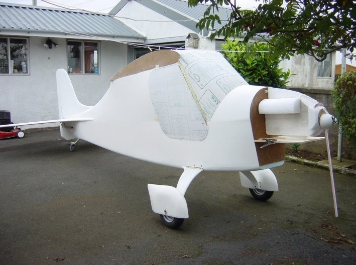

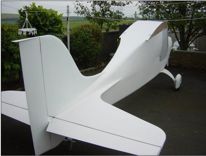

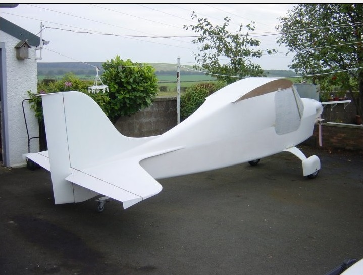

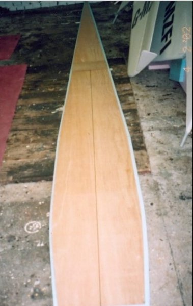

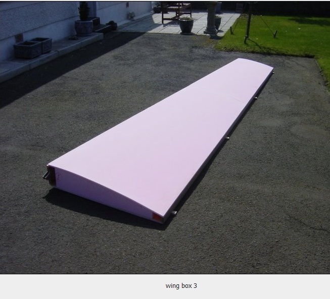

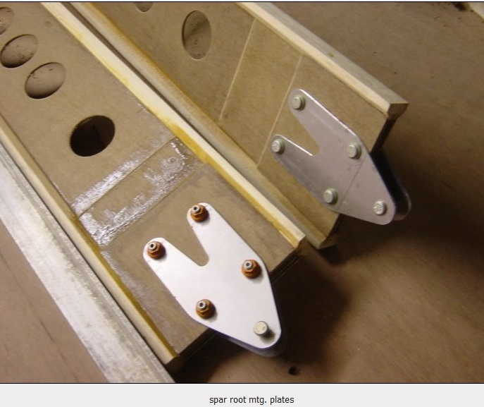

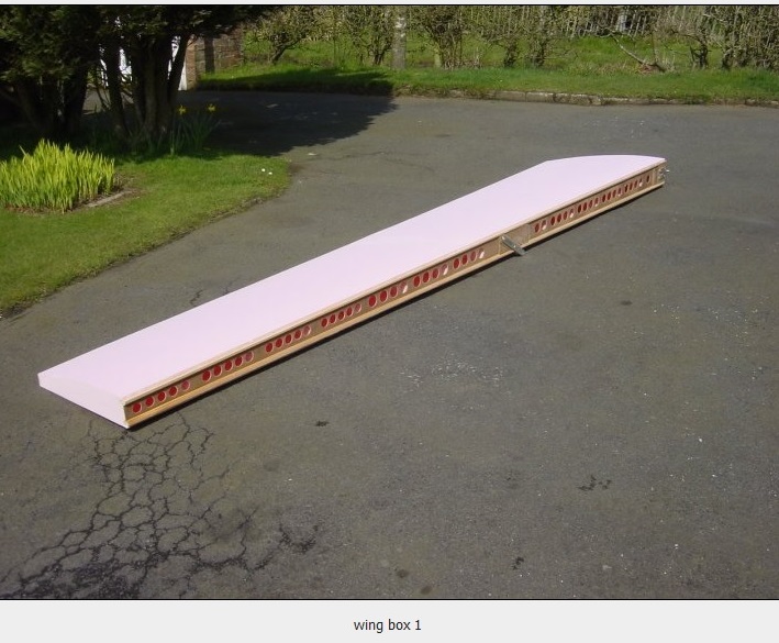

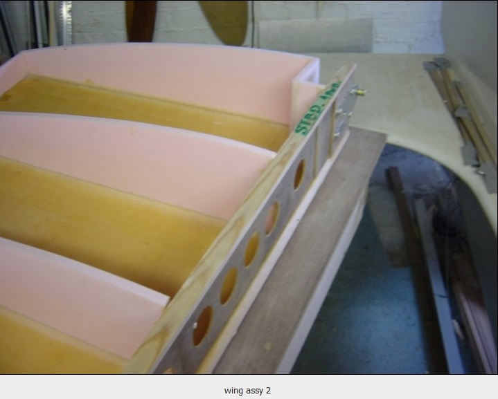

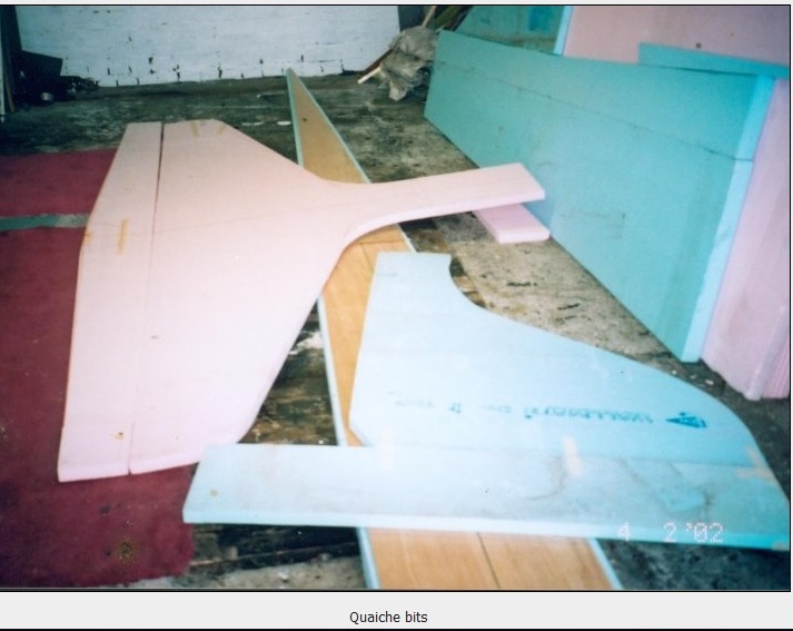

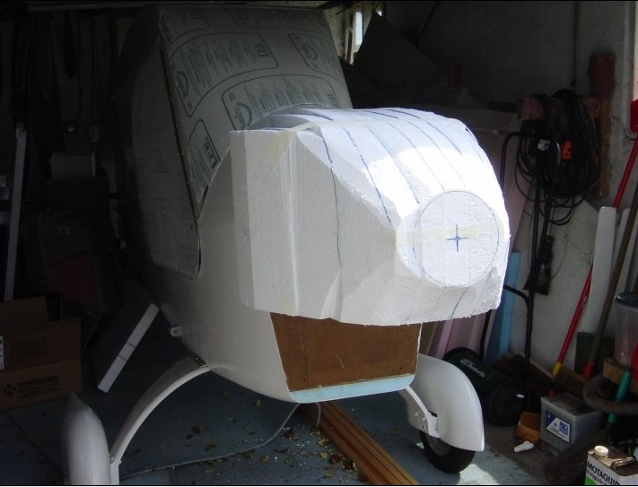

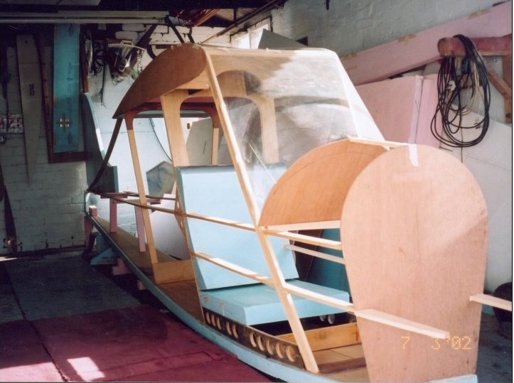

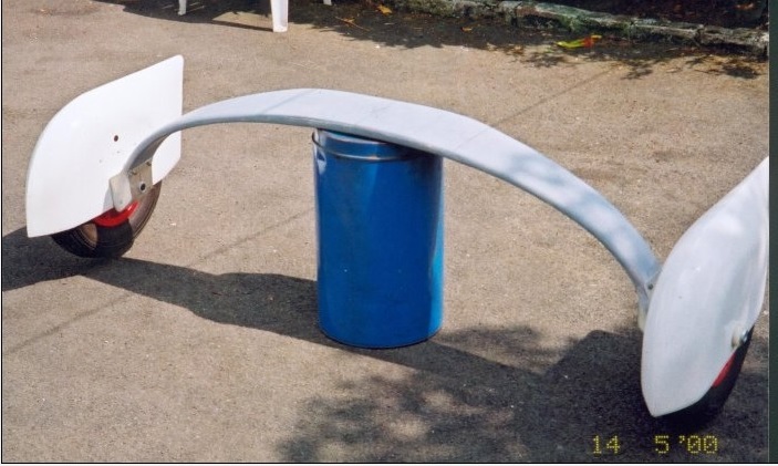

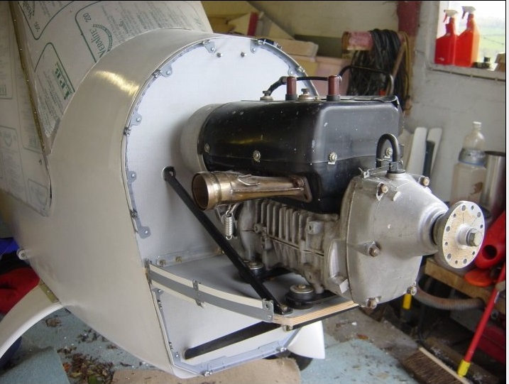

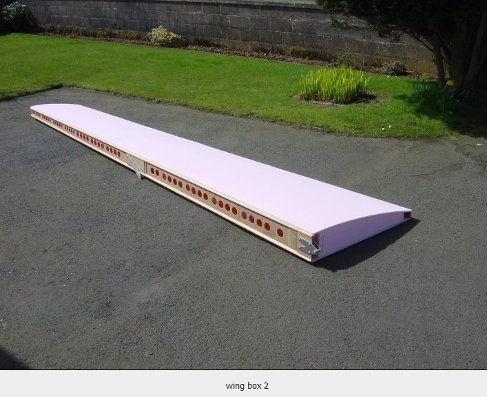

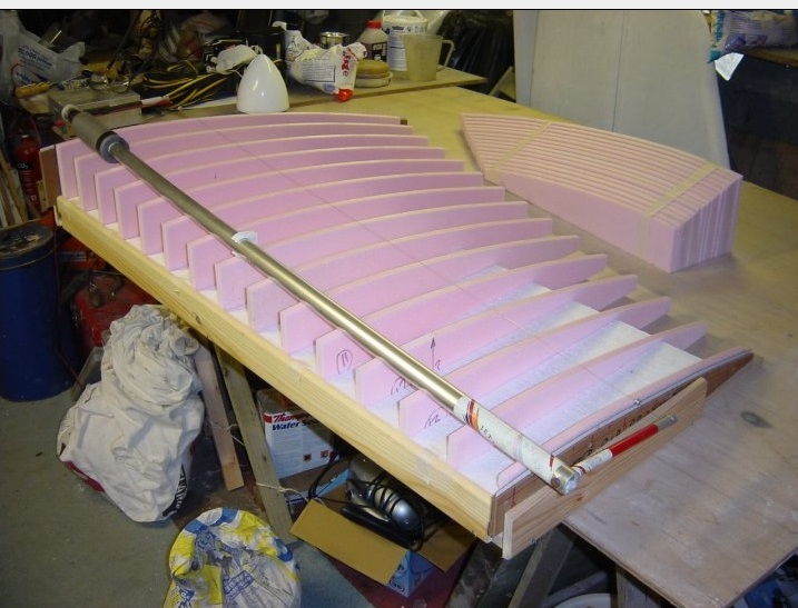

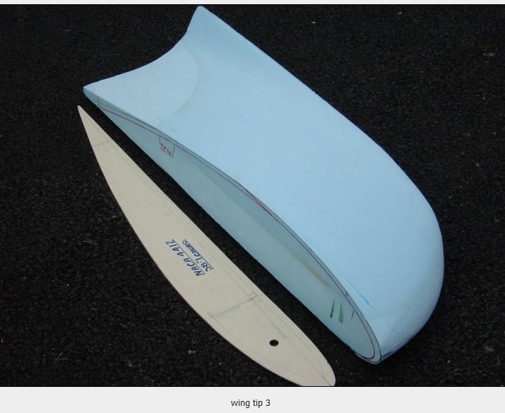

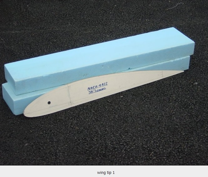

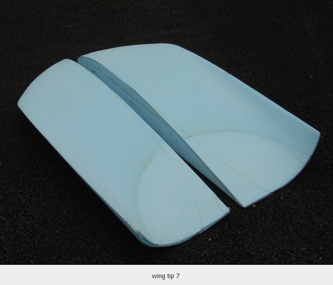

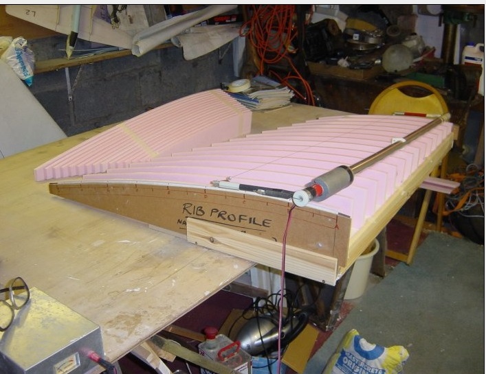

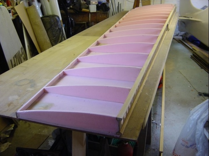

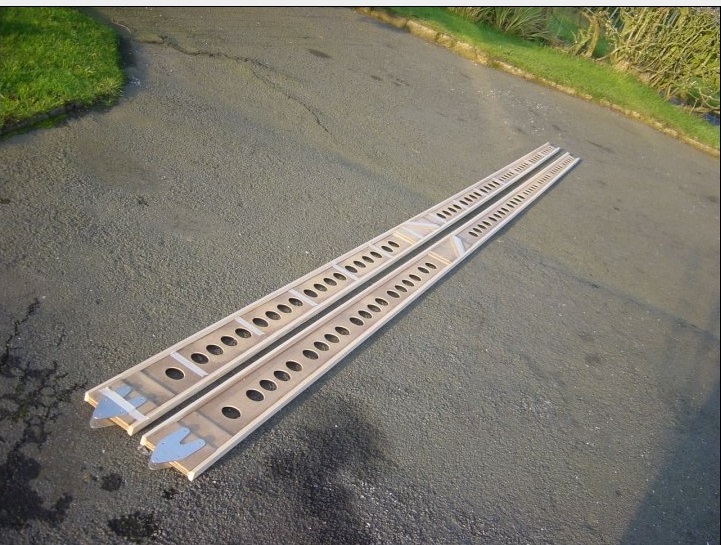

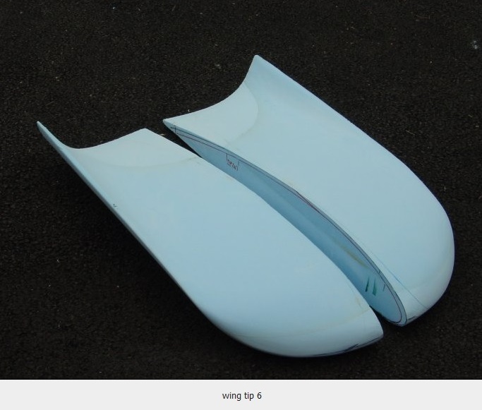

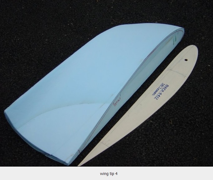

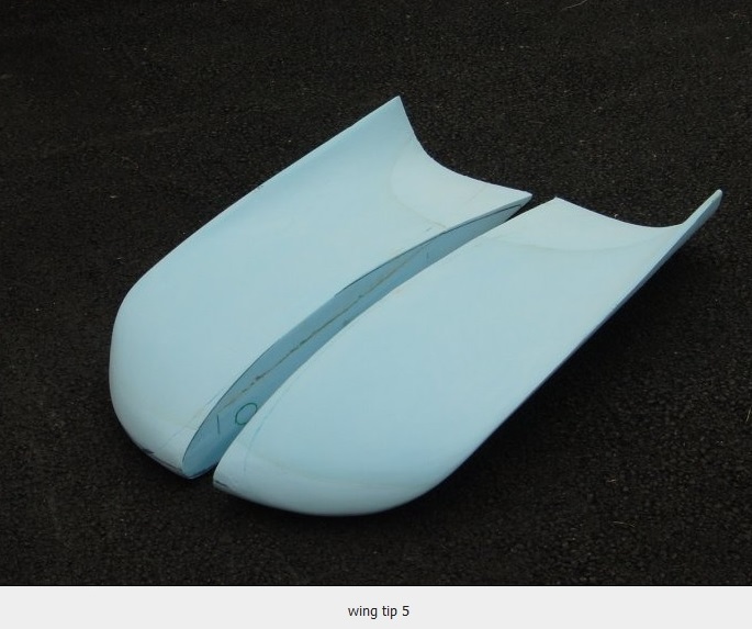

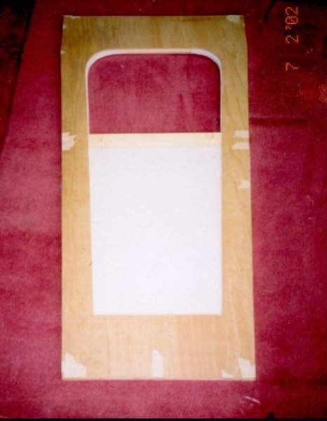

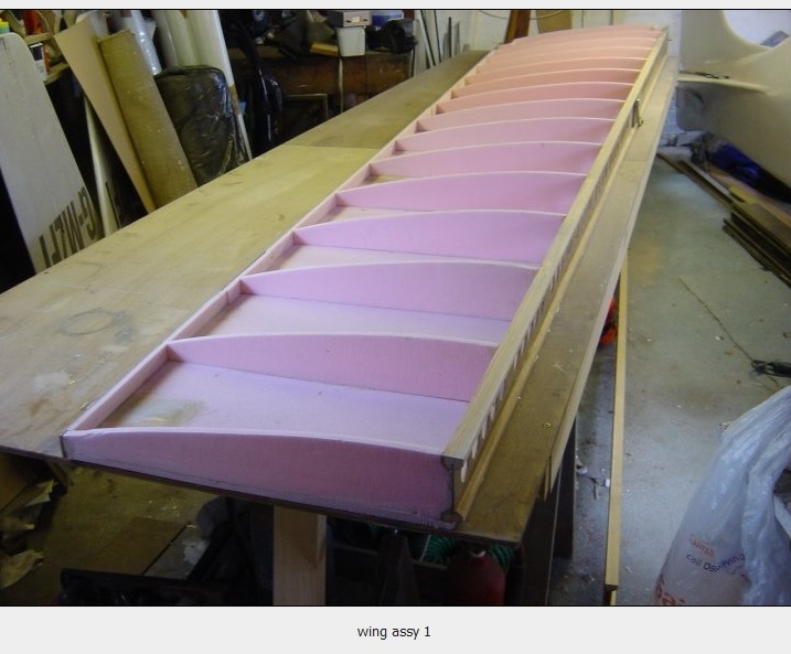

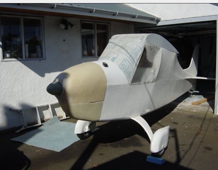

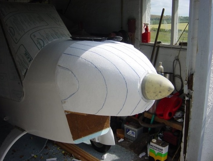

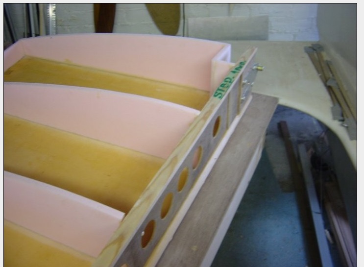

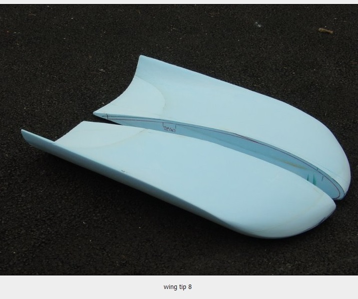

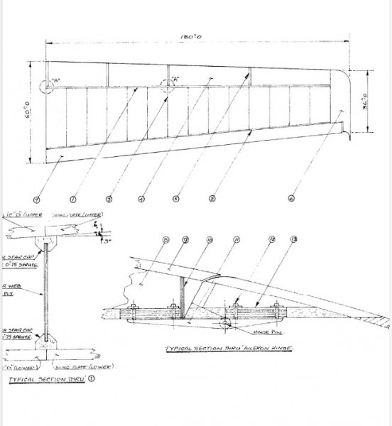

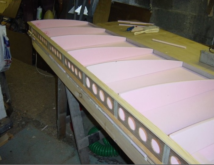

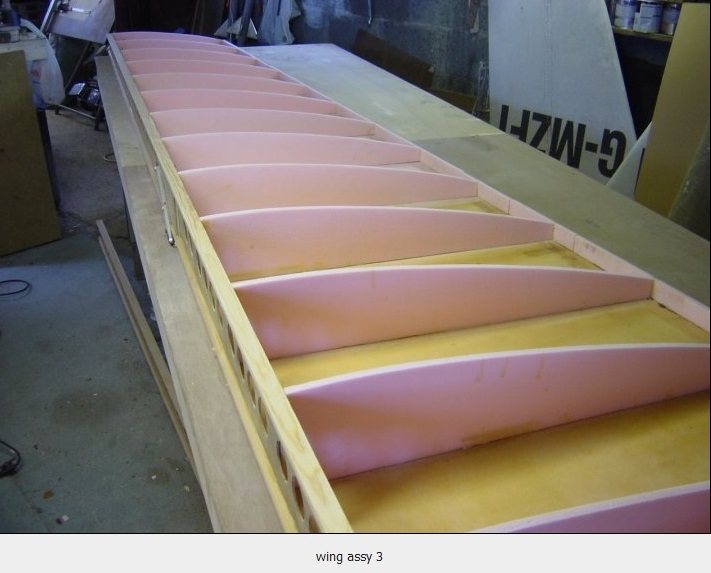

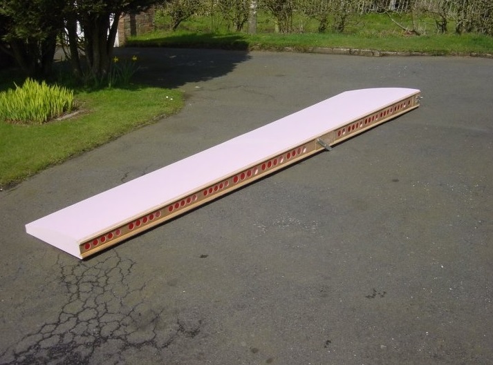

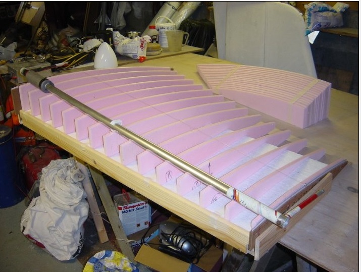

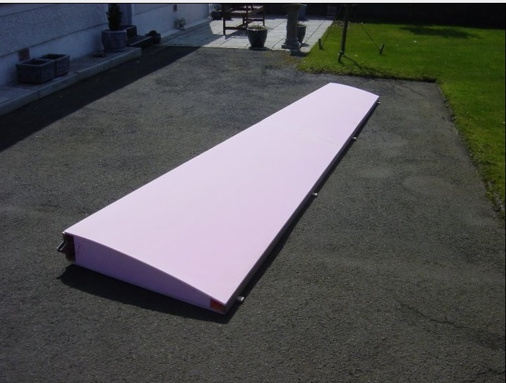

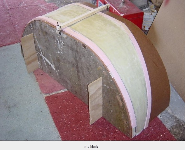

SGIAN DUBH Posted June 8, 2016 Author Posted June 8, 2016 Here are the Construction Pics so far ;-) 1

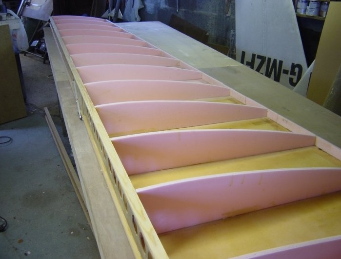

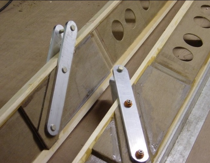

pylon500 Posted June 9, 2016 Posted June 9, 2016 Just some observations, which I'm not 100% sure of..? Is the wing actually tapered? Depending on which photo's I look at, I get the impression that the wing has a lot of cantilever after the strut attach point? Yet the spar caps look to be about the same size over the whole length? The strut reinforcement blocks look a bit 'sudden', meaning they don't appear to taper the load out into the web gradually. I think I would have used a plywood rib at the strut attach, to stabilise the shear movement in the top cap in that area. At least with full span ailerons, the twisting load on the wing is lessoned. Separately, I would have mounted the engine a little higher, for multiple reasons; Less power/pitching moment, Better ground clearance, More room under the mount to try to hide the exhaust, (it can be done, you don't need that big can hanging totally on the outside). How wide is your cockpit?, does look a little cramped.. Sorry for any grief, just my observations (hopefully all wrong).
kasper Posted June 9, 2016 Posted June 9, 2016 I'll pop in 2p worth ... the construction pics are I think possibly a mix of the Sgian Dubh (quite tapered wing outer panels ) and the Quaich (gently tapered wing over its length) Both built by Hugh and use the same basic construction method. And for the Quaich the spars are as per the pics - 1 inch caps top n bottom with a 4mm cut slot for the single spar web. Might be wrong on the mix of photos and I'm sure Pete can correct but from what I recall speaking to Hugh years ago when the loan engines were being cobbled together to display them the Quaich was not as tapered.
SGIAN DUBH Posted June 9, 2016 Author Posted June 9, 2016 Just some observations, which I'm not 100% sure of..?Is the wing actually tapered? Yes the Wing is Tapered. Depending on which photo's I look at, I get the impression that the wing has a lot of cantilever after the strut attach point?Yet the spar caps look to be about the same size over the whole length? The strut reinforcement blocks look a bit 'sudden', meaning they don't appear to taper the load out into the web gradually. I think I would have used a plywood rib at the strut attach, to stabilise the shear movement in the top cap in that area. Yes, there is quite a lot of wing area outwith the Strut attachment. At least with full span ailerons, the twisting load on the wing is lessoned.Separately, I would have mounted the engine a little higher, for multiple reasons; Less power/pitching moment, Better ground clearance, More room under the mount to try to hide the exhaust, (it can be done, you don't need that big can hanging totally on the outside). Hopefully the full span ailerons will give a balanced roll rate without stressing the wing. The engine is set to be on a precise thrustline. The Ground clearance is ample before the prop tip would get near the ground ( the tail would be very high in a propstrike scenario ). The Exhaust is going to be inside the cowling as per attached picture ;-) How wide is your cockpit?, does look a little cramped.. The Cockpit is very narrow @ 23in (58.5cm) Lets just say " it is SNUG for me " ;-) Sorry for any grief, just my observations (hopefully all wrong). I am more than happy to read constructive comments or questions, so feel free to post anything on the subject.... I am not capricious in any way ( some may disagree on that ) & I would rather 'bat' back answers than get to a point after the event where someone says " I thought that was wrong, but didn't want to say as it might offend " I have a ' Can Do ' attitude to most things in life, it is sometimes good to have outside intervention to rein me in a little. 1
SGIAN DUBH Posted June 9, 2016 Author Posted June 9, 2016 I'll pop in 2p worth ... the construction pics are I think possibly a mix of the Sgian Dubh (quite tapered wing outer panels ) and the Quaich (gently tapered wing over its length) The Photos are all from the Quaich Construction Folder ( as seen in Quaich Gallery ) so I am assuming they are all Quaich related. Both built by Hugh and use the same basic construction method. And for the Quaich the spars are as per the pics - 1 inch caps top n bottom with a 4mm cut slot for the single spar web. Hugh seems to have used the same construction method in both the Sgian Dubh & Quaich, I have every faith in his construction techniques ( just as well seeing as I will be putting Human 'Guinea Pigs' into them for Flight Testing ) I am certainly going to do some 'Taxying Tests' that may include a 20m hop ( if I can shoehorn myself into a 23in wide seat, it should be possible albeit snug ), the actual flight testing will be undertaken by a sub 86kg Pilot. Might be wrong on the mix of photos and I'm sure Pete can correct but from what I recall speaking to Hugh years ago when the loan engines were being cobbled together to display them the Quaich was not as tapered. The Wing Taper can be seen in the attachment in the previous post, the engine in the Quaich is a Rotax 447 which I am guessing is of Unknown provenance, so I will be having it closely scrutinized before any Air gets under the wheels. The Sgian Dubh is now being fitted with a Rotax 503 of Known provenance. I would like to see The Quaich & Sgian Dubh flying together as that is something that is assured of putting a huge smile on Hughies face ;-) The Quaich & Sgian Dubh are getting incredible support from the UK CAA as they now seem to be very pro-active, sadly the BMAA are being very negative towards these projects, luckily the CAA are the decision makers & they are 100% happy with the concept of both these projects. Understandably the CAA are not so pro-active in accepting the Iolaire onto the SSDR Category, they are prepared to accept it if I can categorically declare it is below 204kg empty but they would prefer me to be able to tell them it is 184kg empty ( which I think is a Tall order ). I am thinking about putting the Iolaire through 'E' Conditions as it has already flown but was never granted a UK Permit to Fly under the BMAA/CAA process.
rotax618 Posted June 9, 2016 Posted June 9, 2016 Very pretty little aeroplane. Am interested to know what the skin is over the foam and how you get such a smooth surface finish.

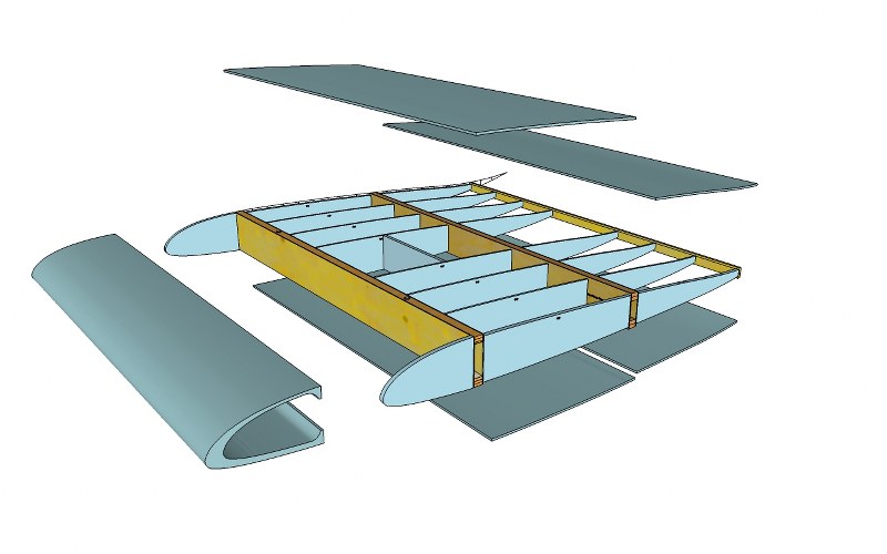

SGIAN DUBH Posted June 9, 2016 Author Posted June 9, 2016 Very pretty little aeroplane. Am interested to know what the skin is over the foam and how you get such a smooth surface finish. the Quaich is constructed from extruded polystyrene foam with 290t glass cloth and West System epoxy. All awkward contours, leading edge D's etc. were hot wired. To further highlight some of the questions/remarks made in previous posts I hope the following will answer a few queries Utilising the same type of construction as in the Iolaire and Sgian Dubh the Quaich is a well tried and popular layout. The aircraft is designed to be easy to handle in the air as well as on the ground. The use of a tail wheel (via the rudder pedals, operating the standard ‘push right go right’ system) combined with fairly large diameter main wheels ensures good performance into and out of short grass strips. If the take off weight is around 290kg and with a best glide ratio in the region of 12:1 then the Vto (take off velocity) will be 38.4mph and Vs (stall velocity) will be 33.2mph. These are calculated figures based on the above moderate assumptions and will improve if take off weight is lower. The high aspect ratio wing is braced at the aerodynamic centre on the 25% chord line by a single strut to the mainspar, which is straight. The full span ailerons are differentialed 1:1.5 and have a rearward pivot point giving a Frise effect when deployed upwards. These devices help to alleviate adverse yaw. The tips of all flying surfaces have been fitted with anti vortex leading edges and tip plates to improve drag at these points. Good all-round visibility is achieved by the low cowling and the sloping fuselage sides. Access is via the lowered port side lifting door/window. The contoured seat forms part of the structure of the main fuselage former. The type of construction employed requires no specialist skills or machinery and could be carried out by the average handyman. The rigid flying surface obtained by all composite methods ensures a better aerodynamic package and therefore better all round performance. The wings are detachable for easy transportation. Assembly and disassembly time will be around 10 minutes.

rotax618 Posted June 10, 2016 Posted June 10, 2016 Could you share your method of producing such a smooth surface, do you cover the cured layup with micros and block sand the surface (very time consuming) or do you have a trick that makes the construction a bit easier?
pylon500 Posted June 10, 2016 Posted June 10, 2016 The aircraft is reminiscent of a plane I test flew many years back, that was also built by an above average 'handy man', built his own house, wooden boat, half finished a KR-2 but got sick of dealing with DoT (CASA back then) and also builds wooden weaving looms. As a University lecturer, he clued himself up on engineering and aerodynamics, and designed and built his own ultralight. Only powered by a Rotax 503, it could still cruise in the 80kt range. Was also a bit squeezy in the cabin, and was all plywood. My own designed single seater was all metal, also a 503, was 30" wide in the cabin (nicknamed the flying armchair), and could hit the mid 70's. I could also fit a full size, two stroke exhaust within the cowl. Was later converted to a two seater. Haas been sitting the back of my hangar for a few years, but nearly ready to fly again... Still not sure how you're getting that exhaust in there? Arthur. 5
rotax618 Posted June 12, 2016 Posted June 12, 2016 I would like to use your construction method on a project of my design, have you had a chance to proof load the wings to verify your calculations? The only concern I have is the disconnection of the wingskin with the spar, relying on the shear between the foam and spar flanges, I discounted this method because of this concern, my solution was to shape the foam to the top of the spar caps and form the glass wing skins using the Strojnik method (lay up the skin on a flat mylar sheet and before it is cured ,hang the mylar up by two edges forming an aerofoil shape) then vacuum the skin sections onto the foam and spar caps. Do you think this method would produce a stronger wing with less finishing?
Deskpilot Posted June 13, 2016 Posted June 13, 2016 Rotax, I agree with your concern re wing skin and spar separation. I asked Hugh about it and he wasn't concerned but I change his design when I was thinking of building one. I lowered the the rib surfaces by 10mm and had the foam sheets level with the spar rather than over it. This allowed the skin to be adhered directly to the spar.

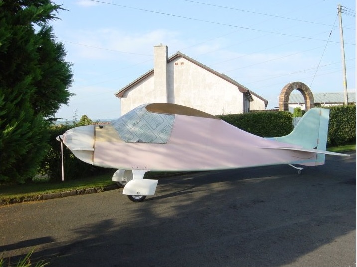

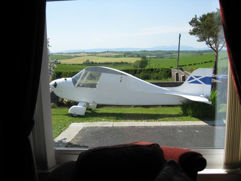

SGIAN DUBH Posted December 29, 2016 Author Posted December 29, 2016 The Quaich was put on the Back Burner as the Sgian Dubh was making Little Progress, now I think the Sgian Dubh is getting very close to being ready for testing, so the Quaich will be getting registered soon ( waiting for a 2017 registered date ). That I think will fly very soon as it is 99% complete already ( just needs a few instruments fitted )
Deskpilot Posted December 29, 2016 Posted December 29, 2016 Eagerly awaiting flight test for both aircraft. Don't give up now. 1
SGIAN DUBH Posted December 30, 2016 Author Posted December 30, 2016 Eagerly awaiting flight test for both aircraft. Don't give up now. The Sgian Dubh is getting ever closer to being ready for flight ;-) I am sure it will be a Momentus Day when both fly over Hugh's Home ;-) 1
