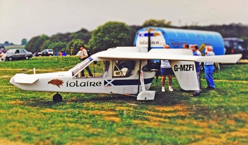

Next Weekend ( 3rd -4th March 2017 ) both the Quaich & The Iolaire are getting collected from Storage & being taken for Flight Preparation. The Iolaire will be getting restored to the CAA Aircraft Register as G-MZFI in the next few weeks ;-) This will be the 3rd of the H.L. SSDR Fleet : G-CJPK was the 1st and is the Sgian Dubh that will be lovingly cared for by Bruce Keeping & check flown by Bruce. G-CKFW is the 2nd and is the Quaich that will be lovingly cared for by Myself & Michael Gregory & check flown by Mike Gregory. G-MZFI is the 3rd and is the Iolaire that will be going to Ireland for restoration by Andrew Russell, Andrew is tasked with getting the Iolaire back into the Air ( The Iolaire has previously flown & was a two seat all flying canard. This met with nothing but blocking even after all the structural stress calculations had been checked and the load testing completed in line with B.C.A.R. Section "S" approved methodology (available from the CAA website). It has flown, and proved stable and easy to handle, both in the air and on the ground, however an approved flight test program couldn't be conducted without a TEST CERTIFICATE. Now with SSDR being available to UK Microlights, Andrew will be trying to get it into SSDR or the Eire Experimental category or suchlike ;-)

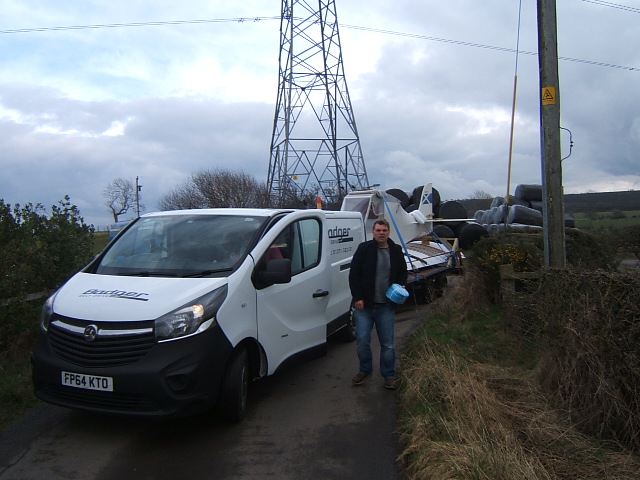

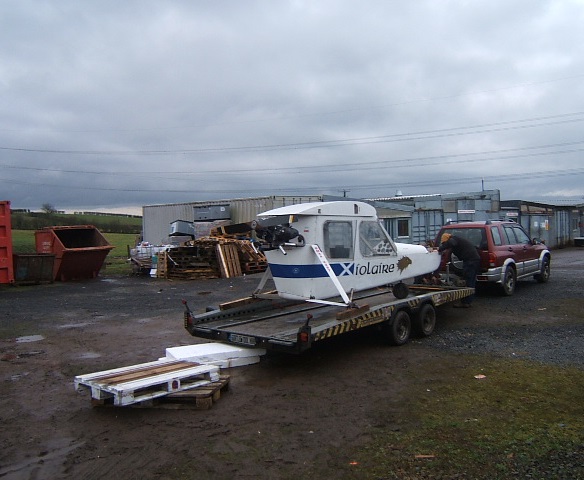

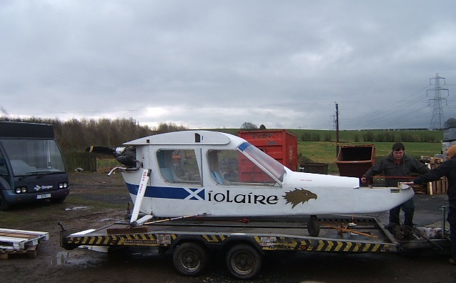

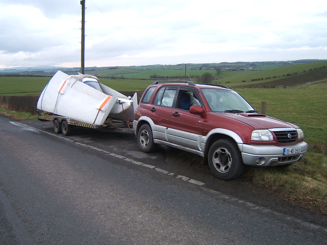

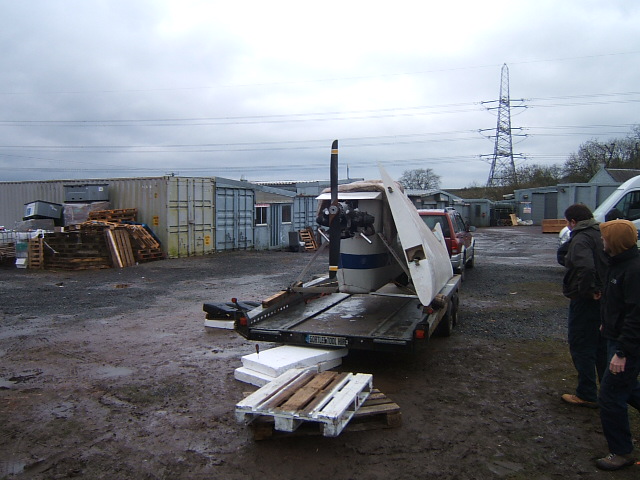

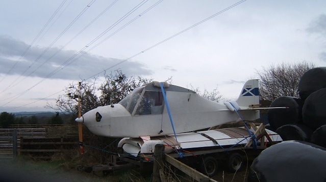

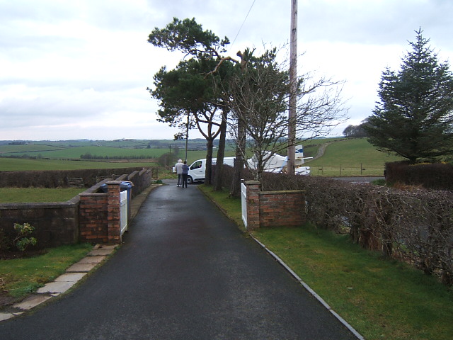

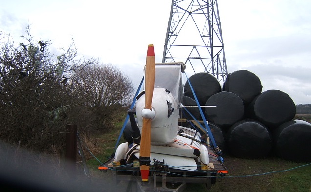

The Iolaire getting loaded in Fenwick Scotland on 4th March 2017 for dispatching to an Irish Location.

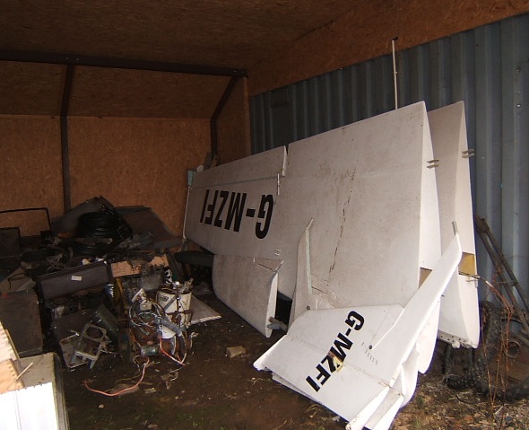

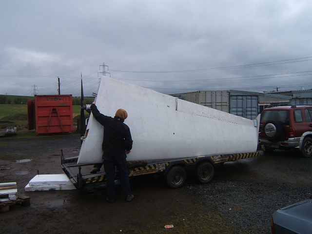

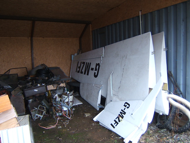

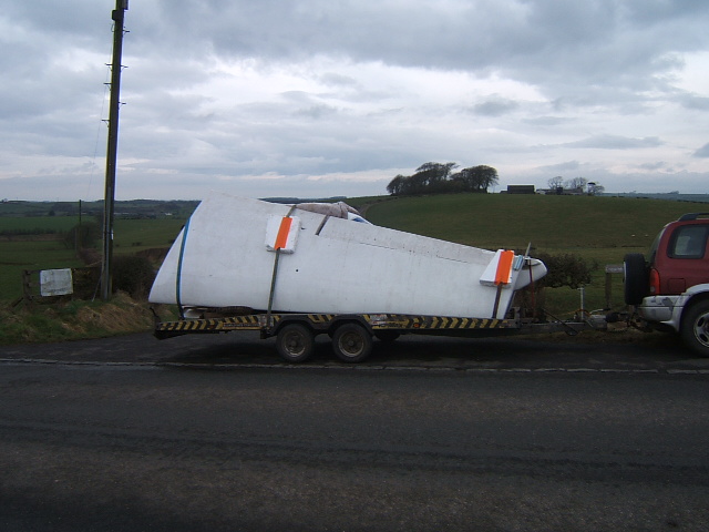

The Wings & Rudders of the Iolaire

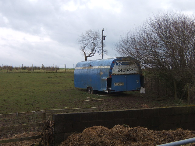

This was the Trailer that the Quaich was kept in ( even though it says Iolaire ) DSCF9684.JPG.d27169d40a824c7b8330570d884e93bf.JPG

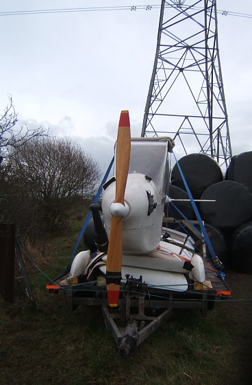

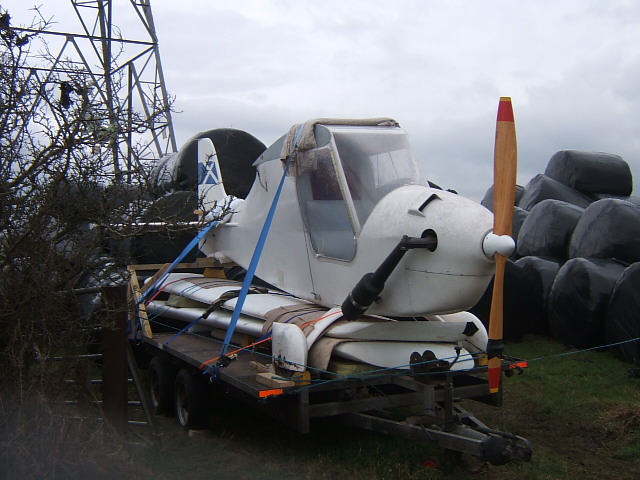

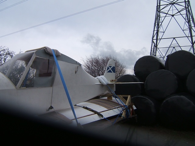

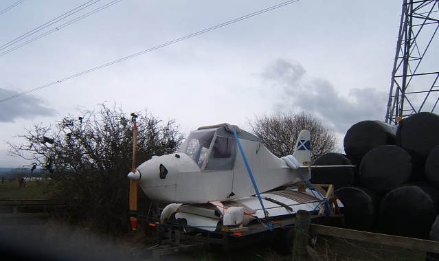

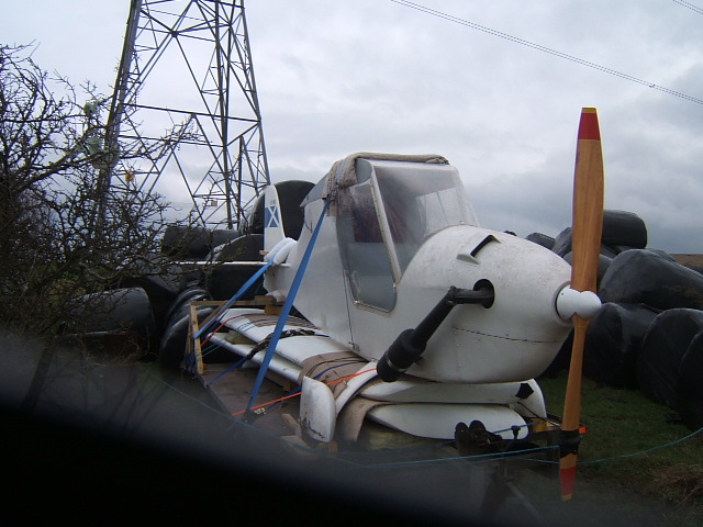

The Quaich loaded on the 3rd March 2017 for a trip down South to be readied for Flight ;-) DSCF9689.JPG.add8cf6494de1d27fa528c9e21ef44b5.JPG

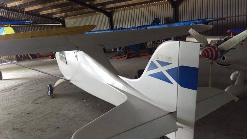

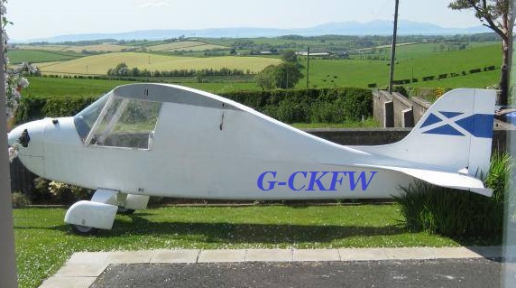

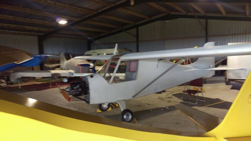

The Quaich ( Above ) in Flying attitude.
The Quaich ( Above) sitting in the Hangar Proudly displaying it's Scottish Origins. Hopefully the Test Flight will be completed fairly soon.

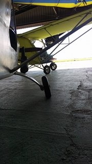

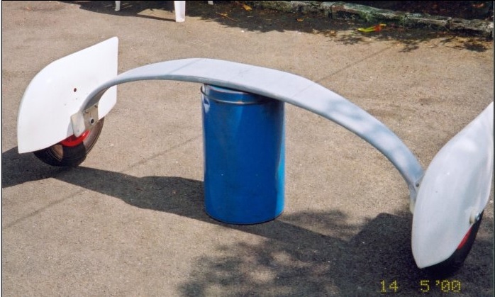

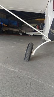

Another area we are looking at now is Undercarriage integrity : After all the Ground Taxying Tests we have now noticed that the wheels are now splayed out !!!
The Taxying tests were undertaken on a slightly undulating runway in Devon and until we do a full stripdown of the wheels etc we aren't sure whether it is wheel bearings that have uniformly failed ( highly unlikely ) or whether the Undercarriage structure has bowed outwards ( this is more likely the case !!! )

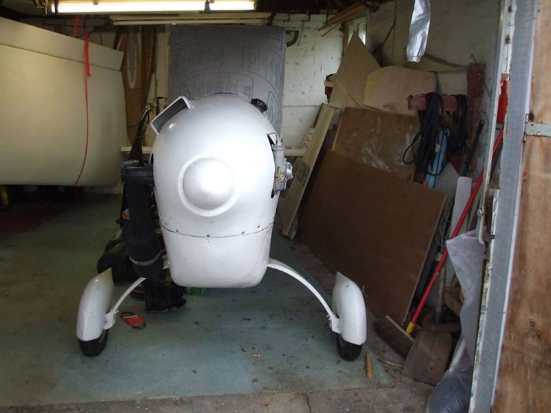

I am pleased we are finding a lot of glitches before it takes to the air fully, just been taxyed fast with tail up so far, the 447 Rotax is running very sweetly ;-) 2104221133_QUUC.jpg.85be193f4ef7770dd183df675606741c.jpg
Opinions on Undercarriage welcomed.
"Glitches"?
If the same person calculated the landing gear as the wings and other structures, I would be quite concerned.
"Glitches"?If the same person calculated the landing gear as the wings and other structures, I would be quite concerned.
Bexrbetter, The Wings & other Structures were tested to Section S so we have no major concerns there ;-) The Landing Gear has actually spread by a few inches, nothing major and not something that has concerned the LAA Inspector who has checked it for us ;-)
