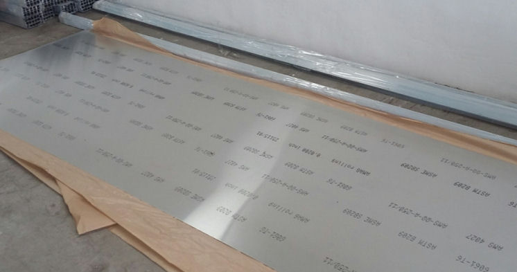

... and a valid point is the laser will cut any material to the pattern, except carbon fibre which can be water cut. But I have a laser 5 minutes away so aluminium, chrome moly, titanium or stainless is the choice. Most likely Ti or stainless as they are at arm's length and available by the sheet. 440 stainless is stronger than chrome moly btw.

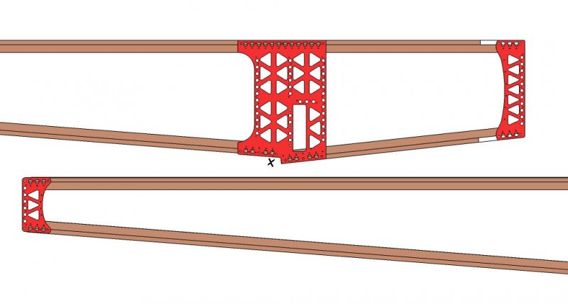

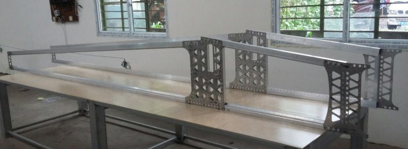

So after another late night of designing nose and tail modules and today turning them into CNC files and sending them to my laser guy, hopefully tomorrow I will have some bits that look like this in real life ...
In case anyone is wondering about the step in the frame where the 'X' is, that's where the landing gear goes.
So no option as a taildragger?
If you came up with a way of making the plate symmetrical, you could just reverse it for tail wheel set up.

I have the tail'dragger plate on file, it's basically the same but the step reversed.

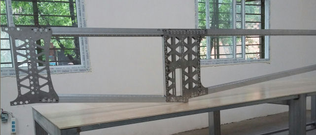

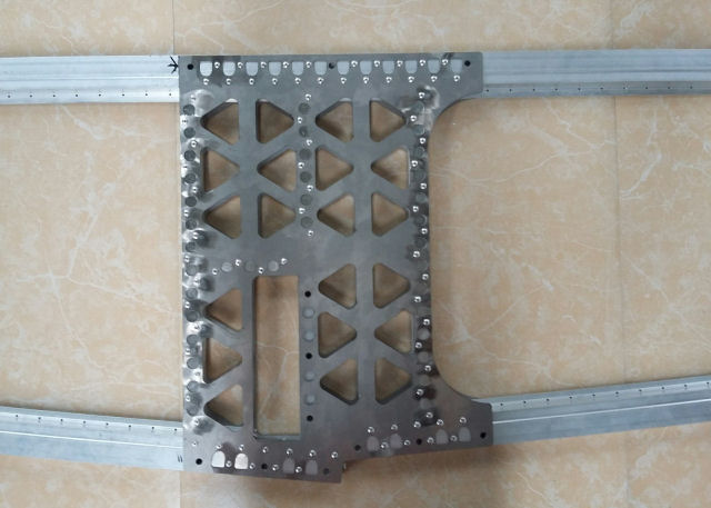

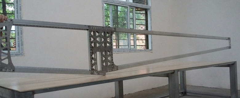

So anyway, this morning had the new nose, new tail and slightly optimised center plates cut and couldn't be happier with the result. Note the nose plate will fold around the corner to support the firewall but is not folded yet in the pictures ..
Very happy with the weights also, below target and lower than original concept.
  • Like 4

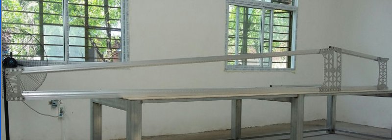

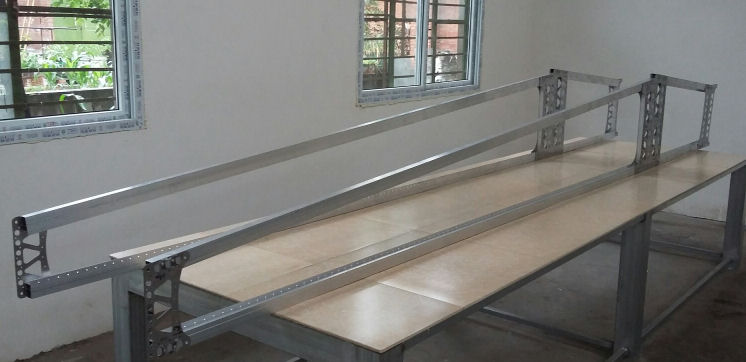

Today was important to me because I got the completely unskilled lad and another guy who has some trade skillz, albeit in another unrelated area, to put the other side together all by themselves. I wasn't at the factory and I told them under no circumstance were they allowed to contact me to ask questions. I asked them not to try to rush.
3 hours it took them working it out as they went and I am pretty happy about that. There's a lot more going on between the 2 main center supports than you can see in the pictures btw.
Point being that I wanted to see if it really is as easy to someone else as it is for me, apparently it is.
(Note that the front supports are yet to be bent around for the firewall)
