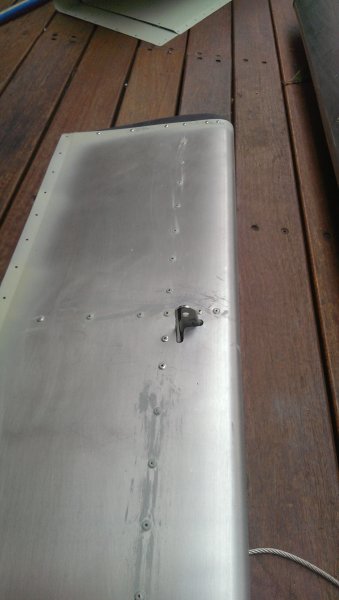

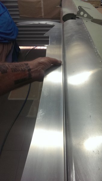

Kyle Communications Posted October 17, 2015 Posted October 17, 2015 I dont think it should be that close..are you sure you have fitted everything correctly
Kyle Communications Posted October 17, 2015 Posted October 17, 2015 The gap on mine is larger for sure
Lyndon Posted October 17, 2015 Author Posted October 17, 2015 At this stage yes. I have had a quick look. Can't see anything that could be fitted backwards etc. But after a big sleep tomorrow is another day for a fresh look Lyndon
Lyndon Posted October 17, 2015 Author Posted October 17, 2015 Hard to see how close it is. The radius is quite sheltered ???

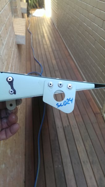

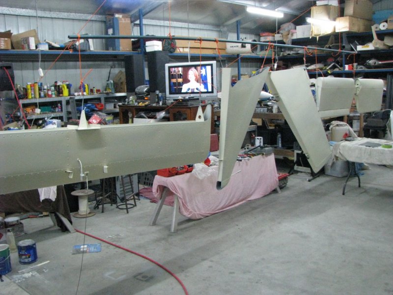

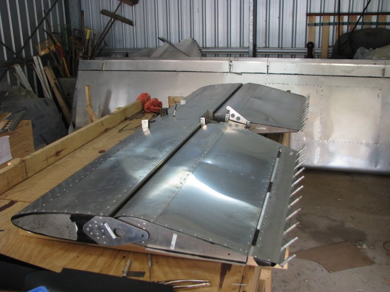

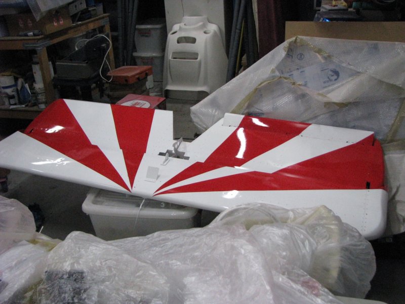

Kyle Communications Posted October 17, 2015 Posted October 17, 2015 Pics after and during painting...are you sure you havent got the end brackets wrong or something?...I know I had the internal pivots on the wrong sides and had to open the skins up and change them over
Lyndon Posted October 17, 2015 Author Posted October 17, 2015 Snap. My pivot s had the same part number Today I also discovered that I had a 50 50 chance and also got em wrong
Kyle Communications Posted October 17, 2015 Posted October 17, 2015 I will be down at the hangar tomorrow hopefully welding and fitting the new exhaust system pipes. I will try to remember to take some pics of the gaps in mine. if Roger is at his hangar I can check his tailplane as it is off his plane for painting as he has sold it. I will check his. His model is a Classic though not a VG

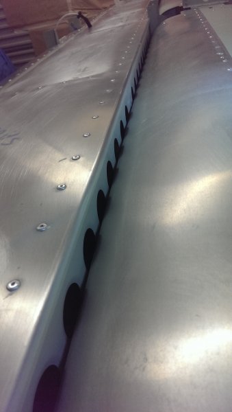

Lyndon Posted October 17, 2015 Author Posted October 17, 2015 Under side. Either the elevator or stabilizer has a woof in the middle Lyndon

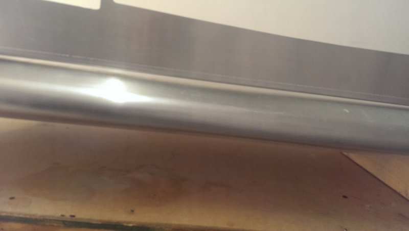

Lyndon Posted October 17, 2015 Author Posted October 17, 2015 Leading edge of the elevator is not straight. No ribs in in the center so on the edge it's wide and in the center it's not as wide thus its about a 4 mm woof. A fix anyone ??? Lyndon
Lyndon Posted October 17, 2015 Author Posted October 17, 2015 A better pic. You can see the leading edge to. Sharp as there in no rib. This makes it protrude Lyndon
Kyle Communications Posted October 18, 2015 Posted October 18, 2015 Yes well I had a look at mine and after seeing your pics that would certainly do it. You either need a new or refitted LE skin or hopefully the elevator frame is not bent that would also cause it
Lyndon Posted October 18, 2015 Author Posted October 18, 2015 Reg has advised it happens. Counter sunk rivets is the fix. I have also gently with a block of wood taken another 1mm of the leading edge in the middle. All good now. Thanks Lyndon 1
