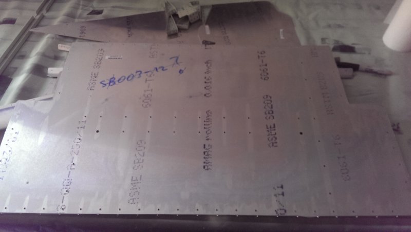

Lyndon Posted October 4, 2015 Author Posted October 4, 2015 Is this the back my book says sb 003-12 but ???
rankamateur Posted October 4, 2015 Posted October 4, 2015 Fit the two together and see how they line up. Mine has round shoulders because it is an S so looking in my manual won't help. the cutouts in the floor are for the cabinets that house the flap control rods so fit them in the there an se if the mounting holes line up on the back wall.
