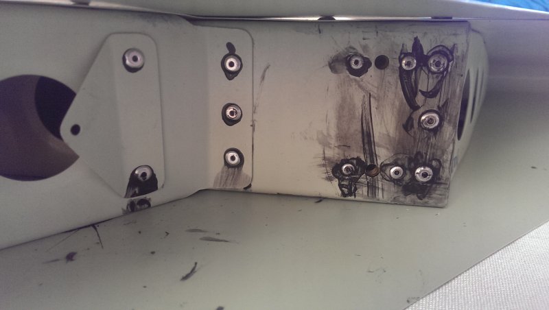

Lyndon Posted September 22, 2015 Author Posted September 22, 2015 Mark great info. I too just found my counter sunk rivets for my fin. Three a4 ones. The four a3 rivets that fit the retainers in the same spot I take it are just normal a3 rivets. Lyndon Â
Lyndon Posted September 22, 2015 Author Posted September 22, 2015 I will now replace these three rivets  Â

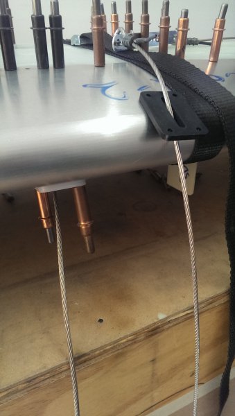

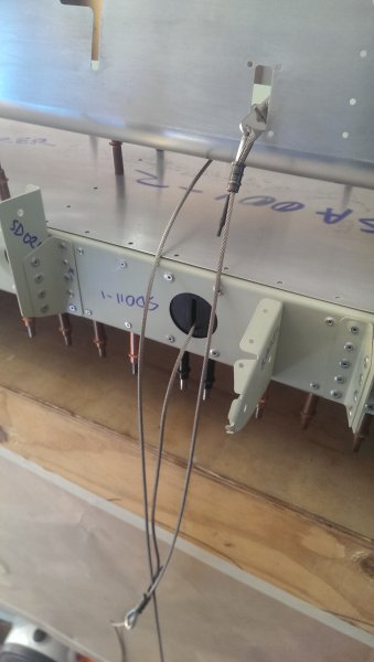

Lyndon Posted September 22, 2015 Author Posted September 22, 2015 Before I button it up. Have I thread the correct end through it. It can go in either end Lyndon  Â
Kyle Communications Posted September 23, 2015 Posted September 23, 2015 from memory the elevator was the same loop on both ends the main issue is getting the correct rudder cables in the fuselage on the correct sides they are actually a left and right side cable...I got mine wrong and had to take them out and put them in the correct sides it was a real pain. The countersunk rivets need to be only on the area that the base of the fin fits flush up against the tail post all the rest of the rivets are just standard ones. Â

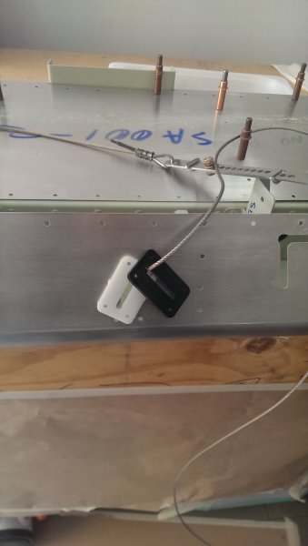

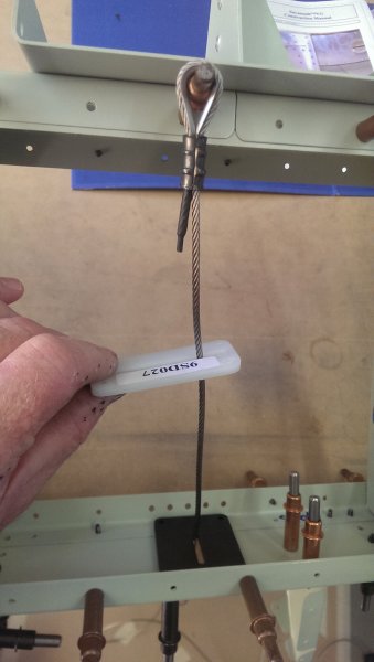

Lyndon Posted September 23, 2015 Author Posted September 23, 2015 It's says use the middle block. There is three of these. Mine has four. Pretty sure it's right Â
Lyndon Posted September 23, 2015 Author Posted September 23, 2015 I have two identical blocks left. One on either side of the nose skin or is one used somewhere else. The cable is installed so the adjuster will be up the front of the plane as this makes sense to me. Lyndon  Â
Kyle Communications Posted September 23, 2015 Posted September 23, 2015 The adjuster goes up the front as it will be inline with the access panel under the fuselage so it will be the correct way around then Â
Lyndon Posted September 23, 2015 Author Posted September 23, 2015 Perfect. I have one block left. I take it that will be used later some where else Â
Kyle Communications Posted September 23, 2015 Posted September 23, 2015 I dont recall having any spare blocks on the cable....for some reason I think there were 2 blocks used in the tailplane but it was 3 years or more ago when I did mine. I would have to have a look at mine to remember...I may have some pictures I took at home I will look this arvo when I get home Â
Kyle Communications Posted September 23, 2015 Posted September 23, 2015 Just looked at one of the pics on the pages I sent you and I think there is a block on the top and bottom skin on the tailplane... Â
Kyle Communications Posted September 23, 2015 Posted September 23, 2015 Looks like there is a block on the underside of the main tailplane at the front skin and the other one must be at the back of the mainplane on the top skin Â
