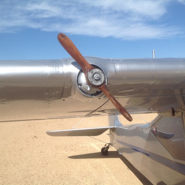

Old Koreelah Posted December 12, 2015 Posted December 12, 2015 Amazing hybrid Auster perfected regerative braking yonks ago! This baby would also give a helpful boost on takeoff! Seen at YQDI Christmas FlyDay this morning. 1
