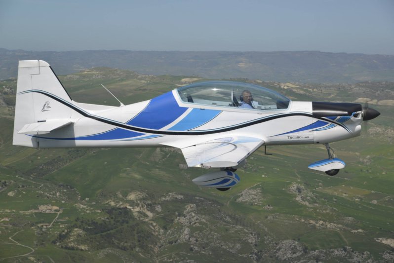

New Tucano-LSA

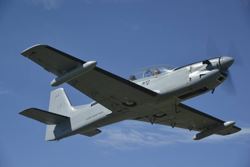

Tucano Replica - Tougher look with external tanks
It certainly looks good. With inflight dropping of ordinance it would bring a new dimension to the old flour bombing comps:wink:

That's a thing of beauty. Love the tandem layout, and the faux military look.
It's a good looking aircraft alright - particularly the retractable gear version. It would be a great project to have in the shed. Building one would obviously take time and money, but if I had the money I'm sure I could find the time.
rgmwa
Once you get the gear out of the way, you can get some real speed with a clean design like that but it needs to be a much more sophisticated approach to the whole project. Nev

The retractable looks so much better than the fixed gear!012_thumb_up.gif.cb3bc51429685855e5e23c55d661406e.gif
Right now there is not a lot of speed advantage but that is begin looked at. I would like to fit nose gear doors as personally I believe this may be a contributing factor if applying Roy LoPresti theory "If I was a molecule of air what would I do" - it would look nasty head on.
But I agree it look tougher legs up and with the tanks.
Gear doors should make a difference. On the same note, do those stub exhausts work? It looks like the engine exhaust is under the cowl. If they don't, I'd leave them off mine ... if I had one. 051_crying.gif.fe5d15edcc60afab3cc76b2638e7acf3.gif
rgmwa
On the Australian first of type I will be installing 2 x 4'' OD fake turbine exhaust as per the Shorts T1 Tucano- the engine exhaust will dump into these and this should provide a means for the cowl air to escape.
The exhaust on the factory aircraft are dummy's
Gear doors should make a difference. On the same note, do those stub exhausts work? It looks like the engine exhaust is under the cowl. If they don't, I'd leave them off mine ... if I had one. 051_crying.gif.fe5d15edcc60afab3cc76b2638e7acf3.gifrgmwa

On the Australian first of type I will be installing 2 x 4'' OD fake turbine exhaust as per the Shorts T1 Tucano- the engine exhaust will dump into these and this should provide a means for the cowl air to escape.The exhaust on the factory aircraft are dummy's
I quite like the idea of the exhaust being underneath the aircraft...Generally there is no easy way for CO and the other noxious combustion by products to end up in the cabin with you.....If however you are exhausting where the falsies are then your really going to test then quality of the seal on the canopy.... I wouldn't do it!
I also note on my aircraft that there is always oil of some sort or other on the belly......I wouldn't want that anywhere (including the belly if it can be avoided) else

Agreed, but if they just create drag, off they come. I require the speed to match the looks. 080_plane.gif.36548049f8f1bc4c332462aa4f981ffb.gif

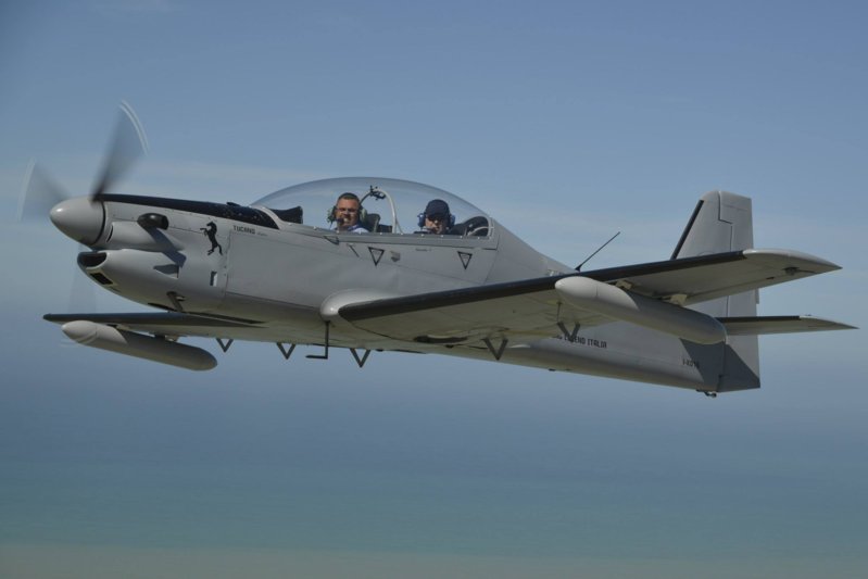

592981396_11011459_926370457393464_2987532987867167832_n(1).jpg.4e0e4997eabd747ea0069d727be84a3a.jpg
This is by the standard of the type clean as was the prototype.
Speaking as a builder the stubs are not a real issue I think more could possibly gained by filling in the hole as its a big cliff for a molecule to fall off. The issue is weight the whole mechanism would have to weigh under a kg. , this can be done if it is totally mechanical using the leg to close the door but its all weight and weight is the problem
Wouldn't have thought it'd be too hard to make a lightweight longitudinally-hinged door for the noseleg which is dragged up when the gear is retracted. The main gear doors could possibly be extended to cover half the wheel too as per Spitfire etc.
