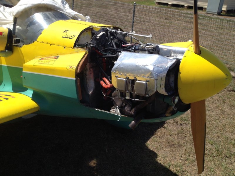

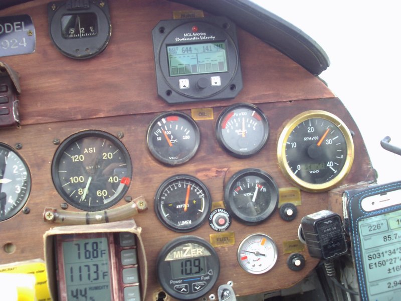

Old Koreelah Posted March 12, 2015 Author Posted March 12, 2015 Update: I did lots of research and shied off the fences idea, because the incoming air would be heated by contact with the crankcase and barrels before passing down thru the head fins, where cooling is most critical. A call to the factory confirmed that people have tried fences and gone back to the ducts. Spent a week grovelling around inside my shipping container fitting a pair of sheet aluminium ducts. (Could have done a neater job in half the time with fibreglass.) Based on what others have written, I eliminated all leaks and extended the ducts over 2/3 of the cylinders (and fitted large butterfly baffles) and right to the bottom of the heads, with less than 5mm clearance to force air thru the fins. Test flew on Wednesday: 166 degrees C- no cooler than the old-style fibreglass ducts. What a disappointment. Spoke to the factory who stressed the importance of sealing leaks to get low pressure in the lower cowl. Had a closer look and found a few small gaps. Sealed them with rubber and silastic. Test flew yesterday: over twenty degrees cooler!    1 1
