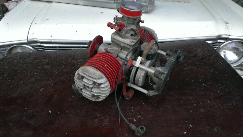

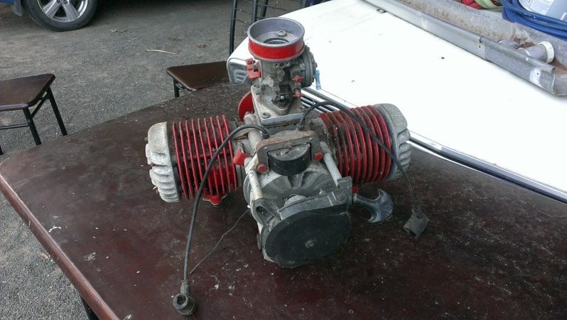

G'day all!
I have what I think is an Aussie made "Skylark" ultralight aircraft engine. It's taken me a full 12 months just to get a name for this otherwise unmarked engine. I'd like to run it for a bit of fun but I'm not sure mine is complete in the ignition department. It also appears to have been subject to some modifications - i.e. the addition of a pull start that is almost certainly a "Victa" part, the flywheel is most certainly marked "Victa"!
The only info I have been able to find is the tiny bit of info at this site where I think what is the same type of engine is pictured;
http://victoriancollections.net.au/items/51085d662162ef0e30b5463f
Has anyone got any info, parts or manuals that I may buy, borrow or copy? Amusing anecdotes or other info for this type also welcome.
Any and all help is greatly appreciated.

It could be the 170cc twin motor that Victa imported from Canada around 1975

I measured the capacity of this engine some time back and if my memory is correct it is 330cc total? I thought it might be a Victa twin too but it isn't I'm sure.
The pull start on it and probably the flywheel are modifications made to either make the engine go in lieu of missing original ignition parts or perhaps to "convenience" the operator. I know trying to pull start a Victa mower with no decompressor will just about pull your arm off when it fires and is very hard on the pull start cord - it will break in a very short time. I can't imagine the pull start fitted to this engine would have been any good either at twice the cc's of a mower and still no decompressor, it can't have been "convenient" at all. Also my specimen appears to have had it's engine mounts altered or replaced entirely to acomodate the installed Victa parts. A suspicion I held before I saw and supported by what I can see of the engine shown in the link.
I don't think this is a "Victa", it's just got some Victa parts fitted to it. I am prepared to be corrected however.

Presently the engine has a two lead coil, the two spark leads, the Victa flywheel and some sort of electronic looking module thingo - maybe a condenser? - It's about the size of a postage stamp. I haven't pulled anything apart yet but as far as I can tell it doesn't have any points although I imagine it should have/did originally.

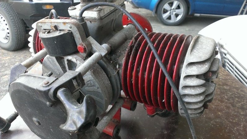

Hi, I purchased a skylark engine of the type you describe around 1982 to fit into a Mitchell wing U-2. It was constructed in Melbourne I believe from mainly Victa parts. It performed okay until after five hours The Crankshaft developed a crack in the weld which bonded the crank pin to the crank web. No damage to the aircraft however I then ordered and fitted at Konig three cylinder engine which gave excellent service.
If I remember correctly this engine was advertised in Airsport magazine so if you could locate some old ones that may be of help.
If my memory springs to light with any more information I will post it.

I put up a photo of the brochure here in this thread.http://www.recreationalflying.com/threads/skylark-2-stroke-motor.11145/#post-111459
in 2010. Looks like you may have one. Have never seen a manual for one even when they first came out. Good find, a piece of history.
You sir are a champ! One pic really says a thousand words -and most of them say something like "OMG I thought the pull start was some homemade cobbled together junk, I can't believe it left the factory like this"! Apart from the angled carby mount shown in your brochure pic my engine is identical! Actually my cylinder heads appear to be very slightly different too - mine having an extra cooling fin on each side.
Also viewers should note that the red paint on my engine was added by the previous owner many years ago when he was a teen because " he thought Holden red would look good". I am reluctant to disagree with him!

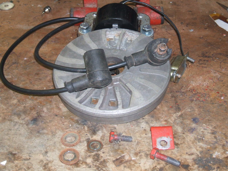

Bit of an update for you here. Minor disassembly of the engine to get a look at the ignition has revealed the coil to be a Victa twin coil and the other part is a Victa module.
I swapped the module with another Victa module of unknown heritage and still had no spark. I tried another type of module called "Nova" (which is presumable similar to the "Atom" but of much more recent manufacture) also of unknown heritage and still no spark. I had the coil tested at a mower shop and they said they had trouble fitting it to their machine but should have gotten something out of it - but again no spark with them either.
I reckon my coil is dead. It certainly seems to confirm what I was told almost 20 years ago and have read again recently on the net about the Victa twin mower - these coils are very probably the worst coil (or part outright?) that Victa ever made. It was largely the reason for the demise of the Twin mower, along with high production costs no doubt. The rear cylinder would quickly end up with a weak spark and soon after, no spark. Victa even fitted a a domed higher compression piston to the rear cylinder to try to help (not sure how it would). Hardly aviation material! Eventually a "revised" coil was produced apparently but I've seen and heard nothing of these.
Anyhoo, it looks like I'm going to be fitting my Rxcel ignition after all. I need to know the ignition timing for this engine. If I get stuck I'll go with the Victa 160cc timing which is given as 3mm before TDC (easily converted into degrees). The Skylark engine has exactly the same bore and stroke as the Victa 160cc. It wouldn't surprise me if it uses the same pistons too. It does however have a significantly higher compression ratio I think. I think this affects combustion rates and in all probability therefore the ignition timing too. Any ideas anyone?
I have found "28" stamped into each crankcase half if this helps anyone.

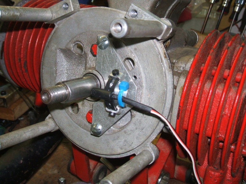

Rcexl systems run 26 to 28 degrees btdc. This is what you use to set inital (static) timing on the hall sensor.
The automatic advance will retard the spark until about 3000 rpm from memory.
This should get your engine working at least. All the RC engines with rcexl pretty much run these figures.
I developed a kit (first one) for owners of these systems to set and test these ignition systems themselves. Previously owners had to return their engines to the dealer. The chinese engine manufacturers were banging these systems on their engines without setting them up properly causing alot of warranty returns and a few crashes all because the timing was out.
oh yeah, remember that it is the point at which the magnet LEAVES the hall sensor which is the exact firing point.

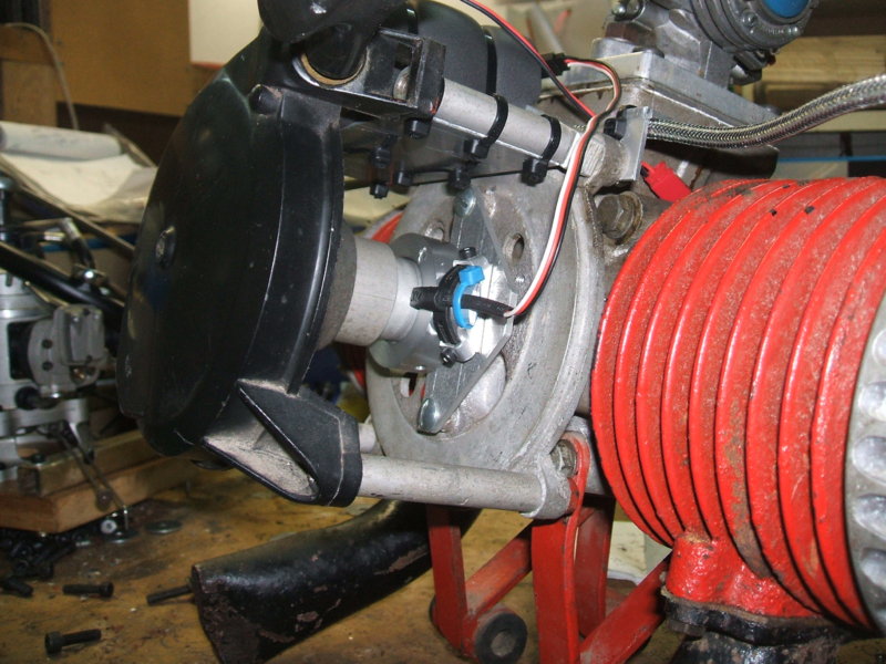

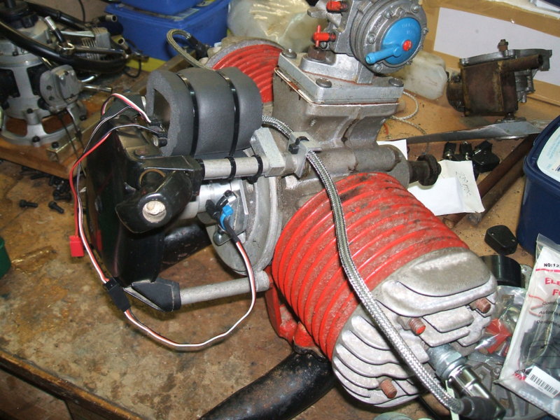

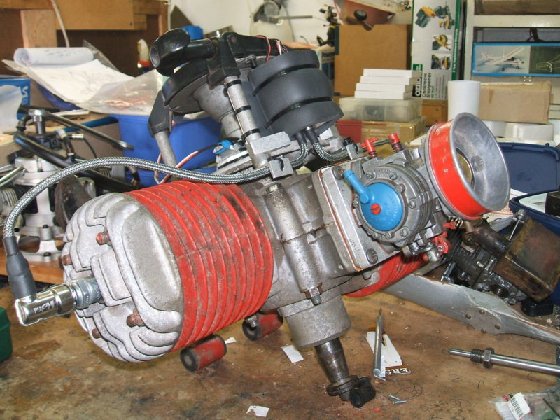

DSCF1119.JPG.7bf7dcf1138465f06bfbcd3e9b711325.JPG Thanks for your continued interest guys!

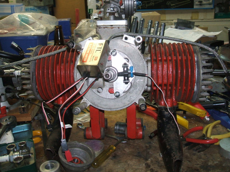

I have gone the Rxcel ignition route. I worked out that "Victa" timing (for their 160cc single mower) is 23 deg btdc so I have set mine there. Downunder do you suppose this is correct or should I opt for the 30 deg that everyone seems to use when converting model glow engines to petrol?
The machining involved was pretty straight forward, the result being what I liken to being a "record player" arrangement - that is the magnet is mounted in the face of a rotating disc passing under a fixed Hall sensor pickup that is itself mounted at 90 deg to the shaft. Timing is adjusted by loosening the starter cup and the two grub screws that secure the magnet housing disc to the shaft then rotating the disc to the desired position.
The fitting of the ignition gear after the machining is a breeze. So simple, neat and tidy. I reckon it has a far more sophisticated, RELIABLE, lightweight and better shielded ignition now than it ever did. I have no plans to fly this engine in anything but if I was to do so I'd take this new Chinese ignition over the old stuff any day, even though the manufacturer specifically said not to. I expect this admonition is more for their benefit than mine 020_yes.gif.58d361886eb042a872e78a875908e414.gif
Any thoughts on the correct spark plug to use? I've put a couple of plugs in it (NGK BP6ES) that were working perfectly when removed from my Mini Moke whilst chasing an ignition problem there. These plugs have exactly the correct length of thread on them but as for the correct heat range for this engine I have no idea.

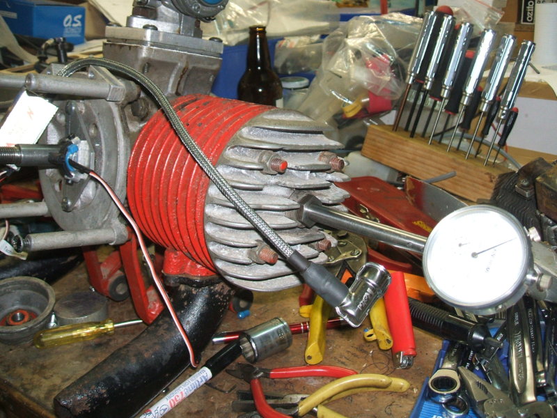

Attached are some pics for your amusement that show the new ignition being fitted. I apologise for all the cr*p in and around the engine. Only now have I noticed how cluttered it makes the pics.
Made the tool with dial gauge to establish T.D.C. and 3mm B.T.D.C. as per "Victa" mower timing. The portion of the tool threaded into the head is made from the bottom of an old dead "Victa" decompressor! I kept that part for years. I knew it would be useful one day! The other bits of metal picked up at the tip shop. I only had to add my dial gauge, two grub screws and some time on my lathe. Other pics show flywheel and other now obsolete parts removed including a small wooden wedge, very possibly fashioned from a clothes peg, that was used to jam the coil in place on it's "E" core (this engine came from a plane that crashed apparently remember). "Here's one I prepared earlier" - a small glow flat twin that I made some years ago, total capacity of 0.65cc. Also visible is an empty brown bottle that until recently contained an apple based "thinking juice". I'm not sure it works very well, but I'm going to keep trying it until it does 003_cheezy_grin.gif.c5a94fc2937f61b556d8146a1bc97ef8.gif
