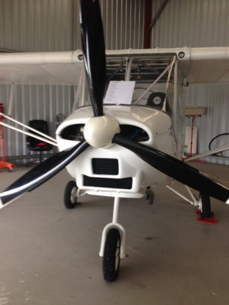

william russell Posted February 6, 2016 Posted February 6, 2016 You wouldn't have any photos of the Radiator/Oil cooler/muffler set up would you William? Sorry Geoff I have not been on this forum for ages and just saw your post I am glad you have it all sorted now My Hanuman/hawk has the 80hp 912 I would have loved the 100hp motor but it has not been certified here in UK so cant fit it without major mod paperwork being done, mine climbs at 800/950 feet pm at 55knts but burns approx 10lph solo and 12 lph dual. I will post a couple of pics of the engine setup etc if you are still interested and would love to see what you have done to yours but I really must agree I think it is a perfect all rounder. Sorry again for not seeing the post when you needed the help Regards William 1
