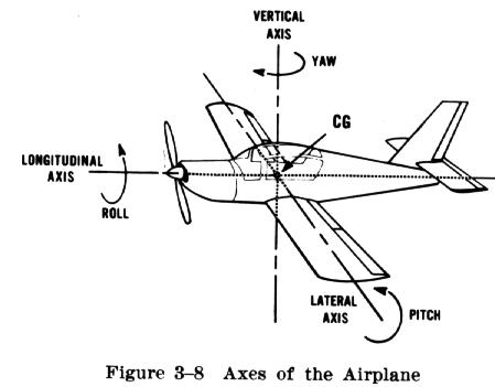

Hey guys, this is something that always get me thinking, I've seen articles that i read about weight and balance, and it said that plane pivots along their central gravity during flight... I thought the central pressure (CP) would act like a falcon on a leaver which is the pivoting point because that's where most of the lift is generated and so the aircraft pretty much get's lifted up from the CP. Anyone care to explain?

The Centre of Gravity of an airplane is a theoretical point through which the Force of Gravity is said to act. It is taken to be a point for the purposes of calculations. The C of G of an airplane can move fore and aft, side to side and up and down by altering the mass and location of loads.
The Centre of Pressure is a theoretical point through which the Force of Lift is said to act. It, too, is taken to be a point for the purposes of calculations. The C of P can move by the change of Angle of Attack and airspeed.
The confusion you have is due to the misrepresentation in the diagram you have. What is the horizontal stabiliser at the rear of the airplane doing? It also produces Lift. This Lift counteracts the imbalance between the Force of Gravity, acting through the C of G, and the Lift force acting through the C of G.

Not to mention that the CG seems to be in front of the leading edge! I think she's a bit nose heavy...

It's a silly diagram. The centre of gravity would normally be around 1/4 of the chord from the leading edge The centre of lift does change with change of AoA and flap extension. The variable force of the tailplane ( horizontal stabiliser, controlled by the elevators) enables you to control pitch by overcoming the couple ( turning moment) that exists when the CofG and the centre of lift are not in the same place. eg if the centre of lift is behind ( towards the tail) the centre of gravity, the nose will tend to drop unless there is a downforce on the tail. This is the normal situation. If you have the plane requiring an upforce(LIFT) from the tailplane, it will tend to be unstable in pitch. Nev
That's a bad diagram, for sure. If you look at it, it seems to have introduced prop wash into the story and labelled it "Thrust". The position that indicates C of G appears to be where the Datum Point for Weight and Balance calculations is likely to be for this make of airplane (at the firewall). Facthunter is correct in saying that in a balanced airplane the CofG is located about 1/4 of the chord from the leading edge, which is where the CofP is located when the airplane is flying straight and level.

Simple answer is 'All movement is around the Centre of Gravity'
But remember, the centre of gravity, or balance point, exists in 3 directions (axis).

The diagram you posted is a bit misleading but perfectly valid even though the CG and CP positions are shown in very extreme locations. Using the fairly 'conventional' type of aircraft shown in your example, to be positively stable (i.e. a condition where the aircraft would want to return to equilibrium after being upset by turbulence, for example) the CG should always be ahead of the CP at all Alpha (angle of attack) up to the stall angle. As alpha increases (on the round-out for landing, for example) the pressure field moves forward which is why we need a static margin (the distance between the CG and CP in level flight) that is great enough to assure that the CP does not move ahead of the CG at high alpha. If that were to happen then the airfoil would develop a negative pitching moment i.e the nose of the aircraft would want to rise even further as the stall is approached, a condition that would be described as unstable.

Note though what Pylon said, the movement (rotations in all three axes) are about the three dimensional CG and since the CG is positioned somewhere along each of X, Y, and Z axes, and always acts downwards, then as the nose of the aircraft moves up the CG moves forward in a high wing aircraft and aftwards in a low wing, so the CG and CP move apart in a nose high, high wing, increasing it's pitching moment and also increasing its stability and the opposite is true for a low wing. Before the howling starts, this is a very small effect due to the CP always acting perpendicular to the wing whereas the CG always acts vertically, but nonetheless it is the reason that midwing and biplane aircraft became popular for aerobatics since in those configurations there is no pitching moment change with change of attitude.
So Solomon, the simple answer to your original question is 'CG'.

the 'vertical'axis is usually called the 'normal'axis these days, that is at right angles to both the longitudinal and transverse axis....its rarely vertical!!
I think the term "normal " means at right angles ( 90 degrees) to. Nev
Quite correct. In the earlier post we were discussing a plane in straight and level flight, at which time the force through the CG (just the weight of the aircraft if in straight and level flight) would be vertically downward, at any other time the 'CG' is usually mis-described, especially in the classroom, but for the well-intentioned purposes of simplicity.
Of the forces acting on a manoeuvring aircraft, the total forces acting through the CG produce a vector which is neither downward nor normal to (or - at right angles to) the longitudinal and lateral axes, since the weight (1G) is always acting downward toward the ground regardless of the attitude of the plane, and centrifugal forces due to turning are acting at right angles to the long and lat axes. So the vector of those combined forces acts in a direction somewhere between the 'normal' axis and the ground.

If you look at the image you posted at the beginning of the thread and remembering that the CG is in a 3D position, and note that the CG is both ahead and below the CP. As the nose rises, rotating around the CG, the CP moves down and backward, so when the nose is high the CG and CP are spaced further apart horizontally. Then consider a low wing aircraft, the CP would be below and behind the CG, so as the nose rises, rotating around the CG, the CP moves down and forward so when the nose is high the CG and CP are spaced closer together horizontally.
