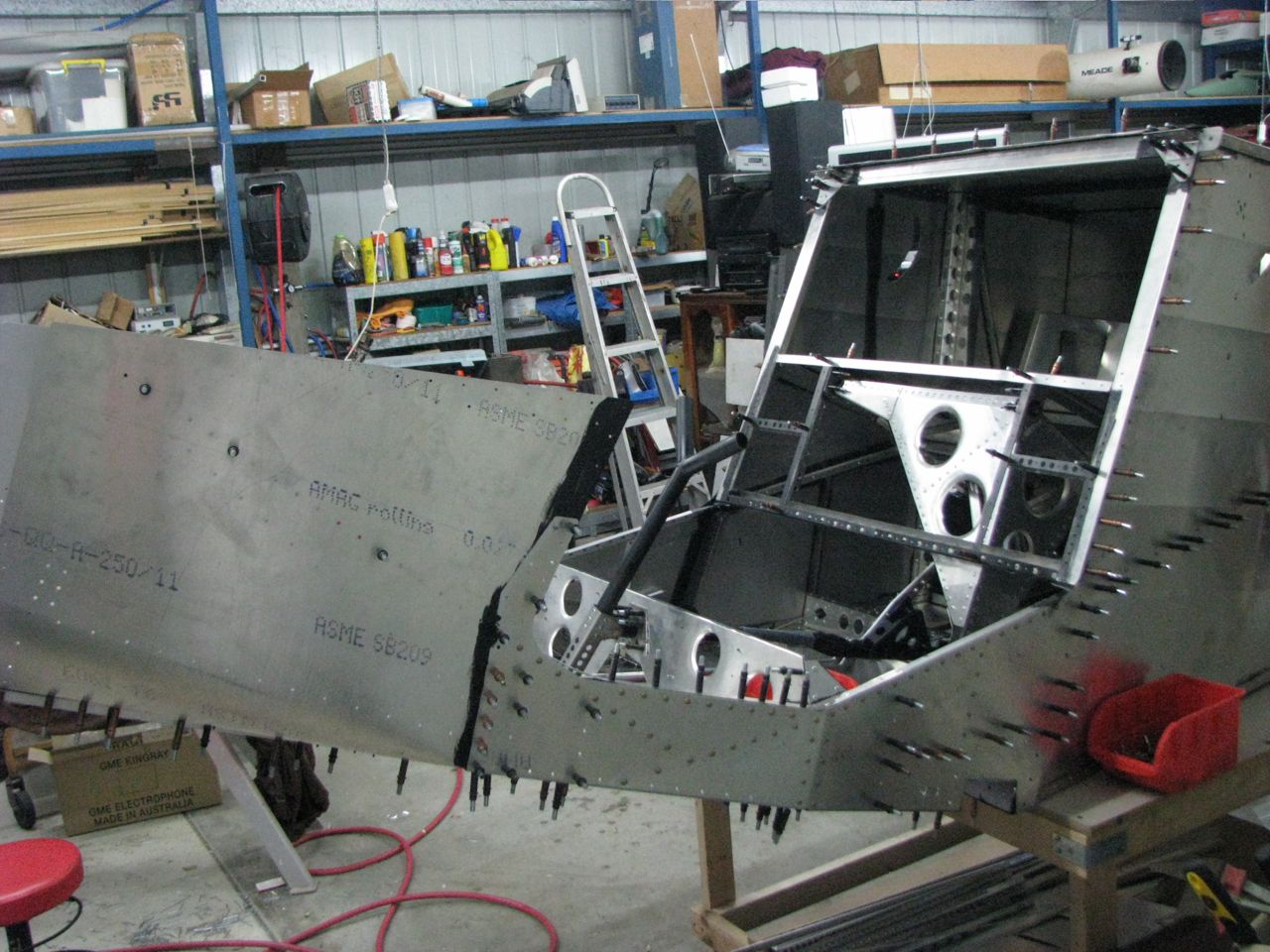

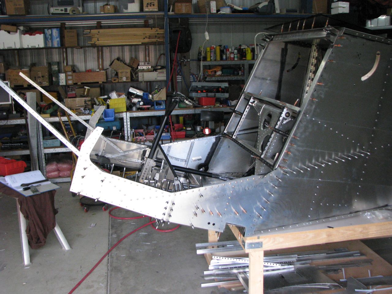

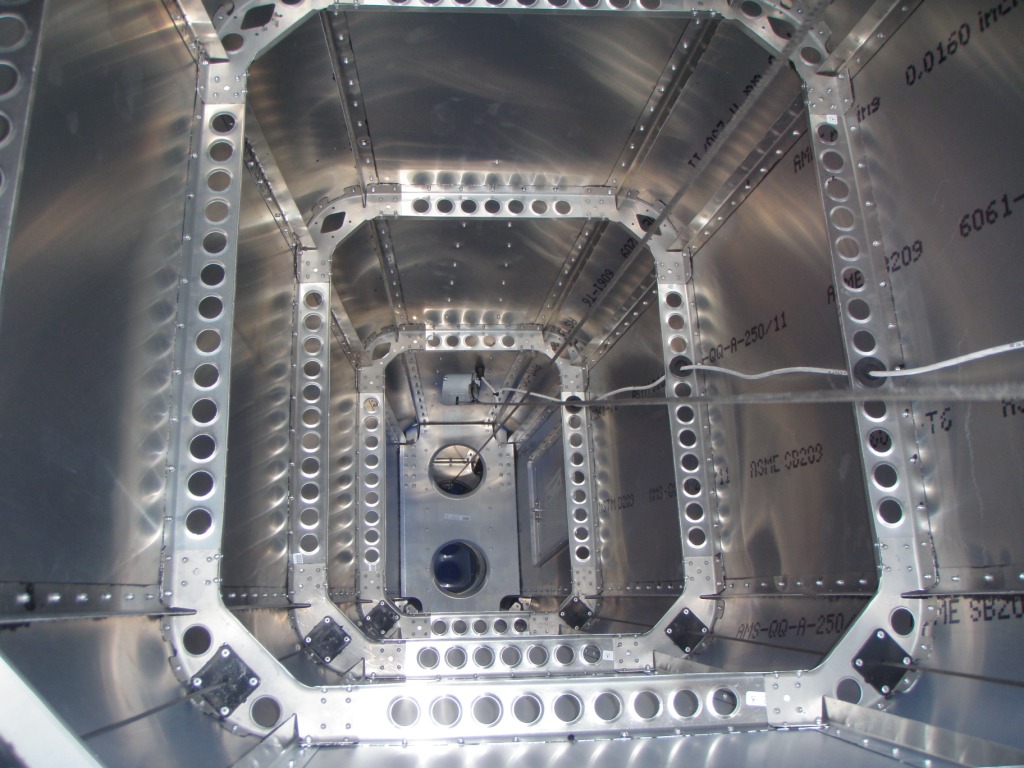

progress is being made :). There is a lot of work and riveting for the rear section of the fuselage I am surprised how long it has taken. There must be 2000 rivets in that section. Thats now done and now I am into fitting the cabin section. This is going together quite well so far. I have put the battery in the new position I was toying with the idea of placing it down the back in the original position as there has been some discussion about the current VGXL being a bit nose heavy. I rang Bill Grieve and asked him about his factory built one as he has done a couple of weight and balance on his and after chatting to him I will go with the battery in the new position. His came out in the mid range and needs his tie down kit in the back compartment where thee battery used to be to keep the sav flying without any stick pressure when he is fully loaded. I thought with the extended engine position and the prop extension the balance would have been a bit more forward but apparently not so its behind the seats. I have been doing an hour or two most nights and progress is nice and steady.

Further progress over the last week or so. It certainly helps doing 1 to 2 hrs a night on speeding up the build. Most time is spent really getting the next set of parts ready. Cleaning,deburring and painting the black goop on and waiting for it to dry..the rest of the time is deciphering the manual :). Have fitted the joystick and control rod also made the flaperon mixer and belcranks. I found it easier to do this from the front rather than do it through the hole in the bottom...I am not a small guy so easier for me not to spend too much time in that opening. Cant work on it this weekend as going out to Dalby for a big model aircraft fly-in its once a year..Tommo should know where it is its on the Cecil Plains Road

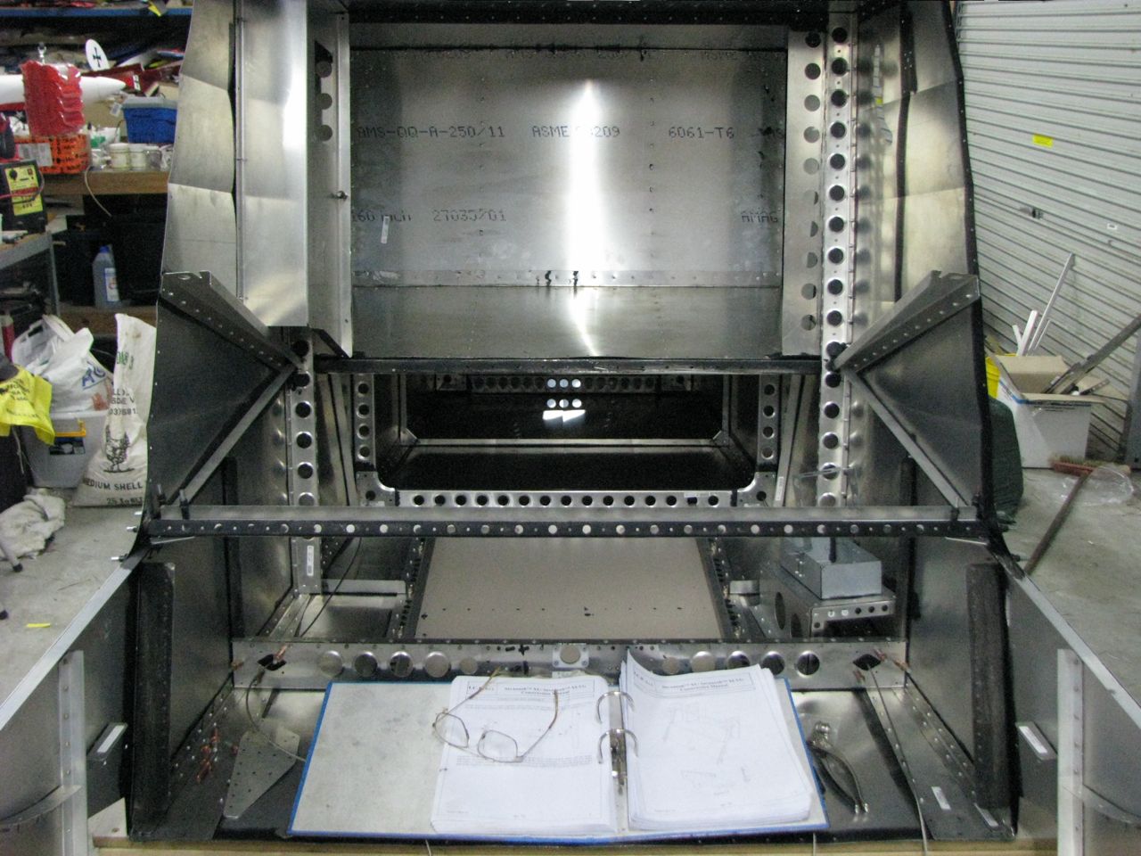

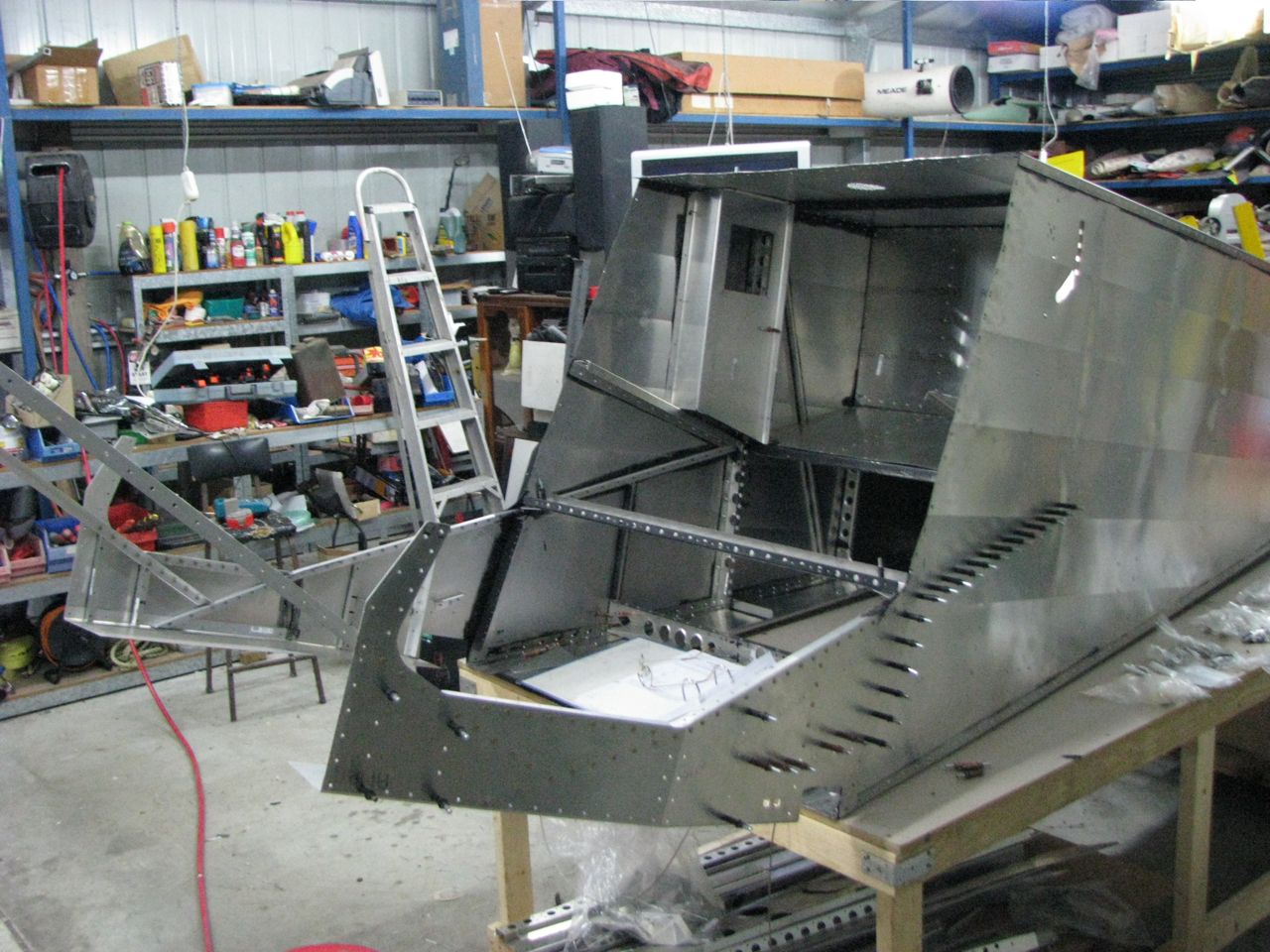

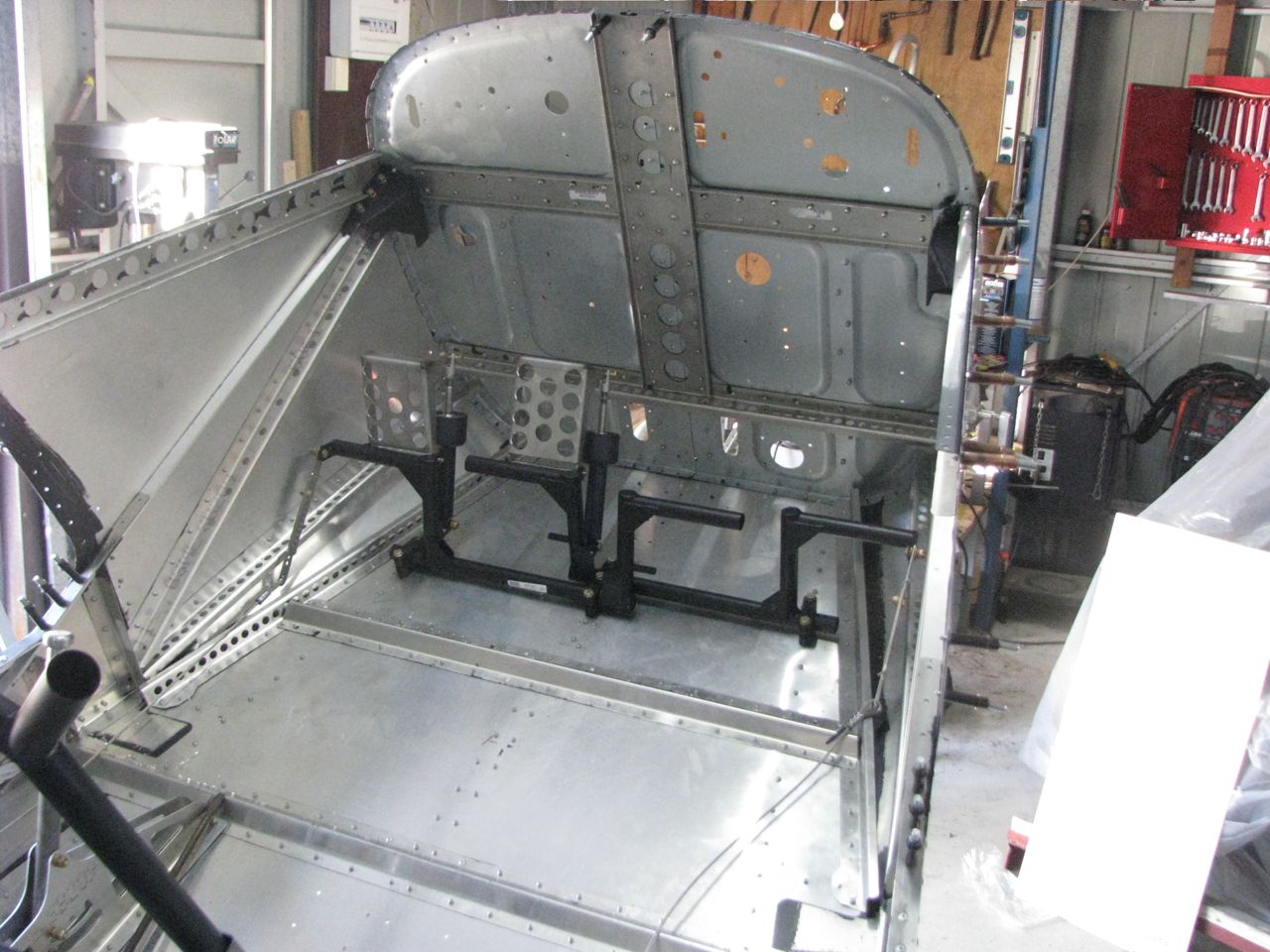

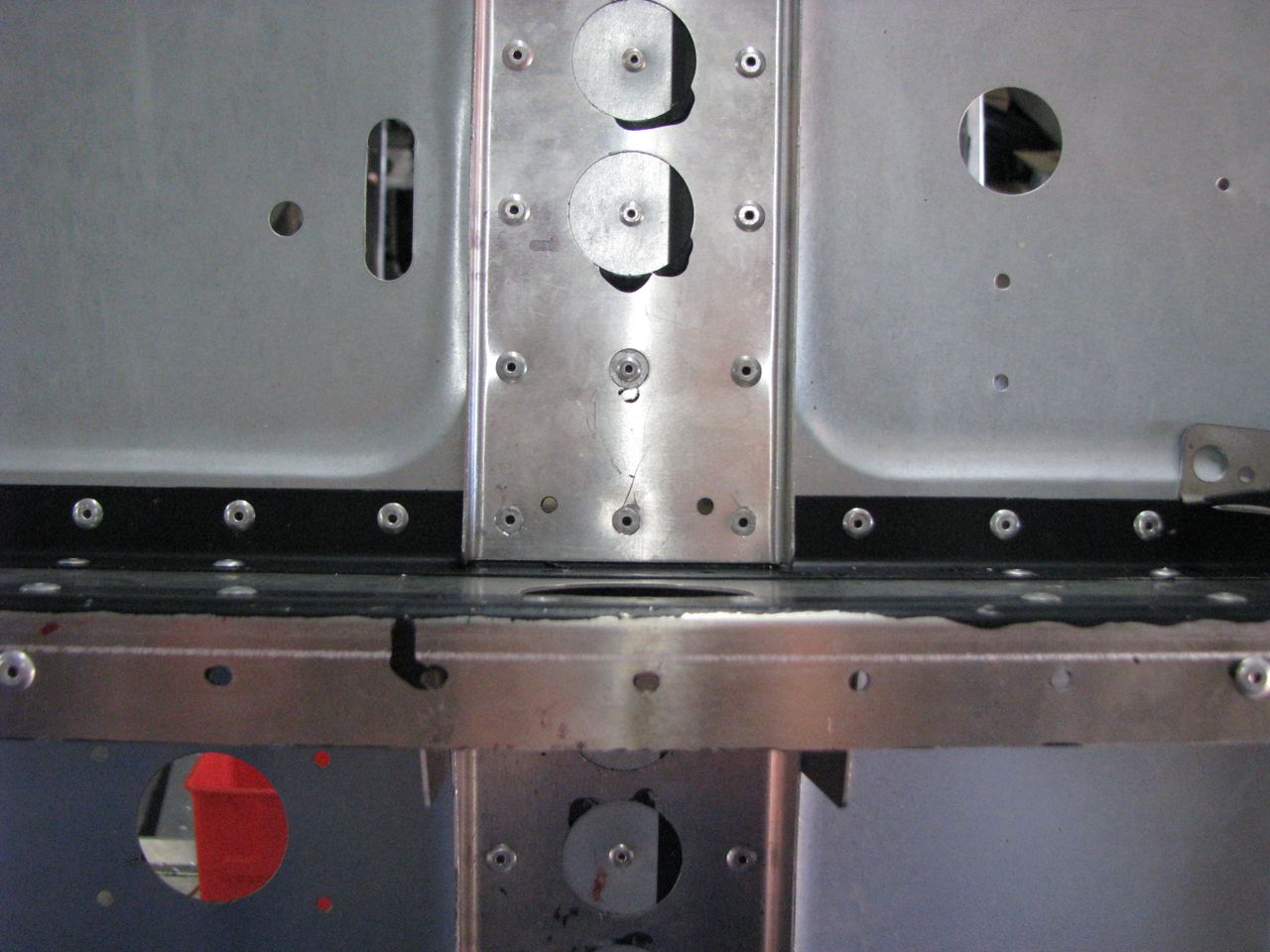

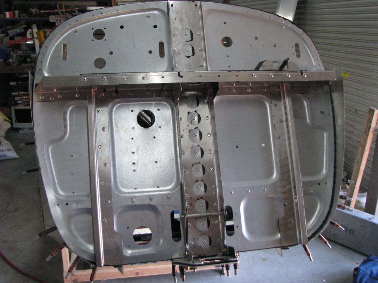

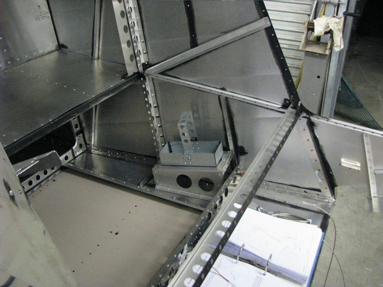

I was away for the weekend just over a week ago so not much done but earlier this week and this weekend have been doing a lot of the smaller fiddly jobs. Its great to finally see boxes of bits being slowly dwindled down. The firewall is in and the engine mount supports are in the floor has been rivetted and the rudder pedals done, I have selected the "advanced" position as I am 188cm tall and wanted the pedals a bit further away. Its surprising how much time is taken up doing these small jobs and just finishing off the bits and pieces. Have struck a couple of things. One mistake was when I built the stab and elevator its was quite a long time ago now about 10 months or so and of course now I am fully aware of how the manual is constructed and you make mistakes along the way and have to drill out some rivets and correct what you misinterperted in the manual or they just didn't tell you in the manual and you find out the hard way. Example is because there are 3 different versions of the trim on the elevator I am sure it didn't tell you that one hinge point is longer than the other and as I did it over a day or two a week or so apart I put the wrong one in the wrong side. There is one hinge that requires the bellcrank for the trim to me mounted on it in the elevator. of course I had the smaller one on the wrong side so had to open up the elevator and remove both hinges and then re- rivet the structure back..only took about 15 mins but is just a crap off. Also there are a few places you need to install countersunk rivets...they dont tell you about these ones in the manual...well not that I have found anyway. I have put a couple of pics in to show. On the crossmember on the firewall just at the top you need to put 3 countersunks there for the top plate for the nosewheel strut also the firewall strengthener for the bottom of the engine mount and also under the front for the main bolt for the bottom of the engine mounts a countersunk will need to got there as well.
I will start to do some painting now of the firewall and internal floor of the cabin at the front. Have sussed out where I can get all the paint as per Maj Millards system which is the wattyl etch prime and undercoat and the top coat is Protek paint. I like the idea of sealing off the firewall from the cabin so Reg Brost has made some entry exit alu pieces for the throttle and nosewheel steering rods and supplies some silicone boots that go over them then he seals it off with a heat resistant silicone sealer he also seals off the firewall to the skins with it. You get it from BSC motion technology I got that on the weekend so will do the painting then seal the areas off will take some pics when I get them done...thats this weeks job to make the pieces out of scrap alu and do the painting. I wont be around this weekend its a long weekend so going up the farm to do some more work and mow the strips as I may go flying again in the next couple of weeks and would love to fly up there and do some landings etc

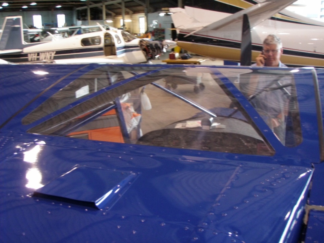

I was in Brisbane earlier this year looking at one of his factory built Savannah S planes. I took a number of photos including the roof 'skylight' window which is not found in the only other Savannah I have ever seen, the Savannah VG. While I was there, he took a number of calls from kit builders who were stuck (see picture). "It's all part of the service I provide" he said.

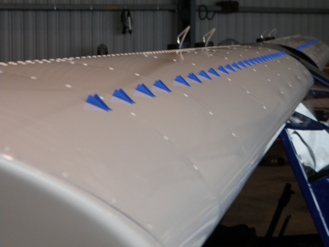

I was just editing my previous post when you wrote that: I had a bit of trouble uploading the picture, it was too large and had to be resized.

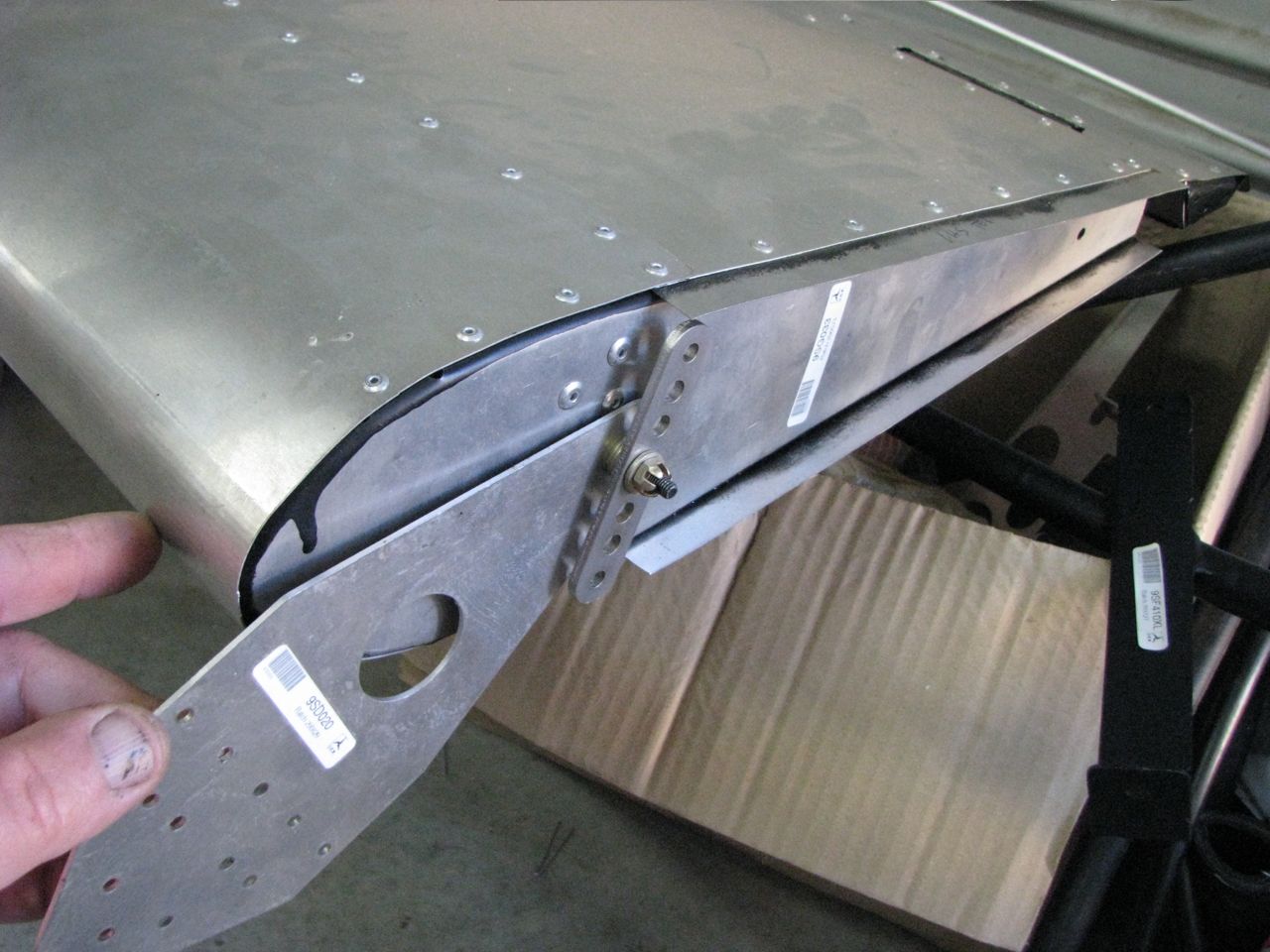

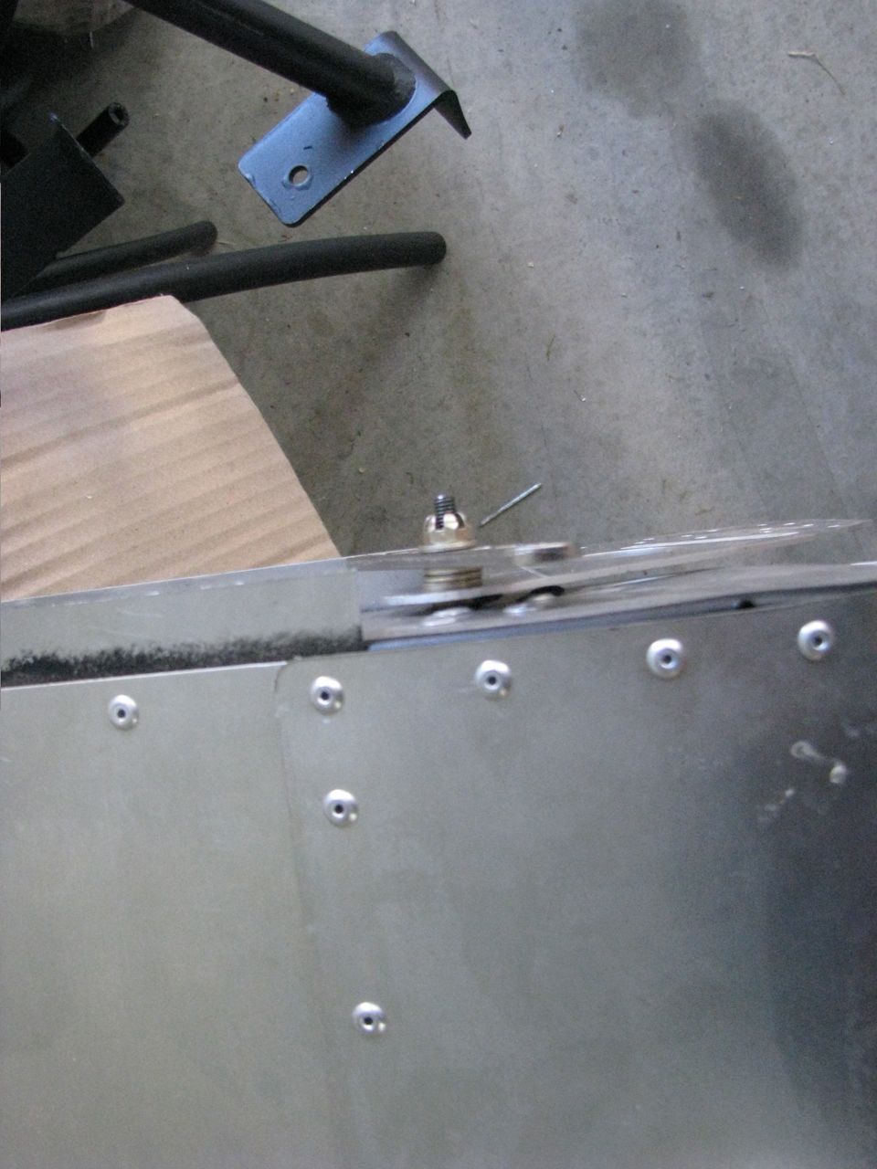

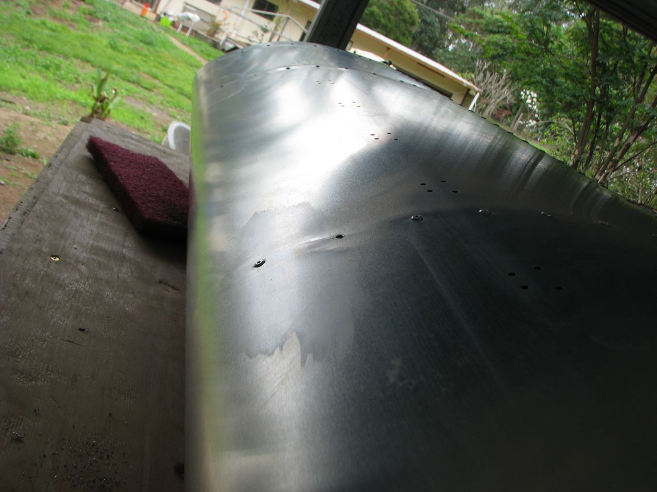

Here is a picture of a the factory-built wing. It also has some indentations around the rivet holes. It must be part of the design. Surely yours wouldn't be much different.
I think I will simply build an aeroplane for the enjoyment and the experience. Who knows, I might get hooked and want to build a second one!

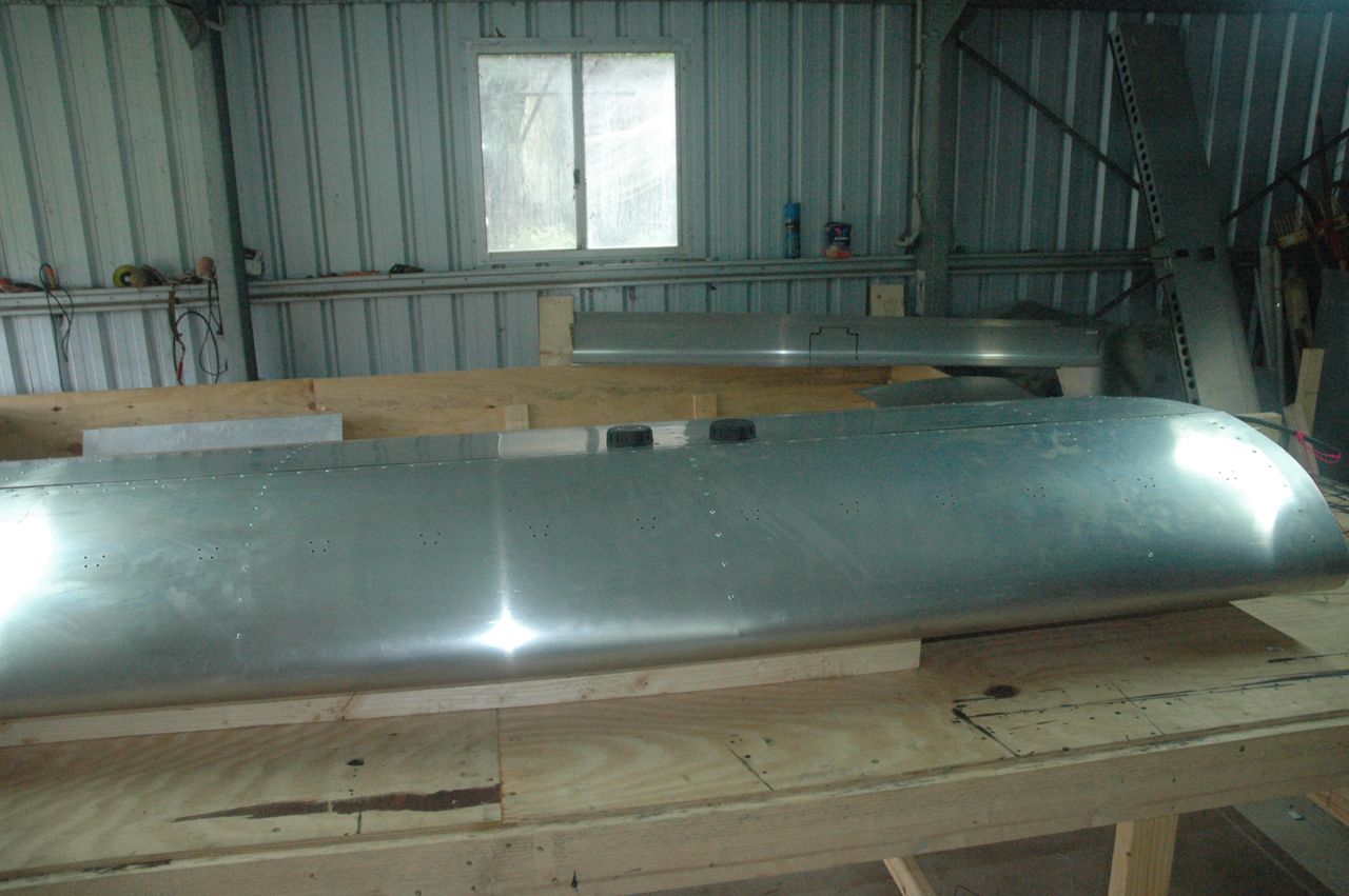

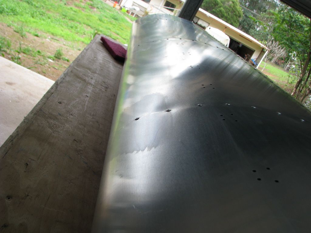

There s also another big dent in the row of rivets behind the main spar...I corrected this as well its in the posts somewhere but attached is a pic of my wing
Mark
I have some better pics which I will find but you can see one wing is really nice which is the second the other 2 pics show where I fixed the first wing I did
That 'good' wings looks smoother than the factory wing!

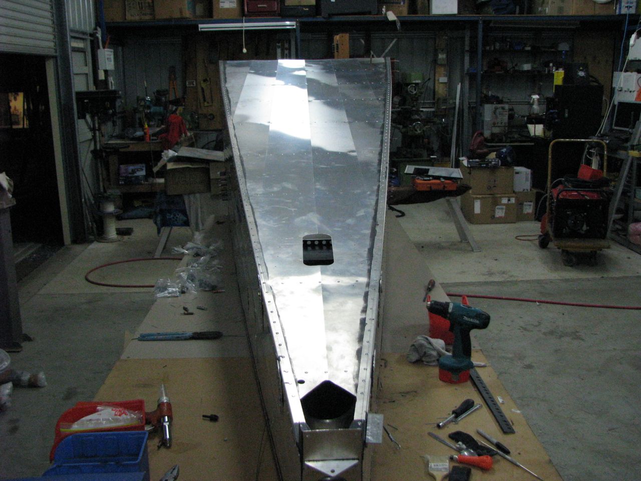

Since I have never seen an XL, I was wondering about the little door near the empennage that shows up on a number of photos. I was under the impression that it was supposed to be the location for the battery. When I had another look at the pictures, I noticed the Savannah S doesn't seem to have a battery in the tail, at least not as far as I can see, even though the door is visible on the right. See the photo of the inside of the fuselage below.
Where will your battery be in the XL?
Hi 80Kts
You will find in a few posts back I was talking about the battery position. In the XL it is just behind the pilot but in the previous versions it was down the back where that little door is. I actually mounted mine there as the door is still there but after discussion with some XL owners I shifted back to the new position. In that door area I will make another small box that I can use for storage/balance if I need it. I am told when you are at MTOW the XL is slightly nose heavy and its good to put your tiedown kit down the back and this works nicely for the CG

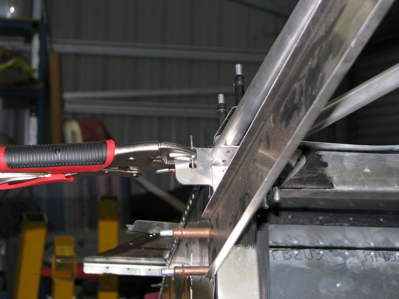

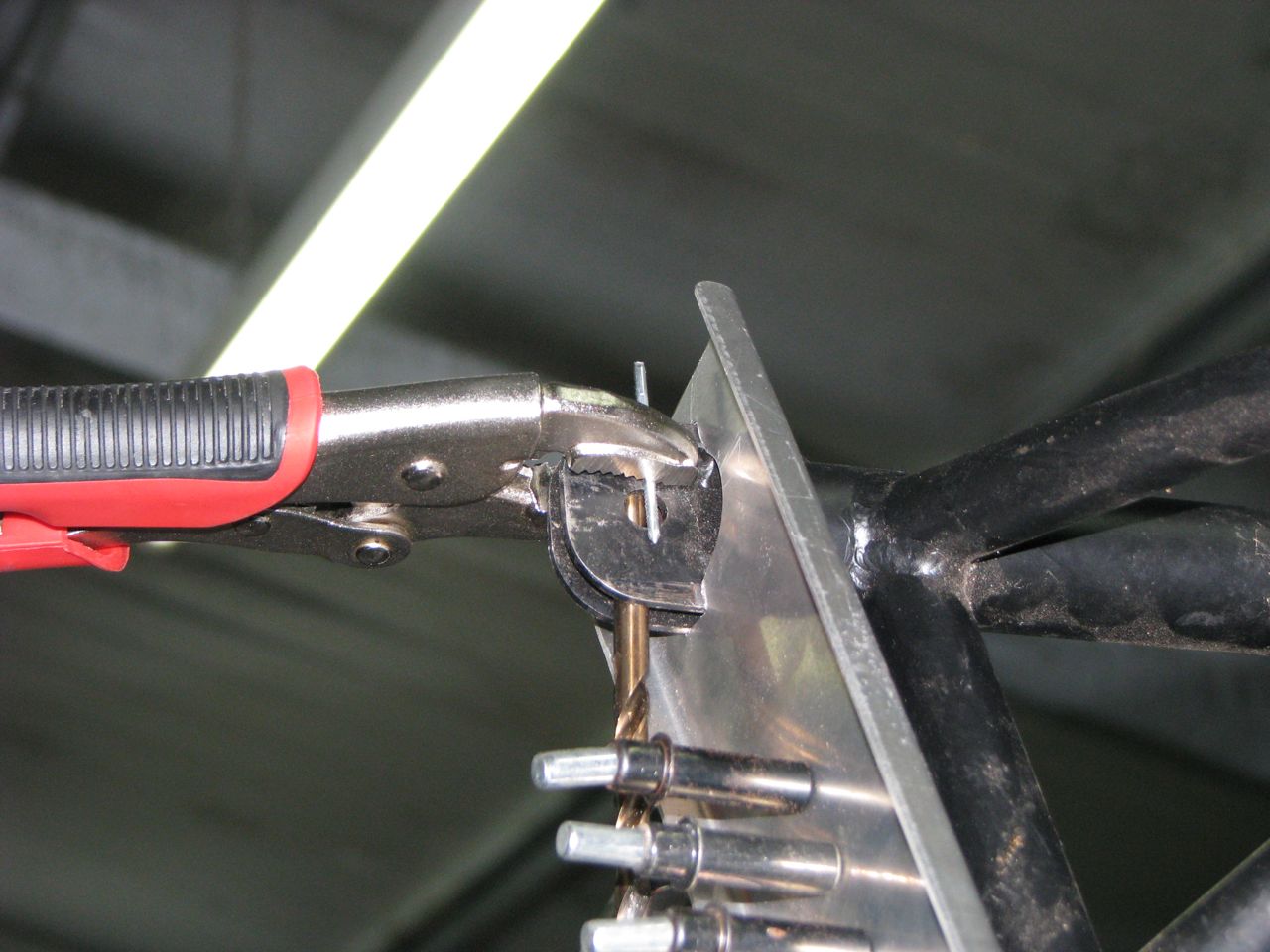

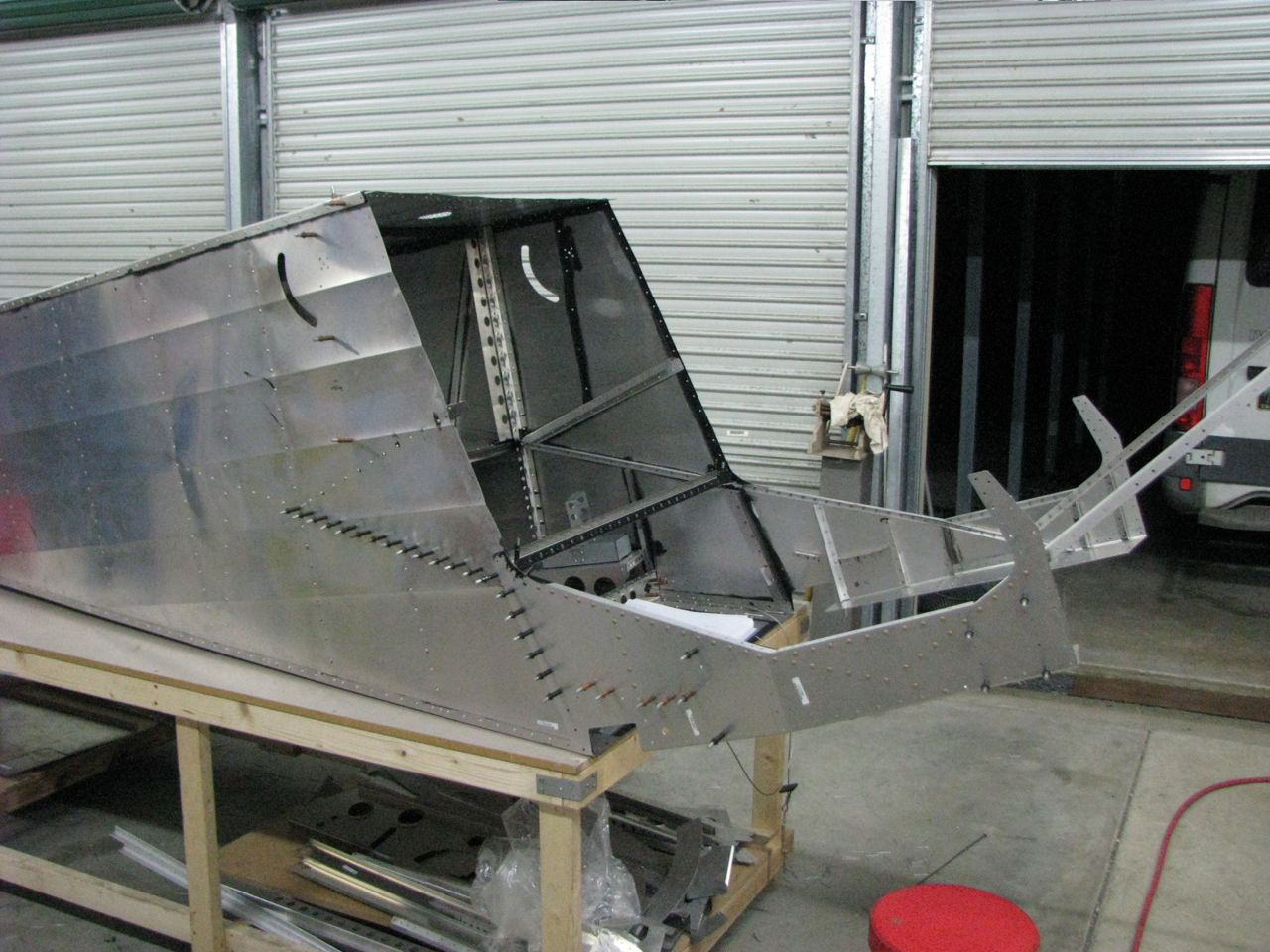

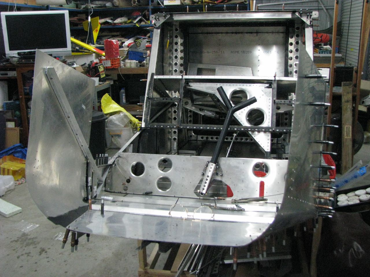

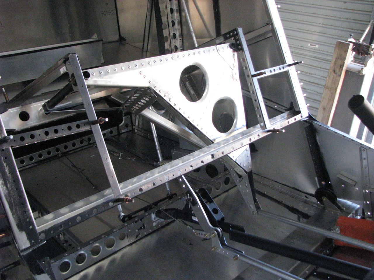

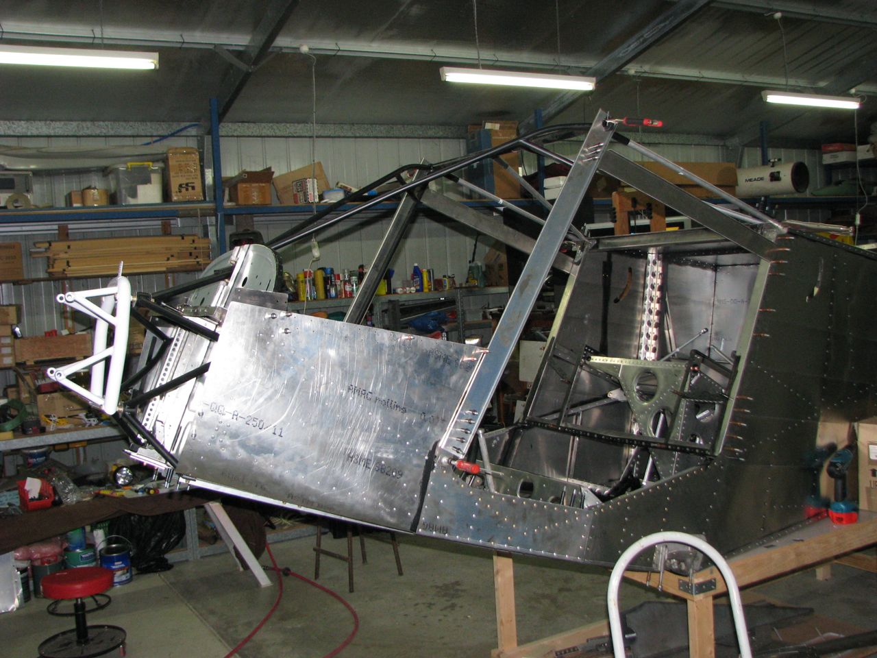

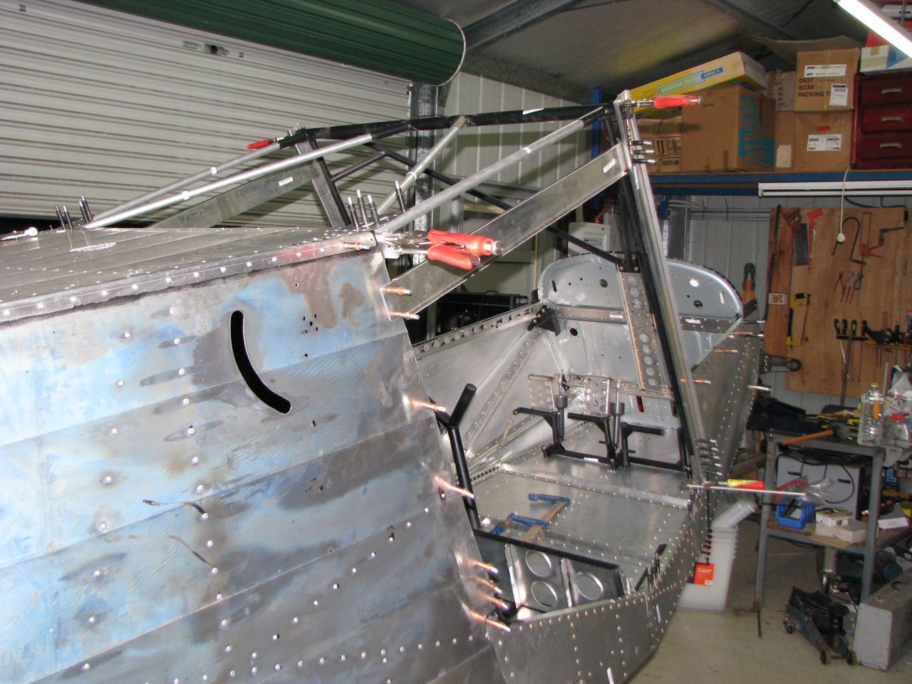

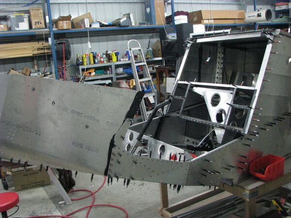

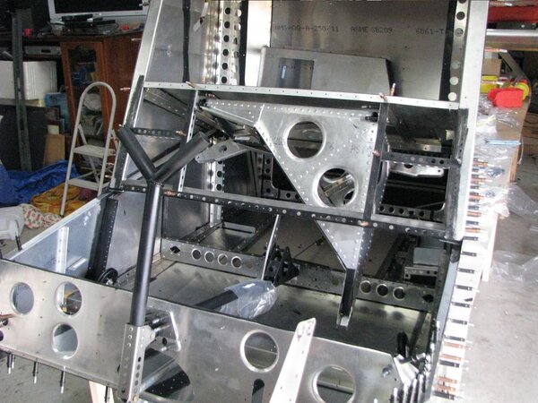

I am at the stage of fitting the cabin frame and the manual calls for the diagonals to be within +/_ 5 mm in dimensions Greg told me this is pretty critical for when the wings go on it affects the wing to tailplane distance and I think the max allowable is 30mm at either end the closer you can get these to be the same the better so I spent most of today getting these sorted. You will see in the pics I have 4 sets of vise grips holding pins exactly over the wing mounting holes on the front and rear and you measure across these for the diagonals distance. Once you get this setup with the jigs at the side holding the front wing mount then you drill the alu tubes in their mounted position and cleo them all. But before you can do this you need to fit the engine mount so you get the mounting holes in the right place for the front V bars that come from the cabin frame that mount to the top mount of the engine mount you can see in the pics that it becomes one nice solid area for the engine to be braced to.
The front bars of the cabin frame now have a slight bend in the apparently done at the factory to allow the windscreen to sit better but this makes getting those front bars up to the back of the engine mount a bit of a mission but it all came together pretty well. Now all the holes are drilled and the frame is clecoed its time to remove it all including the engine mount as I want to etch and paint the firewall also put on the front skin for the dask then I can fit the noseleg and the rest of the parts on the firewall remount the cabin frame recheck the diagonals to make sure and then can get onto fitting the rear of the seats and the bottoms. I am getting to the part now where all the really fiddly bits are coming then of course the painting which will take a while as well. But I am really happy with the outcome this weekend so tomorrow will remove the engine mount and cabin frame and get this other stuff done. I need to order my engine in the next week or so too so it will be here when I am ready for it.

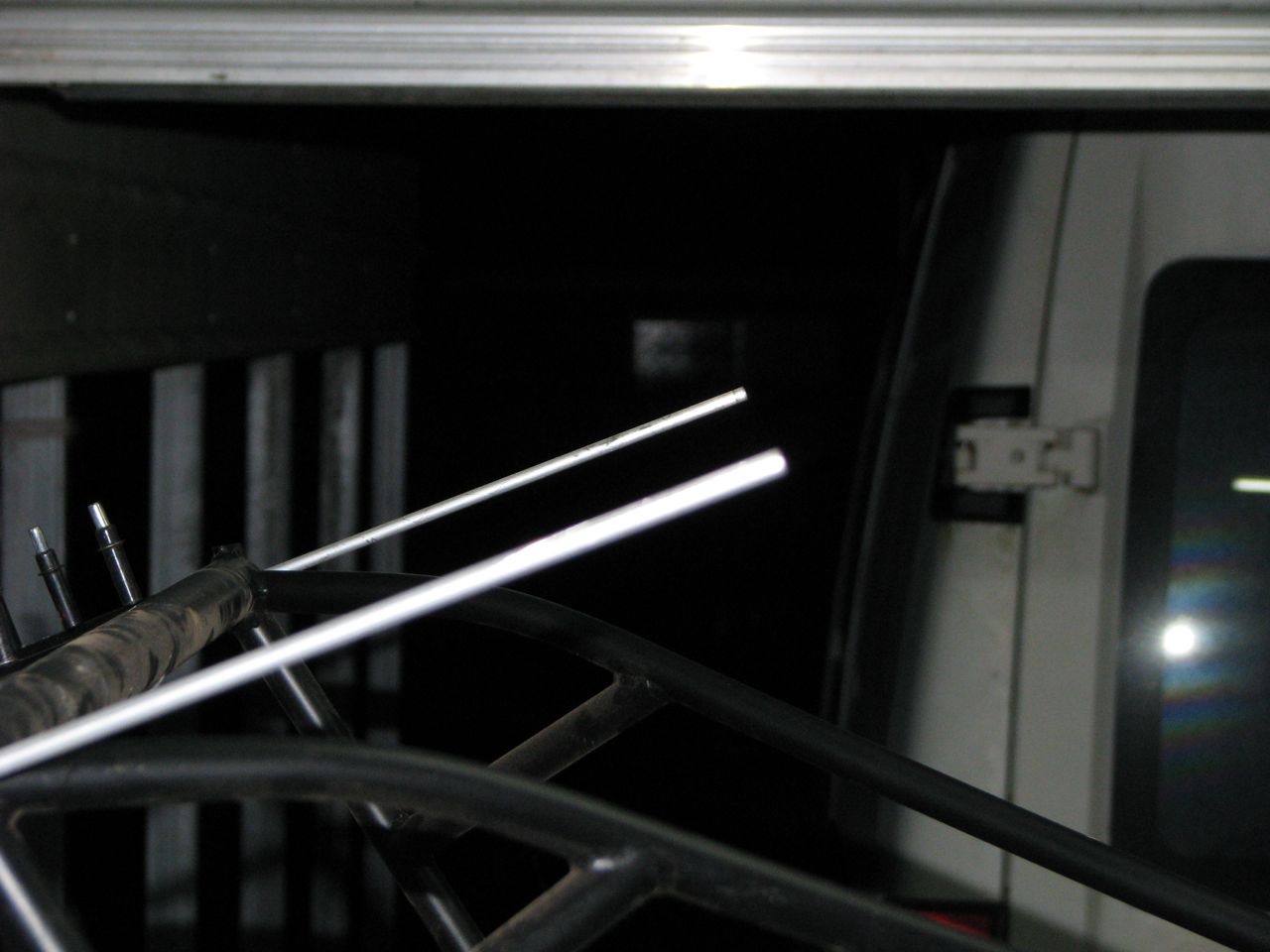

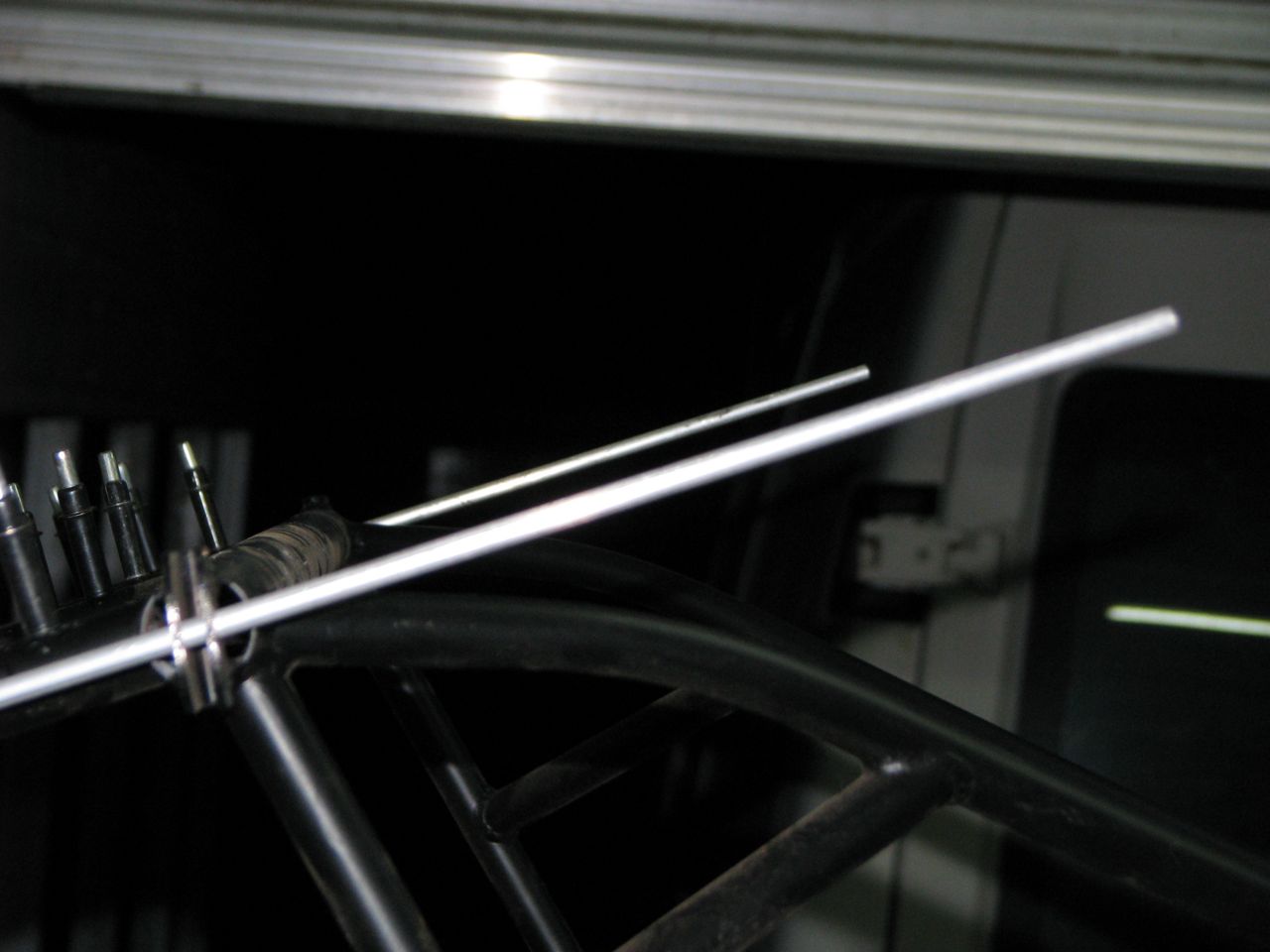

The pics of the 2 rods coming out of the front mount go from the back mount this was just to check there was no warp and both wings will be at the same incidence
