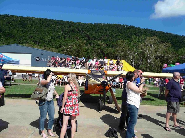

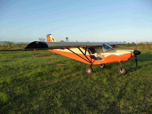

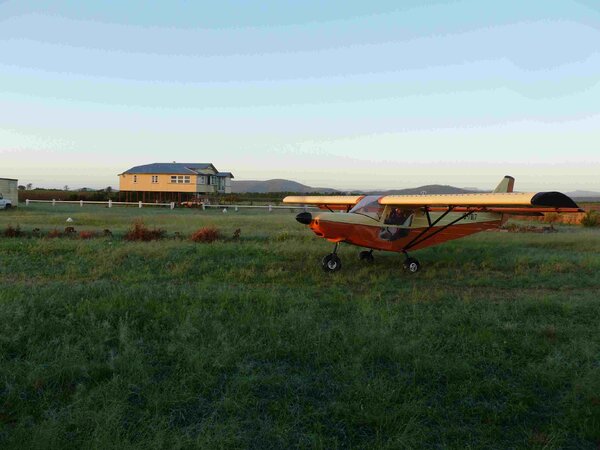

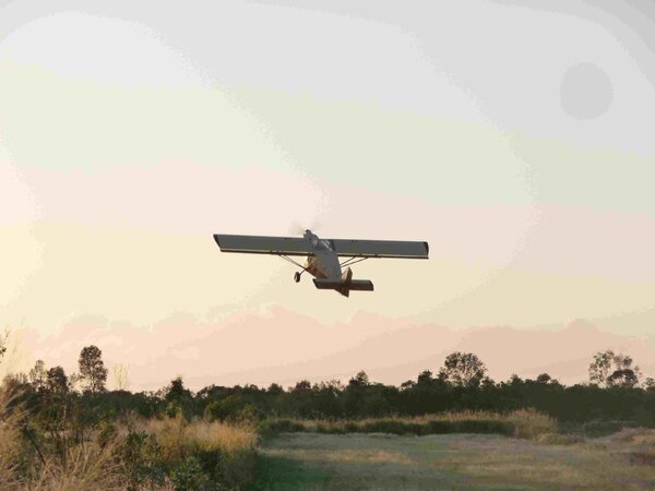

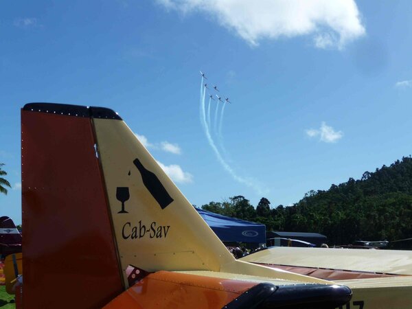

Hi Ian
Pics look great I love the tail motif
Great to see it flying. Did you fly her to the show?...are you happy with the performance? Who did the initial flight Maj?
Blow by blow description on inital flights and the trip to the airshow would be good
Mark
Hi Mark
I did the first flight on friday afternoon, then a couple of hours on sat after work and flew into the airshow very early sunday morning. So far all is going well, over 5 hours and 25+ landings, nearly got the landings sused now. Very easy to fly but much faster than the drifter!!!! very happy with the whole thing at the moment:cheezy grin:
After spending so much effort to build it there is no way I'd let someone else test fly it! A good idea to get lots of flying in to get current first though.
