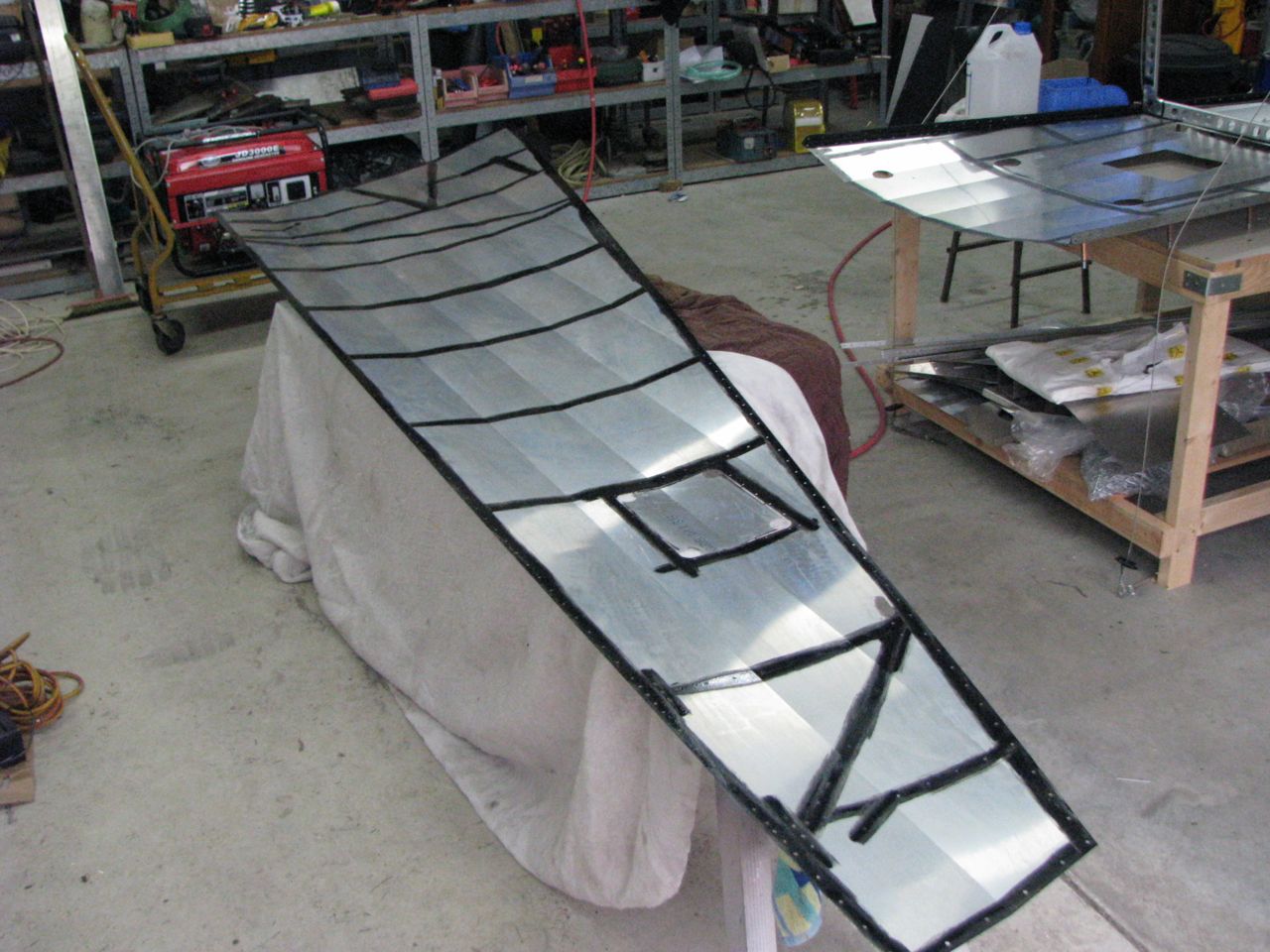

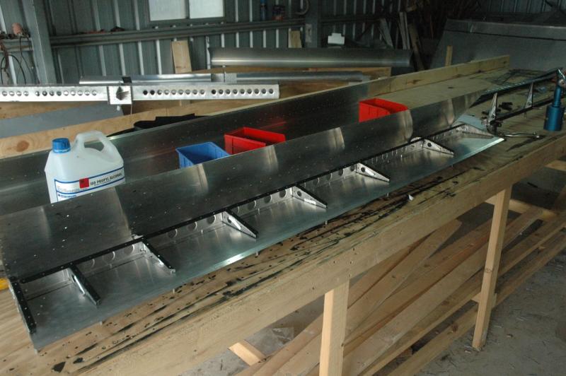

I have been going slowly with mine just too many things pulling me this way and that lately but should be getting along with it soon. I went on Sunday and fitted the tank skins and turned the wings over sliced off the sikaflex that comes through the holes that are now blocked by the alu strips in the second tank positions. I am actually making up my sight gauge adaptors on the lathe here today. i have to make 8 of them of course for the 4 tanks. I started using metal but its too heavy when I add the Legris fittings which are metal as well so the body of the adaptor is made from a chemical/fuel resistant plastic called Ertacetal its a white nylon type of stuff I will take some pics tomorrow and post them after I have finished the 8 pieces. These push fit and seal with internal Orings onto the 1/4 inch alu pipes that come from the tanks and will sit in the wing root same as the rislan tube the kit supplys. They are made from 16mm rod eracetal just 2 holes tapped at 1/8 bsp.
We need some more pics from you.
When it comes to painting I think I will paint the bits before they are assembled as this should protect all the alu parts as well. Once I shift the wing off the bench this weekend then I will build the flaperons and the elevator then I will shift all the fuselage gear to my place here and progress will be made every day then

Got to work on the Sav today. Put the fibreglass wingtip in and finished off a few other little things on the wings this morning. That wing is now in the rack with the other one and I can get back into some frame building again. Boy the tanks were a frustration at times but I am happy with the way its all turned out. I have attached a couple of pics of the fittings I made up to go onto the 4 of 1/4 inch alu tube that comes out in the wing root for the sight gauges. The clear tube is a plastic that "supposedly" will not discolour or be affected by petrol...we will see I suppose. The only thing that this system of fittings is a pain and I really didn't think of it was I cant see pretty much all of the fuel level as the 8mm fittings do come down a fair way. I will see how these go if not maybe just that tube clamped onto the alu might be fine. I will suck it and see when the time comes but at least I have a couple of options now.

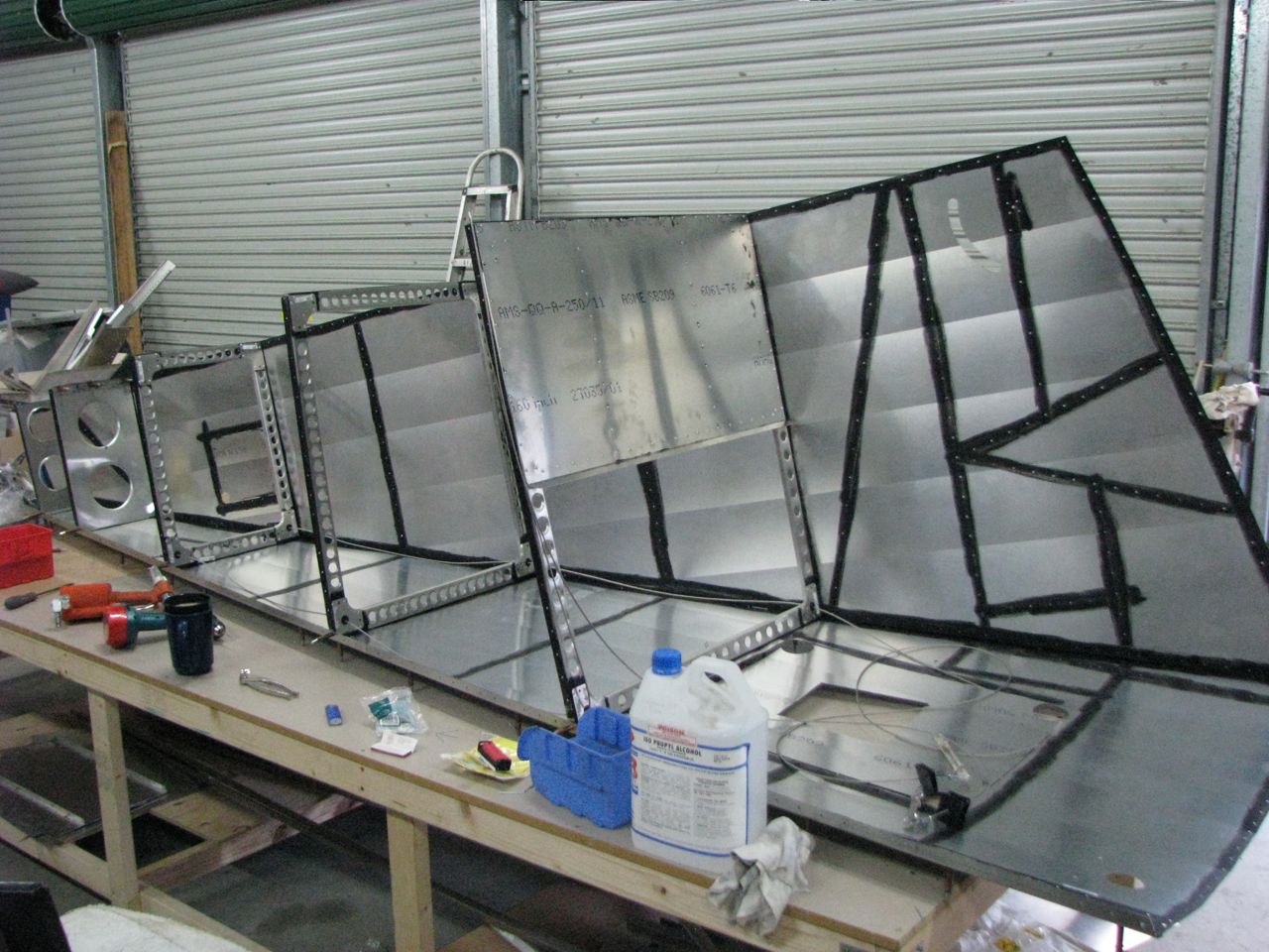

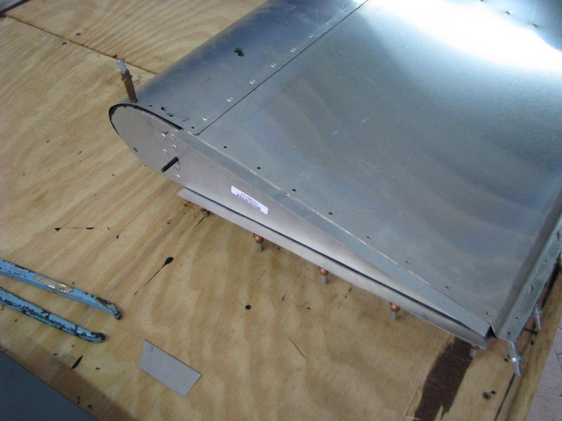

Ok the wings are off the bench and now its time to get to the elevator. Reasonably straight forward to assemble. Cleaning and deburring the skins and other parts as usual and the painting of the black goop onto the right places which sometimes you think you have done all the mating surfaces but just as you are about finished clecoing them you see you missed a bit so unclip it all and do some more painting....that black stuff seems to get on my fingers all the time no matter how careful I am.
I didn't take too many pics today but the top and bottom skins are on and also the nose skin. Have the trim tab pretty much ready to assemble as well.
Will be going up to the farm next weekend if these cyclones don't change our plans so probably the next weekend it will be riveted and then I start on the flaperons
Mark

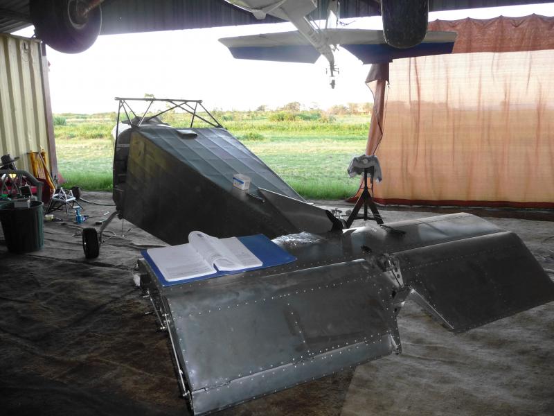

We were all set to start the paint job when cyclone Anthony and now Yasi come along. Anthony wasn't too bad but we took the tail off so we could put Cab Sav inside a shipping container, part of the hangar, along with the box of bits still to be fitted, so it should be safe.

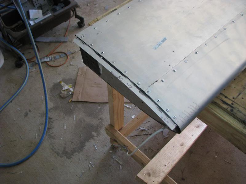

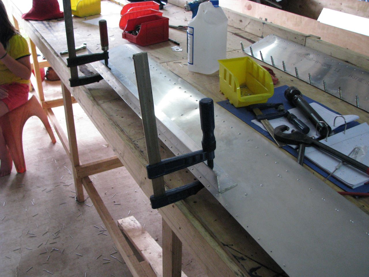

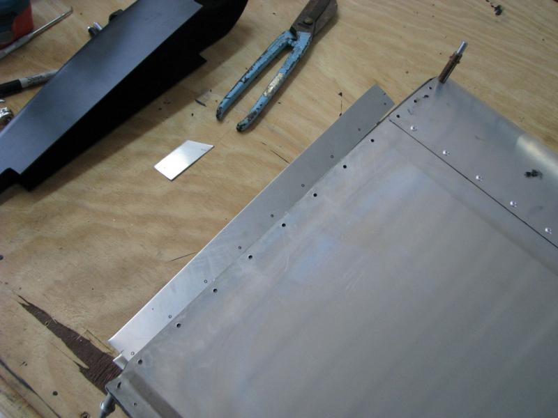

Been a while since I posted...probably because I havent been able to get to do any work on the Sav :(. I had started putting the elevator together a few weeks ago and finally got back to it this weekend.

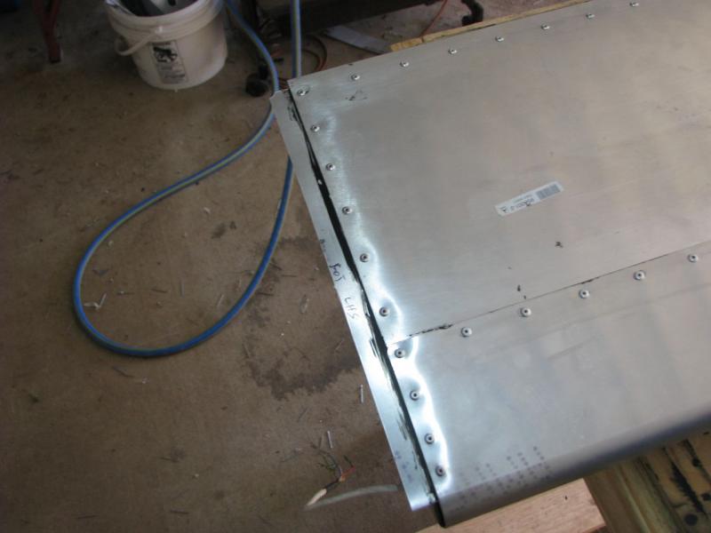

I also went to take some pics of me sitting in a VG XL for a guy in Canada who didnt know if he could fit in it so while I was there laurie was talking about things he would do different in his if he built another one. One of the things he would do would be strengthen the outer panel of the stab on the rivet line where the nose skin meets the main skins. This is very soft as it is just 2 sheets riveted together with no spar support and it squeezes really easy and feels very flimsey. I had already done the stab it was one of the first things I had done. Anyway while doing the elevator the plastic tips need to be attached and ICP supply this special cut strip you rivet to the end ribs then the tips slide over there but its a bit of a trick to line up all the holes. Most I have seen are not a nice flush and neat job. Steve Donald gave me the tip for the rudder and fin which I did and the tips really fitted nicely and easily so I decided to do the same for the elevator.

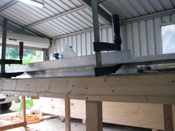

The pictures attached show how I just cut some 25mm wide strips out of the tank cut out panels and they slide between the skin and the rib at the end just makrk and drill the holes then rivet them in. The tips fit beautifully and are close enough to perfectly flush with the top of the skins.
The stab I had riveted the nose sections and the tips are much larger for it so I decided to remove the rivets and do the same to it. The other issue was this soft skin in the outer panel so I removed all the rivets and a few extra past the main frame and then cut one of the spare skin tensioners to size slipped it in the spot and marked the skin holes on it then removed it and drilled the holes. Painted the black goop on it and slipped it in so it locks between the inner and outer rib then riveted the main seam so it was now holding both skins and being bent at right angles it has now made this part of the stab really strong with basically no extra weight...maybe a total of 100 grams for the 4 strips required to do the job. I have done one now and will do the other 3 also do the tip mounting mods as well. Hopefully will get them done later this week or next weekend then it onto the flaperons
Mark

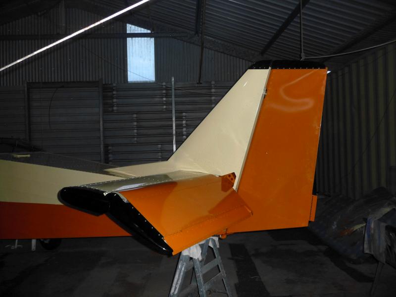

good to see you back on the job. I've been a bit delayed with the cyclones up here but now making headway again. Started painting the top coats of paint today, preparing for painting was very time consuming as in all the little jobs that i hadn't decided how to do them, they now had to be done. You think a part is finished then you find you've left bits off for this or that now is the time to put them on.
A quick tip for the stabilizer and elevator tips. I am putting BOTH sides of mine on with rivnuts so the can be easily removed, this way the sav will fit inside a shipping container ready for the next cyclone!!!!!
I'm still having problems uploading photos so will try to put some on later.

Hi mark
I've used wattyl super etch primer, followed by epinamel pr 250 primer then polythane AU 625 2 pack topcoat. This is the system that Maj Millard recomended, he works on the seaplanes at shute harbour and its the system they use, some of them have been flying for 70 years aparently and still going strong. As I want to put floats on eventually and live very close to the sea corrosion protection is important. I'll try again for some photos.

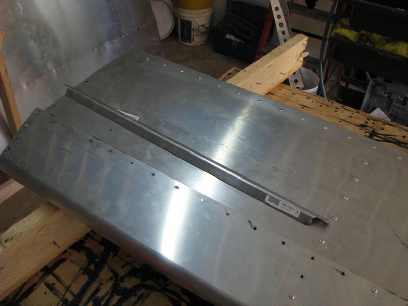

The paint job looks great looks like you have done a lot of prep before painting.. I got time yesterday to finish off the strengthening of the outer tailplane skins. Those right angle skin tensioners really made a huge difference I think they should be standard. By the way I didnt come up with the idea it was Laurie Strickland I was chatting to him the weekend before and it was one of the things he said he would change if he built another and I have to say I am glad I did it. I have mounted the servo now and all the tip holders are in as well so have put it aside now until I need the unit. Pulled out all the bits for the flaperons and started filing all the sharp edges and de burring the skins thats a massive job as all the edges seem to be proud and sharp. Pretty much have all that done for the right aileron complete and will paint the black goop on this weekend and start to assemble it and then onto the left Aileron. Will be around for a few weekends now so hopefully will get these done and get ready to transfer all the fuselage bits over here to my place and hopefully really motor along once its here

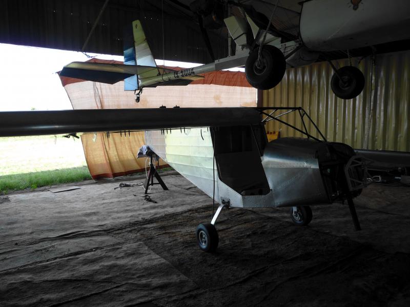

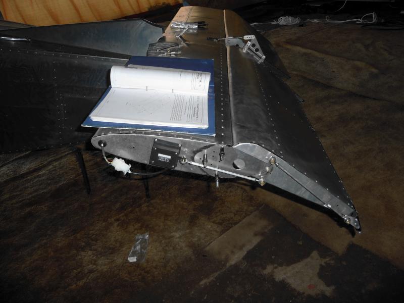

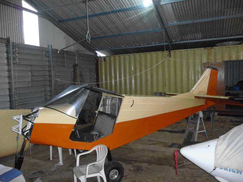

took the Cab Sav for a roll today all on its own three wheels, then put it in the shipping container as we are off to Perth for ten days, just in case there is another cyclone whilst we are away, I will be putting the engine in and wings on when we get back.
Cant upload pictures again so will try later
regards
Ian

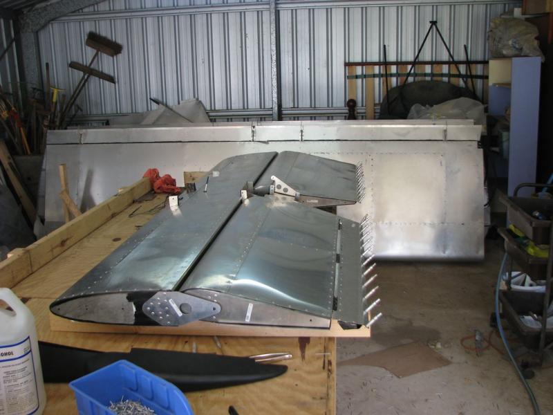

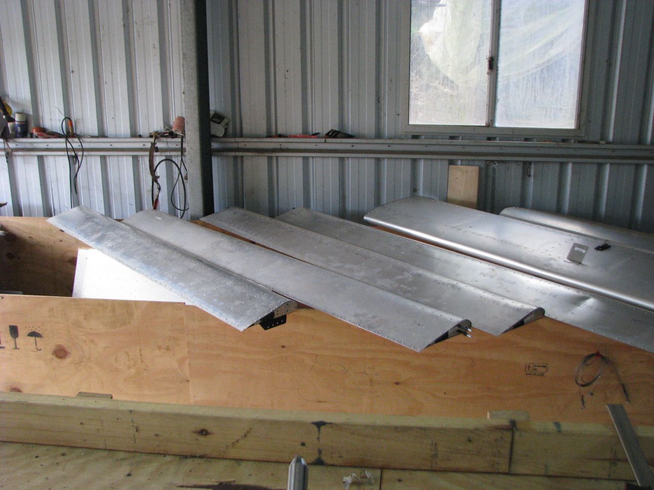

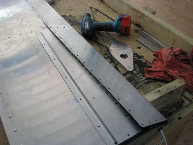

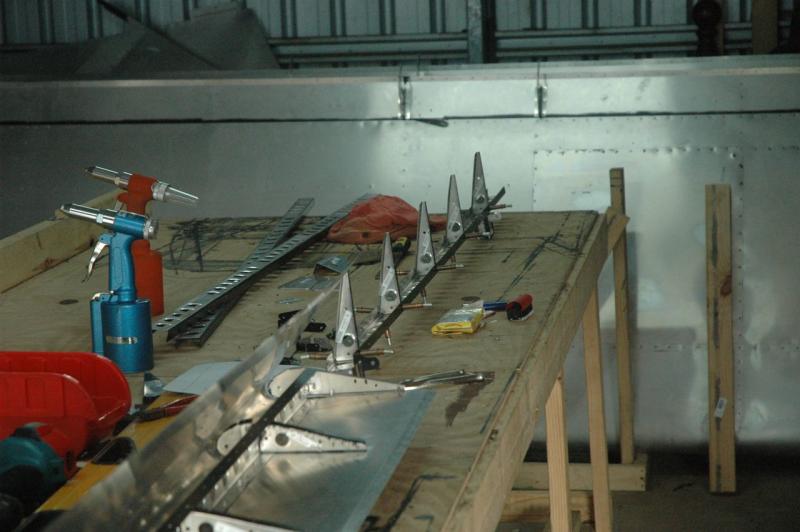

Got a few hours today to work on the Sav. Doing the flaperons at the moment. So far this would have been the worst drawings and instructions for putting them together. I had to read it 4 or 5 times and really look hard at the diagrams to decipher where certain bits go and their orientation. I thought I had it right but had to drill out some rivets and rectify my wrong assembly. really peeved off at myself about it as I thought I had it sorted before I started but I was wrong I hate having to redo something.. So lesson learned once again that sometimes you really need to read the manual several times over and over to make sure you understand totally what bits go where. To date the manual has been pretty good and no real stuffups but the flaperon section you really need to read thoroughly. Next weekend hopefully will finish the flaperons off as I should be able to get a couple of half days to work on them
Mark
  • 2 weeks later...
Worked on the left flaperon today almost finished the outer one now with the inboard one done. Just need to rivet the top skin on the outer panel I am really surprised how much time the flaperons have sucked up. All the parts I have made already will stay at my mother in laws place until it comes time to do the final finishing and painting of them . Also building a new work table here at my place getting ready to build the fuselage over here is just over 4 mtrs long and 1.2 mtrs wide it will be around 800mm from the ground to the top surface so its no too tall. I was thinking of bringing the table I made the wings etc on over here but its too high so its quicker and easier to knock up a new table. Will post a few pics of it later. Got to go up the farm next weekend to get the mezzanine floor finished off with all the welding. so after that should have the flaperons finished and can start getting most of the fuselage bits over here and start on them. I will be able to devote a lot more time on it then when its over here
Mark

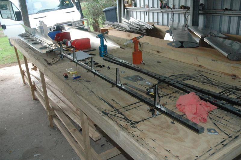

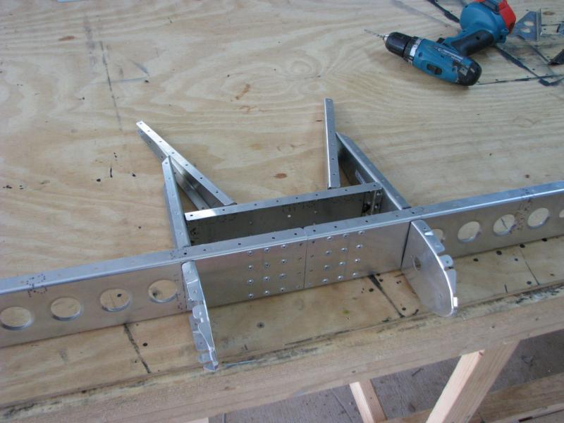

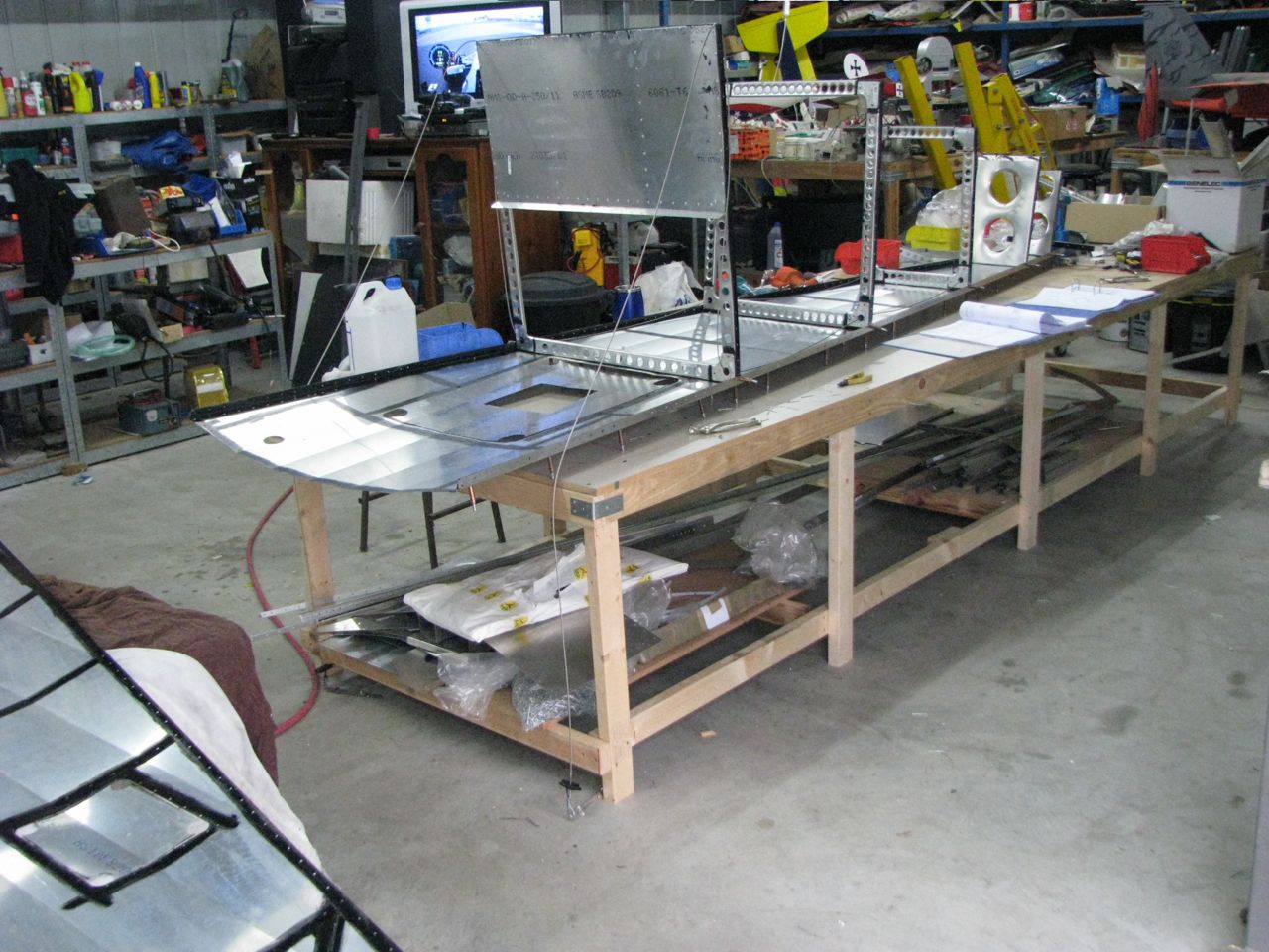

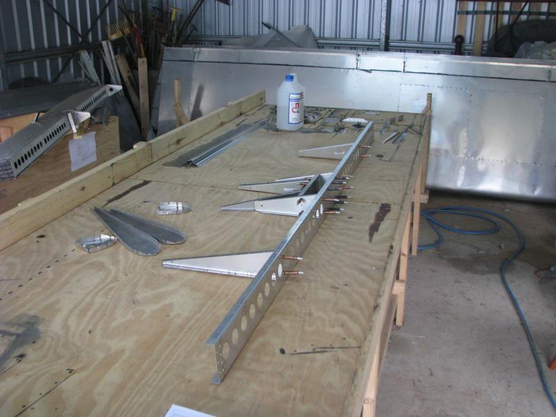

IMG_0918_1.thumb.jpg.3ee48dae1bc21f5ec97b3e6bd809c4a7.jpg Hi All

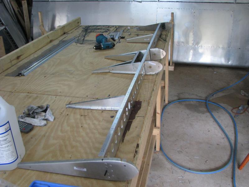

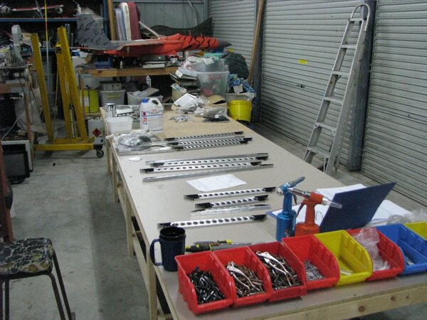

Its been a while since I have done a lot been doing things up at the property and finishing the flaperons when I have had a chance. Also have built a new 4 mtr long sturdy table over here at my house now to build the fuselage. Things should now happen a lot faster as I can now work on it when I get any free moment here also at night now. I have all the parts I have built stored over at the mother in laws place where I built them Just need to transfer the rest of the parts over to here which I will do this weekend.. I started on the main frames last night deburring the edges and holes and painting them last night. A couple of pics to show how I kept the traing edges of the wings and flaperons when I riveted them using the small training edge rivets using alu angle and clamps. This works great it keeps the trailing edges as straight as a die
Mark
Now the bits are here at my house I can work a lot more on the Sav. The manual is still not very good but much study and comparing photos from Reg Brost's cd I managed to work most of it all out so far.
