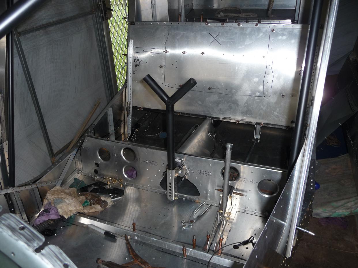

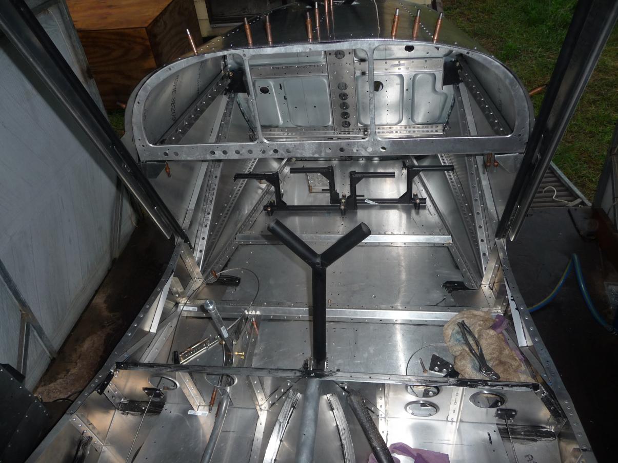

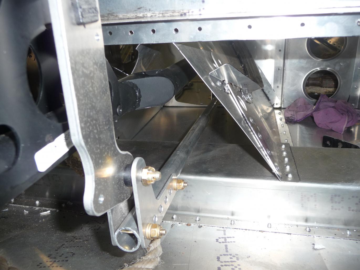

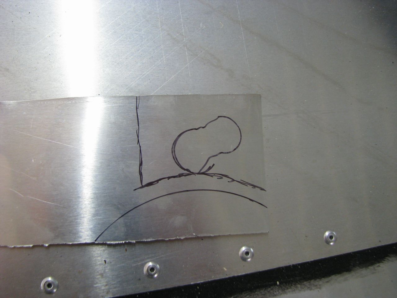

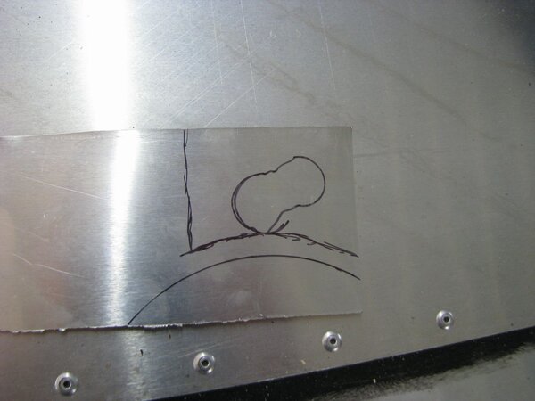

Hi Mark. I've had a good few days on the Savannah. Fitted the engine mount, tempoarily and the cabin frame, and all controls. I do have a problem with the elevator control rod contacting the front top of the main gear cover. Anyone out there encounted this and how do I fix it please, see photo. I'm sure a large file or bit of brute force would fix it but whats the right way? or what have I done wrong?
[ATTACH]12553.vB[/ATTACH] [ATTACH]12554.vB[/ATTACH] [ATTACH]12555.vB[/ATTACH]
Ian
Hi Ian
You havent done anything wrong. Steve the LAME who is building one down the road tells me this is normal as he has struck this as well, you have to bend the elevator control rod so it doesnt hit. Ring Reg Brost if thats who you got the kit through. I am told this is "normal" and this is what you do. You are really powering along I wish I could devote more time to mine at the moment but work has been ballistic this last couple of weeks....got to take it when its around at the moment. Everyone seems to be the same one week work is overflowing the next its a famine
Mark
Mark
Thanks for that Mark, I was contemplating bending it but just wanted to check and couldn't gat hold of Reg last night. I work in tourism in the whitsundays so its famine for me at the moment with the weather and time of year so only 2 days work each week at the moment, which leaves lots of time for building the Savannah!!!!!!!!
Thanks again
Ian

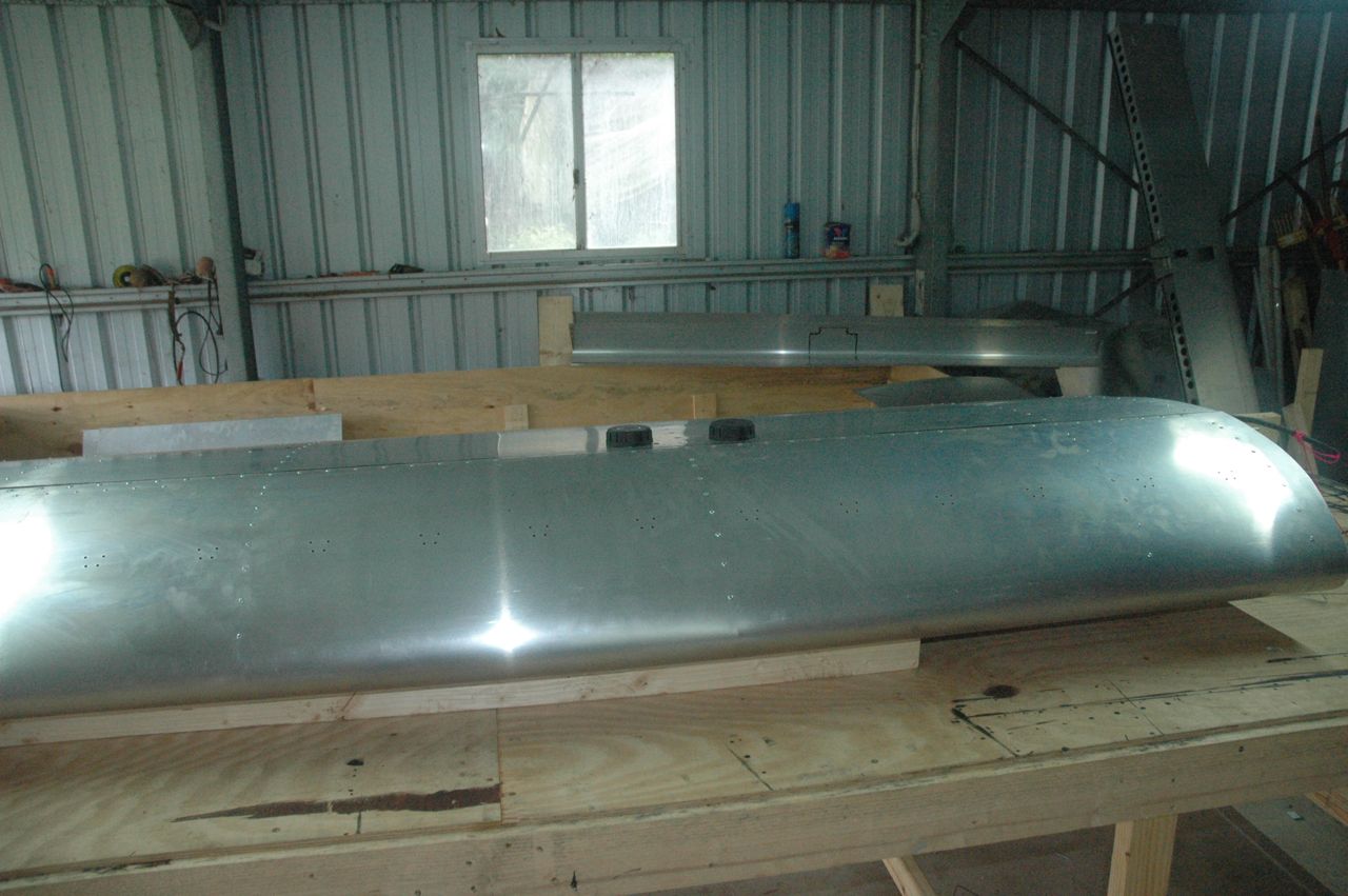

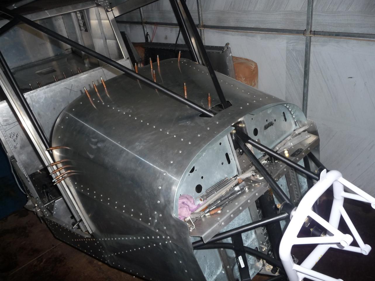

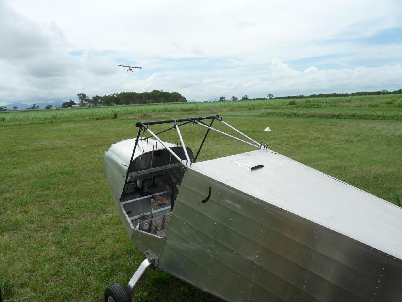

Here's the latest[ATTACH]12587.vB[/ATTACH] [ATTACH]12588.vB[/ATTACH] I'm still progressing but there seems to be lots of fidly bits now and I'm tyring to finish lots of half finished jobs. We did manage a bit of a fly-in on sunday with six aircraft and good weather for a change, but the rain is back now. Three days work now this week, I'd rather be Savannah building!

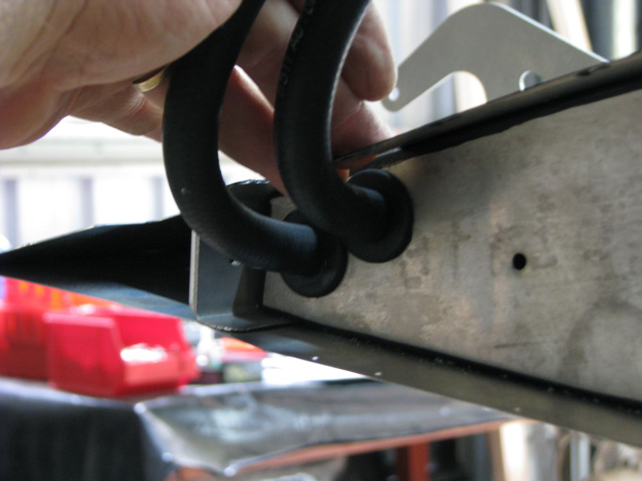

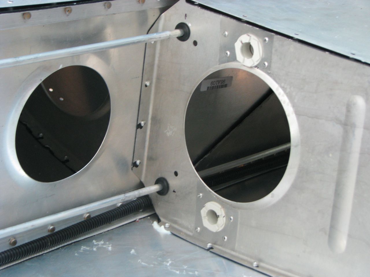

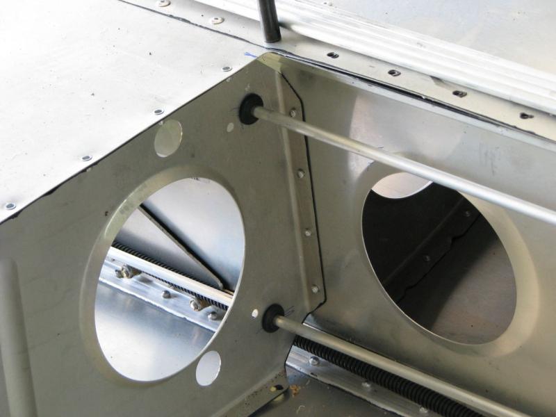

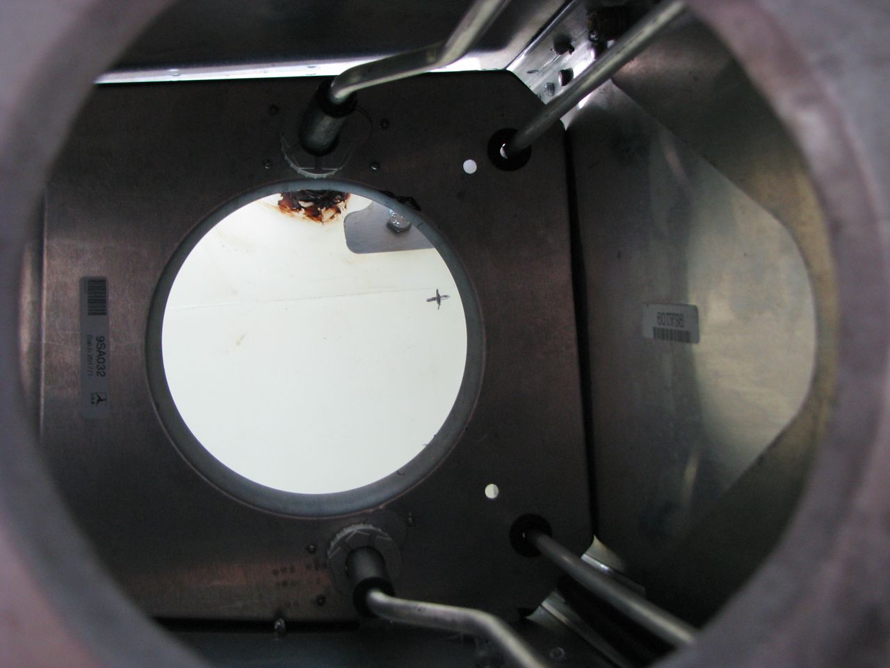

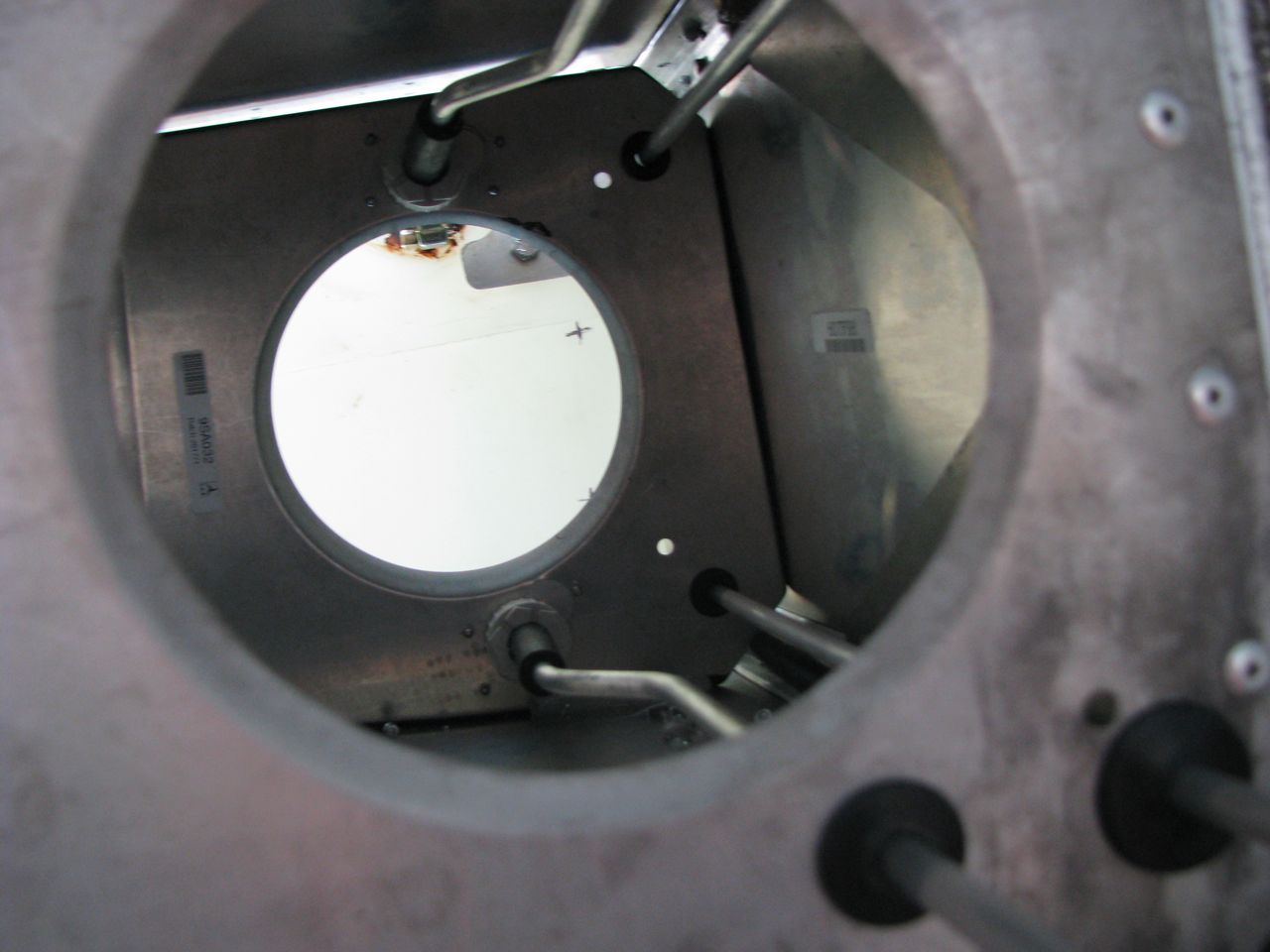

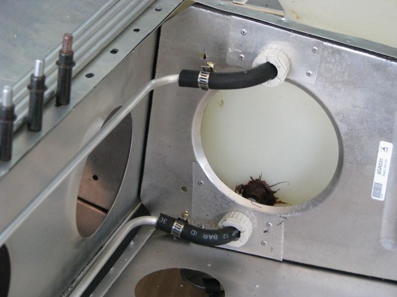

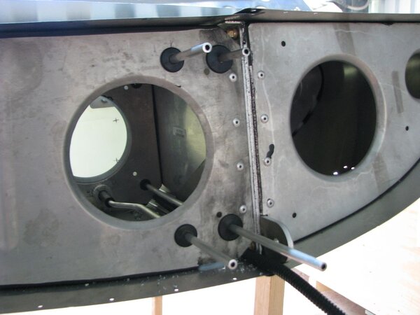

I wanted to get the tanks all finished on the right wing but I managed to snap off the rivnut mandril for the rivnuts so I will have to get another one to finish that off but at least all the plumbing is now finished and I just have to do them next time and I can start the fuel tanks on the left wing. I was told the tanks take a lot of work and they sure do but of course its a critical part so time and care needs to be taken.

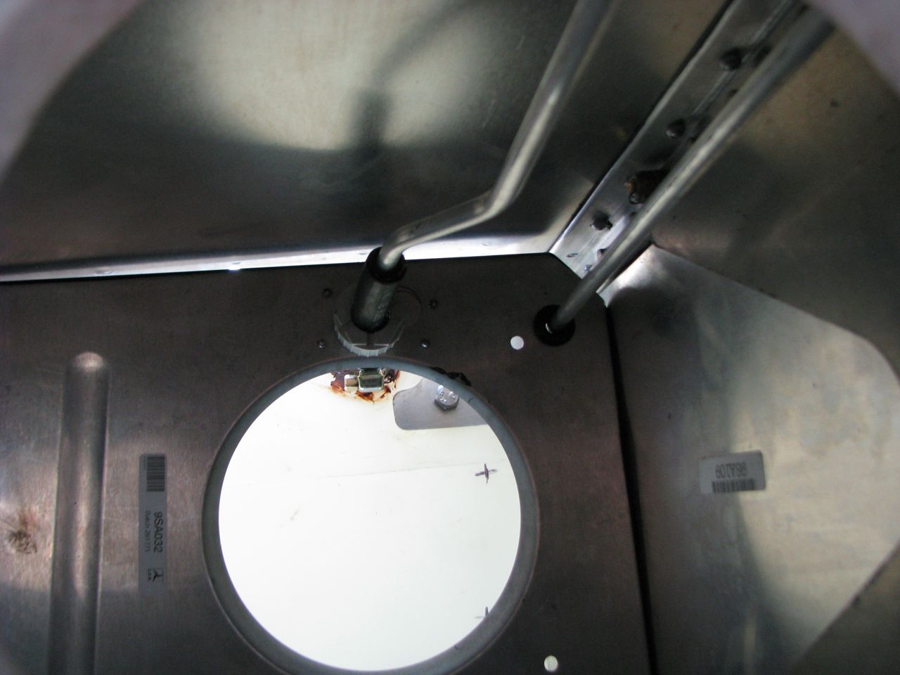

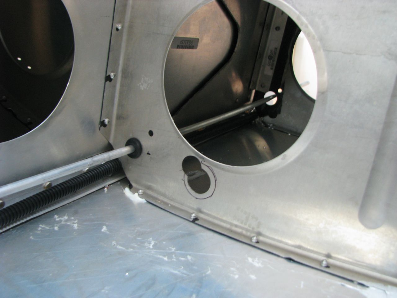

I had the outer tank plumbed and the tubes to the root ready it was the inner tank I finished off yesterday. As I have said before when you fit the gauge fittings into the tank using the measurements in the manual the holes don't line up so to make a nice straight entry through the rib you need to redrill the holes. This then leaves a pretty big hole so I elected to make up a support plate. The pics show the plate and how I marked it up I cut it out to make it fit then redrilled the hole in the support plate to make it a nice fit. I have used the electrical conduit fitting through the inner ribs where the fuel hose goes to make sure it wont rub through and it supports everything nicely. The inner tank I used the 1/4 alu tube as the outlet so I can fit better sight gauges. The outer tank tubes are closest to the main spar and the inner tank tubes are further to the trailing edge at the root rib. The rubber grommets for the outer tank are larger because that hole is already in the rib and I made the extra 2 holes for the inner tank tubes smaller so you can see the smaller grommet used. These grommets are all from Clark Rubber. I just have to put on the clamps for the inner tank tubes on and I just bent those tubes to make then fit nicely and come out of the root nice and straight. I have run Sikaflex at the rear edge corners of both tanks and to the top skin this should hold the rear of the tanks nicely as there crossbars that hold the tanks quite firmly anyway and I also put a little on the forward tank holding brackets as well. When I have done the final fixing of those crossbars I will run a bead from the edges of them to the tanks as well. I will order another mandrill for the rivnut gun but in the mean time I think I can modify the original so it will work
As there is no instructions on how to fit the extra tanks I am very happy with the way I have done it and it should all work nicely when I have sorted out the sight gauges I will post all the details on those as well

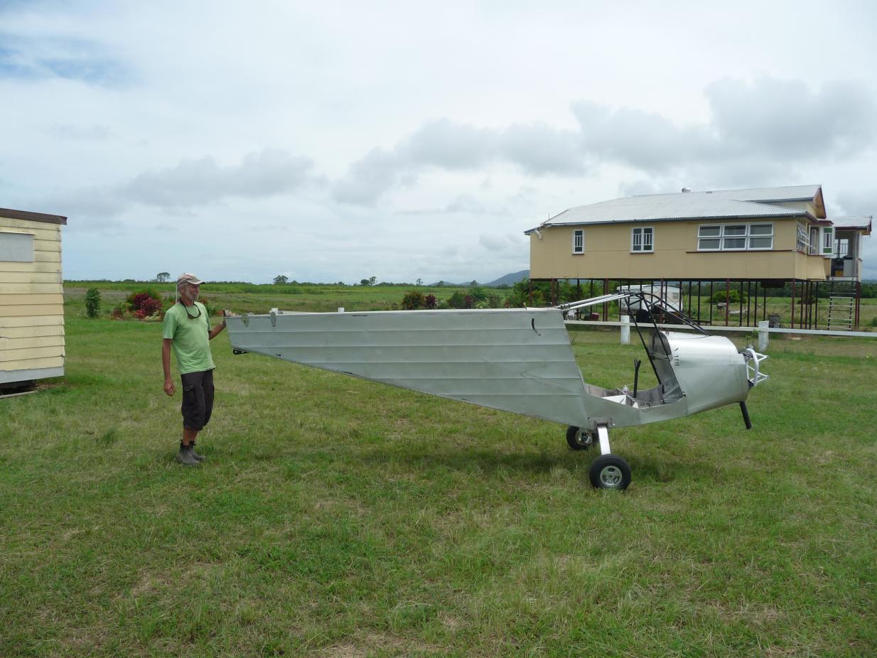

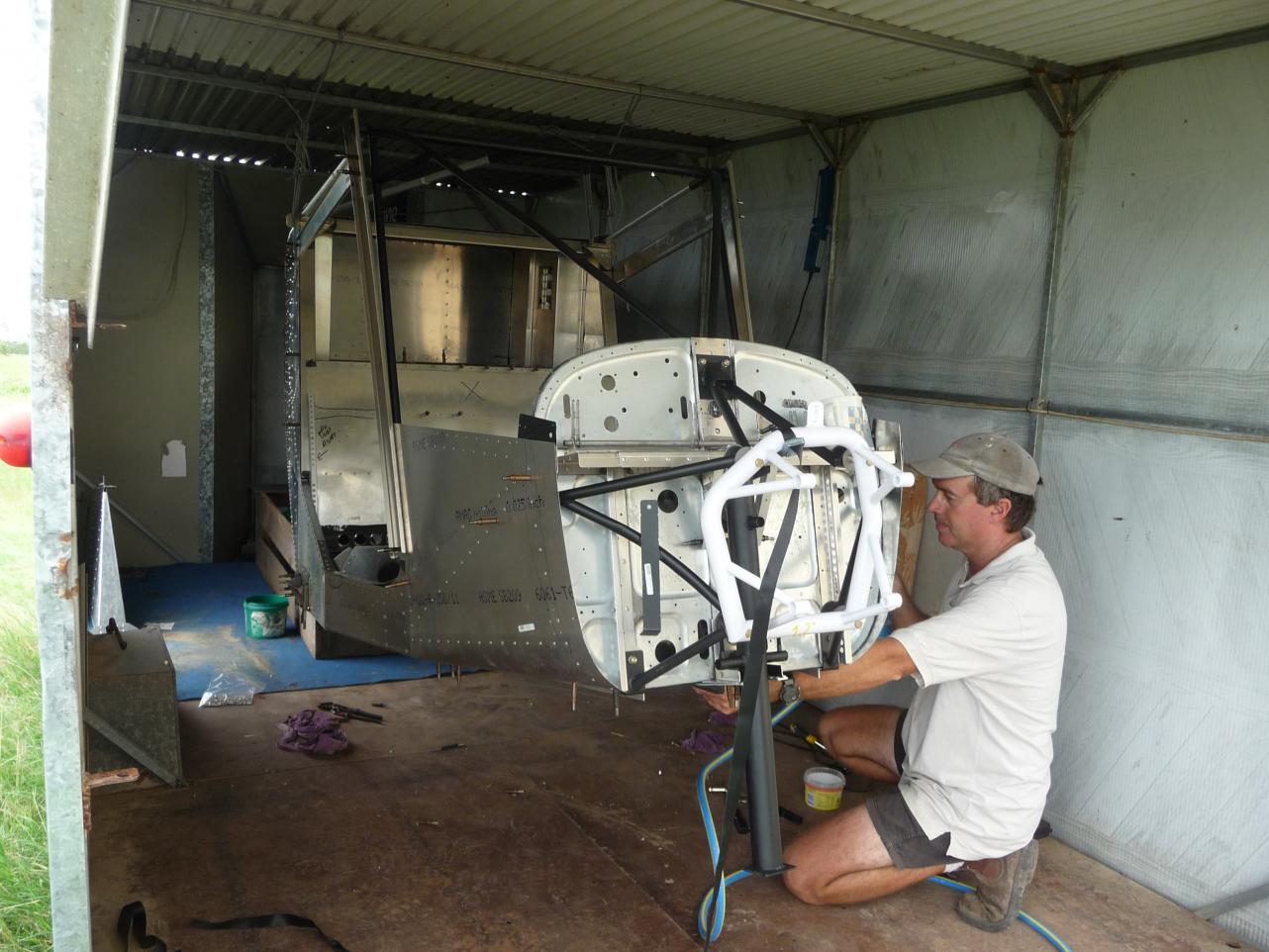

Its good to see you back on the job. My Savannah went for its fist roll today on its own 2 wheels[ATTACH]12632.vB[/ATTACH]. I spent today going through the parts that are left and there arn't that many. I did find a windscreen demister box, but there are no holes for it in the dash cover pannel, do you know if this has been superseeded now with the cabin heat. I also made a start on the right wing so I'm now going back through all youre old posts to see how its done.
I've put the doors together but not fitted them yet, that was arll quite straight forward so far and I thinck i've sussed out the hinge system so I will try to fit the doors next week.
It's good working on the plane outside as its not rained for at least 4 days now. Aircraft arn't meant to be left chained up inside![ATTACH]12633.vB[/ATTACH]

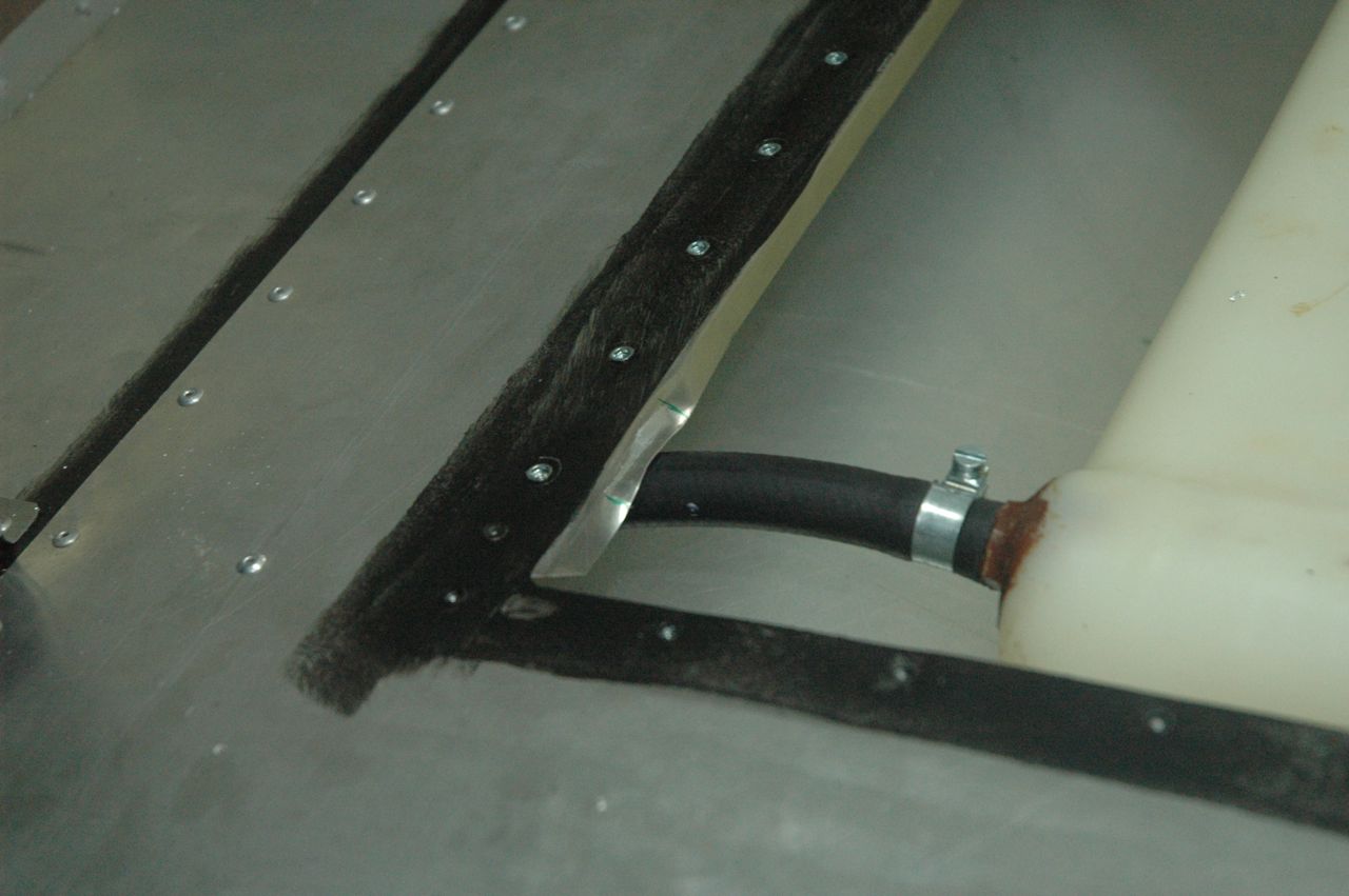

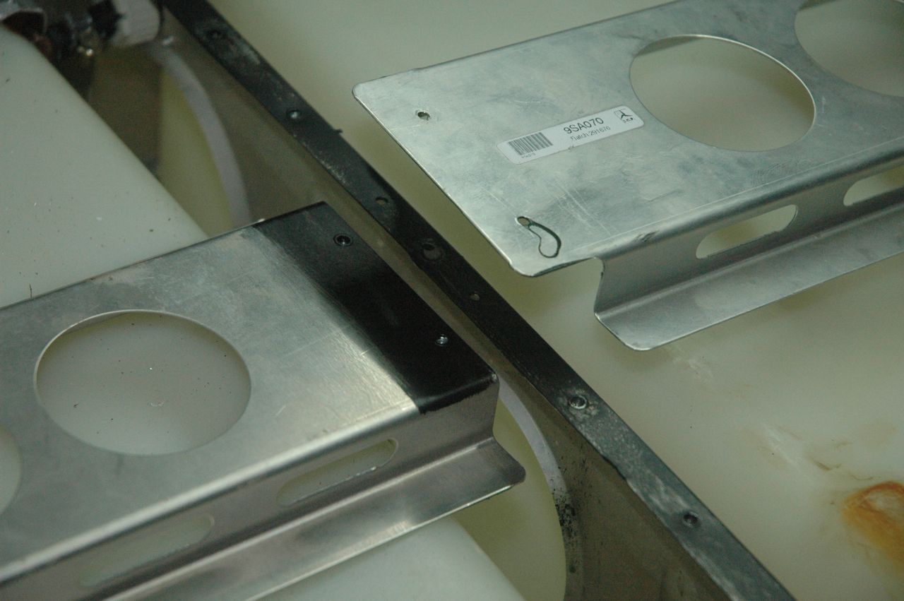

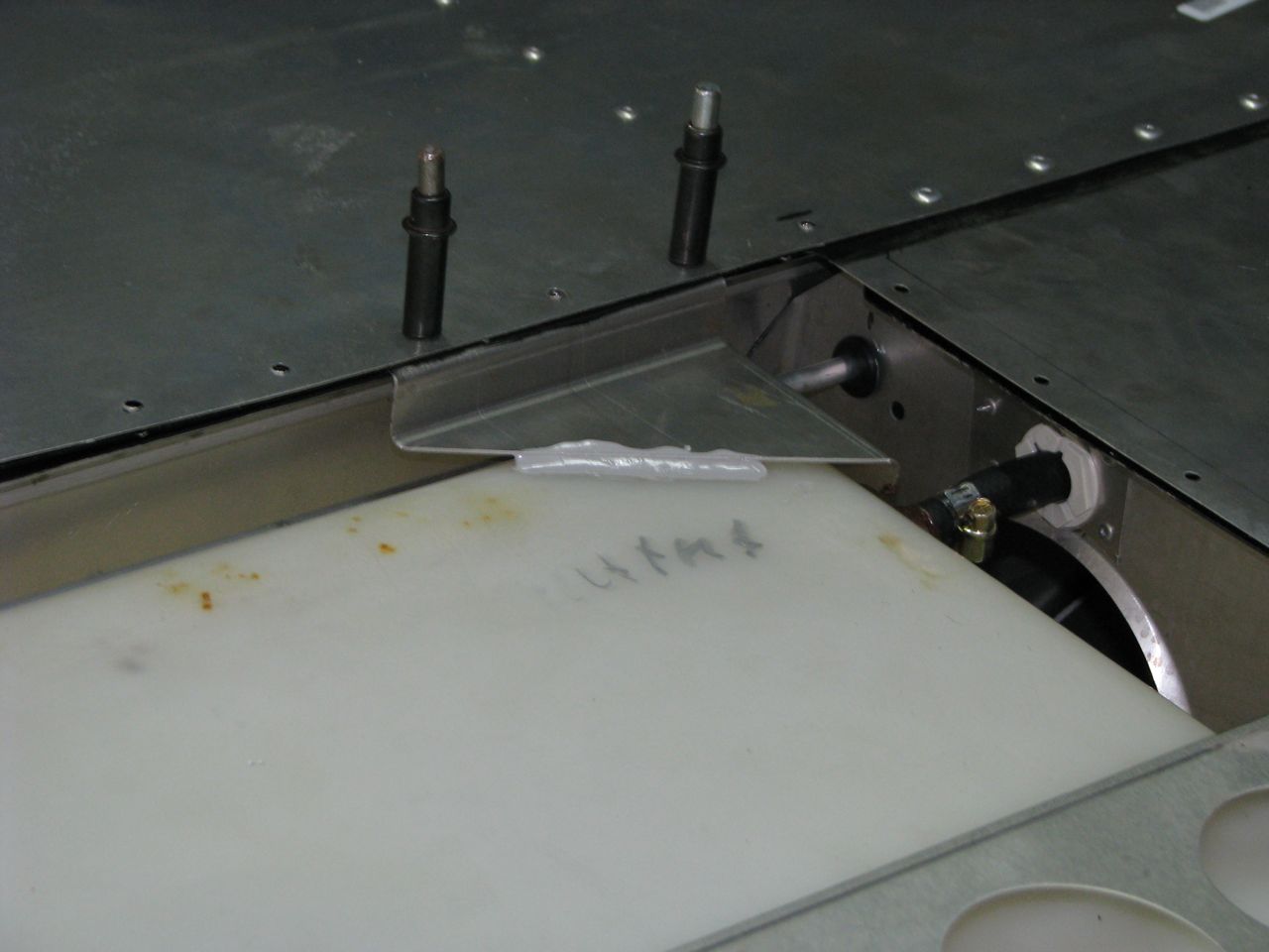

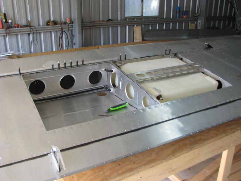

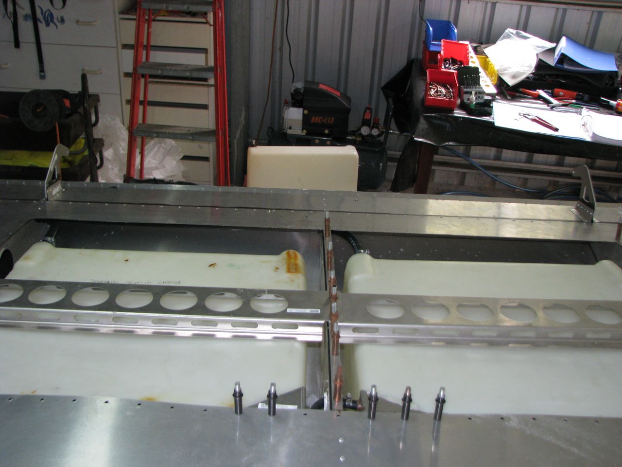

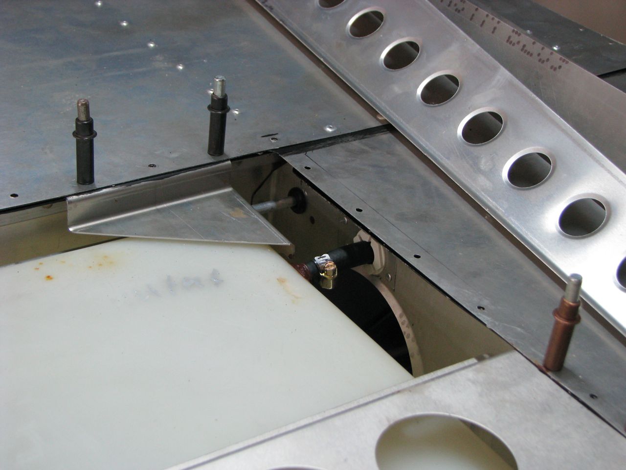

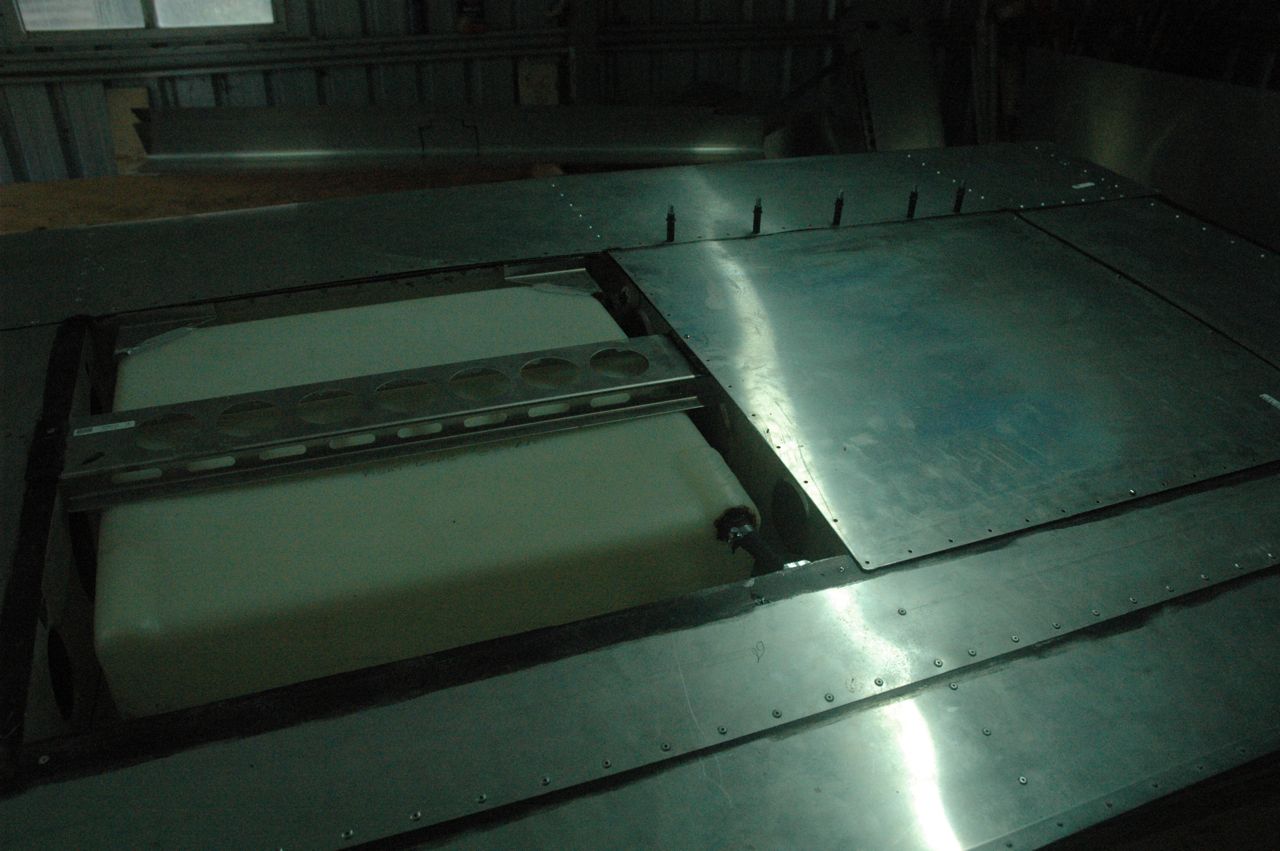

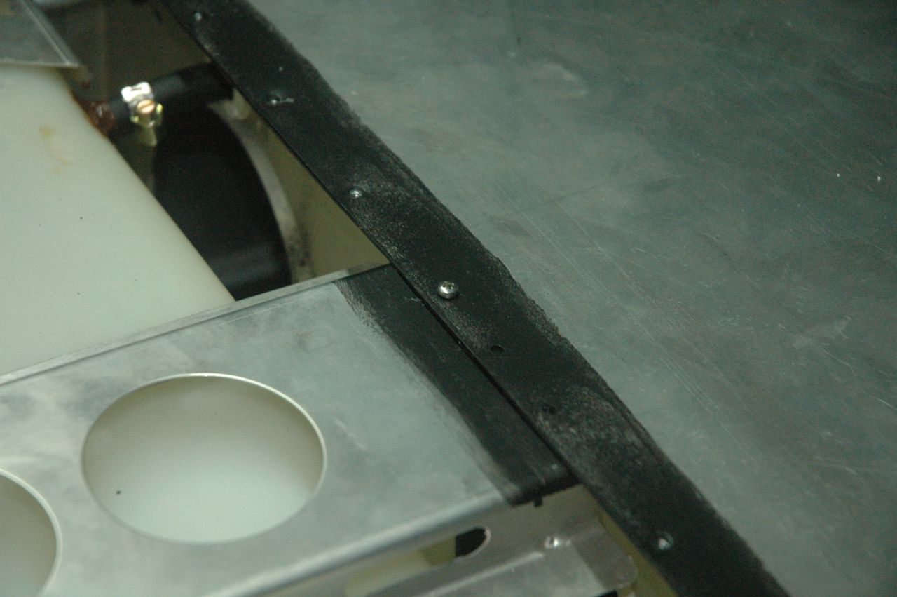

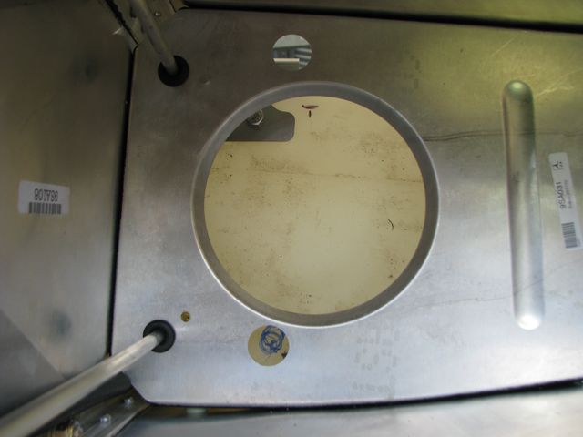

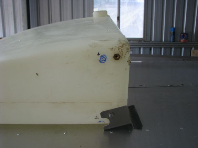

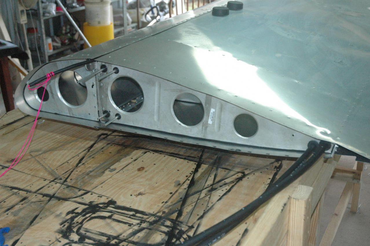

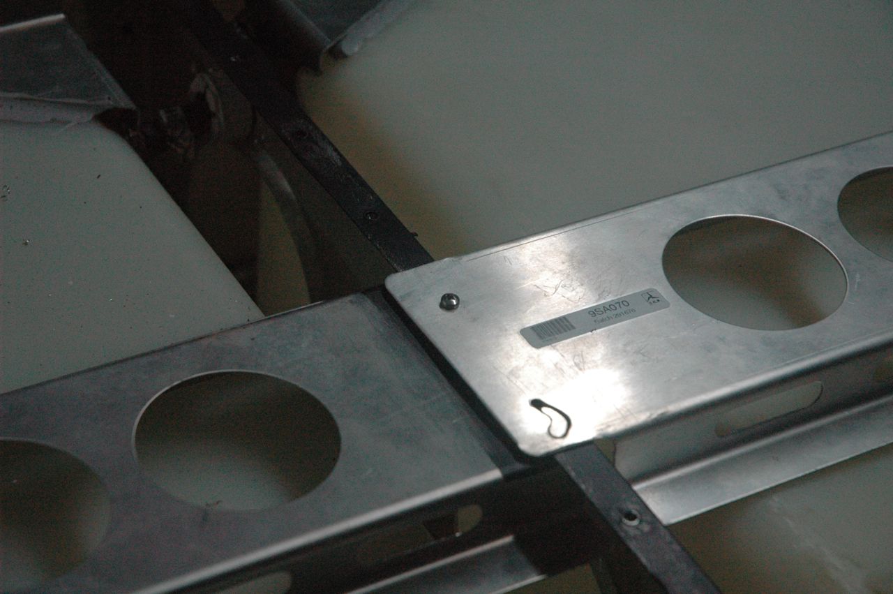

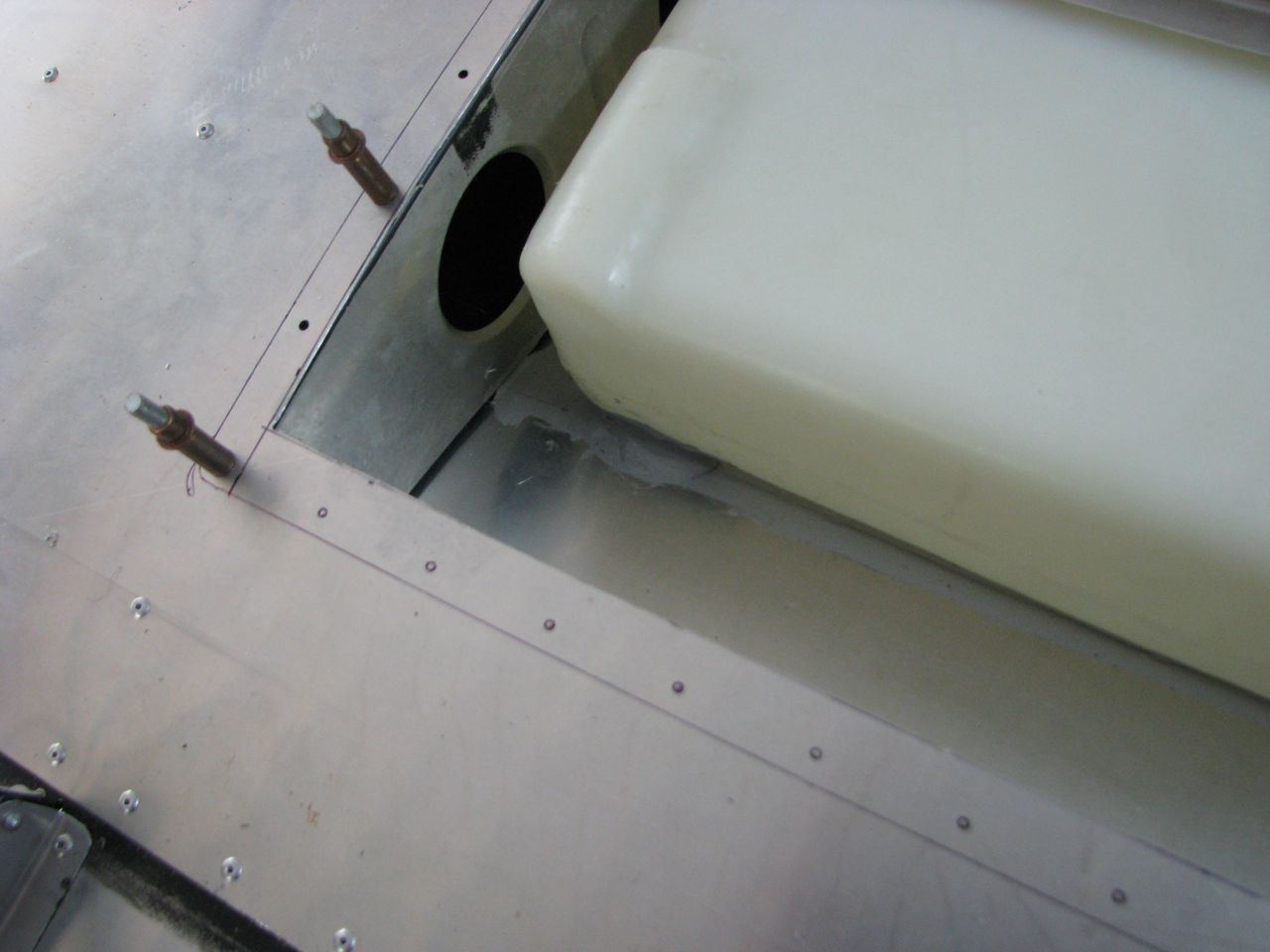

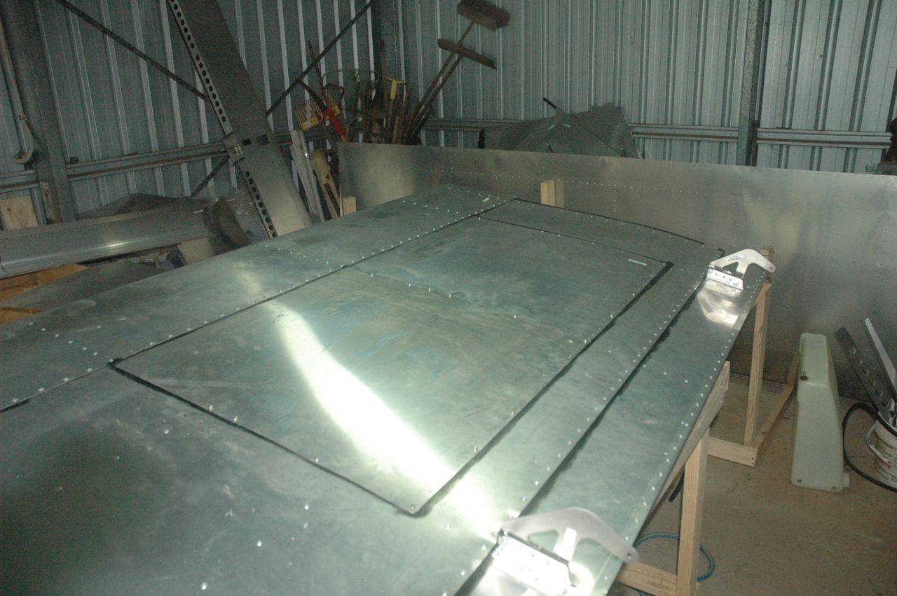

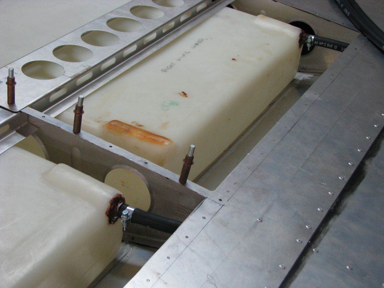

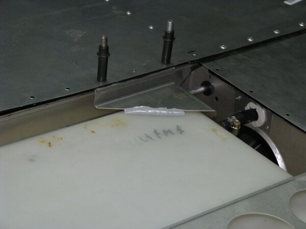

Got back on saturday morning here so managed to get there today to do some more work on the fuel tank install. Its finally pretty much finished except for the sight gauges which I will chase up this week. If you are riveting the tank skins then there isn't any real issue but if you rivnut them like I have so I can always have easy access to the fuel tanks if there is any leaks etc just be careful on using the rivnut pliers. I managed to break the mandrill the last time I used it the 3mm rivnuts are quite small and it doesn't take too much of a hamfist to break the thread off the mandril. I didn't chase another up but managed to stick it in the lathe and claw back the 7mm or so of shaft I broke off and it works fine. Well enough to do all the rivnuts for the wing so far so be warned do not put too much pressure on the pliers after you feel the nut collapse. Once it collapes just leave it at that. All the rivnuts also had a drop of loctite on them to make sure they stay solid.
The main issue to work out was the arrangement of the support crossbars and how they would be held with rivets and rivnuts. The bar over the inner tank is under the rib edge so the rivnuts are placed into the crossbar so that the bolts go through the skin then through the wing skin then through the top of the rib edge then they screw into the rivnut mounted into the crossbar. The centre of the 2 tanks on that rib is similar except the bolt goes through the tank skin then the inner tanks crossbar then the wing skin then the rib top edge then into the second out tank crossbar with rivnuts placed on it so it becomes a nice sandwich. The outer part of the outer crossbar just gets clamped between the tank skin and the wing skin hopefully all the pics will help to explain it.
I have put a few of the screws into place to hold the bars and some of the skin as I will come back to these for a final check once I have finished the rest of the wing off well to how far I will go with it until the final bits. I will need to get someone to give me a hand to roll the wing around to dislodge any small metal filings and cast offs that I may have missed during construction then i can vacuum and blow it all out so the wing will be squeaky clean inside. So after this I will then place the last of the wingtip skins in place and also seal around the tank filler caps so any spilt fuel does not get into the tank area. Then its onto the tank install into the left wing.
The tank install certainly has been a mission...I was told that but of course until you have done it you think its easy. There is not much information at all around on how to fit the extra tanks. I have done it the way I thought best and easiest also to be maintenence friendly and functional. I am sure it could be done other ways but after the first try failed I think this way is easier using the conduit guides and the alu tube.

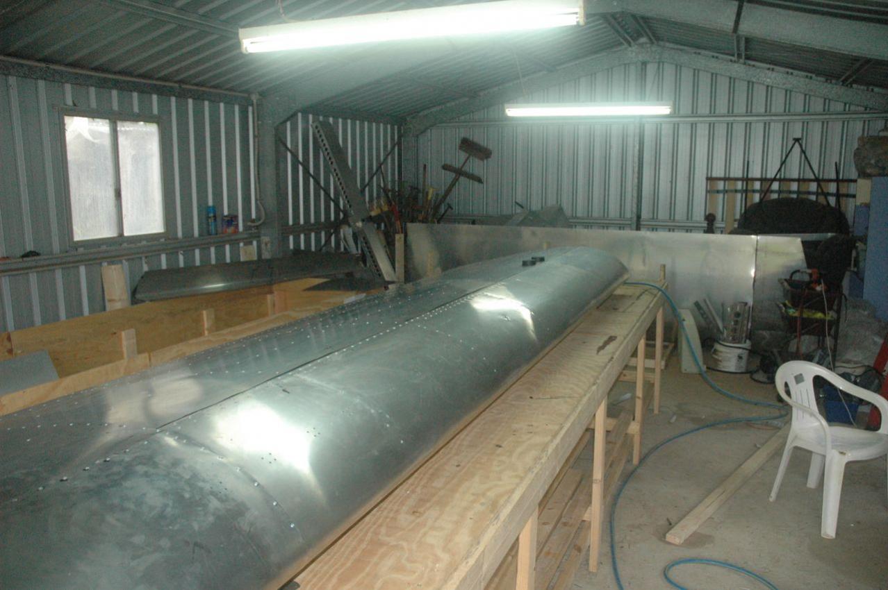

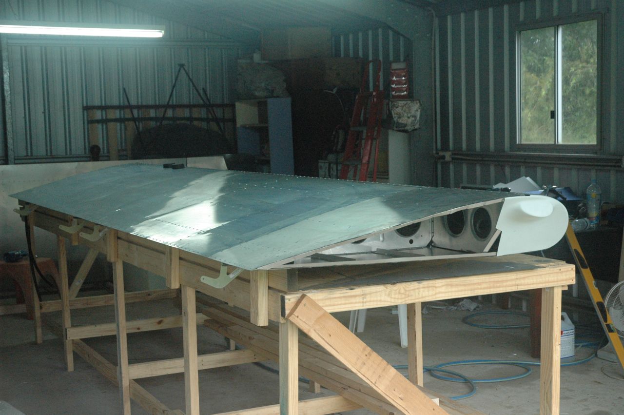

Hi Mark. Good to see one wing done, I.m sure the next one will be much quicker. I put the first rivets in the wing today.
I notice your bench is solid wood, I carpeted mine with quite a deep pile carpet, as there was lots getting thrown out after cyclone Ului last year. This made it easy to slide components around without fear of scratching them, and, especially with the fuselage, when putting clecos into the lower surface you can just push the cleco through the skins into position and into the carpet without having to lift the fuselage up. That seemed to make it a lot easier for me.

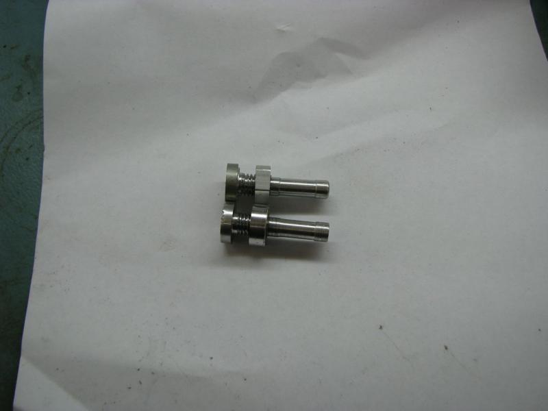

The sight gauges I will head off tomorrow down to the local festo shop here and get some 1/4 inch festos to fit and seal over the alu tubes coming out of the wing and get the same thing in 8mm for the glass borasilicate tube and machine a small coupling block to mate the two at right angles this will give me a nice fitting unit at the right distances and also they are great connectors if you have never used them because they seal so well. We use them on our model jet aircraft for all the fuel and air systems in the jet aircraft they never leak and last for years

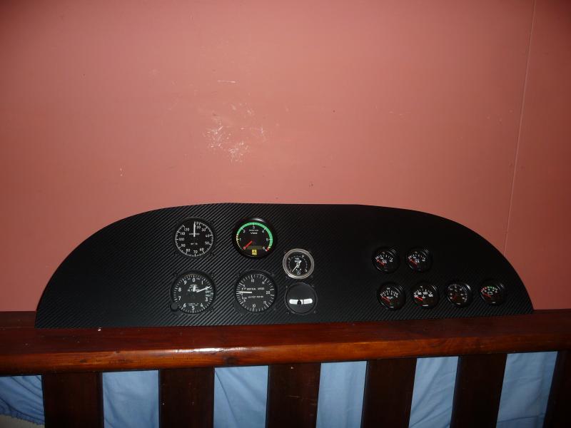

I put the instrument pannel together and its HEAVY, 3,5 kg!! How heavy is youre brauinger pannel? A few extra bucks to save 3,5 kg may be money well spent.

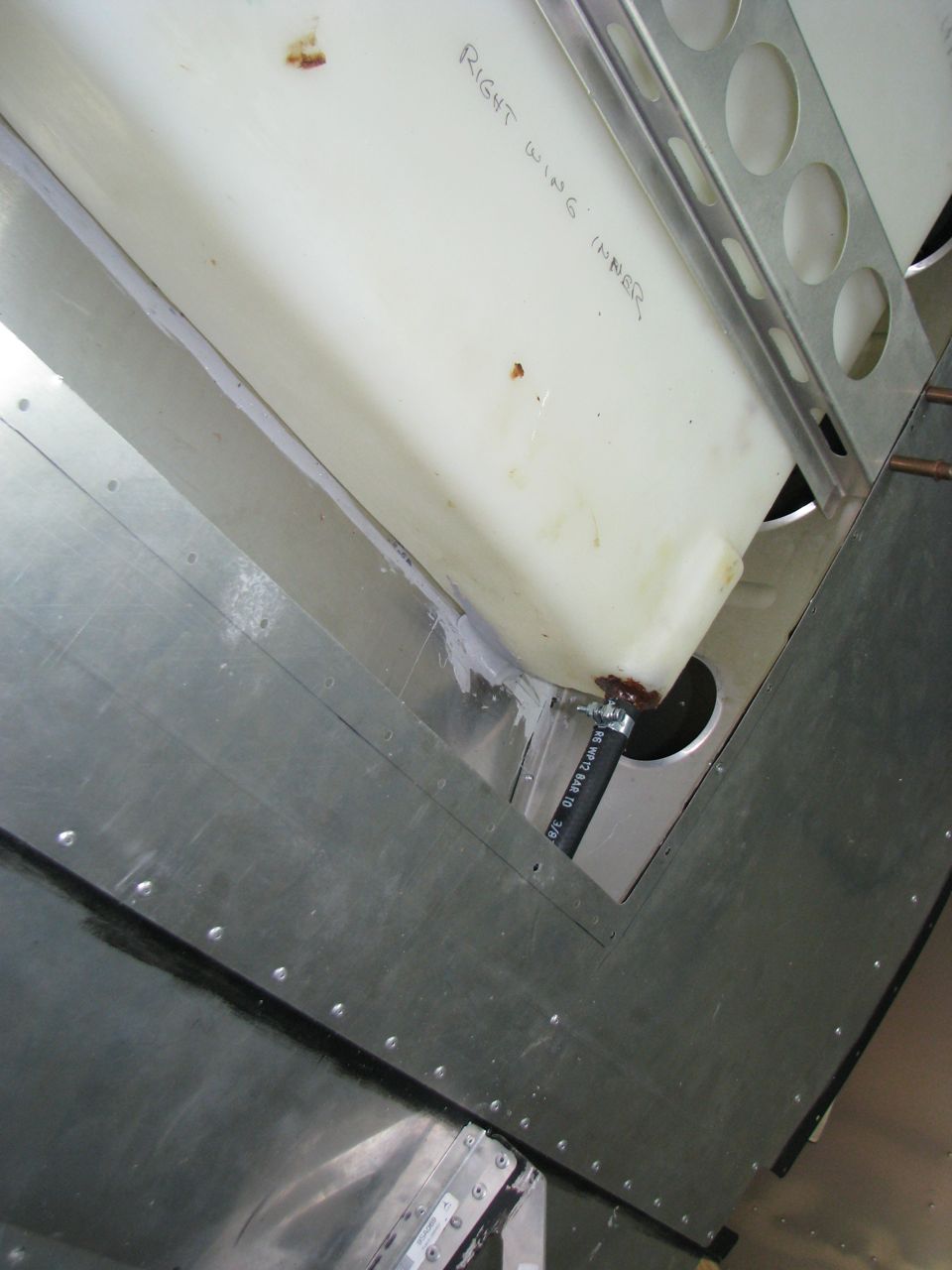

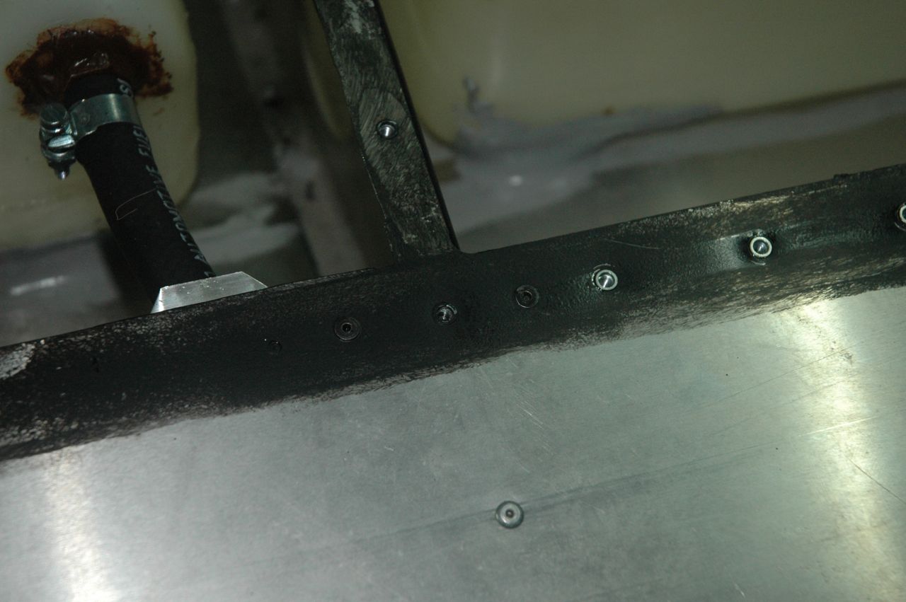

I have to say installing the extra tanks is a bugger of a job it takes a lot of time and a lot of fiddling around. I hate to have counted how many times I have had all 4 tanks in and out of the wings...but the light is at the end of the tunnel finally after today. I got the alu tubes hooked to the outer tank and then proceeded to put the fittings into the inner tank for the fuel gauge. Now because I am using 4 sight gauges I was 1 fitting short so I made one up on my lathe came out pretty good really and it was just like the supplied ones just it had a round nut instead of a hex one. The main thing I wanted to show was I moaned before about the sight gauge fittings not in the right place when you go by the measurements in the manual. You have to open the holes out in the ribs and then I have been plating the holes so the internal strength is still in the rib. On the tank picture you can see the black niko marks which are the manual measurements but the blue marks are where the original holes in the ribs are you can see how far out they are and why you need to extend out the holes the conduit exit guides really do make the hose transition through the rib excellent. So I fitted and sealed the 2 gauge fittings into the tank and left them to dry tonight then I will fit the tank and that wing is pretty much complete. Then it onto making the flaperons and elevator then its onto the really big job of the fuselage. I should be able to make that here at my house so will be able to work on it regularly pretty much a few hours each day or night so progress should be much quicker.
Ian...the brauniger weighs 1 kg. I see you have made a new carbon dash plate I got some 1mm alu sheet and have cut it out to shape but have not fitted any gear into it yet. The 3 Belite gauges have arrived I am going to fit and I am seriously considering a flat gyro compass in the dash as well. My dash will also have a angled downwards "glovebox" in it so I can have maps and other essentials in it and so they wont fall out on takeoff its angled down it will just be a open front but will have to think about some sort of flip or sliding cover so prevent all this falling out when practising stalls etc as the sav nose angle is unbelievable when doing stalls.

Did some more work on the sav today didnt really take any pics but basically the inner tanks is in and mounted and all the fittings are in. I will just check the sikaflex that I put on the tanks to hold them in place then it will be put the tank cover skins on and I can then get into the flaperons and elevator. Up at my mother in laws place I have to do some work around there is 5 acres so I do all the slashing and some of the mowing etc and it can be a pretty big job so anyway the upshot of the story is today while doing some slashing before I went to work on the tanks I came across this little fellow in the back about 20mtrs from the shed the sav is being built in...didn't have to worry about him today as he had already had a big feed as you can see
