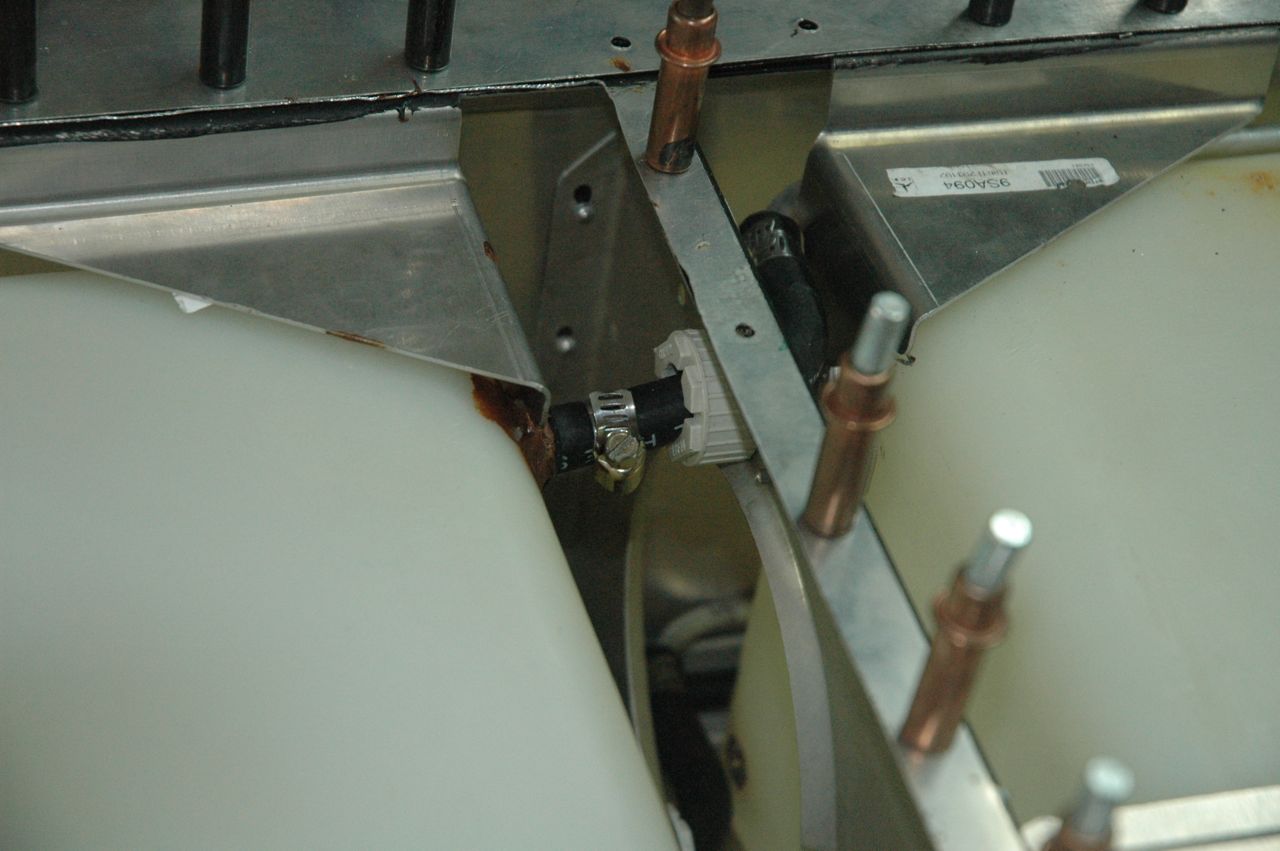

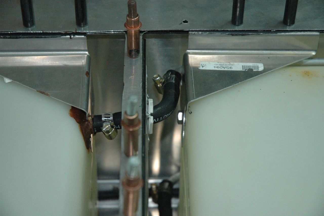

Anyway this gave me time to do a bit of work on the sav again. I have put the rest of the fittings into the fuel tanks now and sealed them over also looked at what extra gear I will need to do the pipework and tube. Have got a 1/4 inch tube bender ordered so i can bend the alu tubes for the second tanks also I might just have a small piece of larger hose onto the extra tanks then mate it up to a 10mm piece of alu pipe to run the second fuel lines at the trailing edge inside the wing I don't like the idea of flexible hose on that tank flopping around but will see how that pans out.

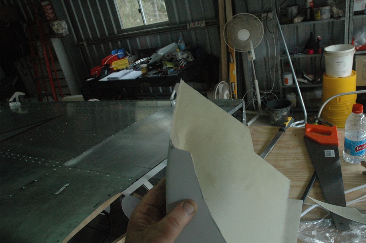

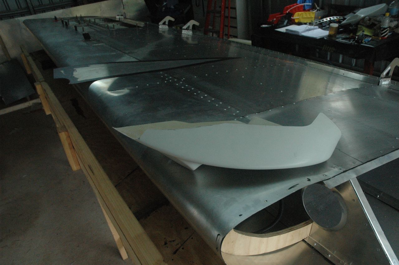

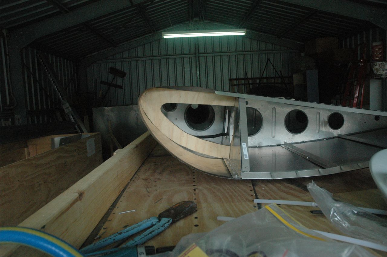

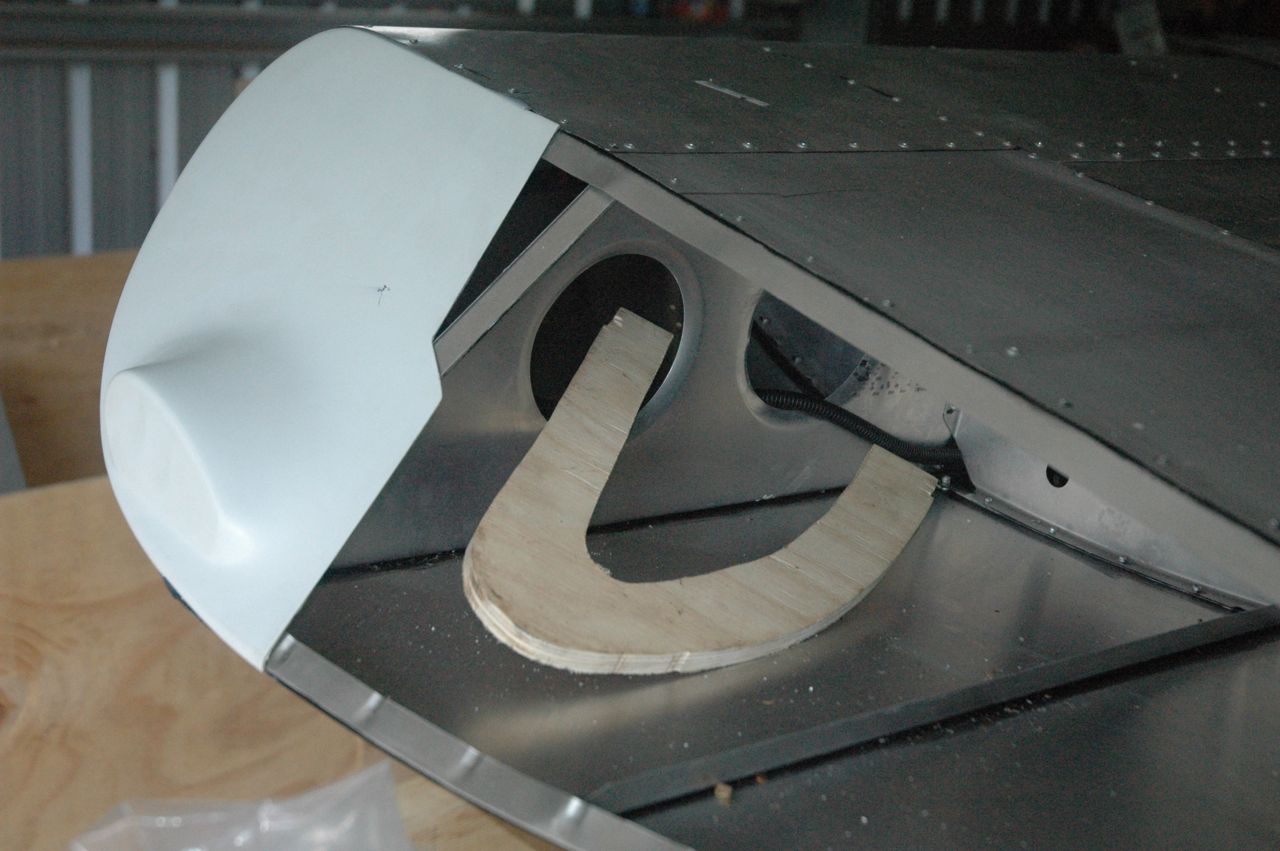

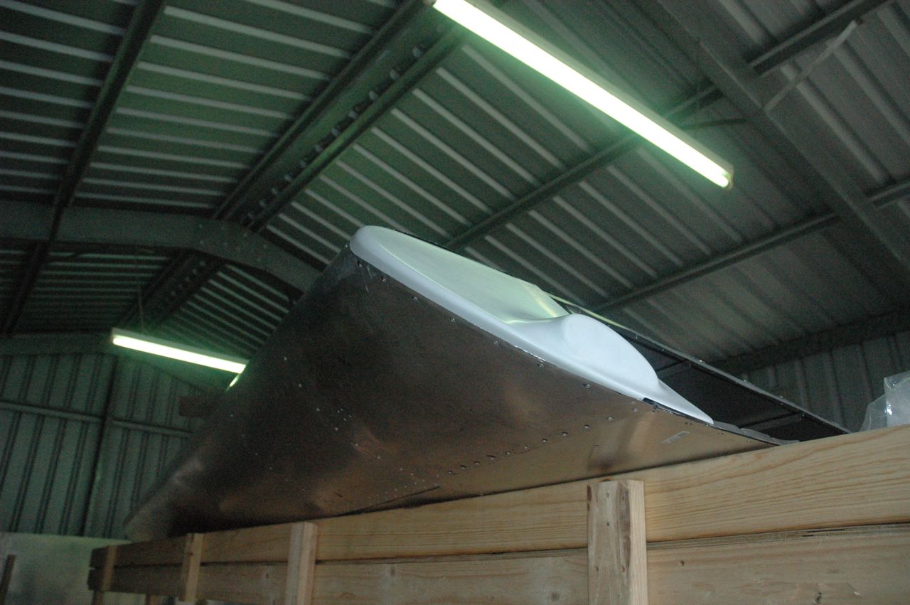

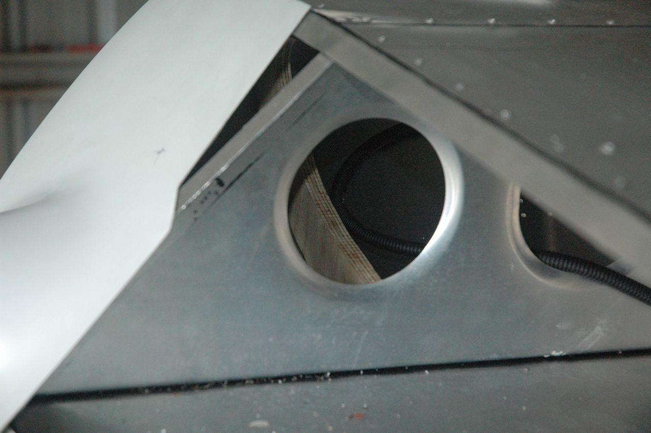

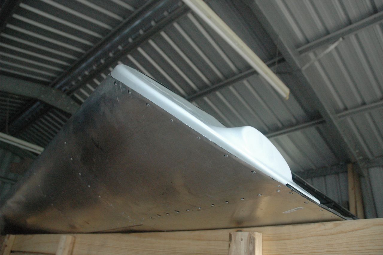

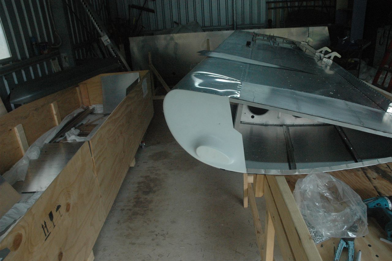

The big thing I did was sort out a easy way for those fibreglass tips. I spoke last week about making a plywood former to slip into the nose skin to help form it to the shape to put the tips in. You will see by the pics I made one after taking a template of the nose rib at the root of the wing it only took 3 mins on the bandsaw. I had it the right size straight off and put it in up against the main spar and slid it around and it pulled the nose skin perfectly then it was just a matter of cutting away the excess glass on the tips to make it fit between the strengthening bits on the tips. The hardest part was trimming the fibreglass and with a dremel with a good cutting disk on it made light work of it. It was so good it was easy to hold the tip in place while I drilled the holes for the rivets. All in all I am pretty happy with the way it turned out. There is a couple of small gaps in 1 or 2 places where I had relieved the fibreglass but a small wipe of filler will fix these easily. The main thing is you can leave the former inside until you finish the riveting then you can put your hand through the first hole in the spar and shift the former sideways then you can manouver it out of that hole and its out. I have to say just making that former made a real crappy job extremely easy
Mark
Hi Peter
yes it did..I remember posting a month or so ago about how trying to fit the tips had big knobs on it...and it is true but using this former its a dream now. So easy to do the only part you have any issue with is how much to the relief on the fibreglass to cut away. I did it all by myself with no extra pair of hands so this will tell you how easy it was...literally took me 15 mins to do where as before I mucked around for 2 hours. So making a former is the trick for anyone who is doing a build

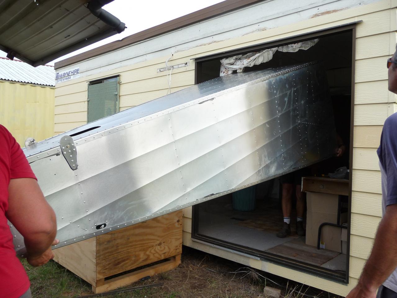

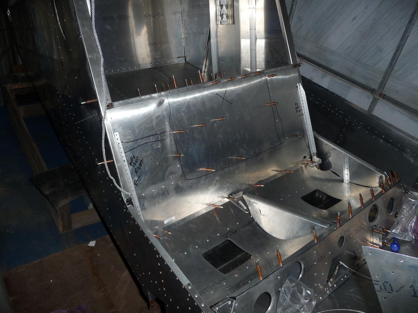

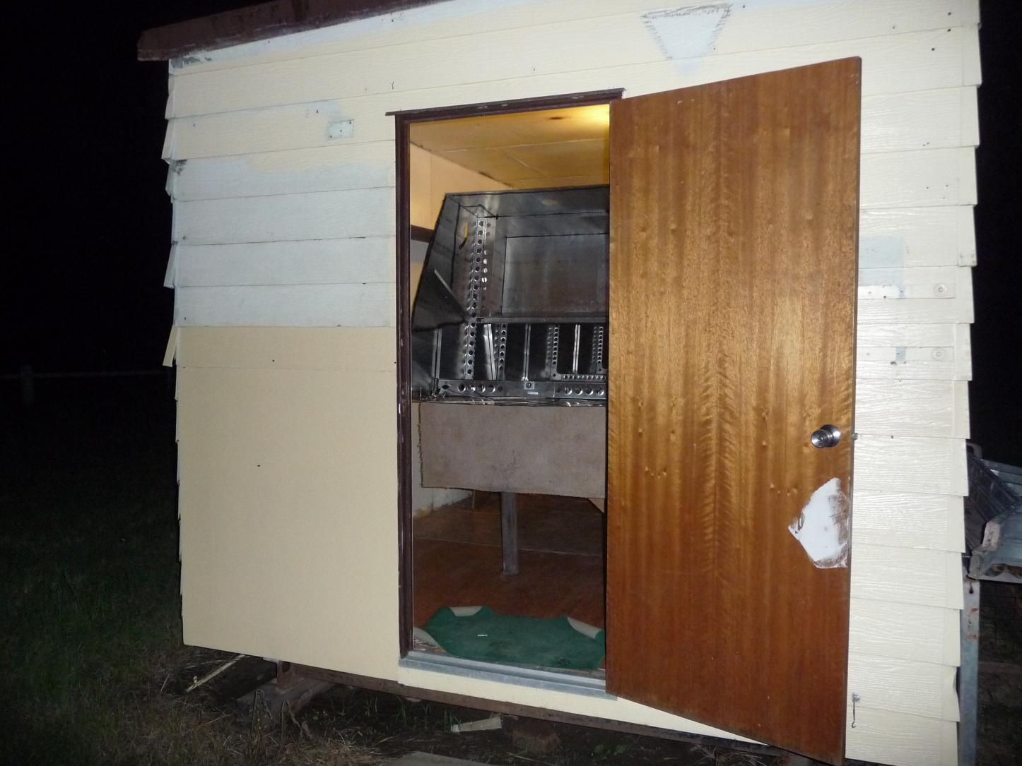

Hi Mark Great Tips for the Tips! I'll certainly give that a go when I get to the wings. I've just finished the rear fuselage. All went well, just it wont fit out the door now! I'll have to either unrivet it or take a chainsaw to the donga wall.[ATTACH]12415.vB[/ATTACH][ATTACH]12416.vB[/ATTACH][ATTACH]12417.vB[/ATTACH]

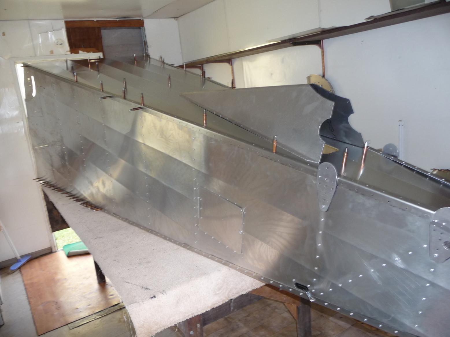

Hi Mark Great Tips for the Tips! I'll certainly give that a go when I get to the wings. I've just finished the rear fuselage. All went well, just it wont fit out the door now! I'll have to either unrivet it or take a chainsaw to the donga wall.[ATTACH=CONFIG]19394[/ATTACH][ATTACH=CONFIG]19395[/ATTACH][ATTACH=CONFIG]19396[/ATTACH]Ian
Ian, I was just wondering why the inspection cover on the fuselage doesn't have the "garden shed" strengthening/anti-oil canning crease in it?
Hi Eightyknots
Thats just the way it came. Its actully where the battery goes, the top edge certainly dosent seem to fit very well, due to it not being bent like the fuselage. I was thinking about putting a crease down it to make it match!

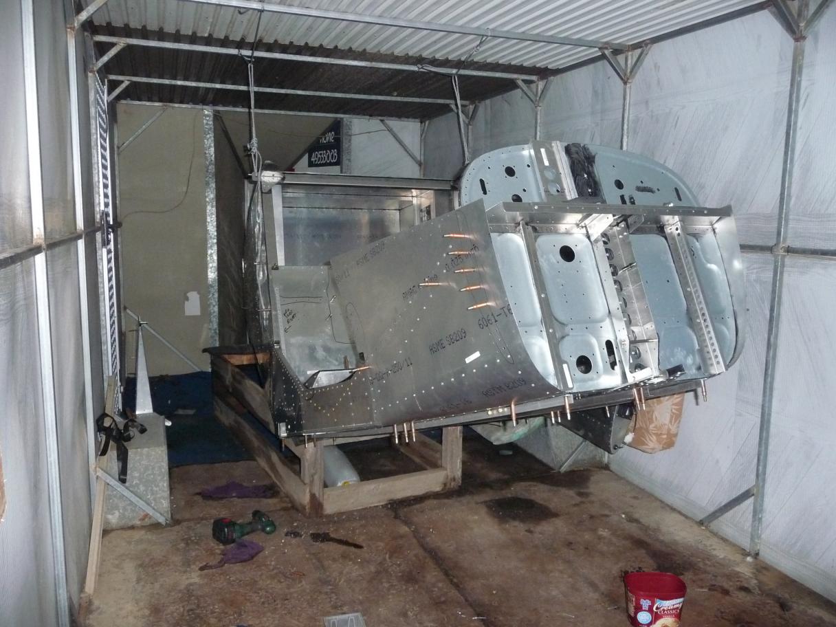

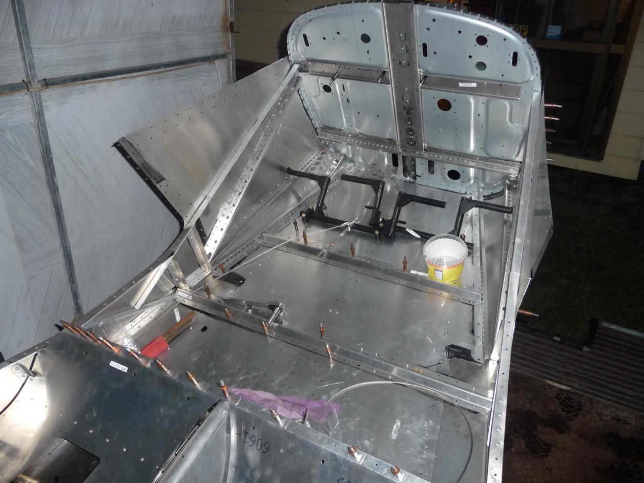

I'm cracking along now with the front fuse, assembly has moved into the drifter trailer once I managed to get out of the donga. Be careful when you put the long and short floors in, the description is in CAP.15 page 10 when they are installed at page 5! READ PAGE 10 FIRST I Nearly stuffed up badly. I think one of Reg's photos even shows the floor in the wrong order which nearly threw me.[ATTACH]12452.vB[/ATTACH] [ATTACH]12453.vB[/ATTACH] [ATTACH]12454.vB[/ATTACH]The rain finally stoped yesterday long enough the go for a fly, still very wet though[ATTACH]12455.vB[/ATTACH] Good to be in the air again! Firewall tomorow

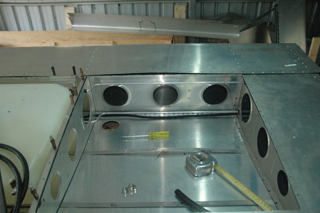

I bought a compressed air metal knibbler from Trade Tools direct for $68 last week to do the second wings tank hole for the extra tank and also the new dash as mine wont have the standard panel. Tried it here yesterday on the new panel and it was really smooth so don't have too much finishing now just a little filing and it will be ready. I wont get a chance to work on mine until next weekend again :( the only thing I am trying to chase up is a 1/4 tube bender to get the fuel sight gauge done for the extra tanks will get it next week and then I should have the tank installs done on one wing anyway the other wing will only take half the time as this one.

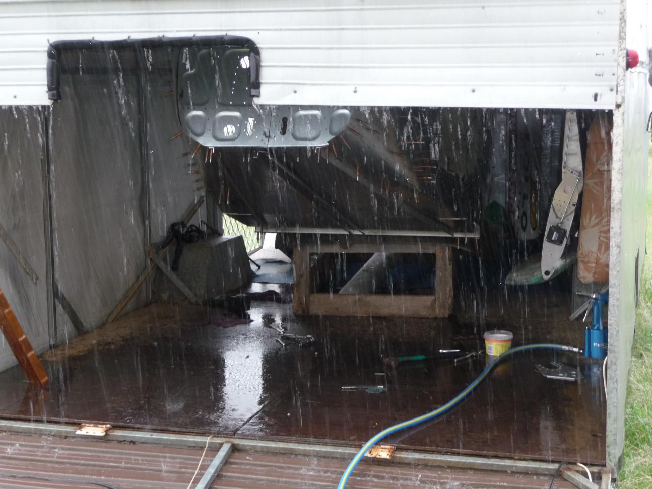

Lots of progress today, firewall, rudder peddals, front wheel gear nearly in. Rain did halt play for a while though. Work tommorow. Have you tried normal "tin snip's for cutting the hole out with? no good? Doesn't the kit come with sight gauges for the extra tanks? I havn't looked at the wings yet[ATTACH]12480.vB[/ATTACH] [ATTACH]12481.vB[/ATTACH] [ATTACH]12482.vB[/ATTACH]. Good look with the plumbing inspection!

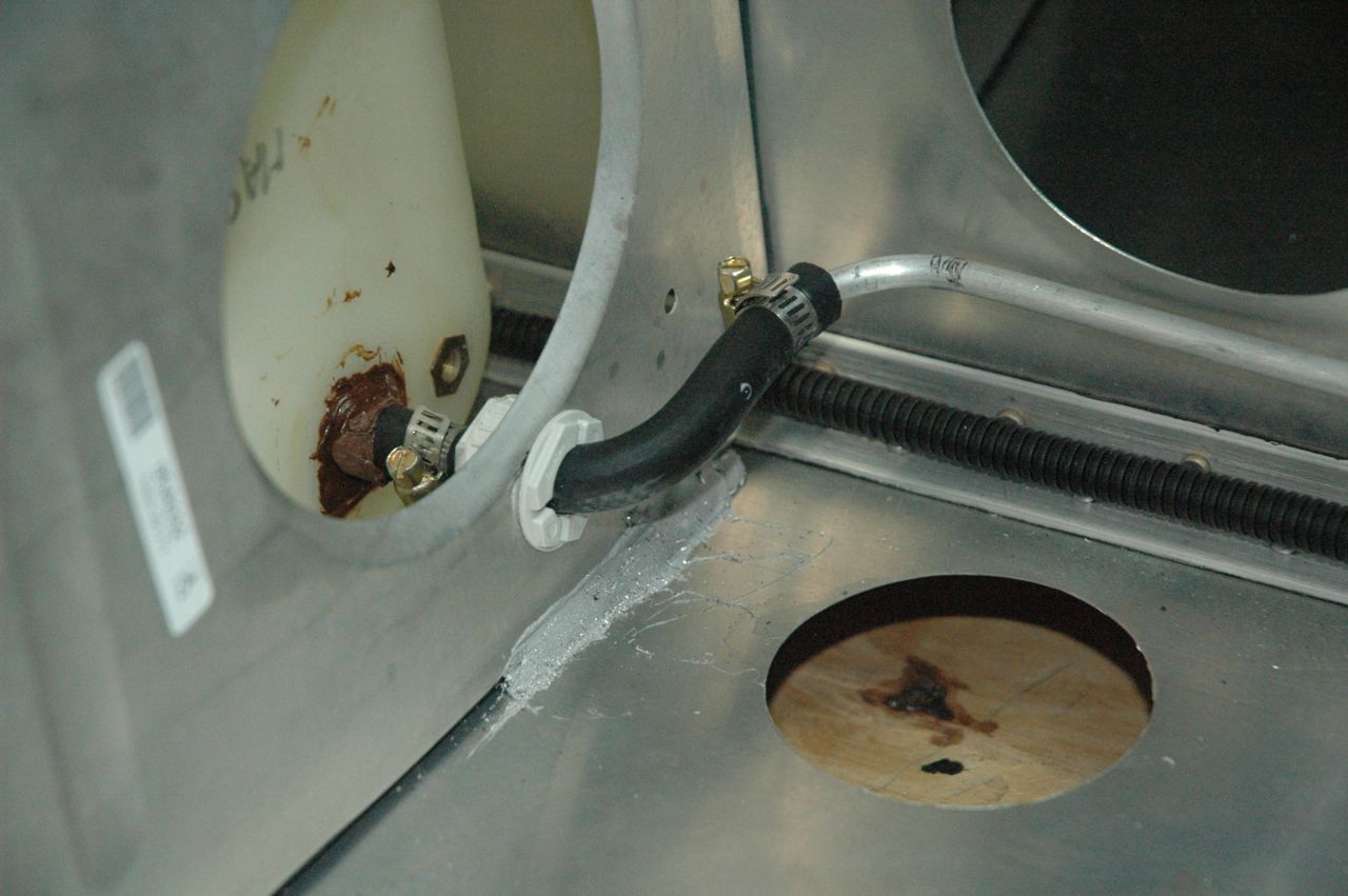

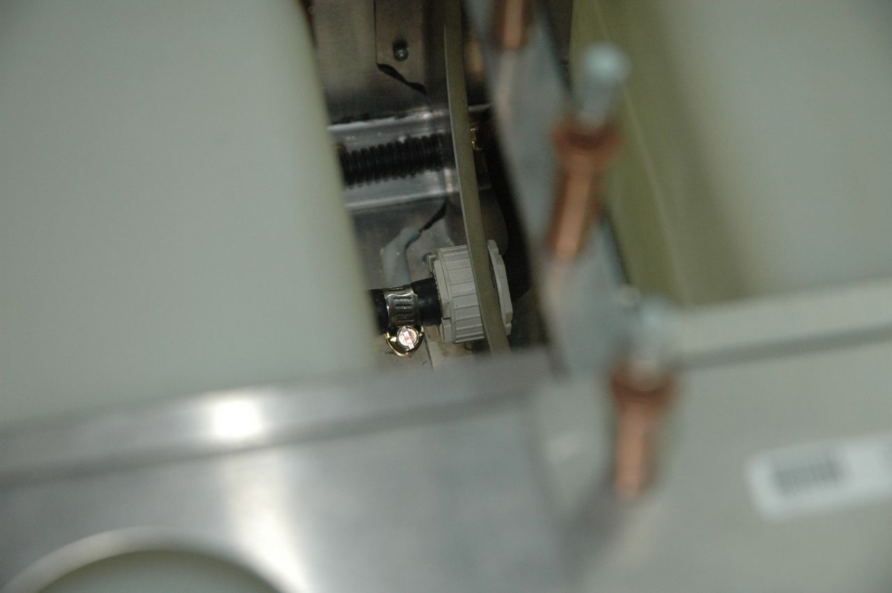

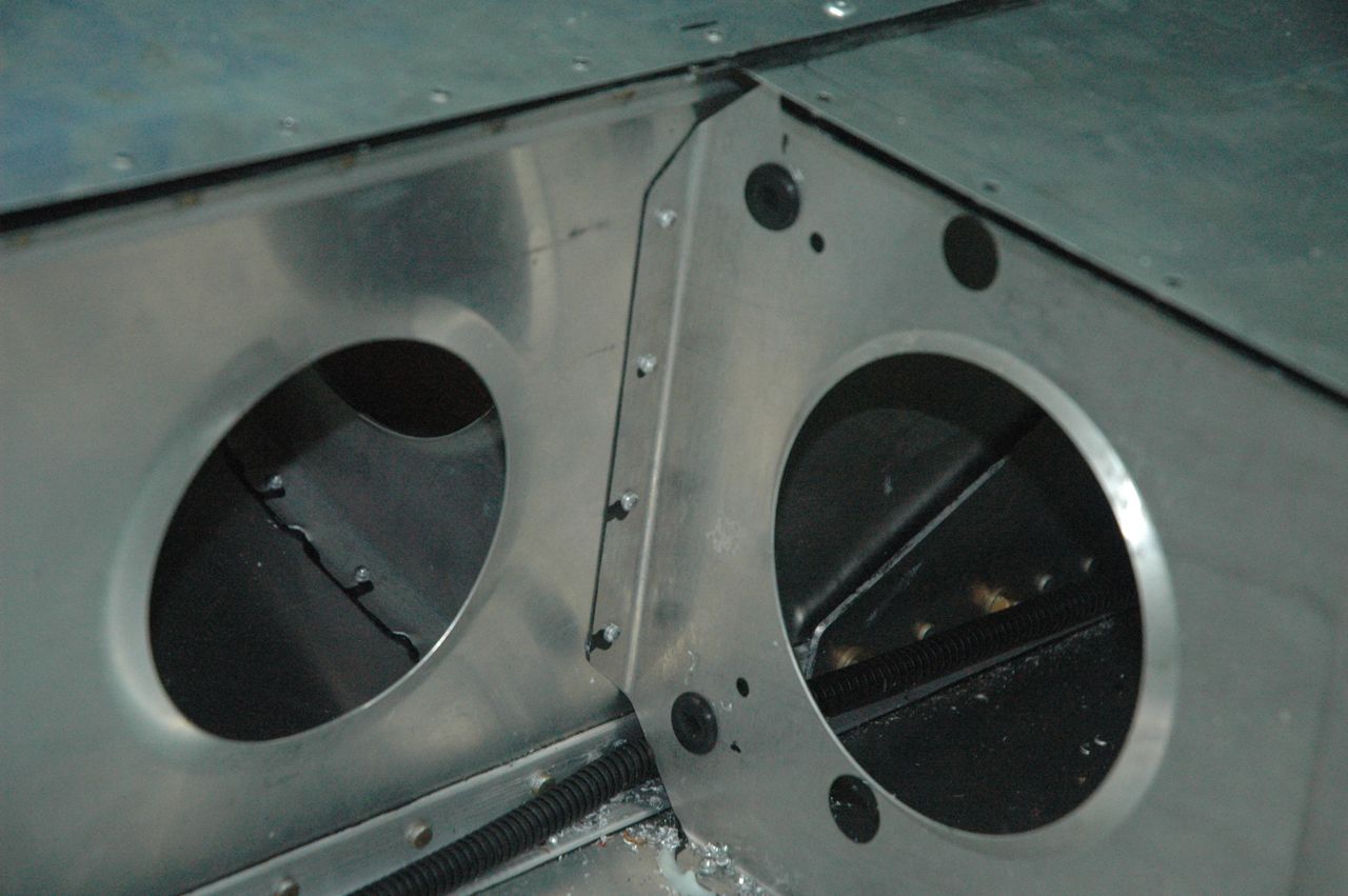

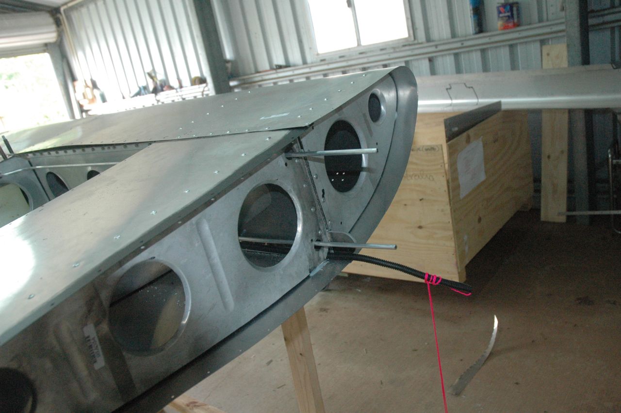

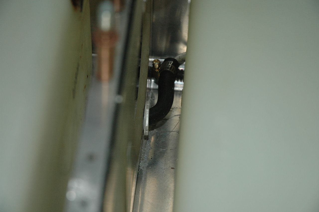

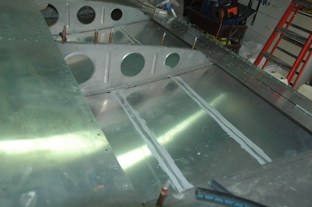

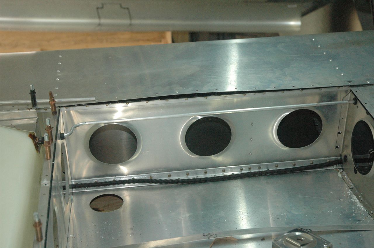

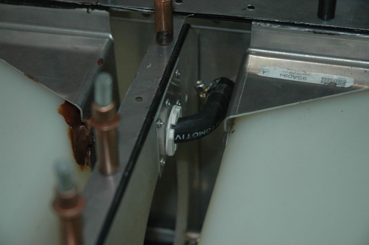

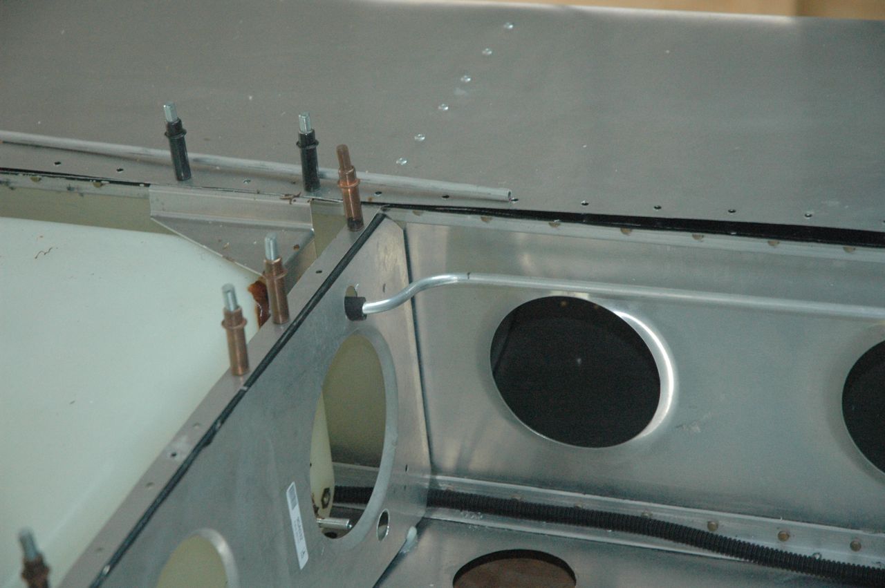

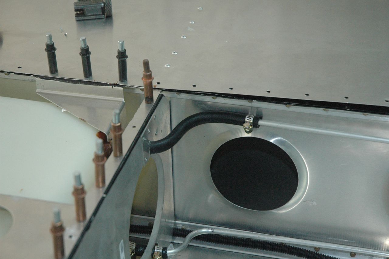

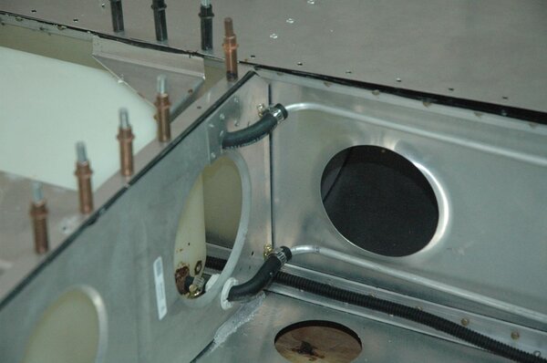

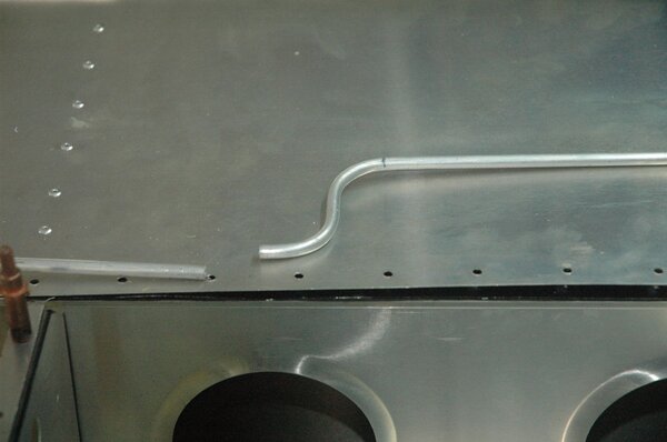

I came back from the property early so I had time to work on the tanks today. What a mission it was too. I was told a couple of ways to install the second tanks and thought that sounds easy enough... well maybe not. I will go through my first attempt then do another post with what I ended up with.

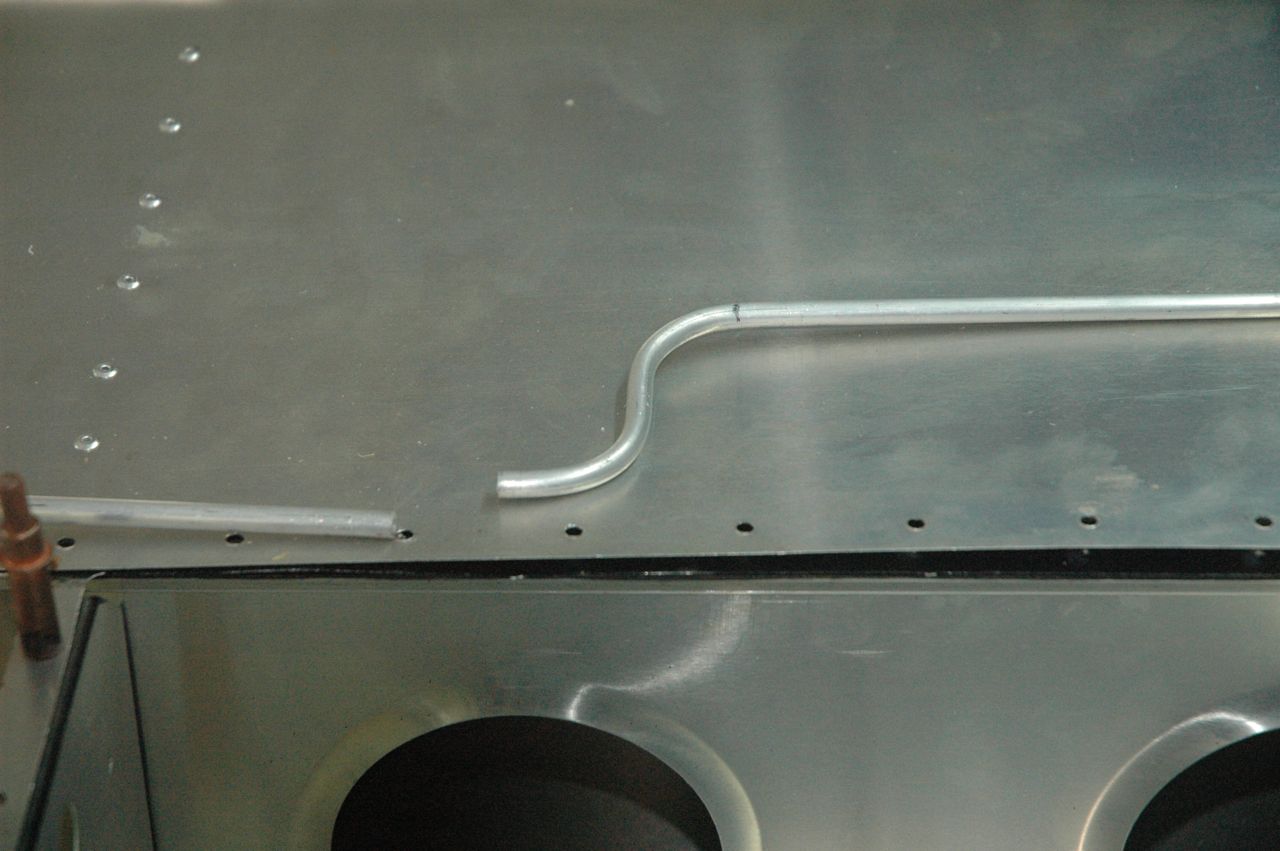

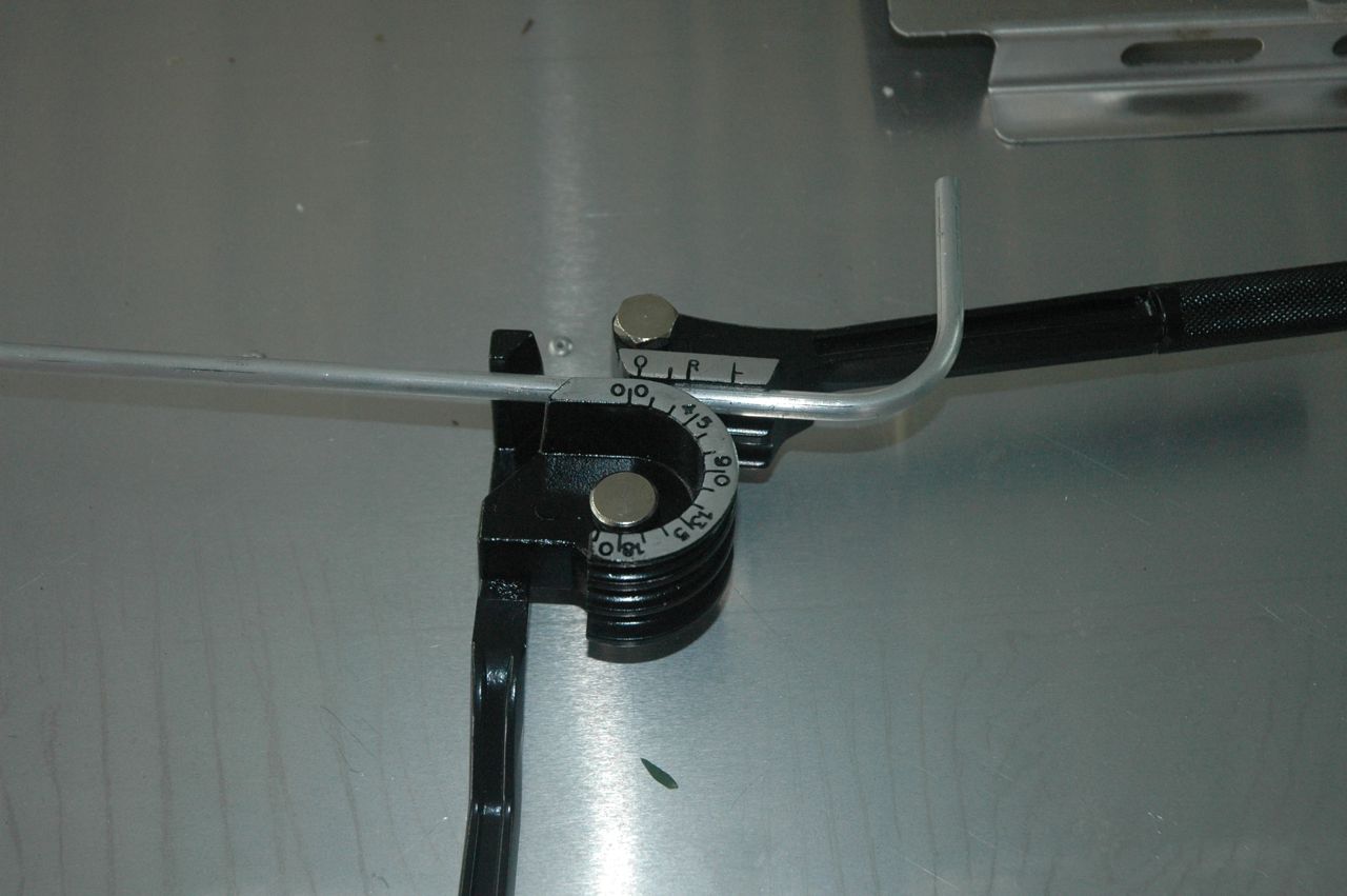

The extra tank I wanted to supply the fuel indicators by alu tube as I am not keen on the white tube they supply in the kit. I want to maybe use lexan tube or similar so I can actually see the fuel and having 1/4 inch alu tube I think will give me better options if not it is just as easy to fit the Rislan tube to the alu anyway. I got some rubber grommets from Clarke rubber but they were blank ..no hole in them so I could drill out to the size hole I wanted into the grommet for a nice push fit. I marked and drilled out the holes for the grommets in the second root rib and the tubes come out the pre made larger holes in the root rib. I will drill 2 new holes in the root rib for the main tank indicator. Then I bent the tube using a bender I go it from Autobarn which works like a treat too. You can see what I was trying to do with some nice funky bends it all looked really great and I kept it as close as i could to make it fit past the main tanks. I had it all fitted up but the main tank fit was not good too much pressure on the tubes and the tank so I decided to go another way..that was about 3 hours down the tube :(.
You will also see that I cut strips from sheeting scrap from the tank holes to make 2 skin tensioners to cover the holes cut in the skin. Most guys just fit a strip over them with sikaflex but I made mine go under the other just like as if there was no extra tank there I also made a second set for the main tank and did the same so they are all locked by rivets to the wing skin. All 4 strips are sikaflexed as well so they wont move or slip and give me a lot more strength there than just the skin
Ok another post shortly for the final version

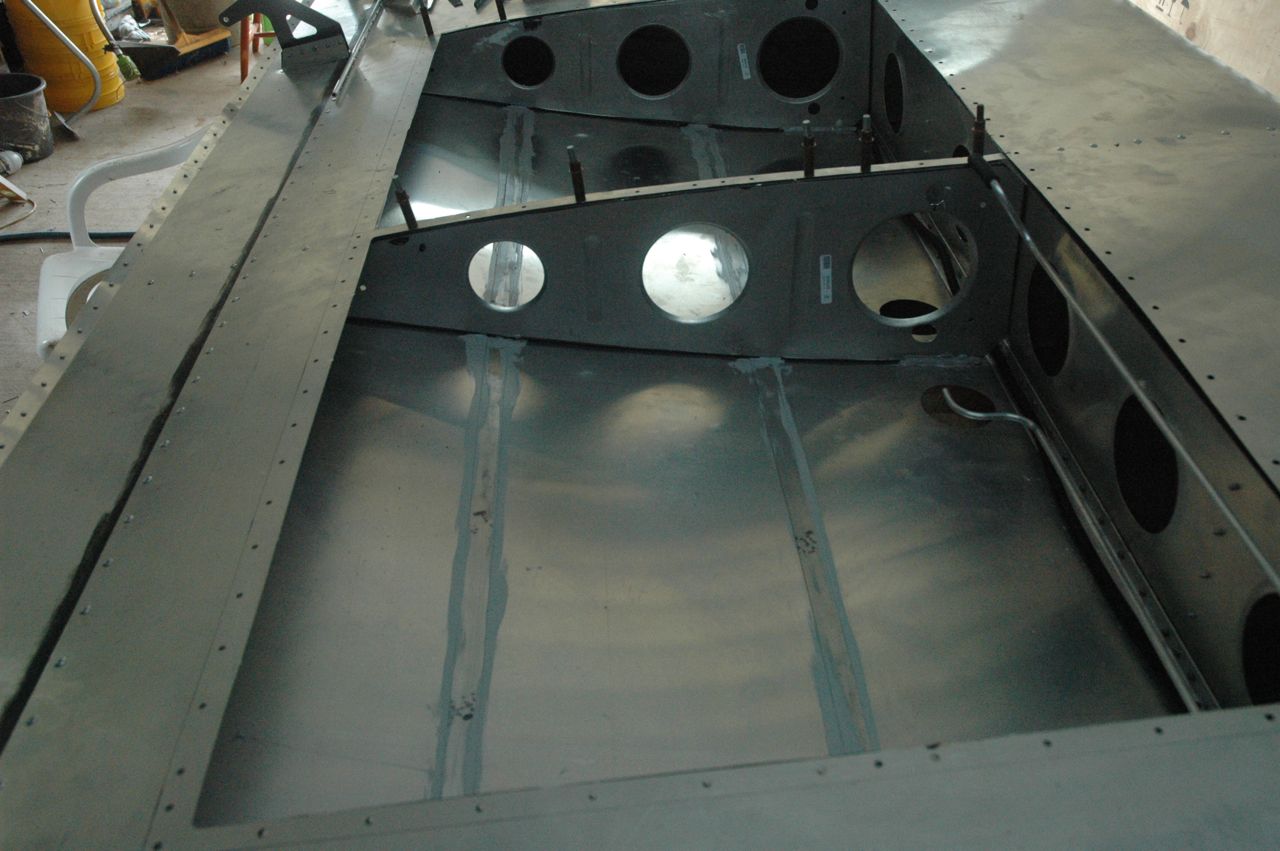

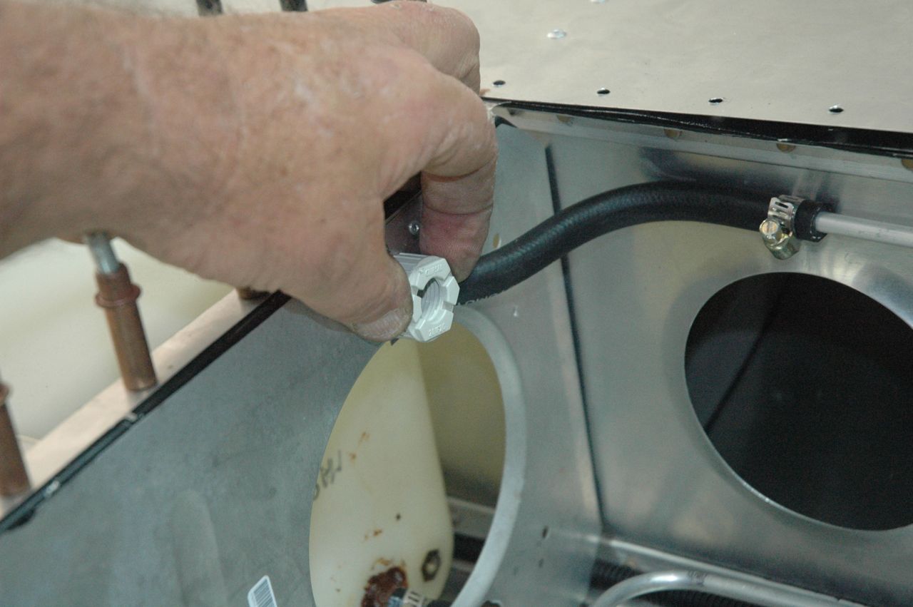

What I ended up with was this
I wasnt happy with the way the tank indicator fitting were placed into the tanks...dont use the measurements in the manual do it by trial and error and marking it will be much better and save a lot of extra drilling and filing and fixing...you will note I have had to put 1 small filler piece in because the hole got what I consider to be a little large. I thought I would just have the 1 bend in the alu tube and use the actual fuel tube to do the bend around the tank. This worked much better so I had some nice conduit feed throughs which the fuel tube fitted nicely through and would make a perfect grommet for the rubber fuel tube so it couldn't be cut or rubbed on through the ribs. These worked so well I will use them in the different sizes for all the rubber fuel hose. The pics are pretty much self explanitary as how it has ended up...I think a much better job all round and probably a bit safer against rubbing. I will check a few more things and clearance around the tanks and maybe might just buffer the tubes with some neutral cure silicone if I need to I will take some more pics of that.

I almost forgot...the wing I am working on is the right wing. The main tank in that wing doesn't have a sight gauge as it is used for the fuel return from the engine....mine will have the fuel return will go into a "T" on the top input to the tank it wont make any difference to the operation but I will know exactly how much fuel I have in all 4 tanks.

looks like it was raining cats and dogs there...I don't know how you are building the sav in that trailer...I couldn't fit in there with the plane or either i would have a crook back from being hunched over working on it. I am blessed to have a 6x6 mtr pretty much empty garage to build mine in so far and the fuse will hopefully be done over here as I have created a lot more room in my big shed it is 12x7.5 mtrs. I will leave the wings and tail feathers at the other garage until they are needed. You are really powering along with the fuselage how many hours so far do you think you have put into the fuselage

Excellent sharing of build info. It will benefit everyone.
Just one point to watch - lexan or any polycarbonate is destroyed instantly by fuel.

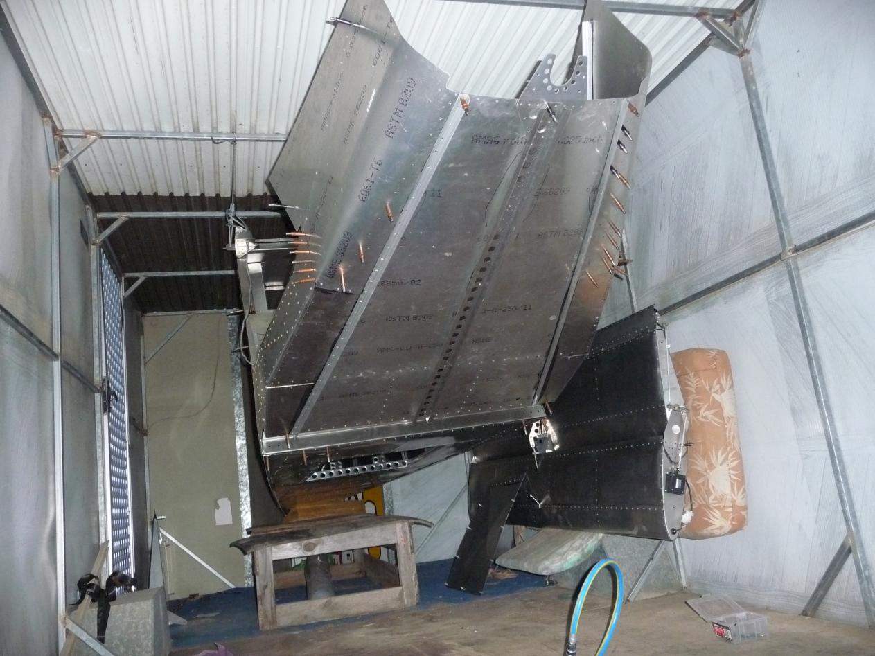

Hi Mark Thanks for all the great info on the tanks, it will give me something the think about when I get to the wings. Initially the fuselage grew very rapidly but has slowed down now with all the fiddly bits ont the fire wall. I've no idea how much time spent on it, probaly about 6 days or 60 hours so far. I'll be doing the cabin frame today, it sounds a bit tricky getting the measurments right. I think the secret is "dont rush and read the instructions, read the instructions and read the instructions again"
It is a bit cramped in the trailer but I suspend the fuse from the roof to work underneath. I now have the donga empty to do assemly work then into the trailer to fit bits. All would be fine if if didn't keep RAINING. once the wheels are on I'll move into the hanger for final assembly. Just have to shuffle the other aircraft about a bit.

thanks for the heads up on the Lexan and fuel...I will do some research into how I will do it...I want the look of clear glass but don't want any glass in there so I will ask a few people I know about what to use but I am sure I can make anything I need to make the couplings to the sight gauges. It helps when you have a 4 axis CNC machine at home :). Also had a think about the fuel return as well I may have to put another entry into the tank for it as having a "T" in the same line will give a false reading of level while the engine is running but not of course when the engine is stopped. I will have a fuel switch system so that I can switch each tank in each side individually basically its 2 switches each one will switch the outer tank and inner tank on each side

Whats wrong with using glass? as long as its well mounted and out of the way there should be no way of it breaking. Glass would probably last longest as most plastics will degrade with time.
Just a thougt
Ian
Hi Ian
I was thinking that it could be easily broken but after thinking about it they are way up in the wing root and out of the way and reasonably protected there wouldn't be any issue. This would make life easier as you can buy push in festo fittings like they use in the top of the tank screw caps for the breathers for the tanks. These fittings can be easily made to fit to the end of my 1/4 inch alu tubes coming from the tanks and the glass tubes will have nice seals then I also think you can get the glass tube in a toughened format as well. I will chase this up this week and see what I come up with
Mark
I was thinking if the glass tube was mounted like a thermometer with a wooden, or aluminium, backing so that it cant get damaged it would be OK. If that area of wing root gets damaged in a crash there wouldn't be much left to burn!
