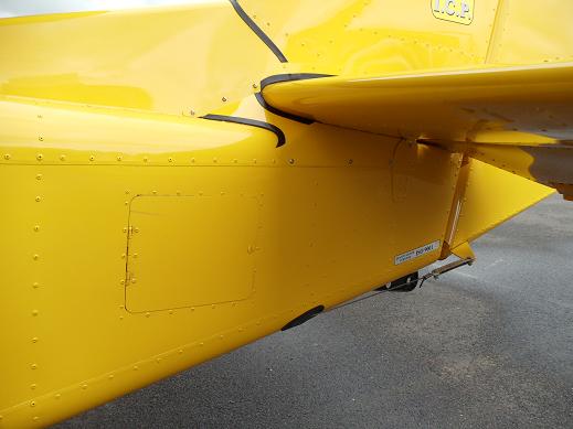

rankamateur Posted June 28, 2014 Posted June 28, 2014 Here's one I prepared earlier Photo used with(out) permission, No view of the front mounting during preflight, give it a waggle, if the bolts have fallen out you can probrably tell.
eightyknots Posted June 30, 2014 Posted June 30, 2014 Here's one I prepared earlier[ATTACH=full]31026[/ATTACH] Photo used with(out) permission, No view of the front mounting during preflight, give it a waggle, if the bolts have fallen out you can probrably tell. Thanks, Steve, that is a good photo that shows this up well. This must make the plane just a bit more aerodynamic.
rankamateur Posted June 30, 2014 Posted June 30, 2014 Here's one I prepared earlier Actually not! It was the first factory built S brought out here.

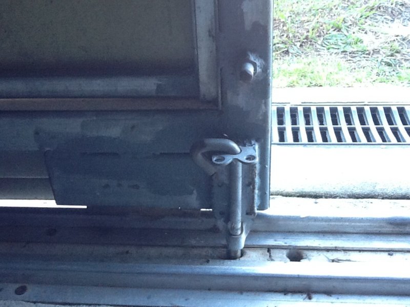

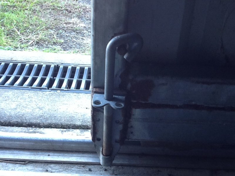

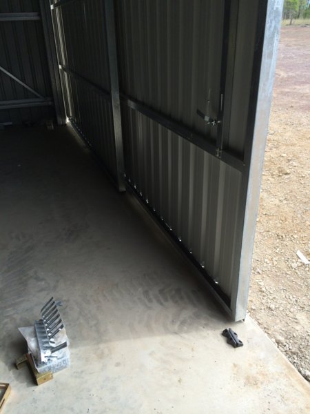

rankamateur Posted July 10, 2014 Posted July 10, 2014 Well the hangar is finished tonight, builder packed up and paid. Just one thing left to do, there was absolutely no locking mechanism supplied for the front sliding doors. next time you go to the farm could you post a couple of photos of what they did with yours Mark? Mine are free to blow open in the breeze at the moment. 1
Kyle Communications Posted July 10, 2014 Author Posted July 10, 2014 I will take some pics when I go up there to sign off although my mate is going up Monday I think for a day or 2 so I will get him to take some pics of it. From what I have seen it is a rotary lever and it goes up to a spring loaded pin by a wire that just pulls the pin out of a bracket with a hole in it. There is also a keylock on the outside handle these mechs are only on the 2 cenre door the 2 outer doors just have bolt style mechs that go into holes drilled into the floor

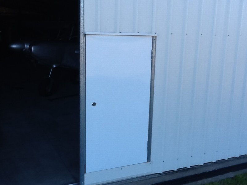

rotax618 Posted July 10, 2014 Posted July 10, 2014 I built a small PA door into one of the centre sliding doors and a simple gate bolt into the floor.
rankamateur Posted July 11, 2014 Posted July 11, 2014 My doors can't have anything protruding from the rear face because it fouls on the other door or the purlin when the doors open back flush with the wall. I am going to need to pin them through a flush hole in the frame with a bolt mounted on the purlin then come up with a flush way to secure the two middle doors together in the centre. It is a bit basic but even a nut and bolt drilled through the edge of the 50mm RHT frame would do it in an agricultural way.

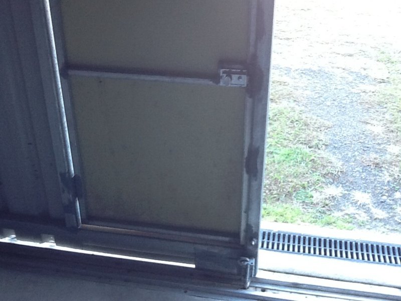

Kyle Communications Posted July 11, 2014 Author Posted July 11, 2014 this is the only pic I have until Eric goes there on Monday
rotax618 Posted July 11, 2014 Posted July 11, 2014 G'day Mark, you will probably regret hanging the doors from the top, every hangar around here has had to convert to bottom tracks. The conversion is easy just instal a couple of alloy sliding gate tracks and wheels. Apart from making the doors easy to open and close particularly when its windy, if you put the tracks down on silastic then they provide a barrier to stop water being blown under the door.

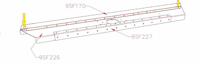

rotax618 Posted July 12, 2014 Posted July 12, 2014 One of the 'S' Savannahs down here has cracks forming at the ends of the angle across the top of the firewall. Have you seen any problem up your way
Kyle Communications Posted July 13, 2014 Author Posted July 13, 2014 Actually I think someone has mentioned to me about this. Mine has not don't that yet. Maybe due to the throttle bar as it puts a lot of stress on that bar as well when pulling the throttles back to idle. When you tug on it the bar does flex a little so that maybe the cause. From a balance of 1.00 to 0.9 you will notice a big difference in smoothness now
