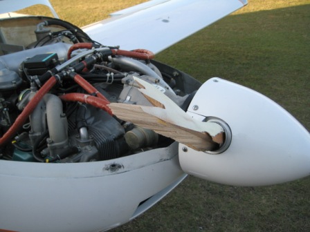

wags Posted September 1, 2008 Posted September 1, 2008 On Sunday 31st August a Czech Airworks "Sportcruiser" was conducting circuits at Gympie Airfield with the aircraft's new owner and an instructor onboard. Slight vibration was felt throughout the aircraft during initial climbout and x-wind legs of a circuit. The instructor reduced power somewhat but approx 30 secs later a very loud "explosion" occurred and the engine came to an abrupt stop. A short stub of one blade of the 2 blade Woodcomp inflight adjustable propeller was visible protruding over the cowling. The aircraft subsequently carried out an emergency landing back onto the airfield without further incident. The occupants suffered no injury other than to their nerves. The aircraft was virtually new (50 hrs or less?) and had not exhibited any previous propeller problems that I am aware of. What remains of the prop stub displays what looks like water seepage (or similar) has occurred between the wood laminations of the blade, but this fact will need to be confirmed by investigators. The engine has obviously "twisted" on its mounts with at least two mounts showing indications of significant distortion. The engine exhaust stub had moved approx 100 mm or more and impacted the nose wheel mount with sufficient force to dent the exhaust pipe itself. Both carbies of the Rotax 912 had disconnected themselves from the intake manifold and no doubt aided in stopping the engine before further damage occurred. The strength of the airframe no doubt contributed to a safe outcome for the occupants of the aircraft. The outcome of an investigation into this incident will be interesting to read as this would appear to be a catastrophic failure of what could be considered as a brand new propeller. It will almost certainly require replacement of everything from and including the firewall forward. I for one will take more than a precursory look at the blades of my prop during any preflight from now on looking for signs of any tell-tale hairline cracks or indications of delamination starting to occur, especially around the hub area.

wags Posted September 2, 2008 Author Posted September 2, 2008 Brentc please do not think I am saying that the Sportcruiser itself had a problem. In fact quite the opposite. Any lesser constructed aircraft might well have ended up loosing its engine and that would have spealt disaster for the occupants with a sudden shifting aft, and definitely out of limits, of the CofG. The fact that engine mounts were broken and the engine "twisted" so much without becoming detached from the airframe is a testament to the strong construction and quality of build of the Sportcruiser. The fact is that a "new" propeller failed for whatever reason - but the investigators will determine that fact. Perhaps this incident suggests we should all practice our emergency landings on a regular basis. Wags.

johnm Posted November 25, 2008 Posted November 25, 2008 photos I think there will be 2 photo's attached to this email One shows the broken blade One shows carbbies pulled from engine - by forces when blade broke This is not a reflection or comment about the 'aircraft and hardware' used in this thread - it just shows you what could happen up front

johnm Posted November 25, 2008 Posted November 25, 2008 There was no plumbing installed in the aircraft - this option not installed (and I doubt whether available) I am told however, if there was such plumbing installed - it would of been put to great use
Guest becky1 Posted December 13, 2008 Posted December 13, 2008 Hi everyone, Just to set the record straight I was flying the aircraft when the propeller snapped on early downwind.In reference to Michael Coates comment about there being another lesson to be learned here by not pulling the aircraft around by the prop,this definately was not the case in this particular incident and perhaps if Michael had all the facts which are well known now to the investigating authorities,he may not of insinuated that this may have been a reason for the failure especially when the aircrew involved can read it on this forum The pieces of the propeller have all been found and proven to be faulty. The aircraft and prop had done a total of 96 hours and had been moved around the hanger with a towbar with extreme care,the aeroplane has never spent a night outside,it was always thoroughly preflighted and the lack of glue on the wooden section inside the carbon outer sheaths could not be seen,so no one had any idea there was about to be a failure. It was a frightening experience especially when it happened with no warning and such a violent bang and a jarring right through the whole aircraft. both my student who also owns the aircraft and I were very fortunate that the carbys did come off the engine which stopped it straight away as I doubt our reaction time could never have been quick enough to turn it off before further damage to the engine mounts and firewall which may have resulted into something far worse than a deadstick landing Jennifer

wags Posted December 16, 2008 Author Posted December 16, 2008 Handling of props and blade failure. I read with great interest the suggestion that pulling an aircraft around by the prop can lead to blade failure, delamination etc. I must have missed something in 40+yrs of aviation and nearly 20,000 hrs flying because I was taught right from the beginning to grab the prop with a hand close in either side of the hub to move aircraft if a tow-bar was not available. No aviator in their right mind would put a load such as this on a prop at any point other than close to the hub. Moving an aircraft in this manner, done correctly, would not subject the prop to anything more than a fraction of the loads imposed on it during normal operation. The facts associated with this particular failure are that the propeller involved in the incident (which could have been castastrophic for the occupants of the aircraft) was virtually new and the prop failed from the inside out. Inspection has revealed a lack of glue on the laminations of the blade core which is made of wood. The covering sheath of carbon fibre was shed as a whole piece from both the front and back of the blade indicating there was movement within the core under the covering sheath. One can only draw the conclusion that it appears this prop failed due to a possible lack of quality control by the manufacturer or similar. The fact that there are other cases of the same brand/type failing because of core delamination around the same time confirms there might be a problem with the manufacture of that particular brand/type of prop. This prop was eventually going to fail regardless of how it was handled. What I find very disturbing about this incident is not how we should or should not move our aircraft around a hangar, it is the failure of authorities to prohibit further flight by aircraft fitted with the same brand/type of prop until they have been fully inspected. Not just a visual inspection looking for cracks and signs of wear as directed in the AD, but a full and thorough inspection possibly even involving x-raying (or similar) of all blades. If I was flying an aircraft with this brand/type of prop I would be doing a whole lot more than simply looking at the prop before I flew the aircraft again! You can be sure of one thing - in a large majority of aircraft types we fly under the RAAus banner, if the motor comes out in flight the aircraft will more than likely be uncontrollable with a disastrous outcome for the occupants. The crew involved in this incident were extremely lucky in the circumstances.
Guest Johnmac Posted December 16, 2008 Posted December 16, 2008 Where have you all been, the accepted and correct way to move an aircraft is to pull via the prop as close as possible to the spinner. It is not, and never has been acceptable, to pull an aircraft by the tip of the prop, even so as I understand it the prop delaminated and expert examination has shown failure of the "glue", end of story.
