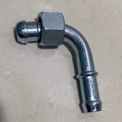

I have a spare elbow  with swivel fitting PN 956580 Elbow (see below) need to find a connecting nipple from it to crankcase.
I believe the crankcase exit hole to be M16 x 1.5mm (?).
I don't know the elbow nut thread (M18 x 1.5mm?) or the angle specifications of the conical end.
I have a oil cooler fitting PN 956577 (sample shown) that fits the elbow but not the crankcase. I imagine the correct adapter will look similar.

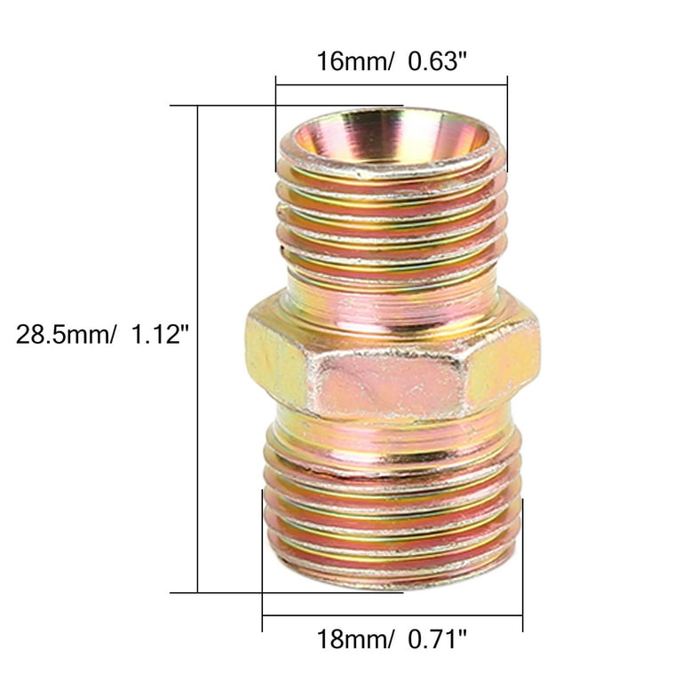

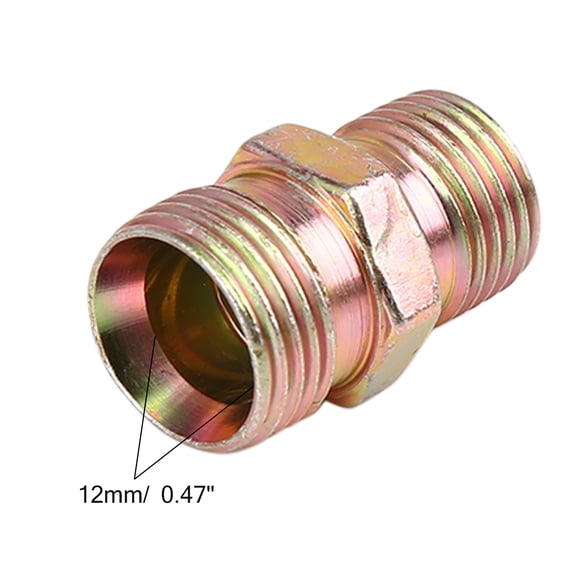

This could be it;
Adapter M18x1.5 Female / M16 x 1.5
Unique Bargains 2pcs M16 x 1.5mm to M18 x 1.5mm Auto Car Straight Air Pipe Fitting Connector AdapterUnique Bargains 2pcs M16 x 1.5mm to M18 x 1.5mm Auto Car Straight Air Pipe  Fitting Connector Adapter
Edited by skippydiesel
Definitely not. That type is for  joining a Pipe to a smaller pipe using thin tapered solderless nipples, which crush onto the pipe as the nuts are tightened. The nuts used have to be internally tapered also. It's an obsolete and not very satisfactory system. The SPHERICALseat on that elbow is one of the best set ups and seals on a narrow 45 degree seat on the correct  part with a thin line of contact achieving the seal reliably with some degree of misalignment tolerence. Nev
