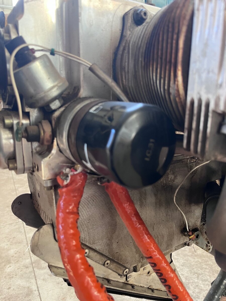

danstee Posted 11 hours ago Posted 11 hours ago I’m pretty sure I have the oil pressure and oil temperature senders, but what is the sensor just below the silver oil pressure sender?
skippydiesel Posted 11 hours ago Posted 11 hours ago My guess its oil temperature. Is it possible you have two or that the other (not pictured) is something else like CHT?😈

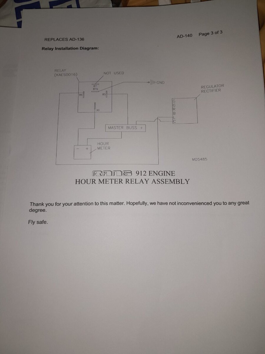

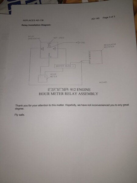

Kiwi Posted 7 hours ago Posted 7 hours ago (edited) 3 hours ago, danstee said: I’m pretty sure I have the oil pressure and oil temperature senders, but what is the sensor just below the silver oil pressure sender? The lower oil pressure switch starts the Hobbs Meter on my Rans S6S. The one on the sump would definitely be temperature. I can look for the wiring diagram if you need it. Edited 7 hours ago by Kiwi
BrendAn Posted 6 hours ago Posted 6 hours ago 4 hours ago, danstee said: I’m pretty sure I have the oil pressure and oil temperature senders, but what is the sensor just below the silver oil pressure sender? temp

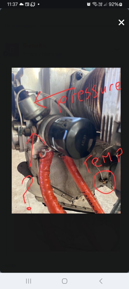

Kiwi Posted 3 hours ago Posted 3 hours ago (edited) I think he is talking about this one. But I'm thinking about a Rotax engine, not a Jabiru. Edited 3 hours ago by Kiwi
