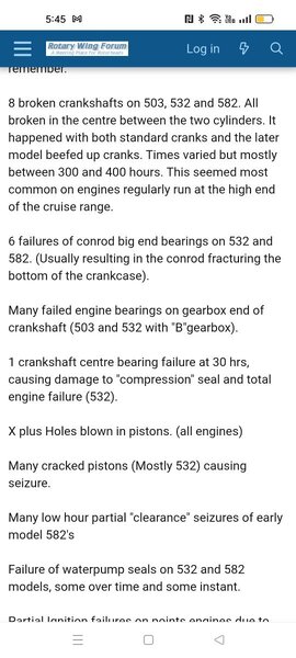

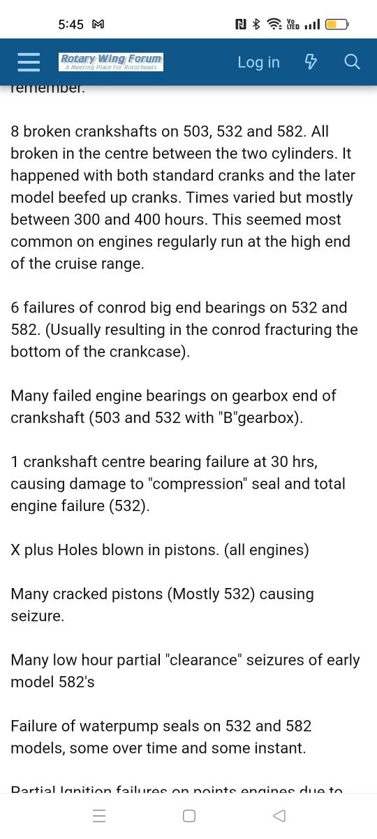

facthunter Posted 18 hours ago Posted 18 hours ago BrenDAn, The MOTOR YOU Have had a reputation for breaking Crankshafts near the drive end. Nev

BrendAn Posted 18 hours ago Author Posted 18 hours ago 6 minutes ago, facthunter said: BrenDAn, The MOTOR YOU Have had a reputation for breaking Crankshafts near the drive end. Nev Pretty rare I think. Rotax rick reckons they were the best of the Rotax 2 smokes. Detuned from 135 HP in the snow mobile version. I have spoken to a few people that have never had an issue. I think if they are looked after and operated by the book should be good like most engines. 1
BrendAn Posted 17 hours ago Author Posted 17 hours ago 31 minutes ago, facthunter said: BrenDAn, The MOTOR YOU Have had a reputation for breaking Crankshafts near the drive end. Nev A couple of paragraphs off a gyro forum. Shows all models can break cranks. Gyros are pretty hard on 2 strokes. Driven flat out all the time. 1
facthunter Posted 17 hours ago Posted 17 hours ago The original Book may not be the Best reference, Currently. Nev

facthunter Posted 17 hours ago Posted 17 hours ago There's a Lot of ways of helping them Last Better. Gyros need Lots of Power. Carbon Behind the rings is a Killer. Big end Cages fail and the Hard skin flakes off the Crank Pins and the results of that are Quick and fast. Any Holey Piston Means aluminium all through that Cylinder and case. Nev 1
