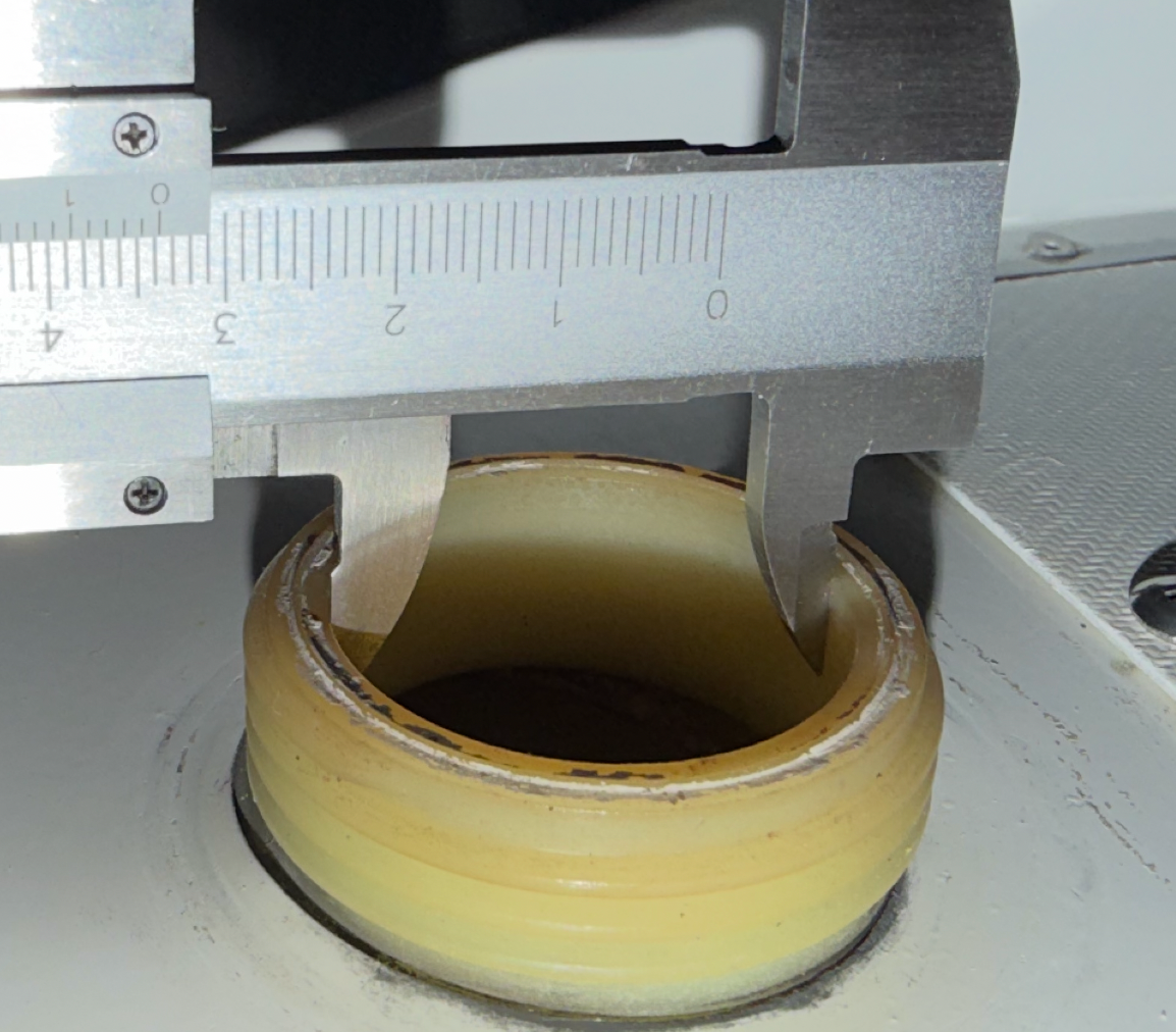

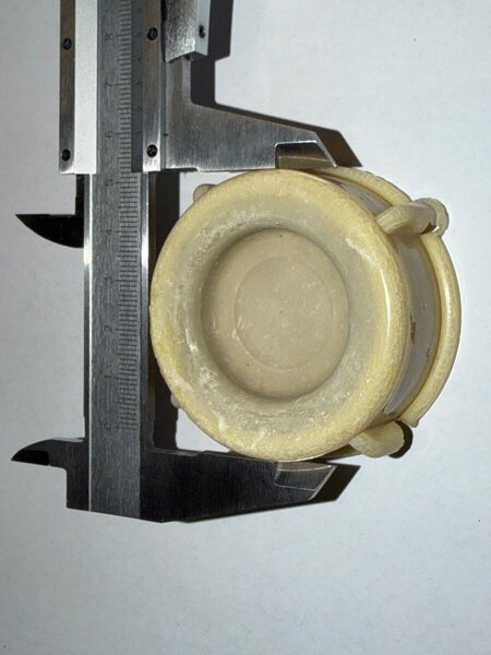

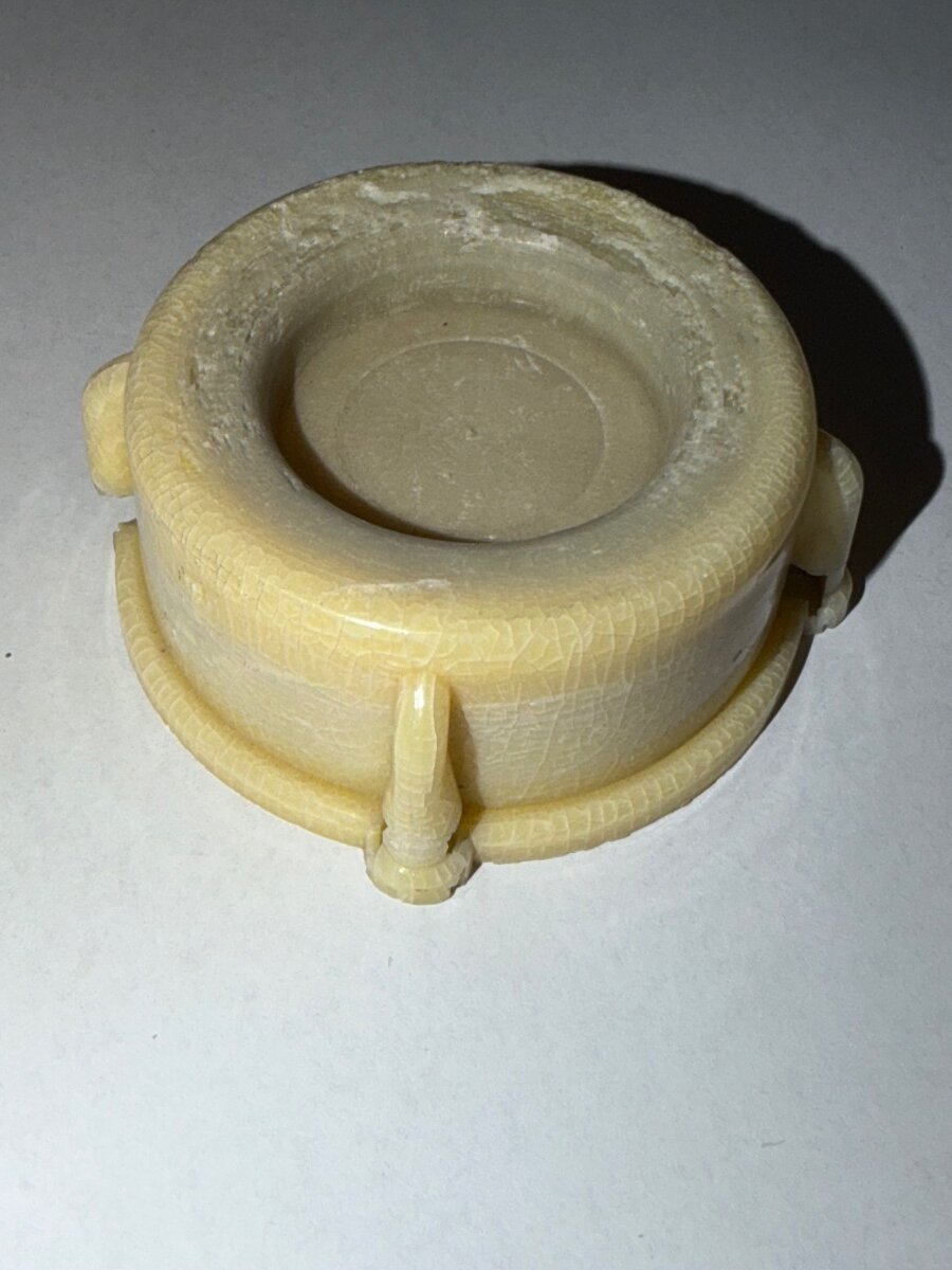

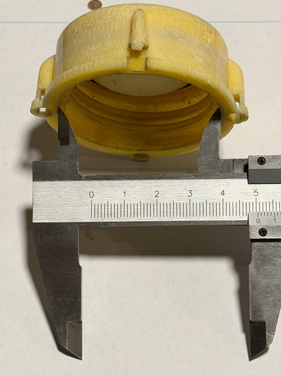

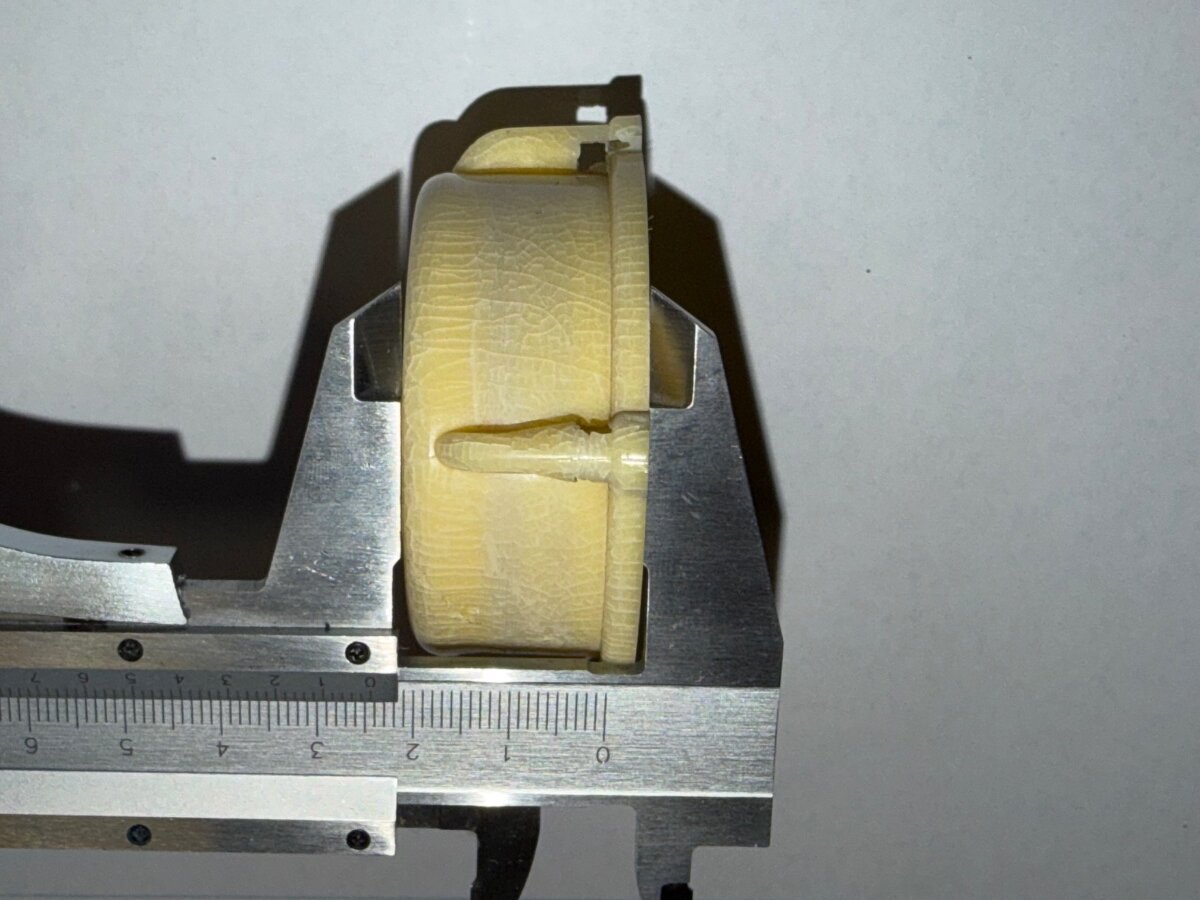

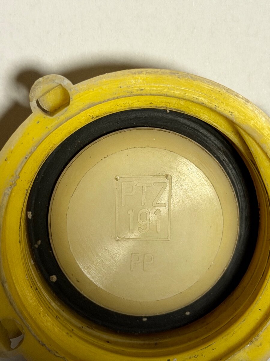

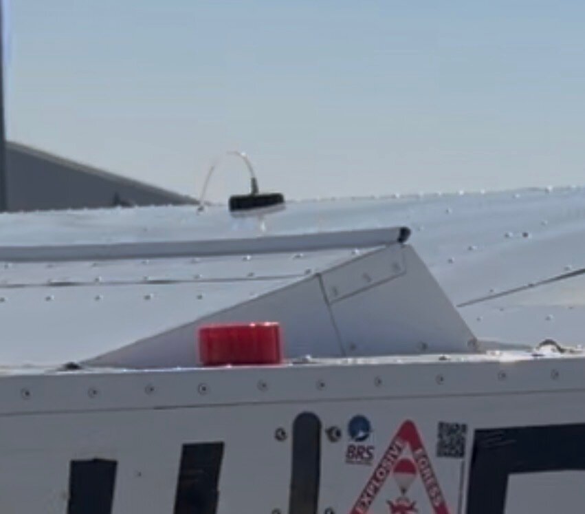

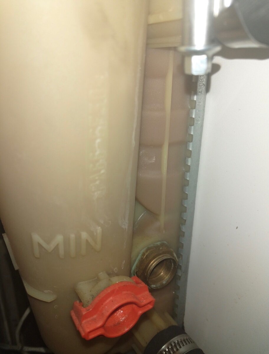

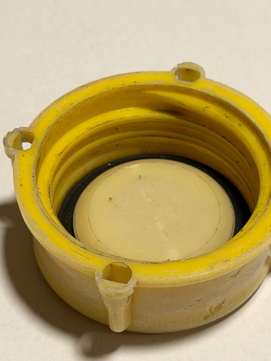

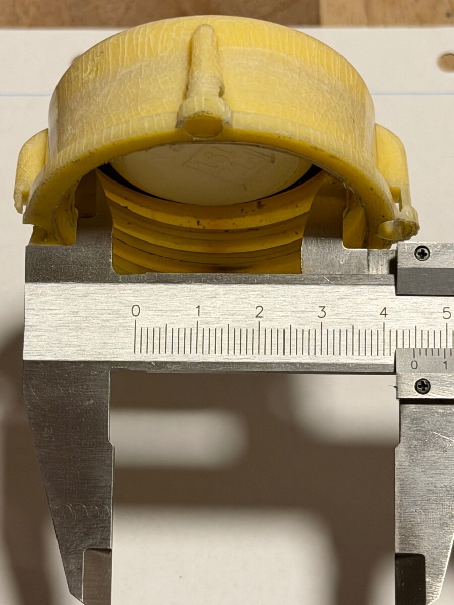

Pat Posted January 3 Posted January 3 Hi all! Happy New Year! My year 2000 ICP built Sav (MXP-740) coolant reservoir screw cap is disintegrating and I am desperately looking for a replacement. It's the version with the rear fuselage air scoop and what looks like an automotive radiator. Pictures and measurements attached. Any hints on where I can find one greatly appreciated! Thanks 🙏 Pat 1

skippydiesel Posted January 5 Posted January 5 From the photo's- That cap looks to have many flight hours left in it. The reservoir is is not pressurised, the cap is just to prevent entry of contaminates and to stop the chance of a turbulence/hard landing coolant spill. Almost any cap, of the right dimension/thread pitch, would do the job.😈 1 1
facthunter Posted January 5 Posted January 5 I reckon it's near Had it. Have a Look around lids of 50 Litre Chemical containers and I think it may be a standard type. Looks sun damaged. Better formed thread than most applications. Nev 2
onetrack Posted January 5 Posted January 5 (edited) That cap is ready to fall apart, I've never seen polypropylene so badly sun-bleached. Finding the correct thread is often the hassle, once you go outside the "regular" suppliers. There's so many different threads on containers and caps, I'm sure a lot of them produce their own thread varieties. Edited January 5 by onetrack 2

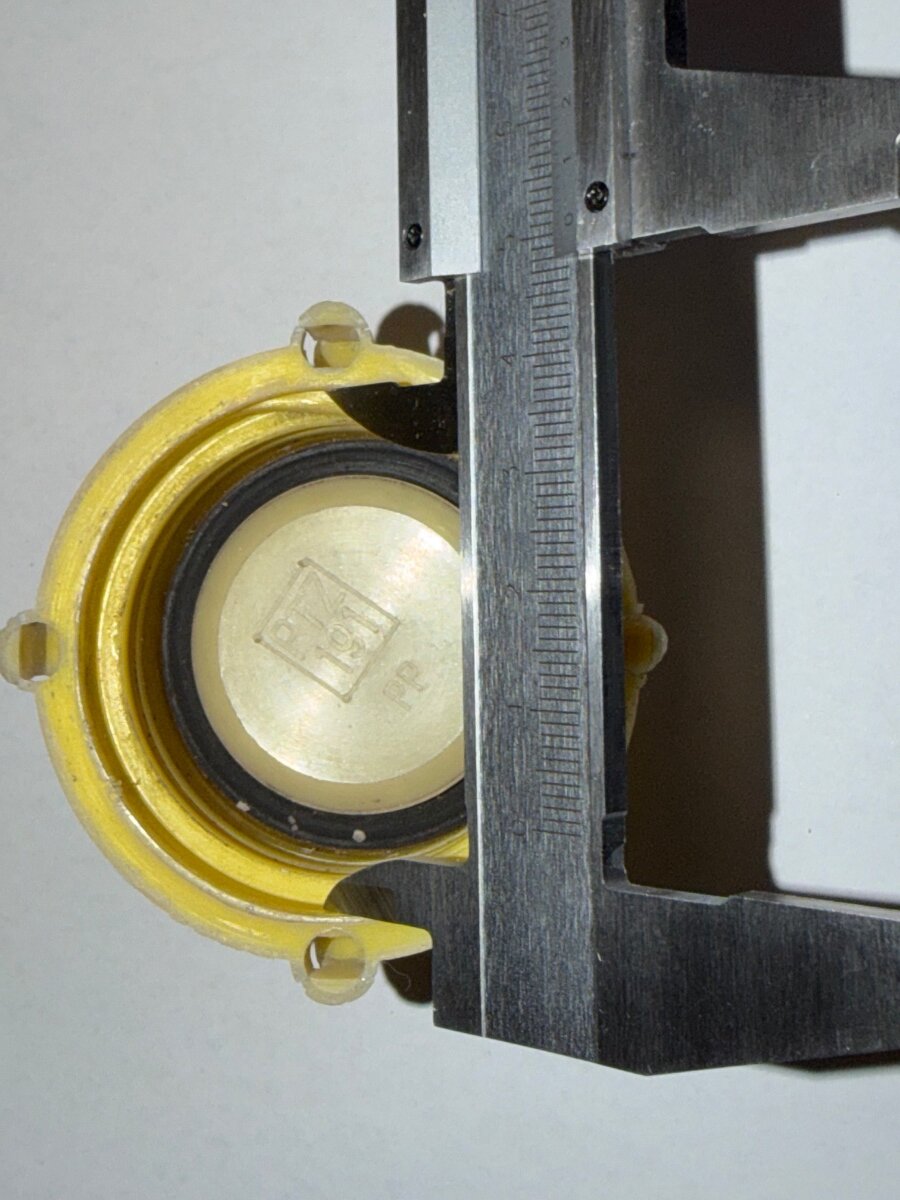

Pat Posted Sunday at 08:20 PM Author Posted Sunday at 08:20 PM So far no luck in finding a replacement. Adding two more fotos of the threads. 45mm it is.
Blueadventures Posted Sunday at 09:56 PM Posted Sunday at 09:56 PM 1 hour ago, Pat said: So far no luck in finding a replacement. Adding two more fotos of the threads. 45mm it is. Try my epoxy method on an old oil bottle and see what you think about it. I've done it a few times. 2
skippydiesel Posted Sunday at 10:47 PM Posted Sunday at 10:47 PM Dont know the dimensions but what about an oil container cap? Another thought bubble - the collapsible jerry cans/bladders, have a cap which can be ordered separately 😈 1
Thruster88 Posted Sunday at 11:23 PM Posted Sunday at 11:23 PM 3 hours ago, Pat said: So far no luck in finding a replacement. Adding two more fotos of the threads. 45mm it is. Have you tried a GL45 or 45-400 cap, can see pics on Ebay.
