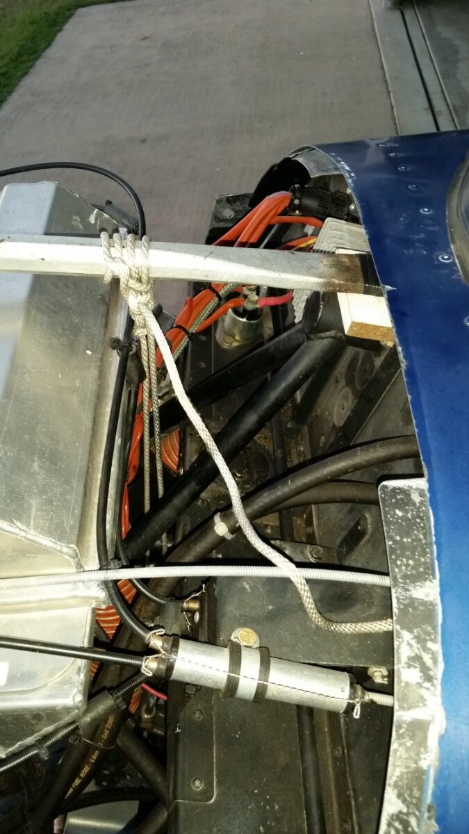

Blueadventures Posted October 29 Posted October 29 There are images of the tool they use. I changed one a few years back and used a straight 900mm crowbar to pull the bungee up and over the top lug. A loop of Spectra cord was used between the crowbar and bungee and also a small block of soft wood was placed were the tip of the crowbar pivoted on the metal. Didn't mark the paint and worked. Have an image I chase up if needed. 1 1

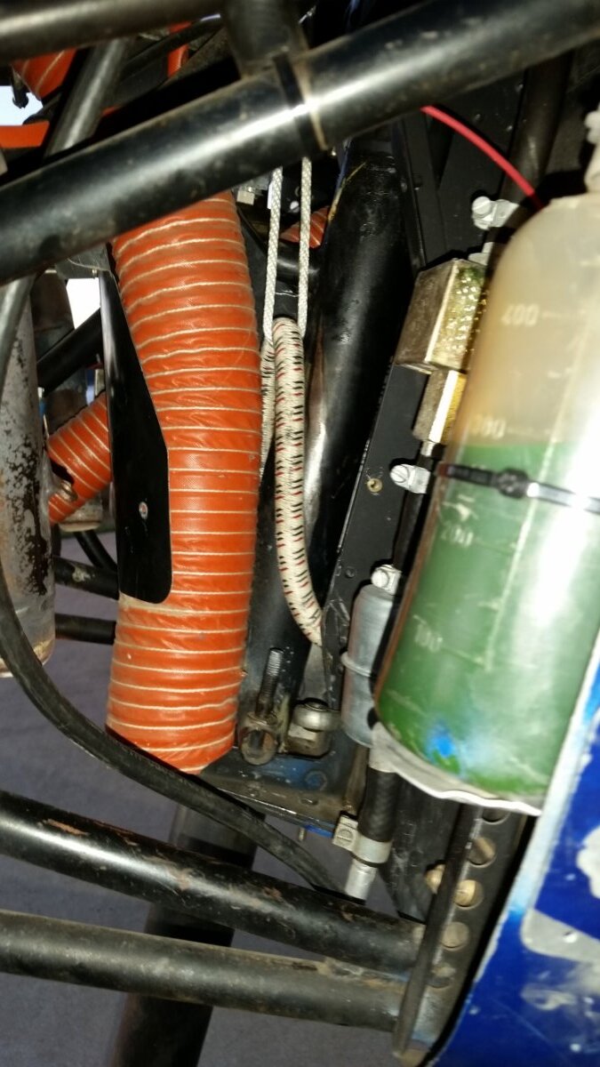

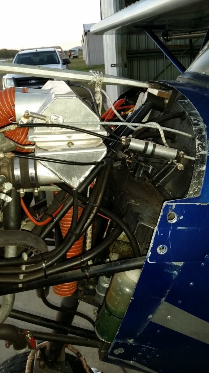

Blueadventures Posted October 29 Posted October 29 (edited) 50 minutes ago, Steve ZK said: Thanks very much. If you have images that would be appreciated. Approaching the 1000 hours mark so trying to tick off some boxes along the way. This is how I did it. (Spectra cord like used for mower or outboard pull starts) Very easy. Talc powder on bungee will assist sliding if needed. Edited October 29 by Blueadventures 2 1
skippydiesel Posted October 29 Posted October 29 Wow! Thats one gigantic coolant expansion bottle - if thats what it is. Got to be x 3 of my Rotax unit. What does the down pointing SCAT tube do?😈
Steve ZK Posted October 29 Author Posted October 29 Awesome and thanks for that. It does look like I need to loose the brackets at the bottom of the nose gear to get the bungy behind.
