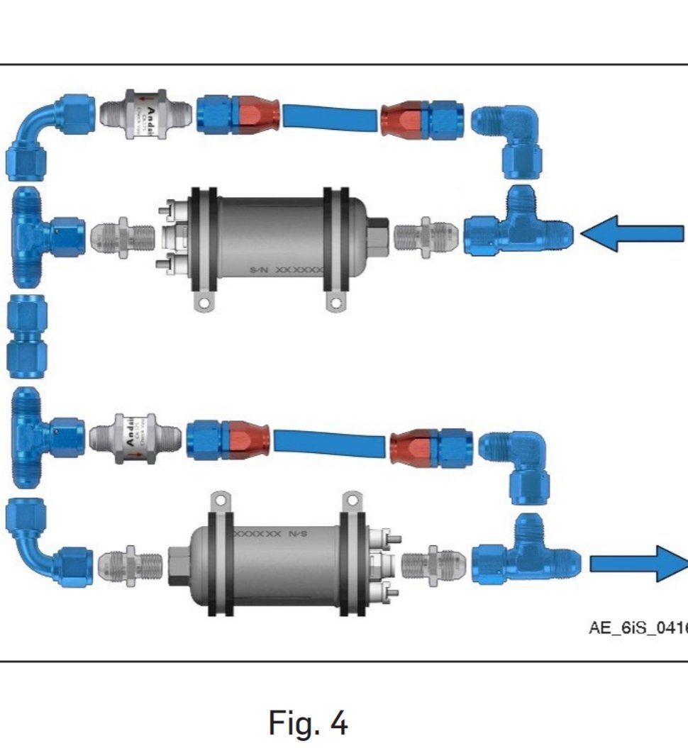

Lyndon Posted July 4, 2025 Posted July 4, 2025 Rotax have a complicated two pump set up with non return valves and an extra line with a restrictor. My question is. Do I just go to racetech and buy all the A an N fittings, elbows etc. The whole set up has flared fittings. Airframe mounted so little or no vibration. Or have off the shelf car fittings failed by experience and I need aircraft quality and price. Thanks Lyndon

skippydiesel Posted July 5, 2025 Posted July 5, 2025 7 hours ago, Lyndon said: Rotax have a complicated two pump set up with non return valves and an extra line with a restrictor. My question is. Do I just go to racetech and buy all the A an N fittings, elbows etc. The whole set up has flared fittings. Airframe mounted so little or no vibration. Or have off the shelf car fittings failed by experience and I need aircraft quality and price. Thanks Lyndon My system is for a Rotax 912ULS; If you would like, I can send photos of my interpretation of the Rotax boost pump, with non return by-pass circuit - all a mixture of automotive & aircraft fittings.😈
Lyndon Posted July 5, 2025 Author Posted July 5, 2025 I've got the layout. Just need to buy the fittings. Lyndon

Lyndon Posted July 5, 2025 Author Posted July 5, 2025 In fact you now have 3 layout options to place them in series.To suit your aircraft I presume Lyndon
Lyndon Posted July 5, 2025 Author Posted July 5, 2025 It's that or hose clamps and rubber hose. Eg the older cassette type. Like I said a complicated system. Lyndon 1
