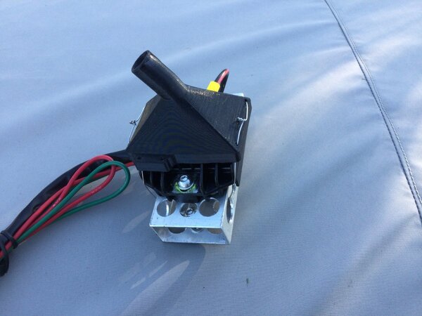

skippydiesel Posted May 18, 2025 Posted May 18, 2025 I seek your leaned advice; At only 153 Hobbs hrs, my Rotax/Ducati Voltage Regulator seems to have "spat the dummy". This is despite mounting in cockpit (away from engine heat) extra careful grounding, with dedicated fresh air supply. Now researching options - see below; Rotax/Ducati - Rotax PN 965349 / Ducati PN 362001. OM, poor reputation. About $350Au delivered CARMO CARR5115 MOSFET - local supplier "Vectriq Parts". Seem to have a strong following. Non standard Rotax connection. Claims of cooler operating and no need for 22000 Mu capacitor. About $300Au delivered. Silent Hektik DE - As yet no local supplier found. Confusing model descriptions. Confusing prices $160 - 192Au in Germany. Fitted by at least one small aircraft manufacture. No reviews at this stage (see reading list below). Electrosport ESR439 - Fitted to various motorcycles including Honda. About $300Au delivered. No aircraft related reviews. Advanced Voltage controller - Claimed to be specific aircraft VR. Estimated $570Au delivered. No reviews SHINDENGEN FH020AA - Original fitted to various motorcycles. Look great. Prices vary from about $50 Au (copy?) to $500Au. No aircraft related reviews Mower style VR's eg suited to John Deere. Suggested reading, curtesy of "RV12 Build Log" http://ctflier.com/topic/2371-regulator-rectifier-longish-and-techie/ http://www.dogaviation.com/2016/01/the-ducati-voltage-regulator-dilemma.html

IBob Posted May 18, 2025 Posted May 18, 2025 Skippy, when you say 'extra careful grounding', presumably that includes the metal body of the regulator? I ask because I'm aware of one that appeared to fail (it hadn't) because the body wasn't well grounded. 1 1
skippydiesel Posted May 18, 2025 Author Posted May 18, 2025 1 hour ago, IBob said: Skippy, when you say 'extra careful grounding', presumably that includes the metal body of the regulator? I ask because I'm aware of one that appeared to fail (it hadn't) because the body wasn't well grounded. I always go the "extra mile" to ground all of my 12V systems, so yes body & any designated terminals all back to battery Neg (-) not just to airframe.😈 2 1
