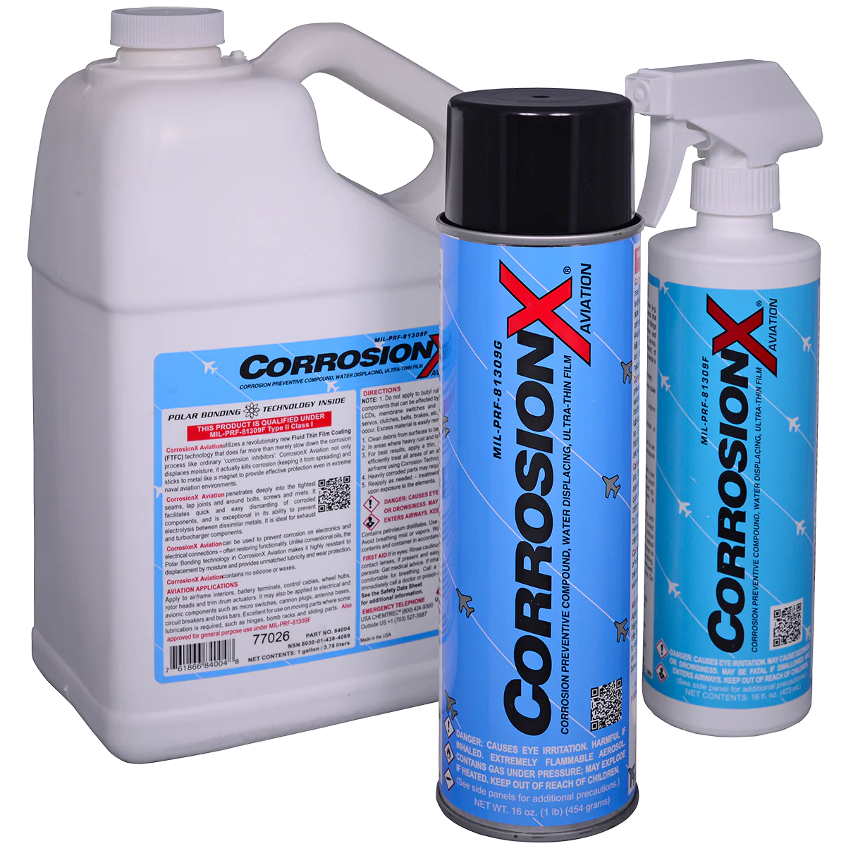

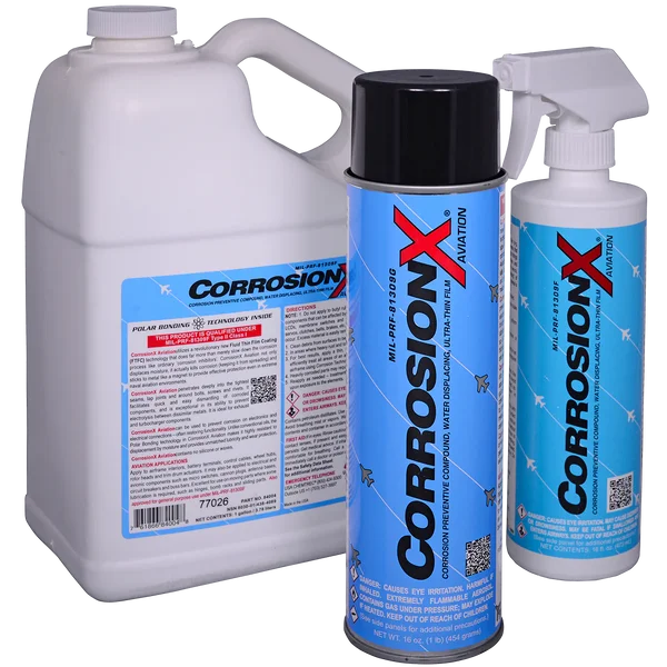

Inox = No /don't. Maybe buy a suitable product from an aircraft maintenance shop down your way that maintains seaplanes or aircraft kept near the coast.  If going to Avalon talk to say SAAA, or the Sea Plane group or aircraft maintenance people they will know the uses and benefits of products like ACF50, Corrosion X and other products.  Let us know what you find out.
