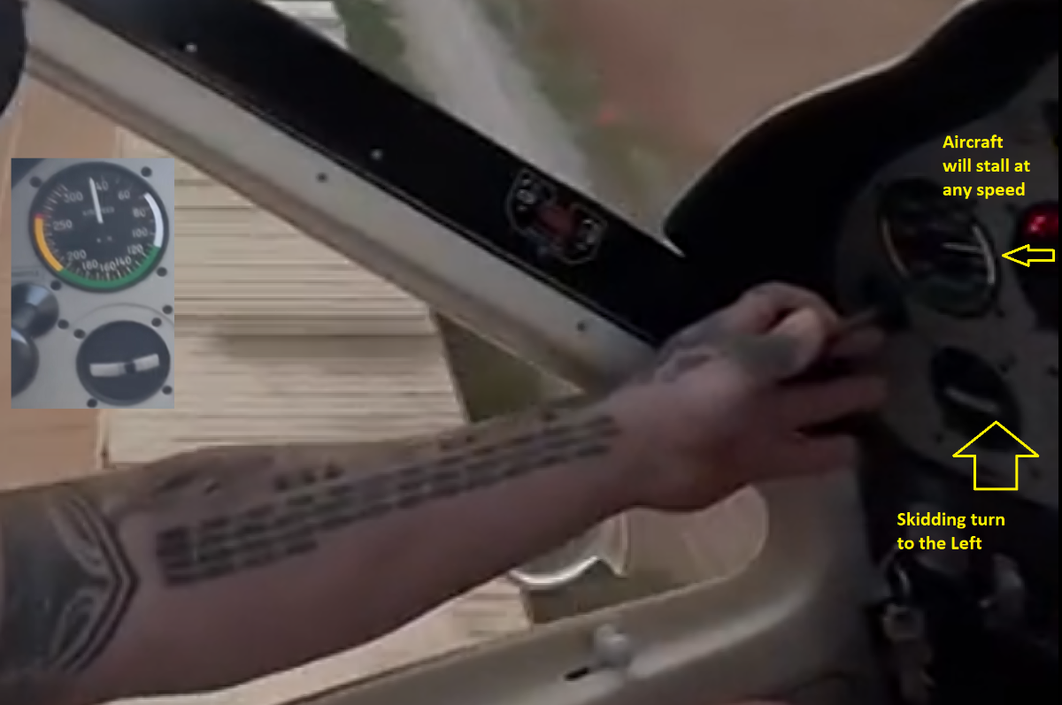

The balance ball was nowhere to be seen at any stage of the video! I wasn't sure if that was the right instrument below the throttle, however, trust me it is, as it will be shown in the next video.
In turns, especially skidding turns, the nose naturally drops down, which PIC counteracts by pulling the stick back. Applying more left rudder into the turn makes the outside right wing flying faster, which increases the lift on the right wing, which makes the turn steeper. PIC’s counter-reaction was applying the right aileron.

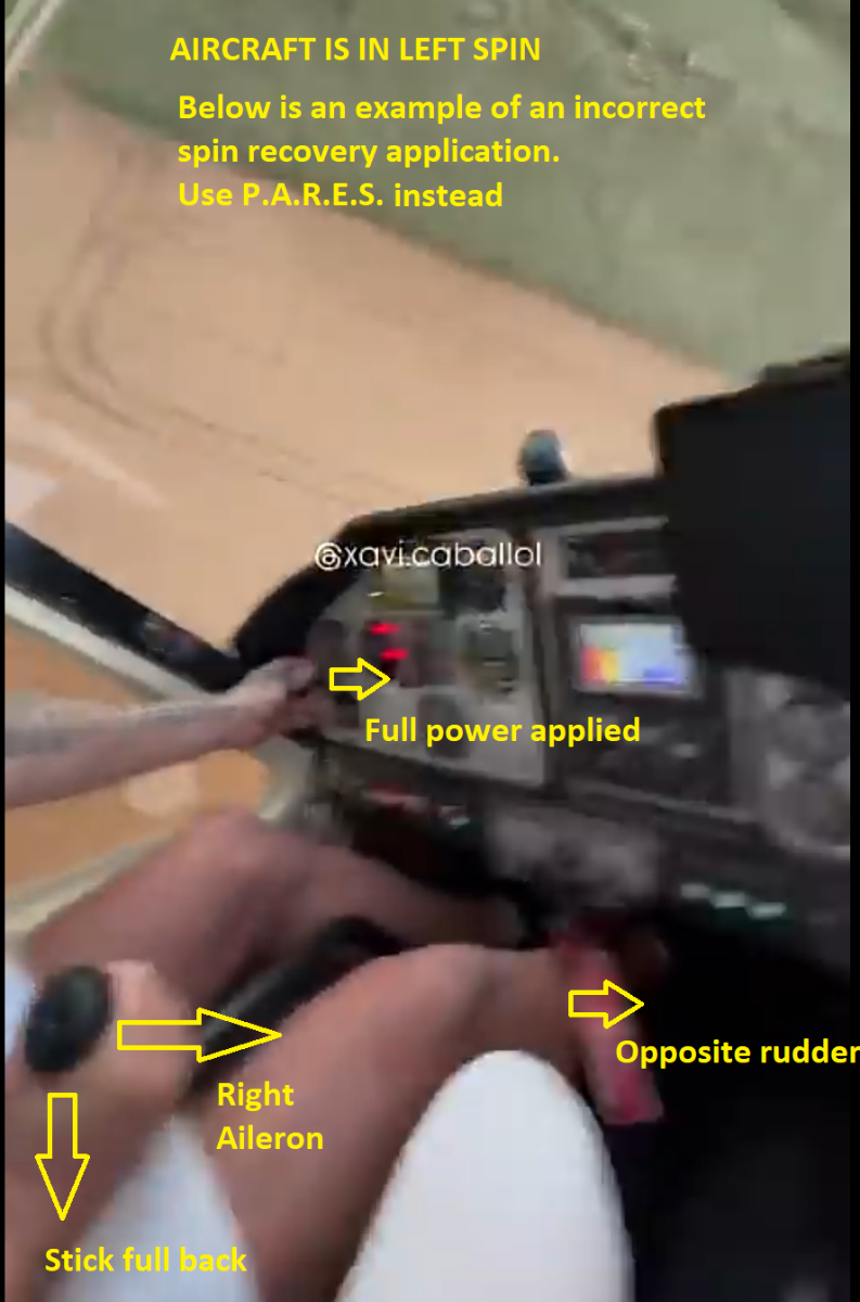

Aircraft enters the left Spin, and we all remember the Spin recovery procedure: PARES (Power idle, Aileron Neutral, Rudder Opposite and hold, Elevator Forward to Neutral, When rotation Stops, centralise the rudder and pull out of dive)
Unfortunately, PIC does the opposite: applies full power, opposite (right) rudder, whilst keeping the right aileron, and stick back all the way to the ground.
Applying the opposite (right) rudder is not sufficient for Spin recovery without other control inputs – and in PARES order.

As I wasn't sure about the balance ball position in the accident video, I found another video showing the balance ball skidding (and slipping) in approaching to land.
All I can say, Xavi and his passenger are very lucky for not Stall-Spinning earlier.

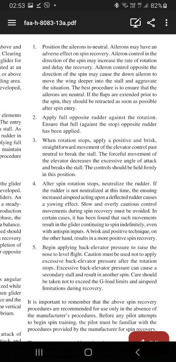

The FAA Glider Flying Handbook (also used by GFA) recommend slightly different Spin recovery procedure compared to powered aircraft (page 8-17):
https://www.doc.glidingaustralia.org/index.php?option=com_docman&view=download&alias=2817-the-glider-flying-handbook&category_slug=gpc-resources&Itemid=101
Screenshot_20250101-025334_OfficeSuite.thumb.jpg.0d22fcef5ffce7136f5cfc75a5839679.jpg
To summarise, if you are flying powered aircraft, get the Spin training in powered aircraft.
