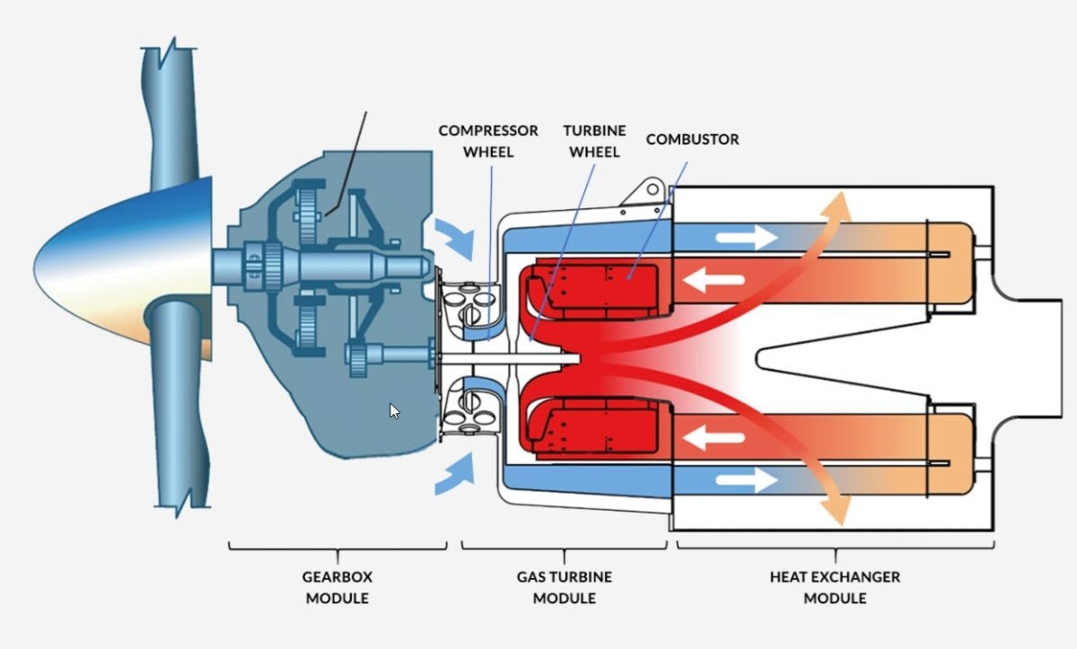

Thruster88 Posted December 29, 2024 Posted December 29, 2024 The TP-R90 looks very simple, one compressor and one power turbine, essentially the same as a turbocharger. Heat exchanger at rear. Propeller from Airmaster NZ, they have feather capabilities. 1 1
facthunter Posted December 29, 2024 Posted December 29, 2024 Not giving away much detail there. Simple schematic. Nev 1
