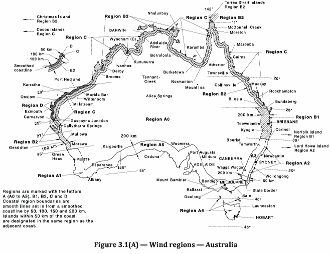

rgmwa Posted February 5, 2025 Posted February 5, 2025 19 minutes ago, Blueadventures said: This is the bracing (Fly and cross) for our Northern Queensland ratings. Just out of interest, these are the various wind speed regions for Australia: If you're in coastal Northern Qld, you'll be in Region C (cyclonic). The number after the letters (eg A0-A5) denotes different wind speeds coming from different directions for each region, and can be used to fine tune a design. The typical basic design wind speeds in each region are: A 45m/sec (162 km/hr) B 57m/sec (205 km/hr) C 66m/sec (238 km/hr) D 80m/sec (288 km/hr) 1 1

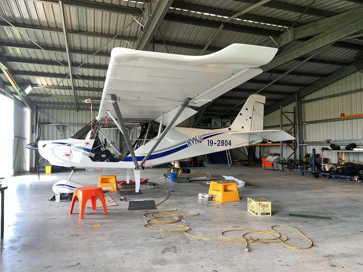

BrendAn Posted February 7, 2025 Posted February 7, 2025 On 05/02/2025 at 8:01 PM, Blueadventures said: This is the bracing (Fly and cross) for our Northern Queensland ratings. Fantastic looking aircraft. I love the size of the doors. 2
